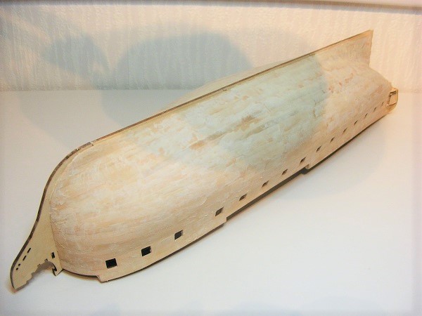

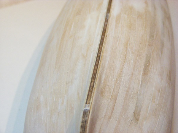

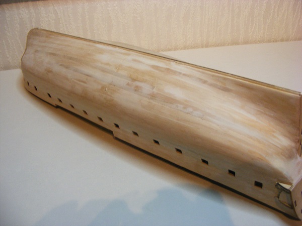

Spent my time on the next part of the build namely, applying filler to the hull... This is a task that many novices tend to rush or they simply look for the obvious blemishes and deal with them, only to be disappointed when the primer is added. You'd be surprised at the blemishes that will show through so take your time when you come to this part and be methodical as you work along the hull. I inspect the hull very closely and any imperfections I believe that may show through when primed gets a coating of filler. Remember, the vast majority of filler will be removed when sanded down. Here is how she looks just now and this will be left overnight to thoroughly dry before starting the sanding process. Sanding down hopefully will start tomorrow evening so until then, happy building all....Cool Cool

Hi Alan, Great job mate. I agree about the blemishes, depending on the light, some are damn near invisible until you apply a thin skim of filler..surprising what shows up!! You've put a lot of awesome work into your builds..Plenty of very useful tips that the newby's to this kind of modelling would love!!

Thanks Jonny, I'm happy to help any modeller if I can, its something I enjoy doing. The future of our hobby is in the hands of those that follow on behind us.....Cool Cool

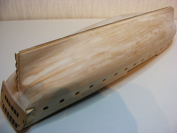

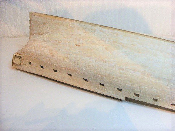

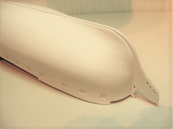

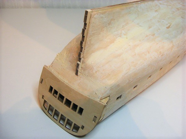

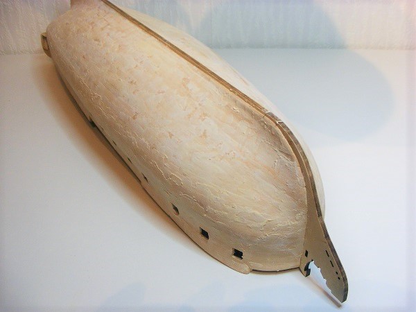

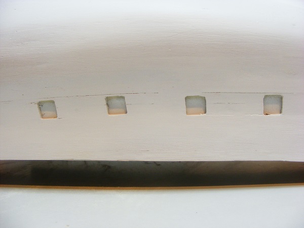

So have now completed stage 13, filling and sanding down. Even with care, I think I'd be living in a different planet if I were to believe that once primed no more blemishes will be seen....Blink Blink .. I'm sure some will appear..... Sanding started off with a course grade sandpaper to remove the bulk of the filler, then a medium followed by fine grades. Lastly a sanding sponge before cleaning all the sanding dust off.. this is where an airbrush really comes in handy, gets into all those nooks and crannies....Cool Cool ... Next step is to mask off ready for the first coat of primer to be applied. Will post again when masking is done so until then, happy building all.....Cool Cool

BigGrin Looking good Alan and yup there will be more gremlins yet to tame Cool

Looks nice and smooth from the pics .Sanding has to be the worst part ,looks like you got through it though.

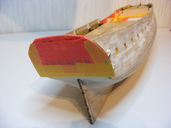

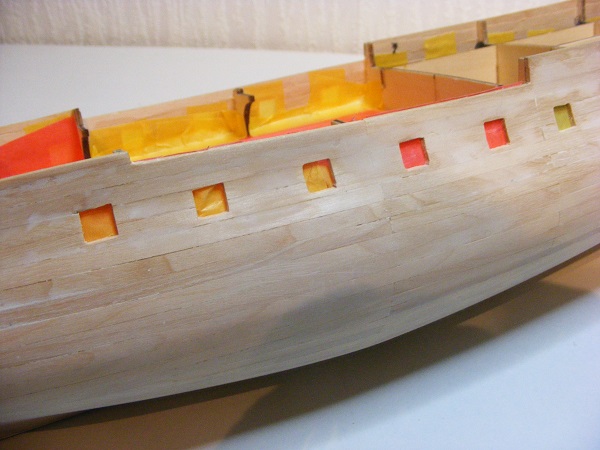

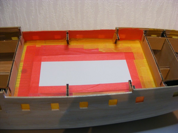

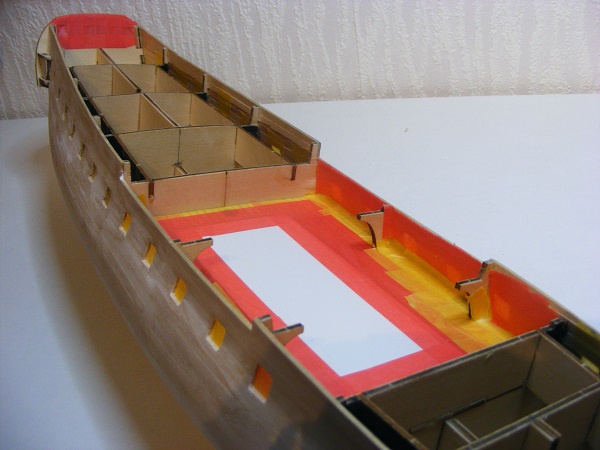

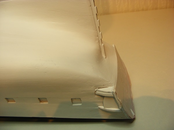

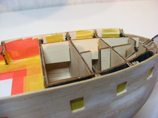

I did say I would post some pics once the masking process was done so here they are. First off was to ensure the main deck was masked off completely, this is certainly one area I don't want to see any paint bleed on. Stern section has been completely masked off although further painting to this area will be done later. Applied masking tape to the inside of the gun ports, this is to protect the blackened gun supports.
She is now ready for the first coat of primer and hopefully this will be applied tomorrow providing the weather holds. Can only prime this one outside so fingers crossed. Until then, happy modelling.....Cool Cool

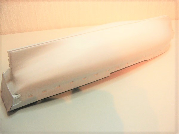

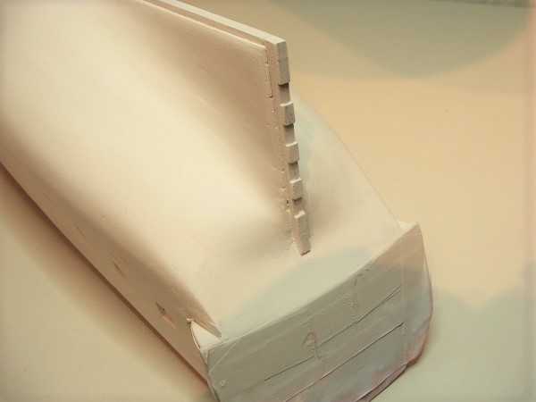

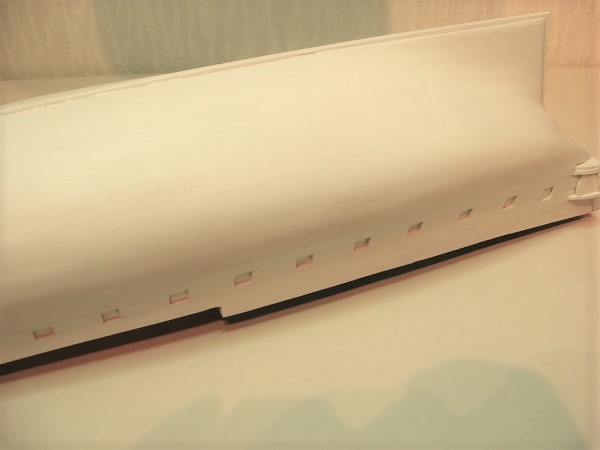

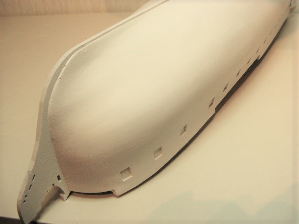

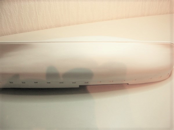

Moving on a little further, it was good to see the weather was kind for me today and allowed me to get the first primer coat on... Here is how she looks and you can see how time taken on the filling and sanding stage has really paid off.. Am please with how it turned out after the first coat with only a couple of minor blemishes to put right. This will be done tomorrow and with a little more luck with the weather I hope to get the second primer coat applied... Lots of painting to be done yet so until next time, happy building all....Cool Cool

That's really impressive for the first coat. All that work on filling and sanding has really paid off. Well done.

From what I can see...That's a real neat job Alan!! Blink Drool
#180 Posted : 30 November 2017 12:14:07
David/Jonny, thanks again for looking in and your comments, very much appreciated....Cool Cool .. Time and care on the filling and sanding is the only way to get good results, not something that should be rushed....Cool Cool .. Couple of small areas to put right then onto the second primer coat....
