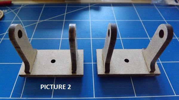

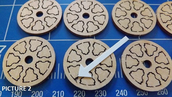

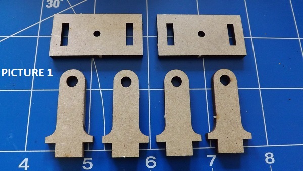

PICTURES 1 & 2

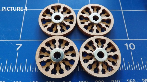

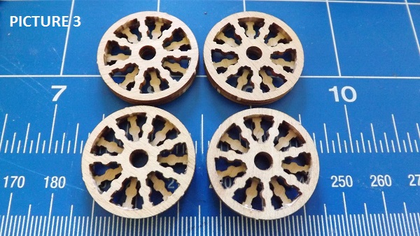

Here we make up the tender wheel units.
With these parts removed we have now used all of the laser cut components from the 2 wood frets that we started with.
The axles that will be used on these 2 units will be made from the wood dowel supplied in the kit which differs from the turned brass axles we get for the engine itself.
This may have something to do with the fact you can motorise this model and if so the motor unit fits under the tender in place of these two axle supports that we are making at present.

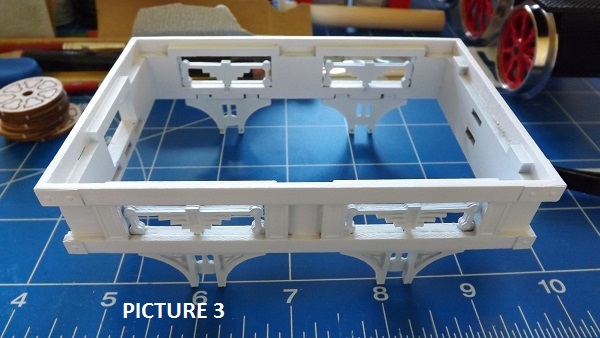

PICTURE 3
Now that the tender has seen all of the various component parts fitted in place it’s time to put down a layer of primer ready for another layer of red paint

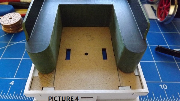

The deck of the tender has 2 anti-skid plates applied on the left and right with the centre section that will hold the “coal” being planked over.

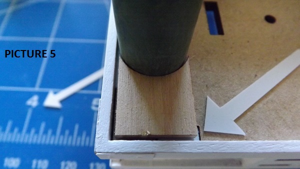

“PROCEED WITH CARE”
Here we can see one of the pre-cut sections that will form one of the anti-skid plates. Again we find fit problems here with the part having been cut smaller than required causing a gap on one side as well as the front.

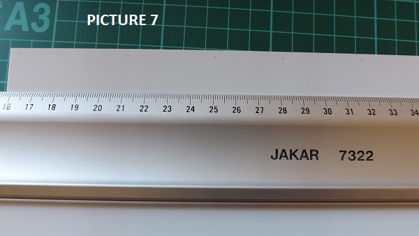

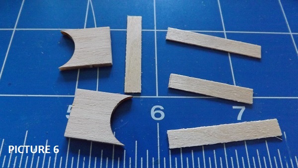

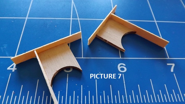

PICTURES 6 & 7
To resolve this issue, I have taken some scrap 0.5mm thick strip and glued this along one long edge and the front of each piece.
Makes little difference what it looks like at this stage as it will be trimmed later. It’s easier to do it with the wood oversize at this stage as it makes the gluing and handling easier to manage.

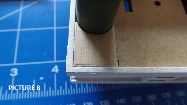

PICTURE 8
Once trimmed and rubbed down we end up with an almost perfect fit into the required location on the tender top.

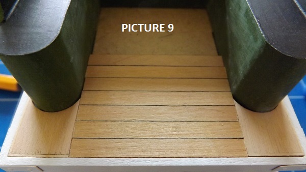

We can then start to plank the exposed surface of the tender.
I think I mentioned in an earlier post that my kit was short on the required wood for this section so again I had to resort to raiding the scraps box for some offcuts that could be used here.
For the first time ever in any build I have done I used the soft pencil technique along the edges of the planks to give the impression of plank separation.
Must admit to being quite pleased with how it looks.

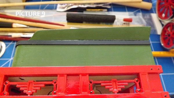

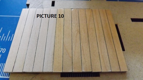

PICTURE 10
Once the area is planked and the glue allowed to dry properly I gave the planks a light rub over with some fine sand paper then used a matt varnish to seal the surface. Using a clear varnish does not alter the plank greatly but in this picture you can see the difference between the varnished and un-varnished area.

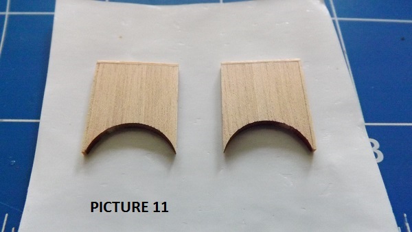

PICTURE 11
We now need to get the kit supplied mesh onto these 2 tread plates. As with the footplate on the engine I can say that glue is not an option as it fills the little spaces in the mesh.
So as before I have used some very strong double sided tape.

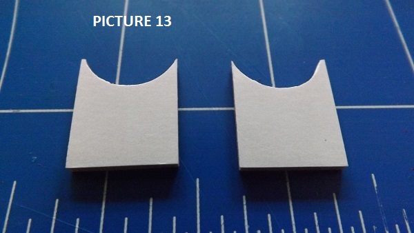

A nice sharp knife blade is then needed to trim away the excess tape from these 2 parts.

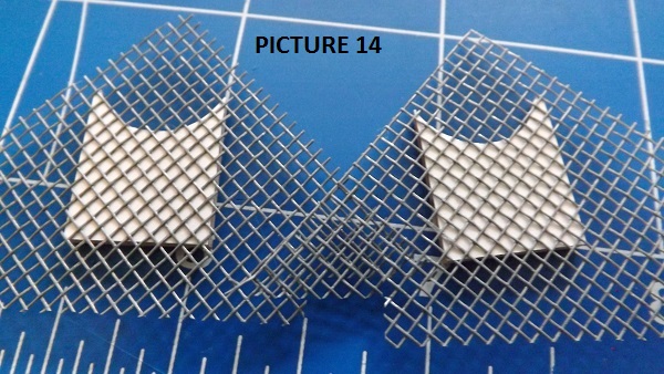

PICTURE 14
We then line up the plastic mess trying to keep some symmetry and press this into place on the tape. Again a quick run over with a roller or other heave object will ensure its properly held in place on the tape surface.

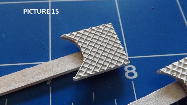

PICTURE 15
And the final part of the build for this evening was to give both parts a quick spray pf primer ready for the black top coat once the primer is properly dry.

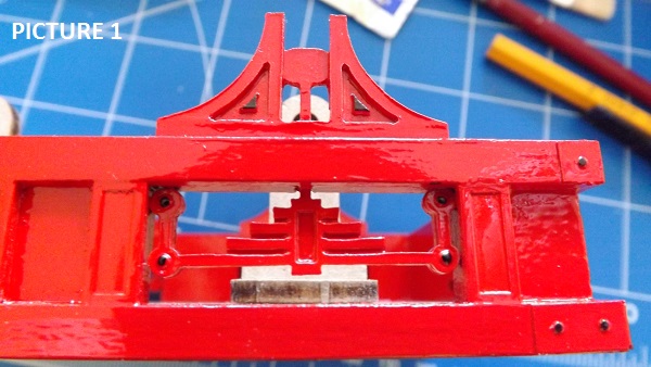

PICTURE 1
The lower part of the tender has now received its coat of Red paint.
Humbrol no 19 - Gloss Red is the choice here. To put a little more detail into this area I have again used a Sharpie Marker to touch in a few rivet heads.

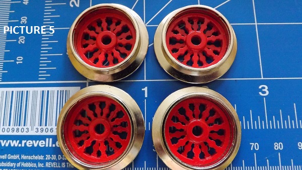

PICTURE 5
Here we can see the wheels after two coats of red paint. The wheel rims at this stage have not been fitted in place but I have added these just so you can see what the finished result will look like.

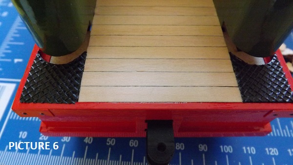

Having planked the tender deck area last week, we can now add the 2 anti-skid surfaces that again were made up last week.
Also in this picture you can see at the front of the tender the two brackets that form the tender to Loco coupling.

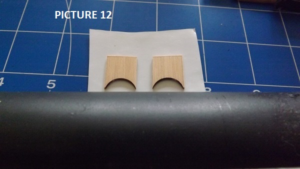

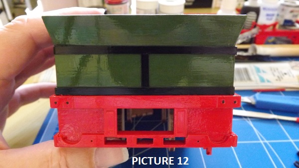

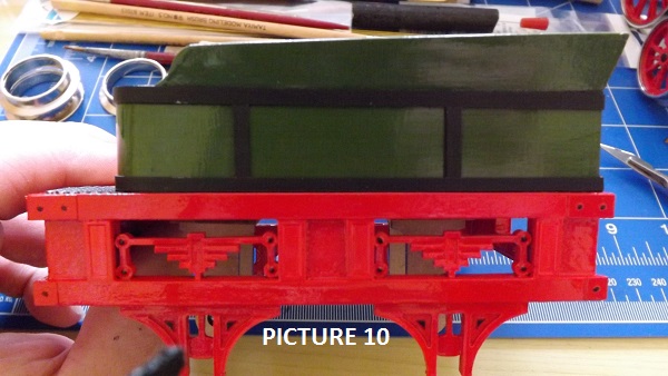

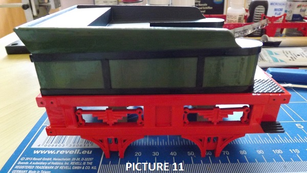

PICTURES 9, 10, 11 & 12
Using the longer strips ensured less joints to have to worry about and once in place they look fairly good.

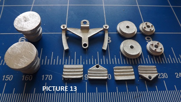

Still a number of cast parts to be added to the tender. This picture showing a selection of the parts that will be added.
Overall the cast parts are quite well made with just minor seams that need to be cleaned up.

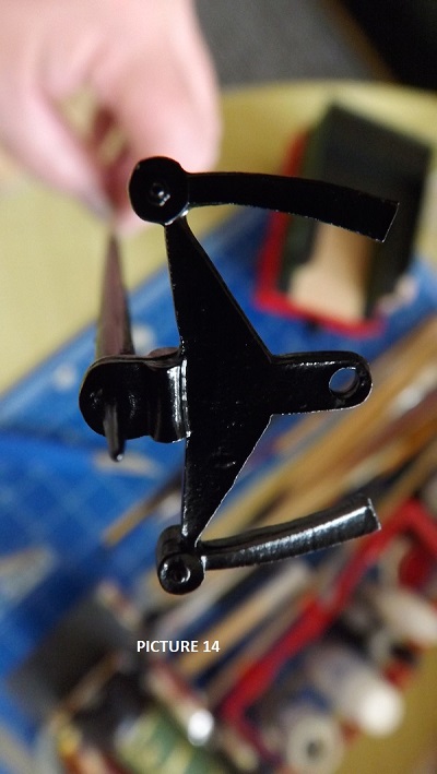

PICTURE 14
Being cast parts its best to prime them first before top coating. In this picture we can see the coupling that fits the rear of the tender.
PICTURE 15

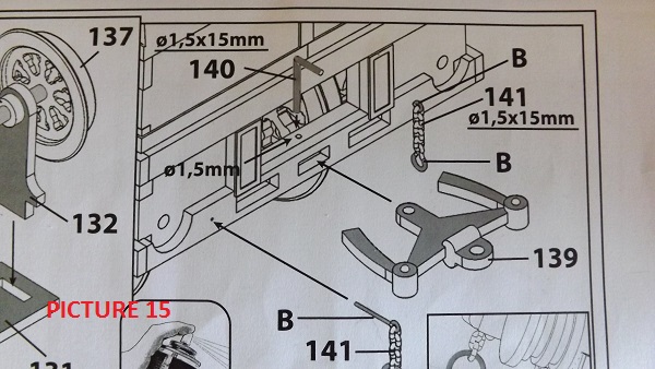

Some of the fittings are designed to be moveable and use brass rod as the fixing pins.
It’s important to look at the instructions to find out what size rod and what dimensions to use.
For the link pin required to fit the rear coupling the instructions show 1.5mm dia brass rod is required cut to 20mm long.

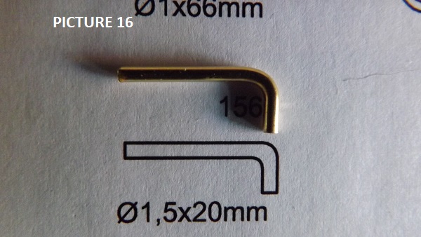

PICTURE 16
Within the instructions we get a template showing each of the brass rod shapes that you need to make.

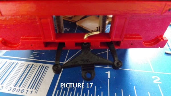

“PROCEED WITH CARE”

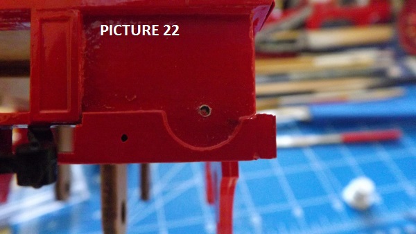

And here we have one of those “I could kick myself moments”. The location for the link pin that holds the rear coupling is pre-drilled in the kit components.
Unfortunately, when they pre-drilled this area they did not centre the hole and having fitted the rear coupling you can see its placed too far to the right rather than being centred.
It’s not an easy one to rectify. We could fill the existing holes but a new hole would have to be drilled right next to the filled one and that in itself could cause more problems than it solves.
This coupling does flex left and right so when the carriages are in place (a future part of my build) it should all be ok.

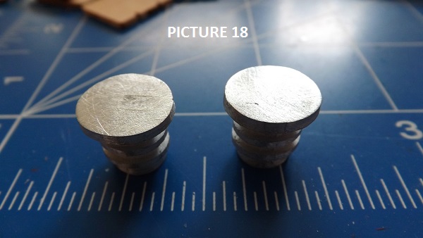

Here we have the rear buffer castings. Unlike the ones supplied for the front of the loco they do not have any cast in locating pins.
Now these parts are quite heavy and my feelings are that if glued directly to the tender we will reach a stage that they end up falling off.

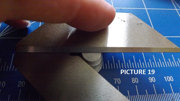

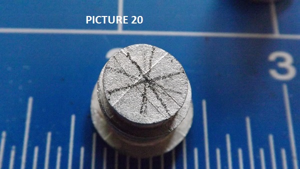

PICTURES 19 & 20
Here I am using a centring gauge to mark up the centres of the buffers so that they can be drilled ready to have a length of rod inserted before finally being glued in place. The rod will act as additional support for the parts.

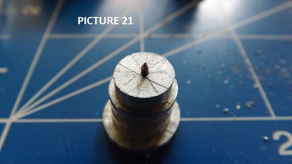

PICTURES 21 & 22
We need to drill the tender to accept the rod pegs. To ensure we get these spot on I have loose fitted into the hole drilled in the buffer the end of a drawing pin.
We can then press the buffer into place leaving a nice little mark in the tender that we can then use as the centre mark to drill ensuring that when the buffer is finally glued in place it will be perfectly aligned.

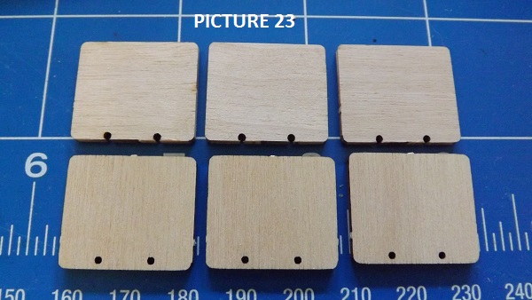

The final part of this week’s build update moves us onto the 3 covers that will be fitted to the tender top. The parts supplied with the kit I am using are at the top of this picture and as you can see each part has 2 holes pre-drilled to accept a brass handle you have to make.
With the parts supplied in this kit the holes were drilled incorrectly and pierce the edge of the panel.
Luckily I still have parts from the original version of this kit so I was able to exchange the parts from the old kit parts.
These are shown in the lower part of the picture and as you can see these have been correctly pre-drilled at the factory so its these 3 parts I will work on next.
