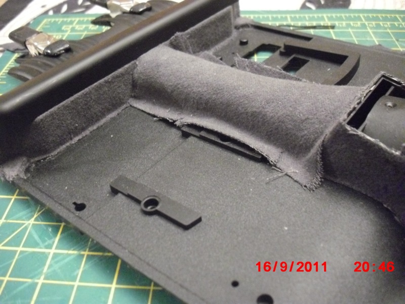

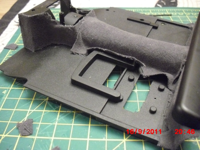

This is a continuation of Day 3, we carry on carpeting the Tunnel, It will not be trimmed untill tomorrow when the Adhesive has gone hard.:-
#162 Posted : 16 September 2011 22:08:35

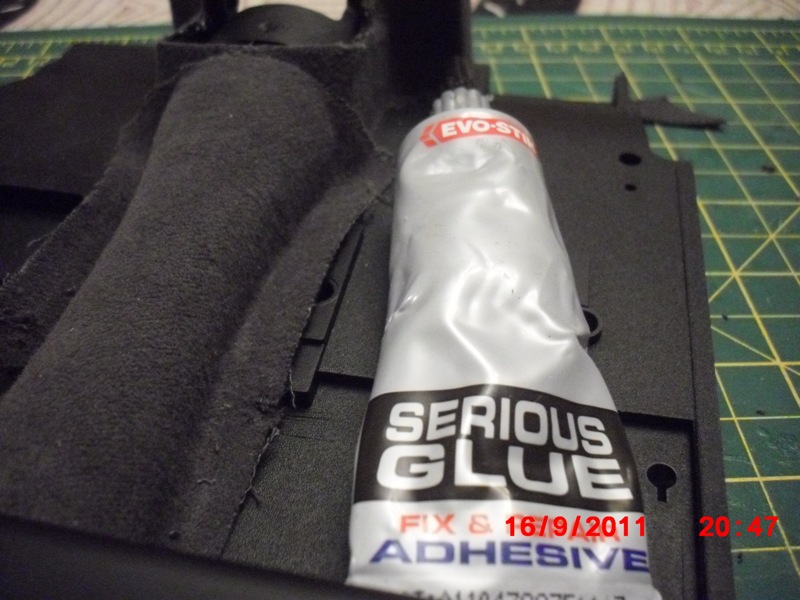

I am useing Evo Stick SERIOUS GLUE it is a solvent free contact adhesive, an as my wife is asthmatic, solvent free is a must.
I will use this to put the copper tiles on the Victory, it is great to use, with a good 3 mins to position the job:-
#163 Posted : 16 September 2011 22:11:30

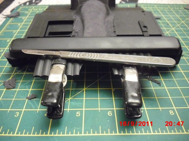

The model knife I am useing is a scalpel, Swan Morton in my opinion the best for this inticate work:-

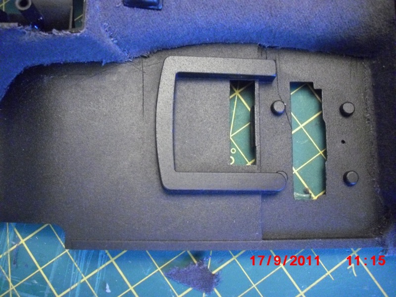

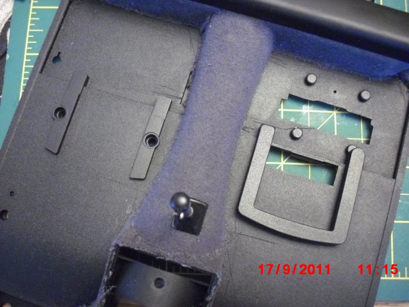

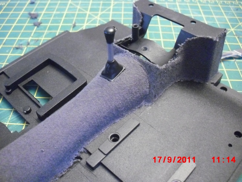

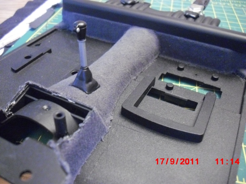

This is day 4 of carpeting the DB5, the tunnel has now been trimmed.
I have placed the gear lever in position (not fixed) just to give a reference point :-

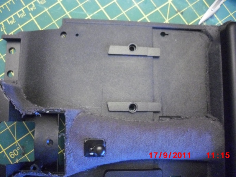

Carpet looks blue but is def grey.
The next area`s are the two sides of the that rae left:-

Hi Spencer,Scot and Sean, thanks for your comments.
Yes Sean I did use the Jacket as my final choice, I will use the dolls house carpet for the head lining, and maybe the glove box and boot.
Well we are still on day 4 and I did say it would take approx 1 week so I am on schedule.

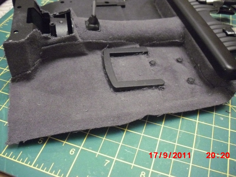

Here is a photo of the passenger well carpeted, please note it still has to be trimmed and and finished :-

Hi Jerry, I apply the glue and fit the fabric straight onto the wet glue, I have approx 3 mins to adjust the fabic, within 2 hours it is set and a further 22 hours it is hard.There is no leaking through the fabric.

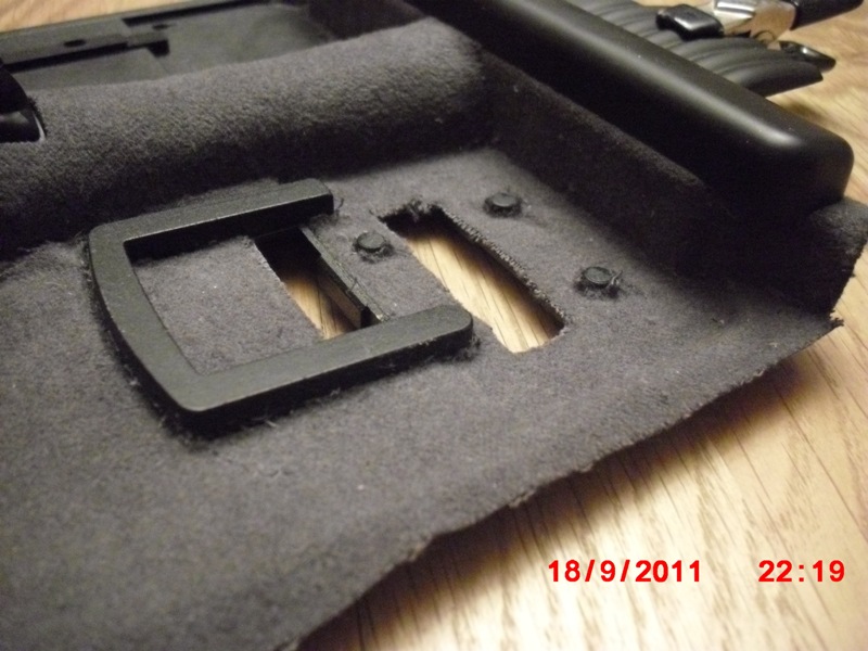

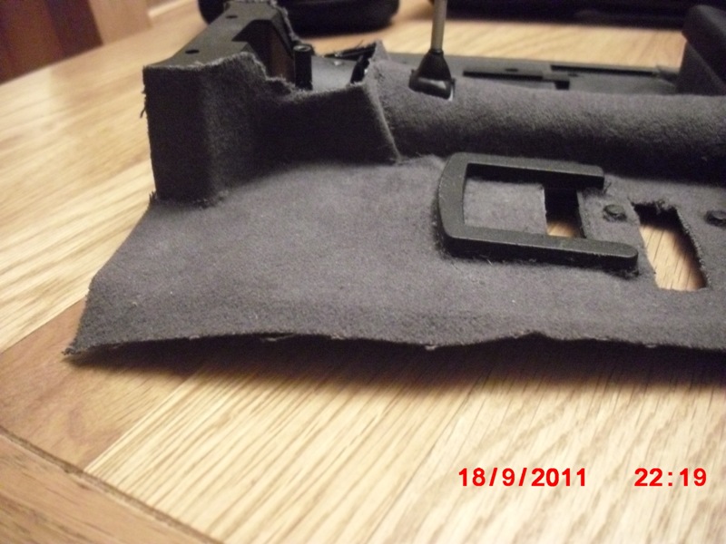

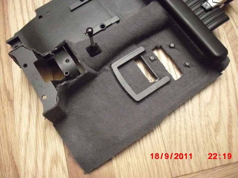

Well this is day 5,and the passenger front and rear well is complete hope you like the effect :-
#179 Posted : 18 September 2011 23:32:53
Last part to do is the Drivers side front and rear foot well, see you laterCool
