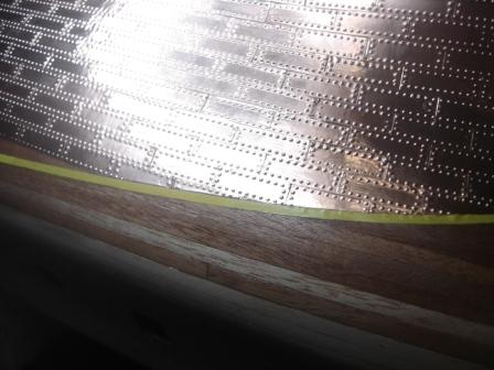

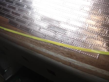

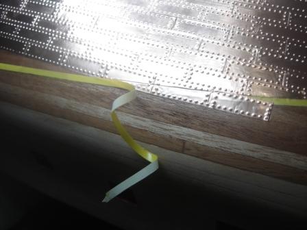

Thank you gentlemen for all your comments, only about 4 rows of tiles left to do on the starboard side I'm leaving the keel and stem post until I've finished the port side. The copper strip goes on really easy just at the stern at about row 9 need to cut single tiles to get the curvature right. Cutting the tiles at the waterline was another challenge but easily overcome, I had used 3mm tape to mark the waterline so all I did was apply a piece of tape over the top on the tiles which gave me the cut line....here's a couple of pics..may need your sunglasses.
Here's the tape in place..
Remove the tape after cutting..
I'll give the whole thing a wipe with some rubbing alcohol when finished to remove fingerprints and stuff then wait for some copper oxide to take the shine off, anyone know how long this reaction takes ????

#174 Posted : 11 September 2016 21:48:44
Great job Barry
Some very useful tips included, well done.

Coming along very nicely the copper tiles look bril and the tape tip is one I will use

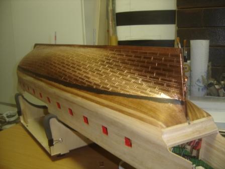

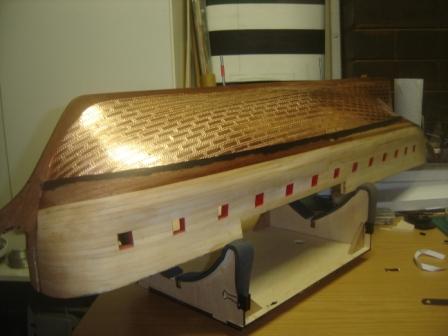

Thank's again gents, been a little under the weather with a chest infection for the past few days Crying but managed to get the starboard side plating finished and put on a thin stripe of black paint at the waterline BigGrin
