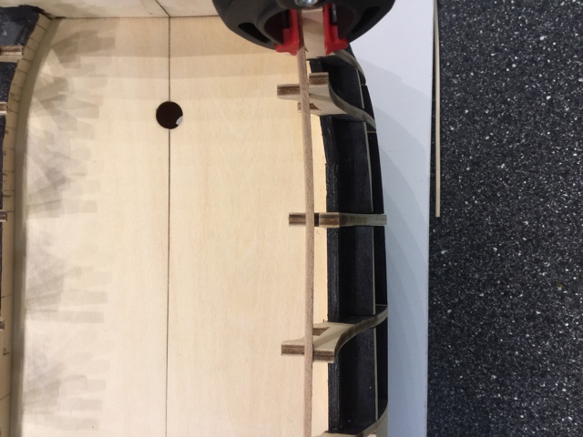

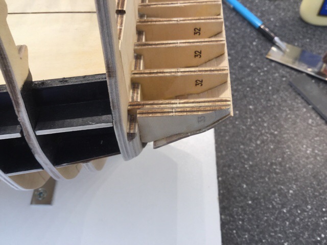

Here are some pictures and a few questions.

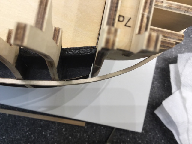

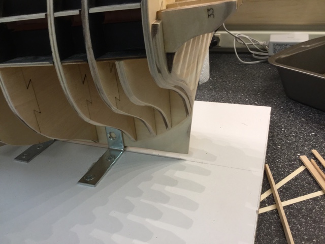

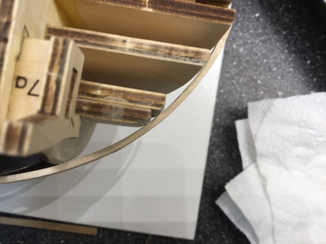

At the bow (see the two bow shots) the planks have a really nice curve and appear the right shape but stand slightly off of the forward former. Should I build up this former or have I got the shape a bit wrong and should I sand down bow formers 11A more? Right now the curve is very round.
At the stern, the transom is nice and even with the stem of the keel. Should the edges of the transom be completely rounded or is the little bit of step on the edges acceptable?
A few of the arms of the frames seem to have a little more spread than others and I'll need to sand them down. I imagine that later I will have to slightly build up the frames inside the bulwarks.
A very few of the frames were a bit shy and I built them up slightly and will sand them back down. These same ones look klike they will need to be taken down slightly inside the bulwarks.
As usual gents your advice is always appreciated.

Unfortunately I am no expert with these plank on frame ships, infact I am only just starting my first ever one. After looking at your pictures though to me it looks like those two formers in picture 2 over been faired a little to much, the way I understand it is that the planks should be sitting flush to the whole former.
Im sure someone with a bit ore knoweledge than me on this will be along soon.

Dave,
Thanks for the quick response and Happy Father's Day to you, father or not.
It actually sits perfectly against the two formers in the second picture. My concern is with the main frame to which those formers attach (shown rather poorly in the first pic I'm afraid). It misses that by about 2-3mm.
Dominick

I see what you mean now, after looking at it again now I can see the gap you mention. Im sorry to say I am a bit too in-experienced to help with this one Sad .

You have done a great job on the fairing overall although as you point out a little too much may have been taken off the former at the bow its an easy mistake to make as fairing is an art in itself. I think it should be ok as it is here.
The transom will need to be taken back a bit more if you compare yours as it is now with the pictures on the official build you will see whats needed here.
I would not worry too much about the frame arms right now as they will be pulled into there correct position as the planking and decks are added.

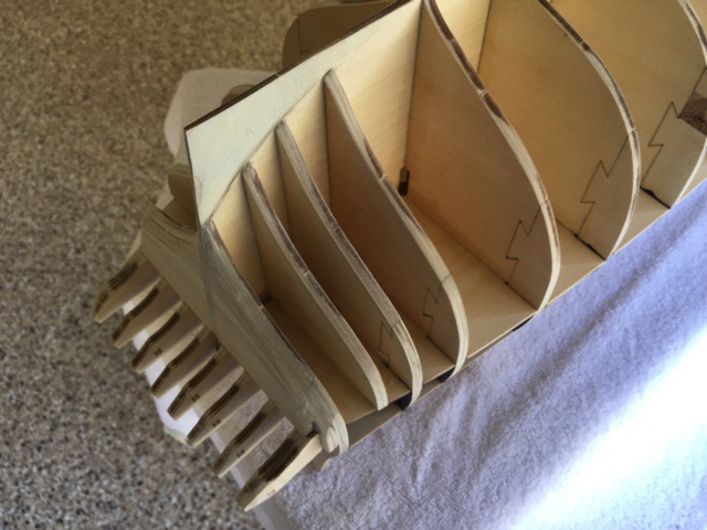

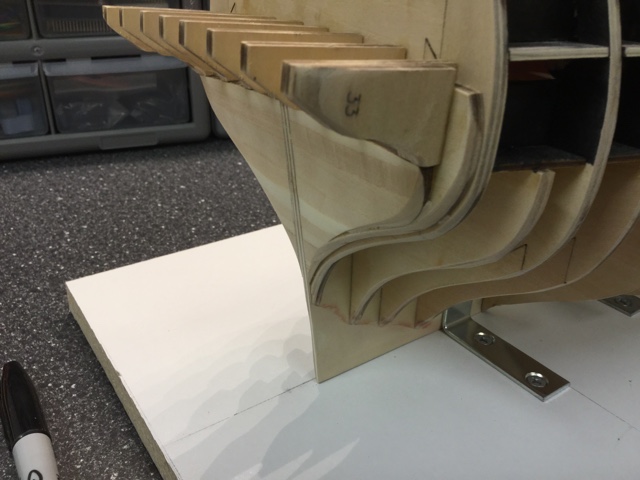

I sanded the stern a bit more. I think it looks a lot like the pictures in the build log.
What do the more experienced members think? Did I get it right? I plan to plank the underside of the transom this week to complete month 2. Perfect timing since I got an email letting me know that month 3 shipped today. BigGrin

Hi Dominick, looks to me like you have the stern just about spot on now.. Well done, look forward to seeing your progress with the planking.. Cool Cool
#170 Posted : 23 June 2015 08:08:44
BigGrin The hull looks spot on Dominick lovely work Cool
#171 Posted : 23 June 2015 15:13:37
Hi Dominick.
Fairing is probably the trickiest part. job done look forward to seeing some planking from you. keep up the good work IanCool BigGrin

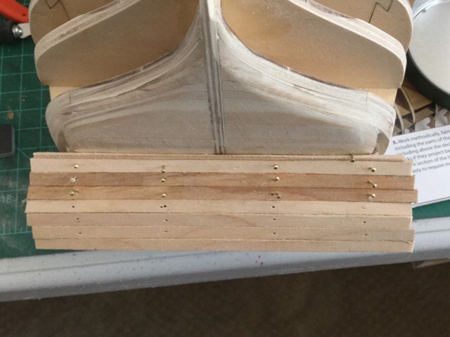

Finished planking the underside of the transom supports. The last plank was pretty narrow but closed it up fairly nice.
And, month 3 arrived yesterday so planking the hull starts tomorrow

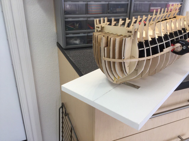

Getting ready to plank.
DSoldano attached the following image(s):

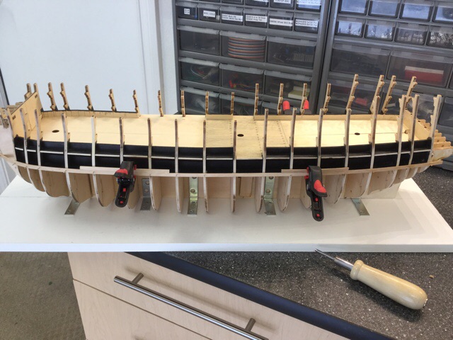

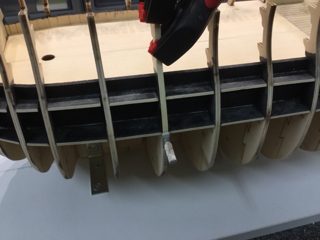

Here's the first of the planks applied. Exciting stuff - well, for me anyway. It was a little tricky to line it up flush with the bottom of the gun deck and then pin it. A third hand would have helped immensely. In retrospect I should have clamped a few scraps to the bottom of the lower gun deck to act as a guide rather than using the "run a finger over it test". All in all it came out fine though.
The clamps and plank scraps are to make sure the planks line up perfectly at their joins so the next course lays in perfectly.
