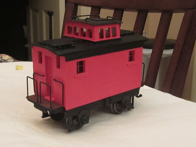

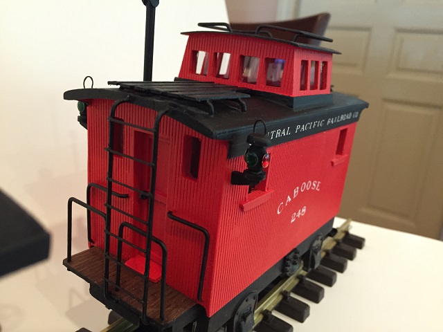

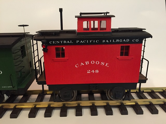

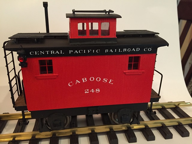

#165 Posted : 01 October 2015 05:59:22

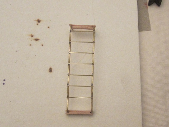

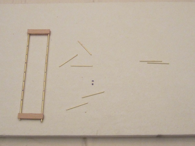

The caboose is now painted and it is time for the final details.The next step is the access ladders that are at the front and rear of the train.I made these with brass rods and superglue.I tried soldering but the rungs of the ladder kept melting.

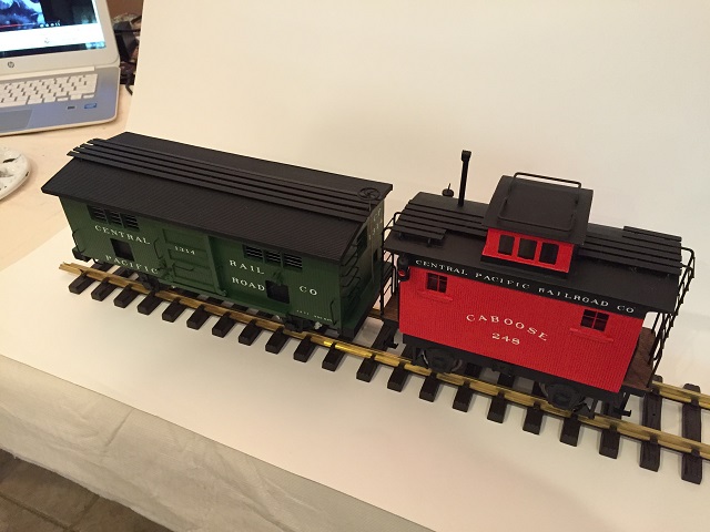

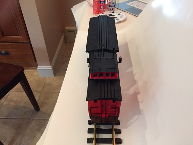

#171 Posted : 05 October 2015 03:25:06

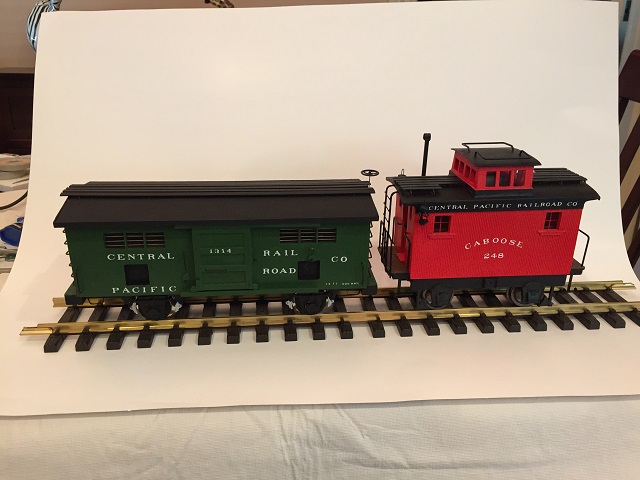

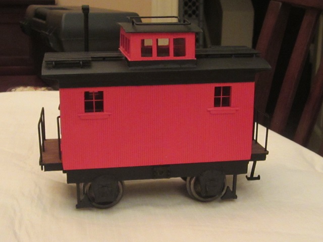

Thanks everyone.The caboose and boxcar are finished except for the link and pin couplers.

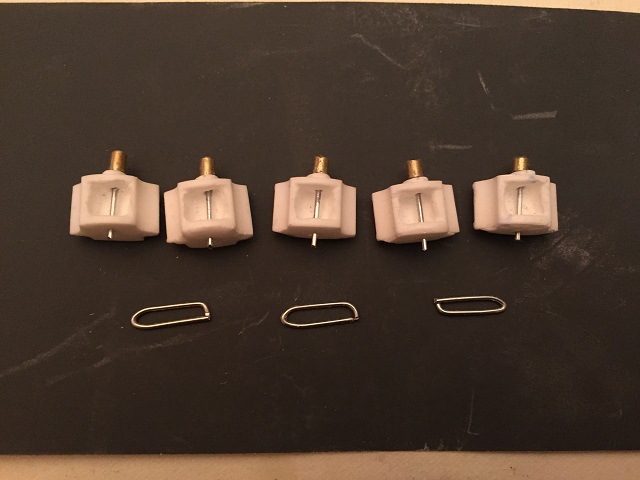

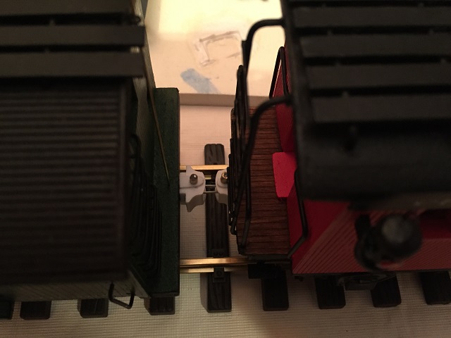

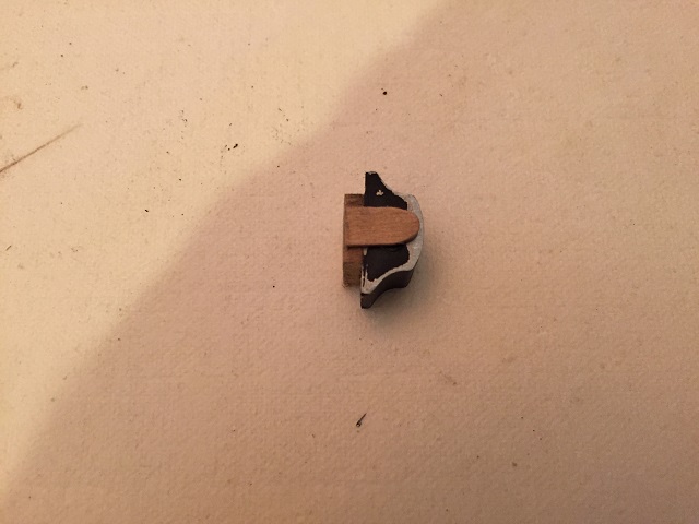

#175 Posted : 09 October 2015 19:43:07

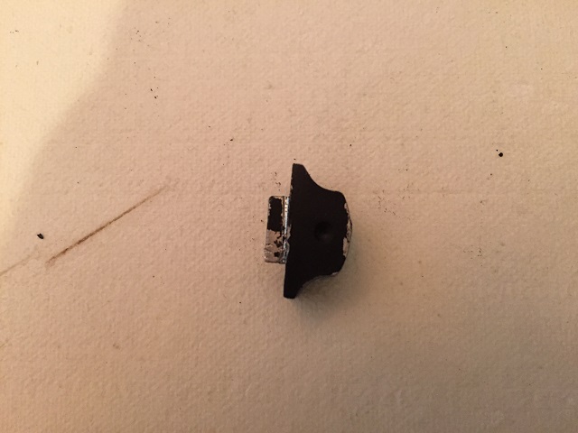

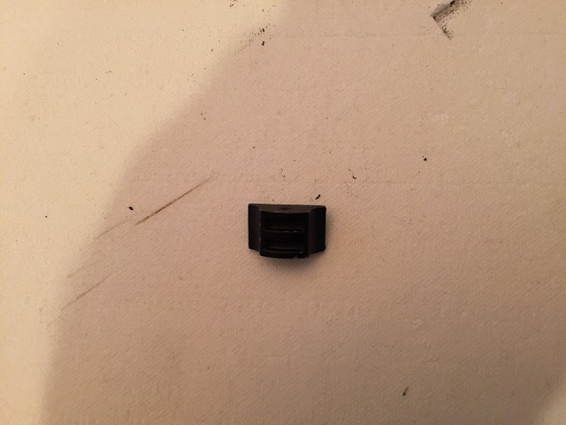

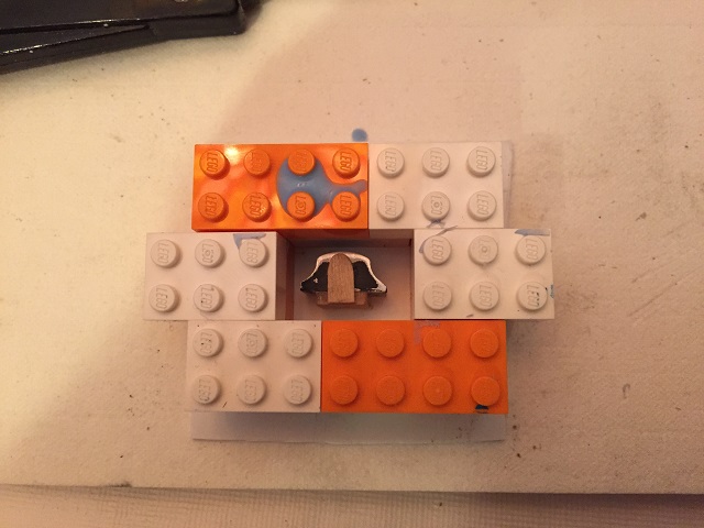

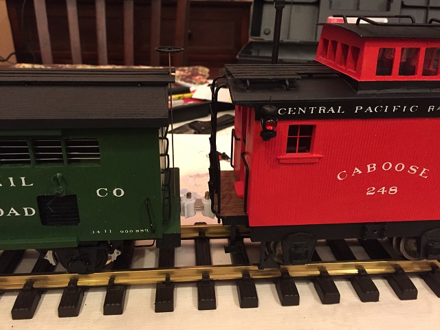

The final part of the boxcar and caboose-------the couplers!!!!
I previously linked a youtube video showing the link and pin couplers that were used in the early days of the CPRR.These were extremely hazardous to work for the engineers and were soon replaced by the automatic couplers that activated once the 2 ends were shunted together.
The couplers that came with the boxcar were not right.THe coupler that were on the Bachmann caboose that I kitbashed to make my caboose were also the later automatic type.

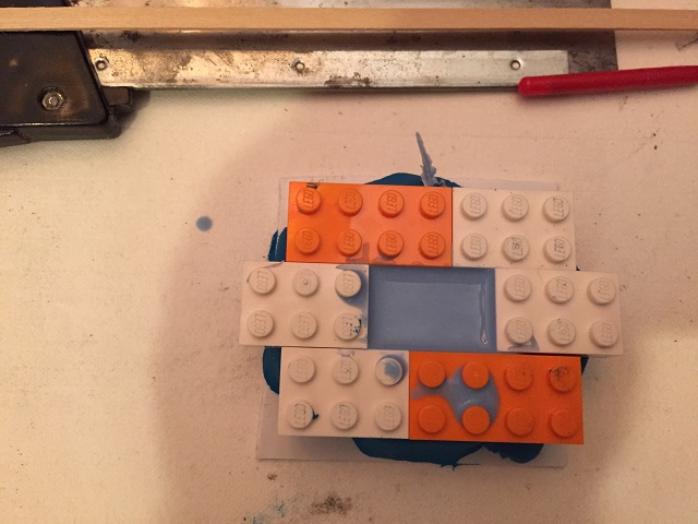

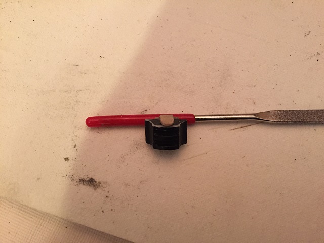

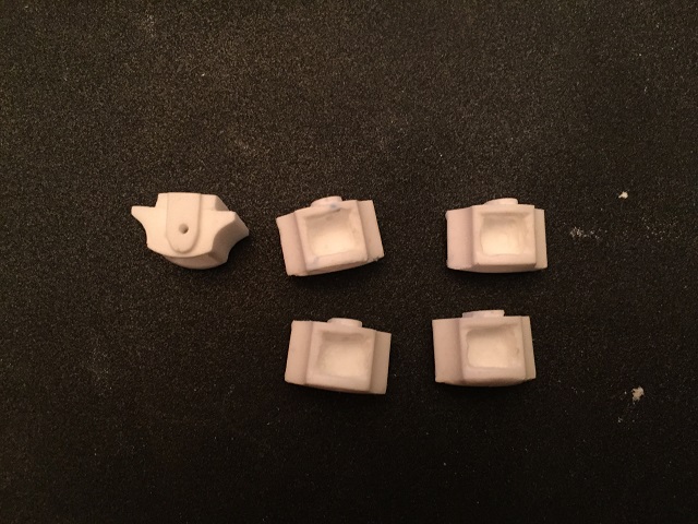

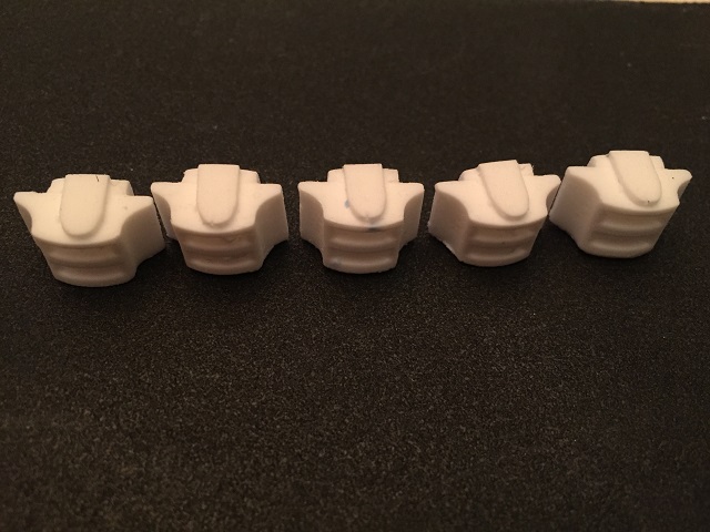

So I ended up using the coupler that came with the Jupiter kit.This was a bit like the link and pin type.I needed 5 of these to attach the boxcar to the tender and the boxcar to the caboose and I only had 1 so I decided to modify the Jupiter part to make it more accurate and then make a rubber mold and cast the 5 couplers I needed in resin.
Once the parts were molded I used a dremel with a bur to hollow out the inside of the coupler.I made pins with pieces of steel cut from paper clips and I made the 3 links needed to join the couplers.I use brass tubing to make the heads of the pins.
The final pics show the link and pin couplers installed between the boxcar and caboose.These are fully functional-You can remove the pins to separate the rolling stock.THey now just need to be painted and then the next step is to finish the tender (now I have the decals I need-Thanks again to Gil Shapley who generously sent me the extras he had).
