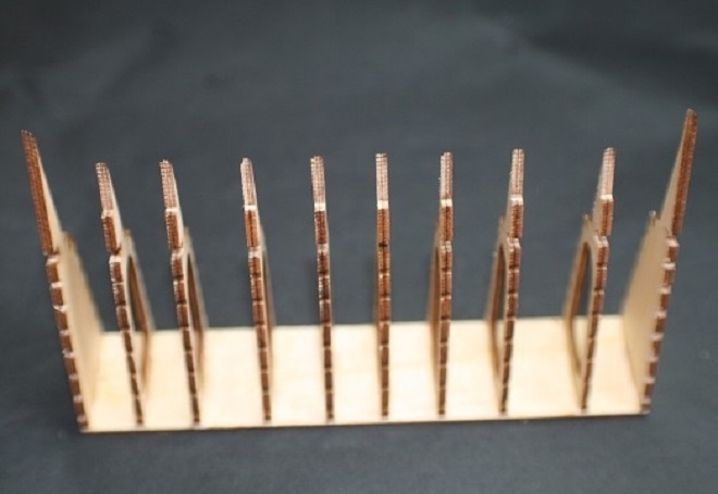

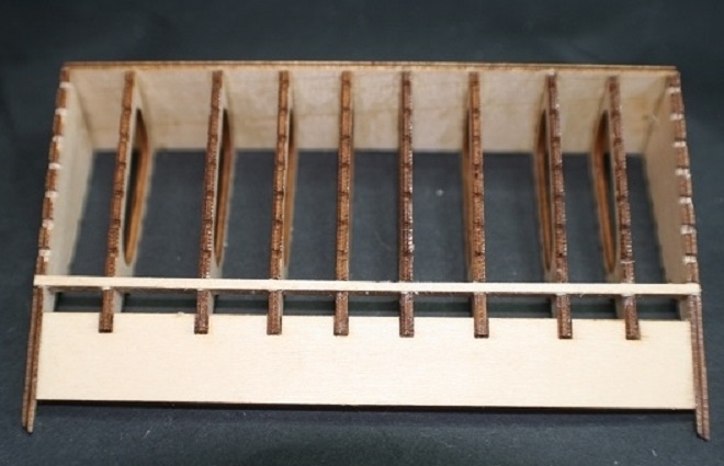

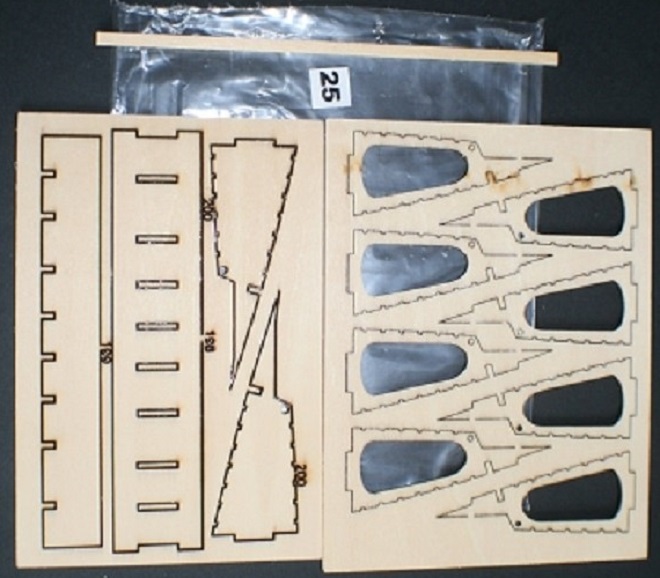

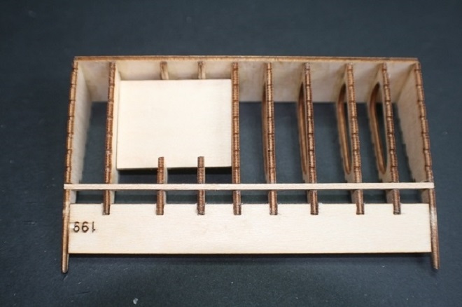

So here`s the parts for the port side.Pic 1
First thing to notice is that the orientation of part 198 is crucial.
The slots for the ribs are not all equally set apart.
The instructions start with the addition of an end rib.

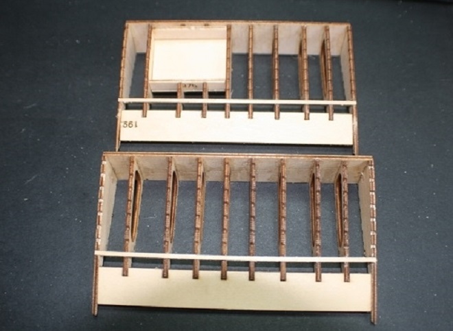

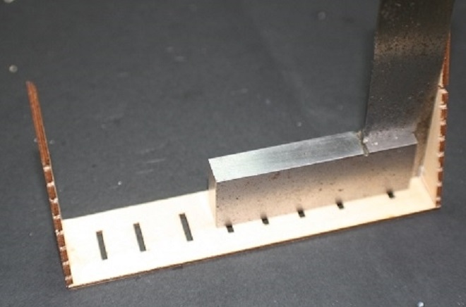

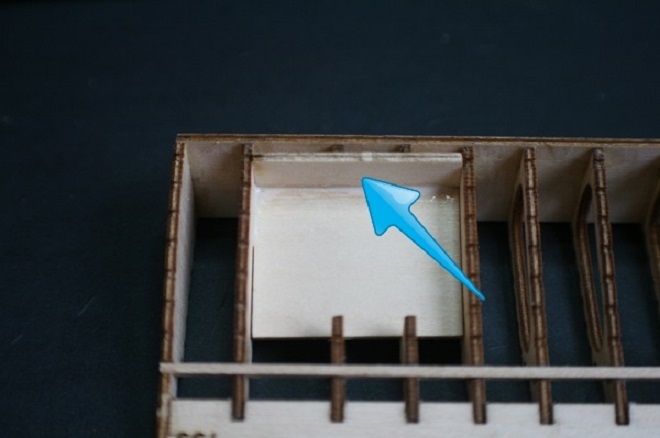

This MUST be set at 90 degrees to the back plate, as these sections will eventually be fitted between other parts with limited space at each end.Pic 2
The instructions tell you then to fit the rest of the centre ribs in a sequential order and check they are all set at 90 degrees.
I chose to set the opposite end rib first. Also at 90 degrees.Pic 3

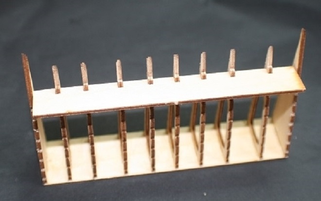

My preference now is to glue and fit all the centre ribs at the same time and then using part 199 as a spacing template to get all the ribs to set at the same time. They are also then guaranteed to be set correctly when the trailing edge plate is put in place.
Having cut out and cleaned up the edges of the centre ribs, glue and fit them in turn to achieve this result.Pic 4

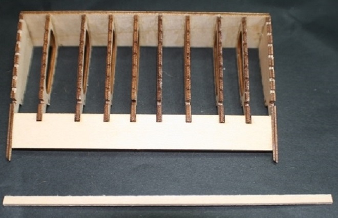

When all the ribs are in place take part 199 and without glue hold the centre ribs in place as follows.Pic 5
I use a quick grab Aliphatic glue for the ply parts of this build and I still had enough time to get these parts set in place before the glue dried fully.
If you use the instructions method you will have ten setting and drying times to obtain the same result I achieved in three. That said you must work with what you are most comfortable with.

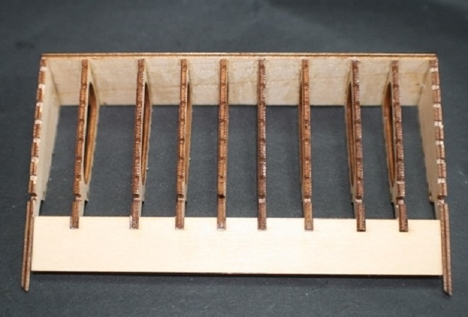

With the ribs set in place and dried, it`s time to fit the trailing edge plate that I used as a template.
I applied glue to the eight centre ribs where the plate is laid on them and allowed it to set. The two outer ribs still have a little bit of flex in them to allow them to be moved outwards slightly so you can apply glue between the outer ribs and the ends of the trailing plate.Pic 6
The last part to be added is a centre spar.Pic 7
Apply glue to each of the slots the spar will sit in and place it with one end square to an outer rib, then allow to set.
When set trim and sand the overhanging end of the spar to achieve this.Pic 8

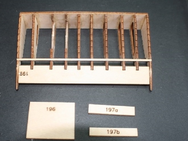

Here`s the parts.Pic 9
When the frame is constructed as before you get this result.Pic 10

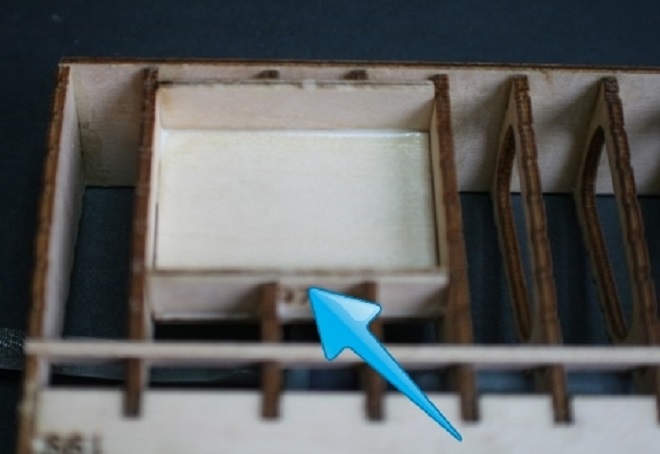

Part 196 is now added to start the life raft box. Apply glue to the ribs it will sit on and hold in place.Pic 11
Two more parts are now added to complete the box section, but NOTE they are different sizes.(Only slight but they are different).
Fit part 197a toward the back of the box looking from the thin edge of the part being built.Pic 12
Now fit part 197b to complete the box section.Pic 13

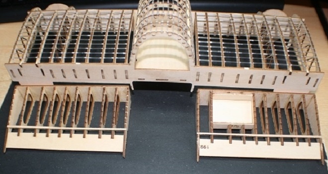

So, that done here`s where I`m up to.
These two sections are identical in size, it`s the camera angle that makes them look different.Pic 14
Finally, this last picture gives you an indication as to where these parts will finally fit.Pic 15

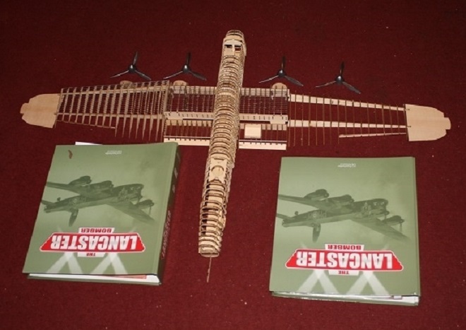

I have actually built the basics of the second outer wing section and to that end, as it`s just a mirror of the first outer wing section I`ll put up a couple of total build pictures.
The wing tips are just laid in place as not constructed yet and the props laid in place for effect.Pics 1+2
Still got the rear gunner section to finish along with the tail section, to give the full realisation of it`s length, but that`s where I`m at.
