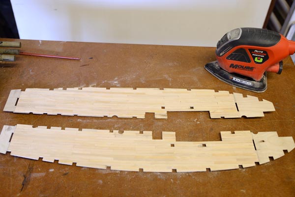

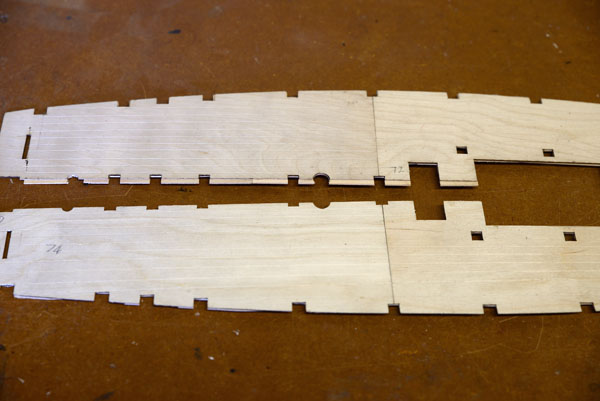

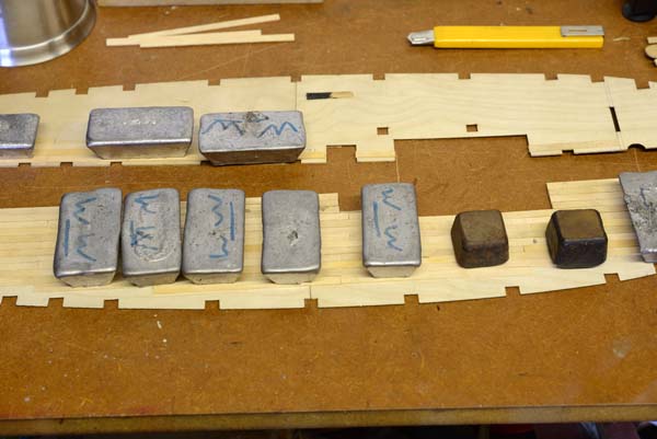

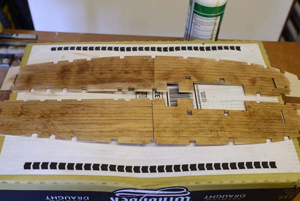

Hi All,

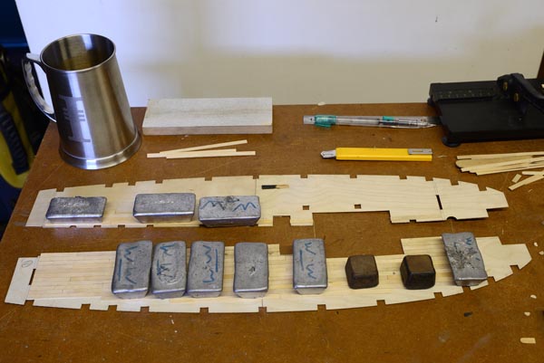

Back to some actual modeling again. I'm glad to be done with the fiddly bits.

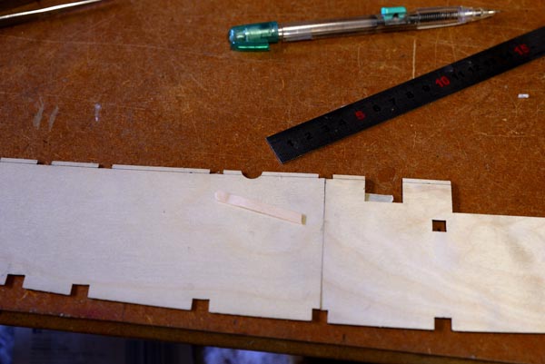

I found it easier planking the second deck off the job. I kept it in two halves, running down the centre line if the ship. I measured the coffee stirrer and halved the dimension and drew a line along the deck. My intension is that the coffee stirrer will overlap the other half of the deck part hiding the seam.
Before a started the planking, I taped the decks together and made sure that they fitted comfortably.
I laid the centre plank first taking care of its position. Once it dried I laid the remaining planks. I planked over the smaller openings and will cut them out once dry.

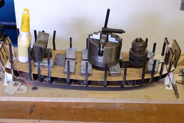

A couple more test fits as I approached the slots for the bulkheads and eventually everything fitted snugly.
Once the coffee stirrers were dry, I flipped the deck and scribed some lines on the underside. This will resemble the underside of the deck. I’m not sure how much will be visible though.
kind regards,
garth

#165 Posted : 12 February 2018 10:02:37
Hi All,

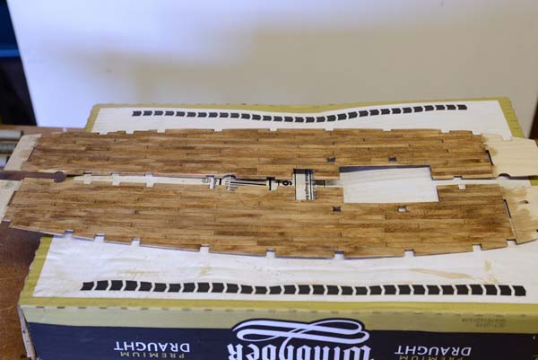

I Stained deck using Light Oak wood stain. I like the alcohol-based stains as they dry pretty fast.
Once all was dry, I fitted the deck to the ribs. Fortunately, the deck has been in and out a couple of times and is a fairly loos fit. This is important, should the components be forced, they may move some parts out of alignment and end up with a warped model.Cursing

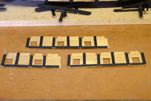

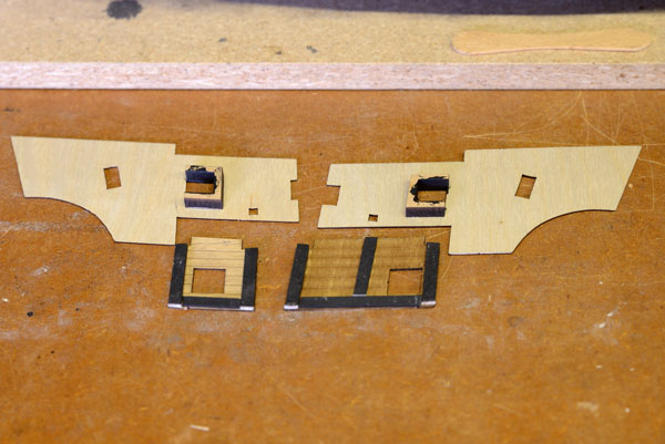

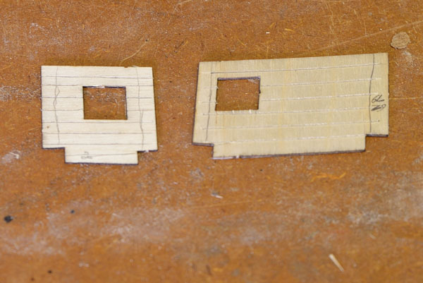

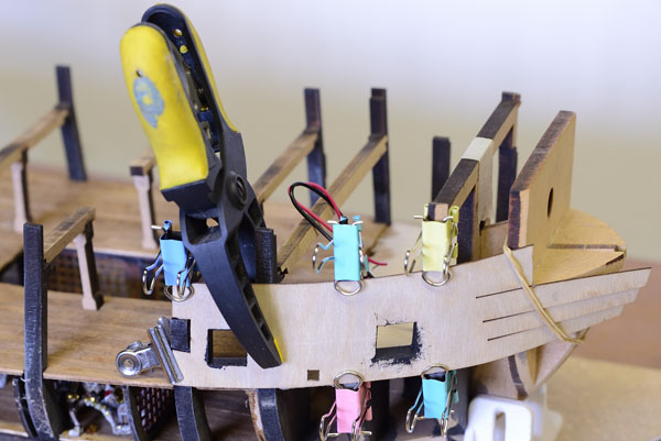

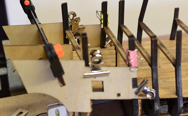

Hi All,

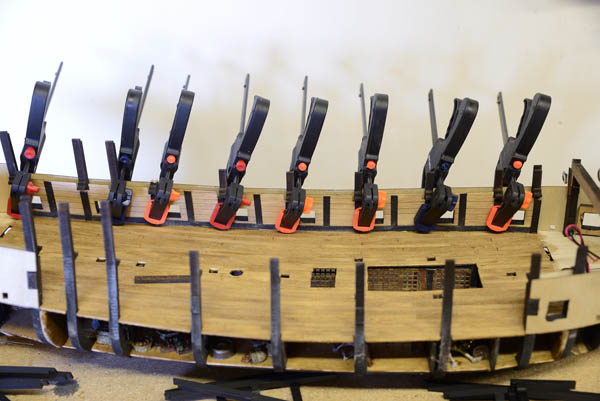

Started Starboard side panels. I fitted the external panels as per the instructions, but the internal panels are devoid of any detail.
Following an old Pearl blog, (Thank you Swordfish Fairey) I liked the offset between the black and Light oak colour of the internal wall sections.
To achieve this, I scored lines to represent planking, darkened them using a B4 pencil & stained using Light Oak wood stain. Coffee stirrers to the rescue again. I painted them and some left-over Victory planking black to resemble the internal structure and glued them to the scored piece.
#169 Posted : 16 February 2018 12:11:52
Hi Garth,
Read your post today. When you mentioned 'coffee stirer' i was so intrigued that i read your whole build diary! What a great idea, and loving your build, and colour of your deck.
Keep up the good work.
Gray
#170 Posted : 16 February 2018 14:36:50
Looks great Garth, doing a great job.
Chris Cool
#171 Posted : 16 February 2018 15:45:17
Really coming along great Garth BigGrin regards PhilCool
#172 Posted : 16 February 2018 23:45:00
Nicely done Garth and some nice tips too.....Cool Cool

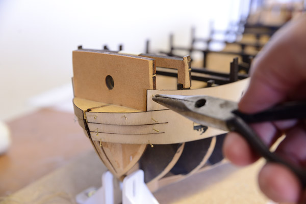

Fitted the Port side panels. Applied the same treatment as with the Starboard side panels.

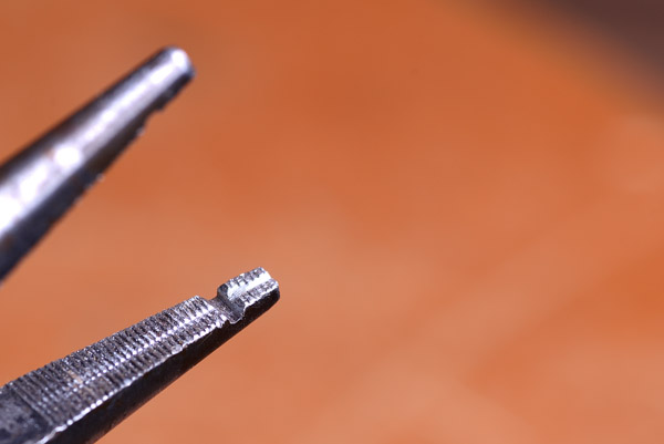

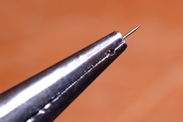

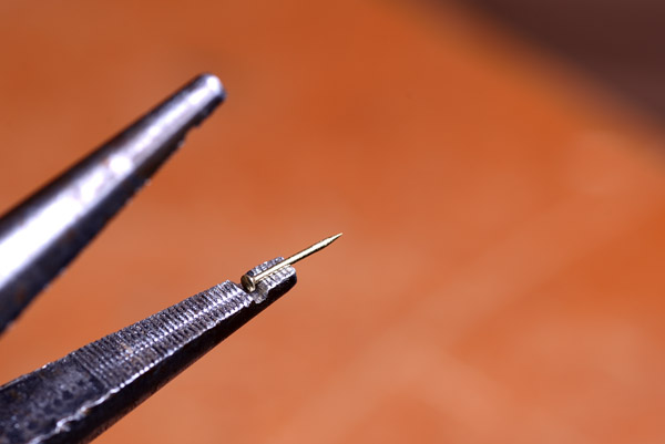

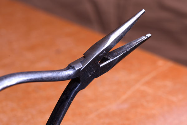

I have a commercial nailer, but it never seems to hold the pin properly. To rectify this, I made this nailer after I completed my Victory planking. The pliers just seem to give so much more control.
I have posted these pics in my HMS Victory build blog, but I will post them again here.
I cut a slot into both jaws of an old pair of long nose pliers to accommodate the pin head and filed a grove down the middle. No more twisting/rotating pins!!! BigGrin
Since posting that, I have learned that model railroad suppliers sell the exact pliers - with slots milled in for pinning model railroad tracks.
