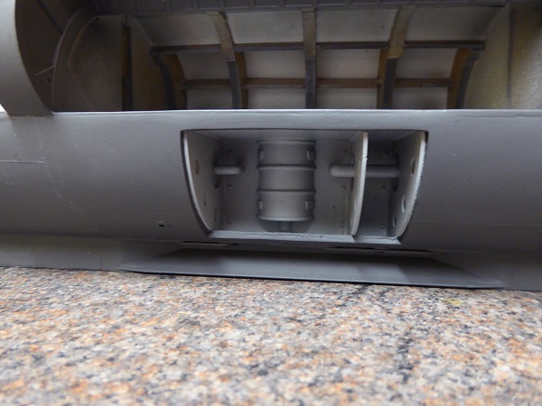

This weeks update of my U230 U-boat build log sees the completion of painting the compartments!BigGrin
The attached photo shows the Aft Torpedo Compartment. I had to touch in with matt white around the central support which will eventually house the aft torpedo tube.
#1590 Posted : 14 December 2017 21:48:28

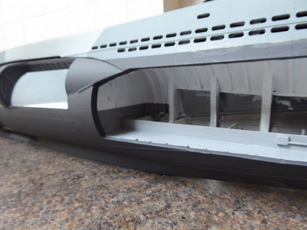

Motor Room. This area will house the main motors which drive the propeller shafts. The main motors are electrically driven, power provided via the batteries. To control the electrical supply there would of been two distribution boards, port and starboard. I will model the port side only to reveal more detail.
#1591 Posted : 14 December 2017 21:50:32

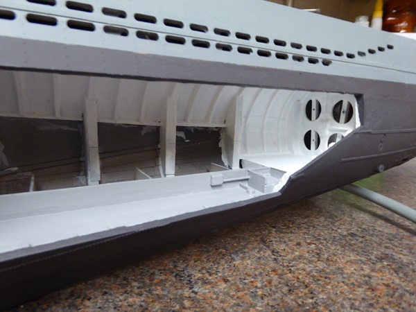

Engine Room looking aft. I will build the two engines and ancillaries as per the part-works instructions, then make a call if this space requires further detailing.
#1592 Posted : 14 December 2017 21:51:44
Engine Room looking forward.
#1593 Posted : 14 December 2017 21:55:48

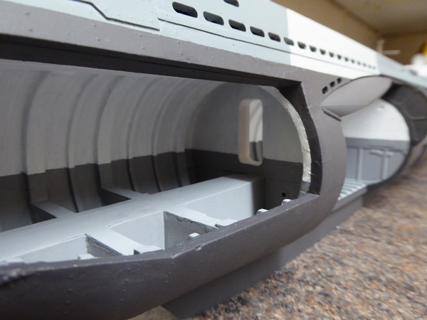

No2. Battery Compartment. This section is a cut-out rather than a full length view, due to the fact that on each side of it lies 12mm thick MDF supports, fixed during the early stages of this build. I will scratch build several rows of batteries connected by copper wire at a later date.
#1594 Posted : 14 December 2017 22:00:46

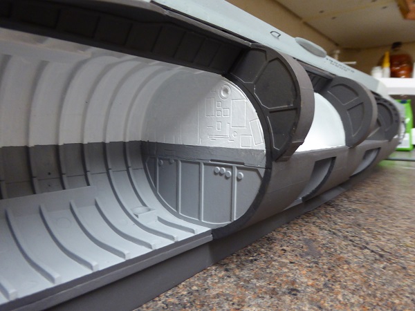

No.3 MBT [Main Ballast Tank]. This tank was constantly in use, either empty when the boat was surface running, or full when dived. Within it lies the search periscope housing and mast well. I'm thinking I might add a few touches of rust around the housing when i come to weather this section as it would of spent some time empty, possibly rusting, before being filled again when the boat dived.
Above it, the Control Room. This will be painted at a later date when I add the part-works supplied pressure hull sections. These sections have lots of kit supplied details to go on first and as per the Engine Room, I will make a call if further detailing is required.
#1595 Posted : 14 December 2017 22:04:31

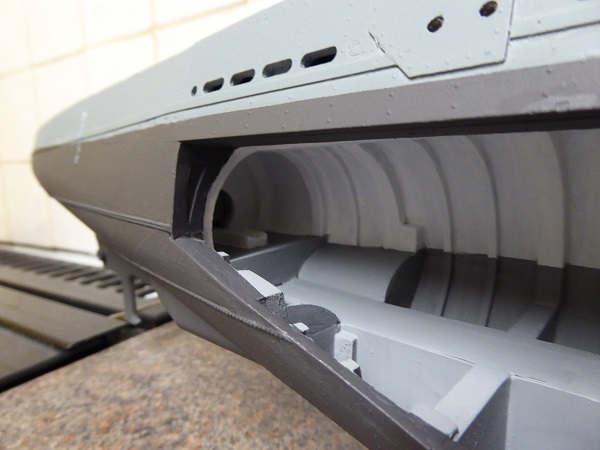

Forward Torpedo Compartment looking aft. Some of the MDF on the inside I have left unpainted as it will eventually be fitted with bunks and lockers. It also means I use less paint and I've been firing through the stuff lately.Blink
#1596 Posted : 14 December 2017 22:06:22
Forward Torpedo Compartment looking towards the bow. This area will get totally transformed, what with all the pipes and valves connecting the different systems to the torpedo tubes.
#1597 Posted : 14 December 2017 22:09:40

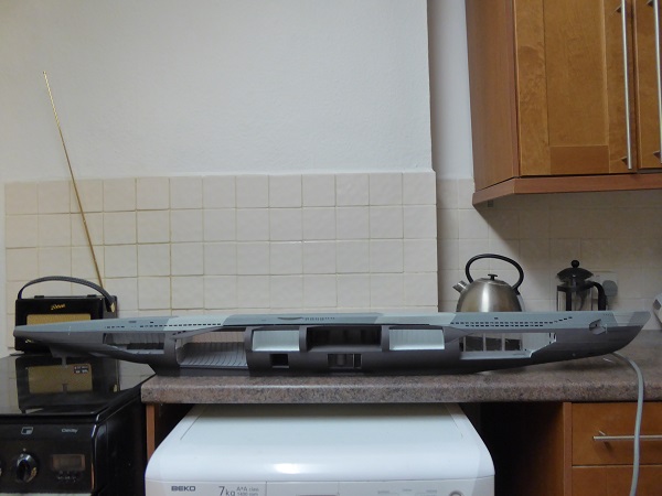

Complete side view with obligatory washing machine, cooker, kettle and radio.LOL As I start to progress with the detailing, I promise [ahem] to take all photos with a white background to avoid distraction.Blushing
#1598 Posted : 14 December 2017 22:25:55

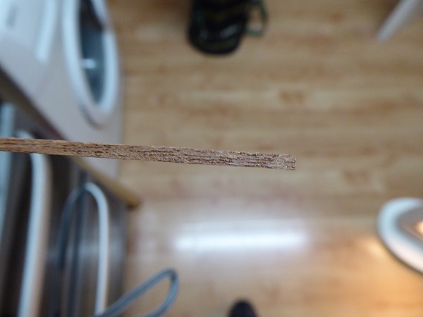

I have yet to paint the top of the U-boat hull [casing] which includes the hatches, capstan and eventually the conning tower. The reason is that I want to lay the wooden planking first.
The real U-boats used mahogany planking as it was cheaper to replace a single plank if it was damaged, rather than if fitted with a steel deck. The wood also proved favourable over a steel deck in icy conditions, as the gaps between planks allowed for drainage.
I bought some lengths of mahogany from Cornwall Model Boats. Each length is 0.5mm thick and 2.0mm wide, which at 1/48 scale translates to 1" thick and 4" wide in real life. Perfect size. Although I may have to reduce the width to 1.5mm, thus allowing a 0.5mm gap between planks to simulate drainage. It will be a while before i start this section, but it will definitely add a nice contrast compared with the rest of the hull when completed.
#1599 Posted : 14 December 2017 22:26:26
One of the mahogany strips laid out on top of the casing.
#1600 Posted : 14 December 2017 22:27:28
