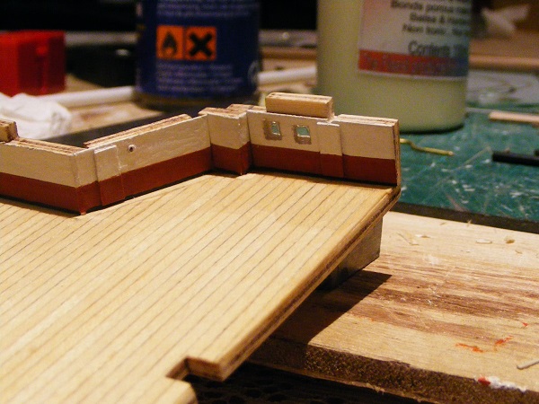

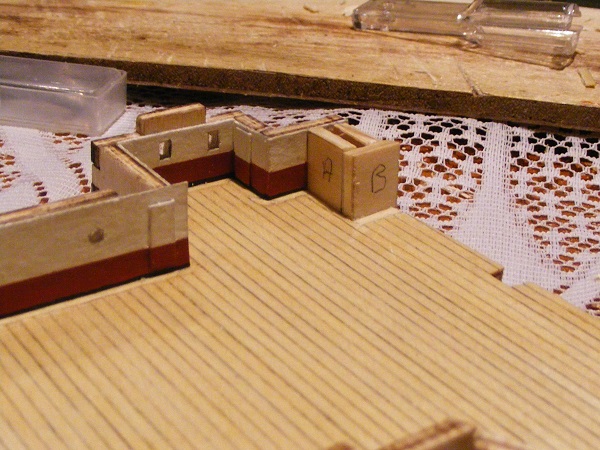

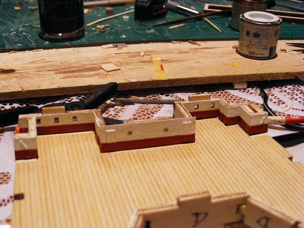

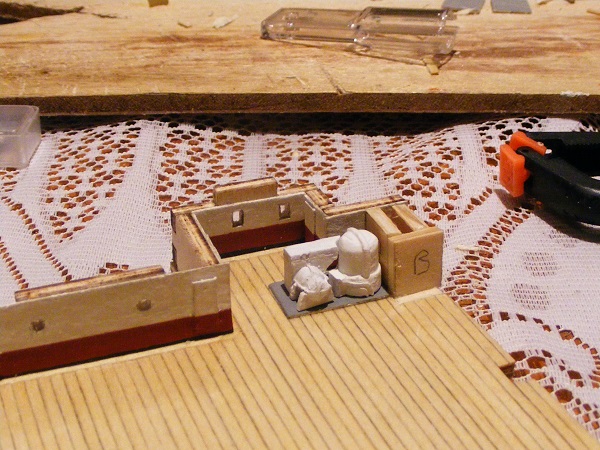

Small update on progress.... am still working on the sternmost bulkhead on the aft welldeck and further research showed there were two smaller bulkheads here on the port and starboard side.. Again these were not in the build instructions so set about putting them in place... the facings for these smaller bulkheads are being painted at the moment... Also, from the material I could find I went ahead and attempted to scratch build a Thermotank prototype. The prototype was done to allow me to work out scale, materials to be used and a technique in putting it together... Am quite pleased with the prototype so next task is to make the actual thermotanks to be fitted under the canopy on both sides... these thermotanks also sat on grey concrete bases....Cool Cool .. The photo's just shows the tank sitting in place, nothing has been glued down... There are a number of these thermotanks all over the ship so the prototype was I think the right way to go... Also have to try scratch building two cowel vent motors which again fitted under the canopy on the port and starboard side.....Cool Cool Still got quite a bit of work to do on this deck so will keep you posted..... Happy building all..

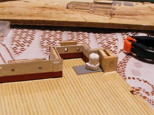

Have you thought of casting those thermotanks with resin/plastic
http://forum.model-space...aspx?g=posts&t=5607
http://forum.model-space...aspx?g=posts&t=5628
Just an idea

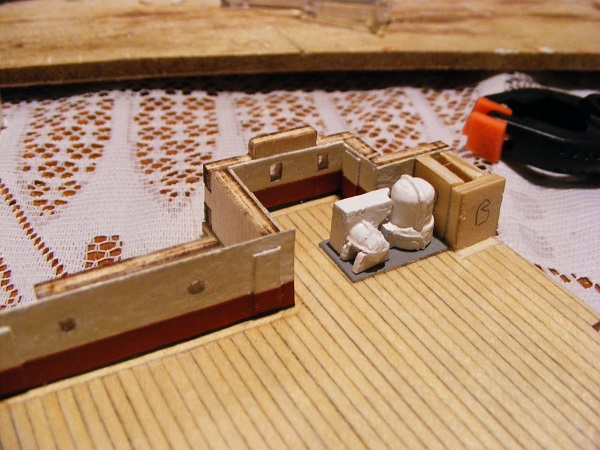

#143 Posted : 23 January 2014 00:20:32
arpurchase wrote:
BigGrin Hi Alan
Just an idea
Thanks for commenting Andy and for your suggestion, appreciated as always...Cool Cool I had thought about casting the thermotanks thanks to your post in the tool section. Had to do a prototype build first though as I needed to work out the scale and fit, had to work from a scale plan of 1:384. The other problem I saw was that although there are many of these thermotanks on the ship the actual layout of the various components is different in each case dependant upon where they are situated... Would have to mould each of the components in turn so yes, I now believe your suggestion of casting is the way to go.... The other problem is I am not sure of the contents of the final part 5 as that hasn't arrived yet, I do know however these two tanks are not included in the kit... Once again, having never attempted casting before should make for an interesting experience.... Will go for the kit you and Mr T have recommended and see how we get on so once again thanks for the assist......Cool Cool

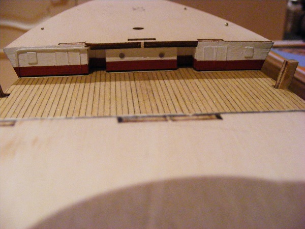

#144 Posted : 26 January 2014 22:52:17

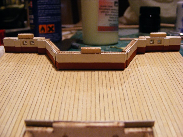

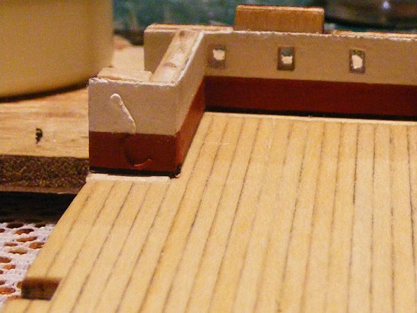

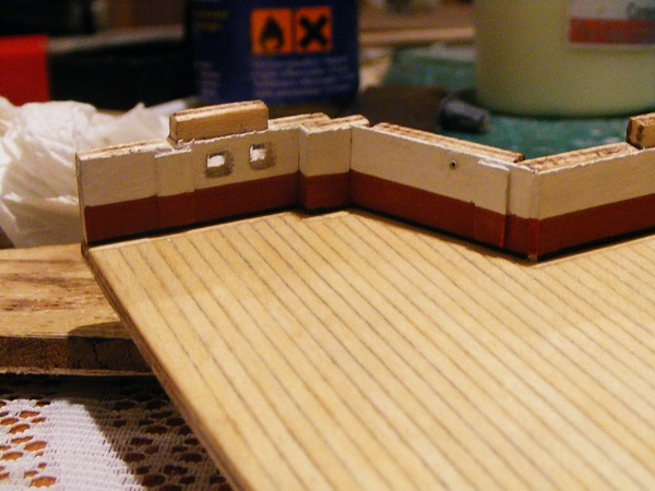

Hi all, completed work as far as I can just now on the forward bulkhead of the aft welldeck.... Again a number of changes not on the build instructions such as, windows on the far bulkheads complete with Krystal Klear for glass, additional doors and bulkhead lights... Blink Blink .. Hoping to finish the 2 small additional bulkheads on the opposite side tomorrow....Cool Cool Cool .. Also, took a break from working on the welldeck and decided to line the lower deck with tin foil, found alphatic holds it in place very nicely.... want to achieve as much light reflection as I can for the portholes due to the thickness of the double planking.. I also intend to line the underside of the decks ...Cool Cool... More soon....
#145 Posted : 26 January 2014 23:07:48

#147 Posted : 27 January 2014 00:03:26

I like your Thermotanks, that's some really good scratch building there, I think the mould and cast method is the way to go, I'll be doing a lot of it myself with both the Victory crew figures and the Great War model too!
The difference is, I'm making the moulds for white metal casting rather than resin. The actual mould making is virtually identical, a treacle-like compound mixed with a liquid hardener to produce a medium-hard rubber mould but one that copes with the temperatures of the molten white metal (hot, but not that hot! you can melt the stuff over a gas hob in an old saucepan!)

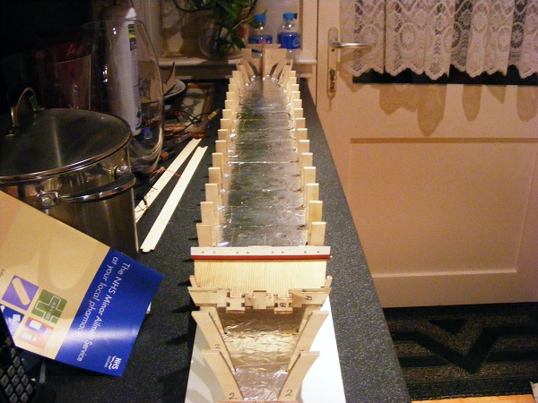

#151 Posted : 28 January 2014 22:23:46

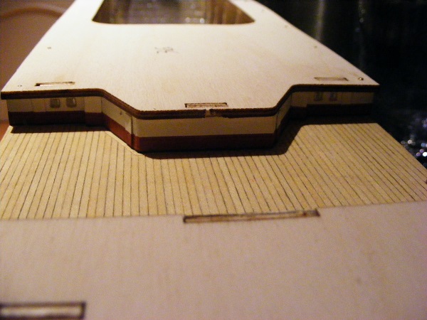

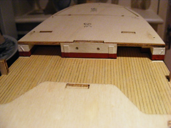

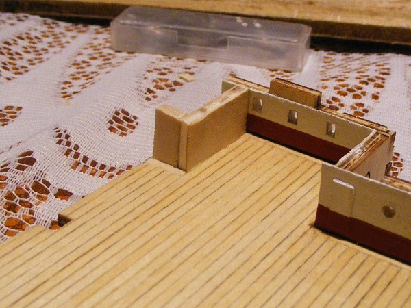

A little more progress..... completed adding the two small additional bulkheads on the aft well deck. On each of these two small bulkheads were stored 2 propeller shaft spanners, these were made out of left over wire from small resistors and flattened out with long nosed pliers.... Blink .. Moved onto temporarily pinning the decks in place prior to planking, these need to be removed again later to allow me access to the inside for fitting all the lighting and of course drill out all of the portholes. Aft well deck also dry fitted and hopefully will be fully fitted tomorrow along with the pinning of the rest of the decks.... Have noticed though ribs 2 and 3 on the starboard side will need to be packed out a little when it comes to fairing the hull. More again soon.... Cool Cool

#156 Posted : 30 January 2014 22:39:00

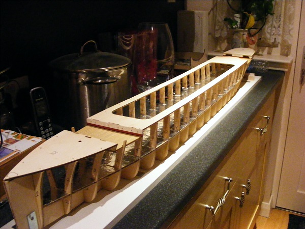

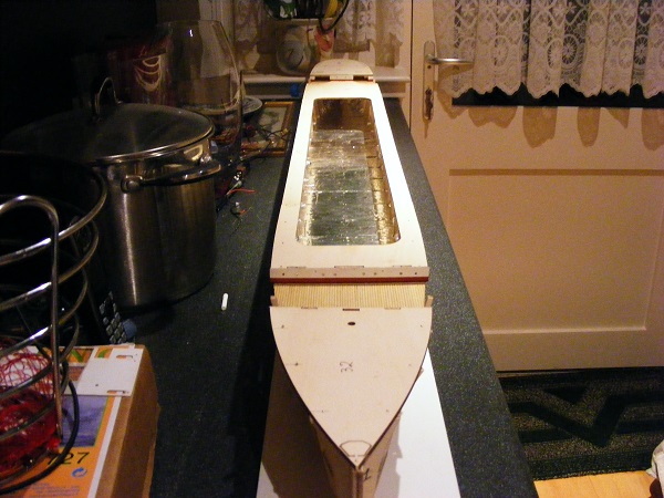

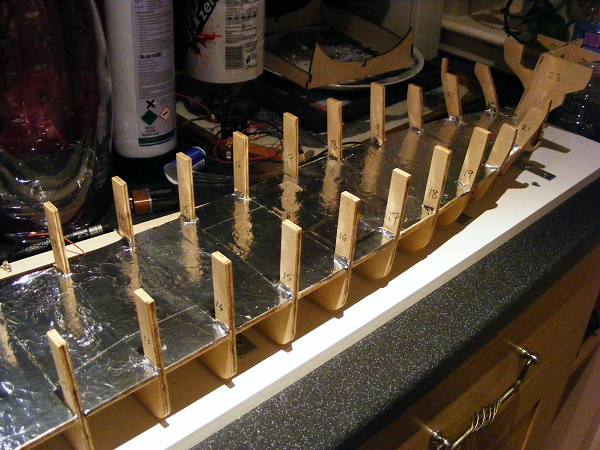

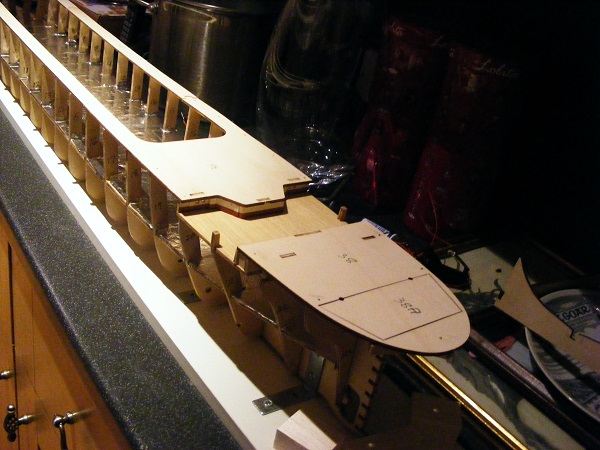

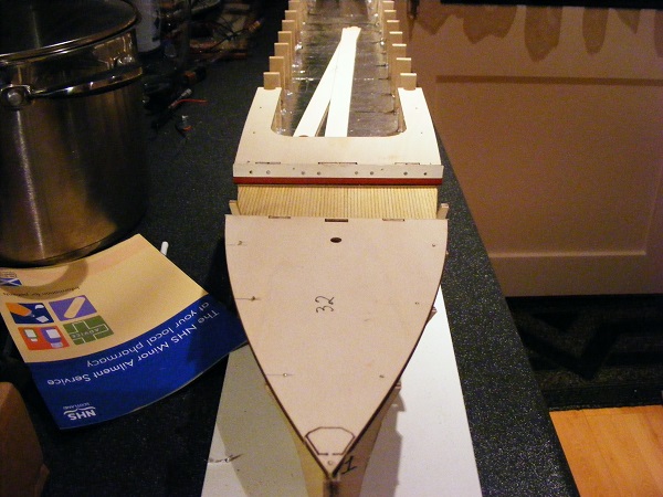

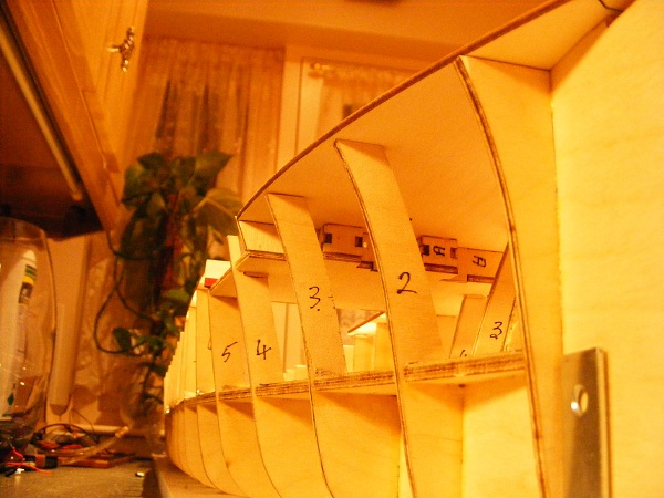

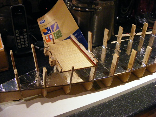

Hi all, have now temporarily pinned the decks in place. Pre drilled the pin holes first to ensure nothing split or broke... Next stage is to attach 4 balsa blocks to the stern area to aid getting the shape of the stern right then can get down to fairing the hull... have a couple of ribs that will need to be build up slightly but nothing drastic.... Cool Cool .. Here are the pics of how she looks now..... Blink Blink
