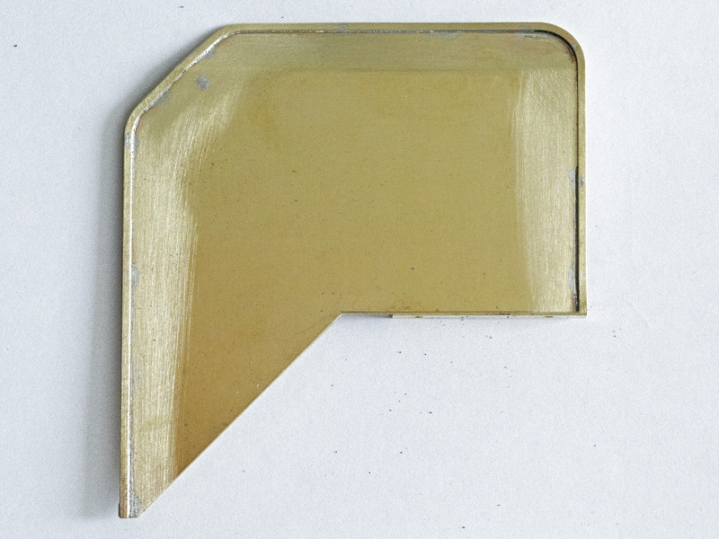

D51 Parts set 15 soldering deflector frames
I have placed a posting under the Soldering 'Model Making Know-How' regarding attaching the frames to the inside and outside of the deflector.
regards Dennis

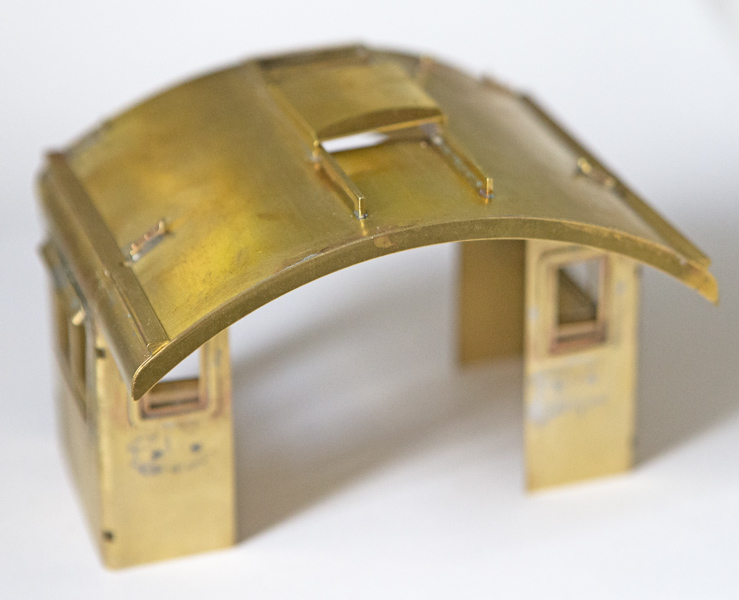

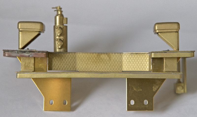

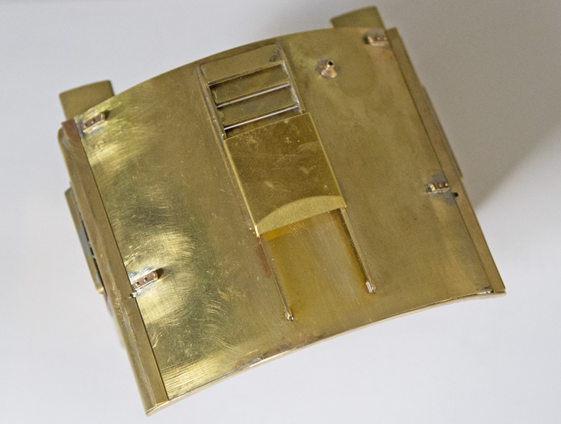

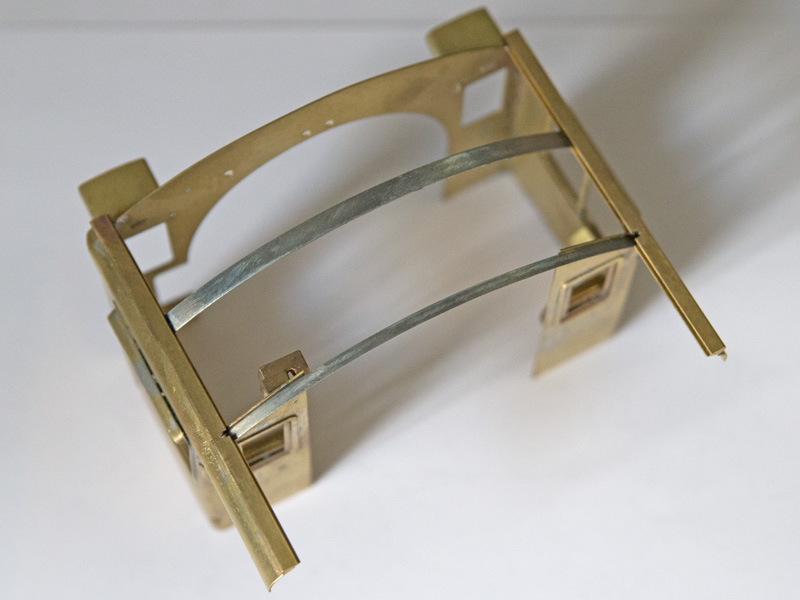

D51 - Parts set 15.
Hi Everybody,

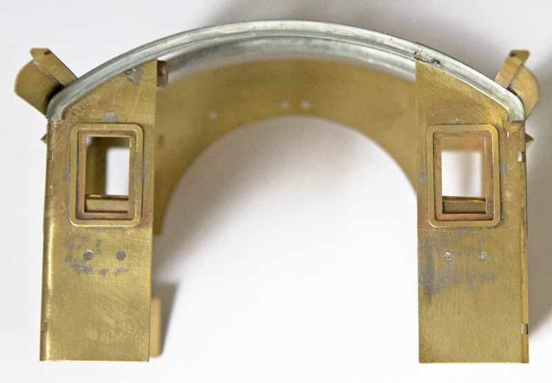

A little later than usual with the main posting on parts 15. The cab has been easy progress for me since the majority of the parts up to this set have been brass. Unfortunately two of the three cab roof supports were Zamac. These I glued in place which seemed fine. The cab roof end I decided not to follow the instructions but simply soldered it to the end of the cab roof. It aligns well and certainly was simpler for me to attach. The cab roof components were all soldered in place. The locating holes were tinned first which aided attachment.The roof brackets proved quite fiddly but I managed after a few attempts. The roof slides fitted in place perfectly another example of the excellent quality of the parts and fit. I have decided to leave the gutter pipes off for now since they will make handling/storage a little more difficult when installed. The window frames and seat back rests were soldered in place on the cab body.

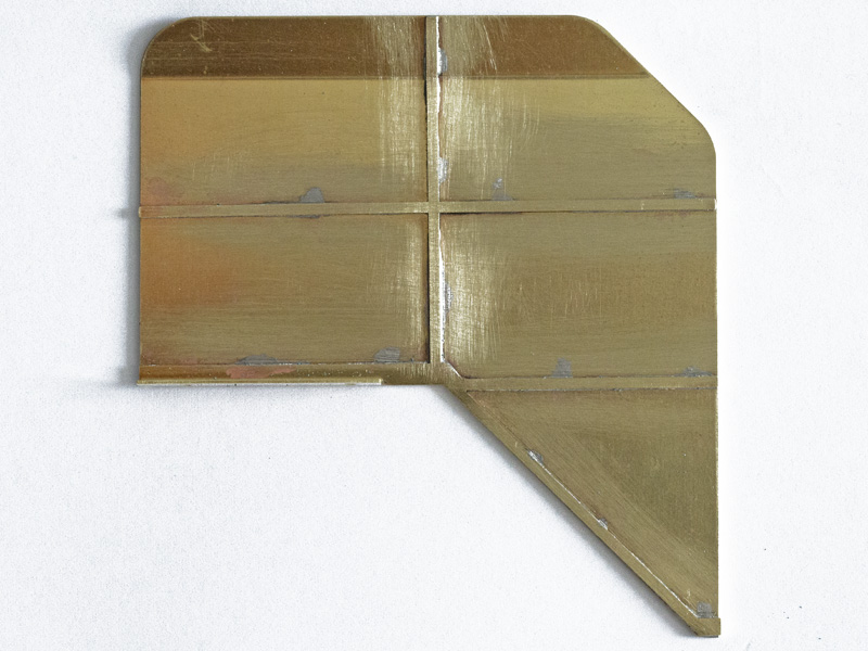

The cab floor end beams were also soldered in place. Initially holding them with stainless screws. I also include two of the deflector pictures also used in my 'Model Making Know How' posting.
Dennis

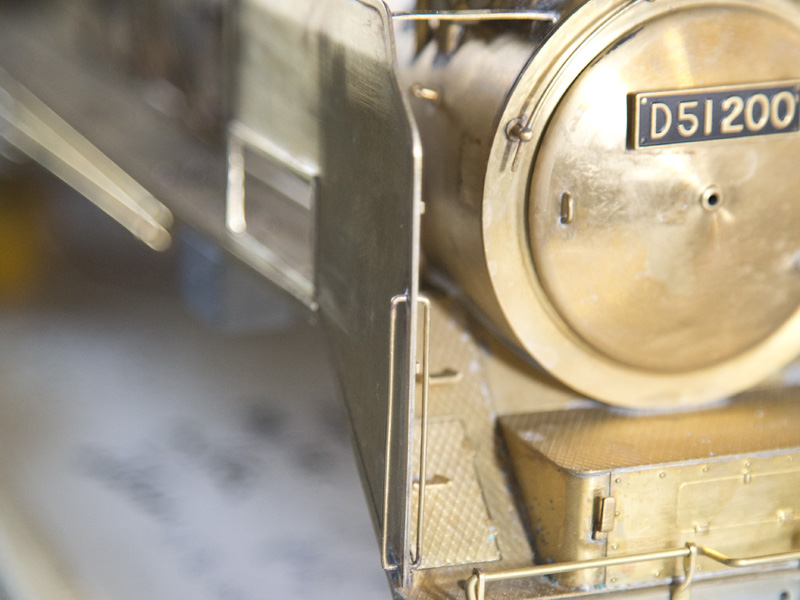

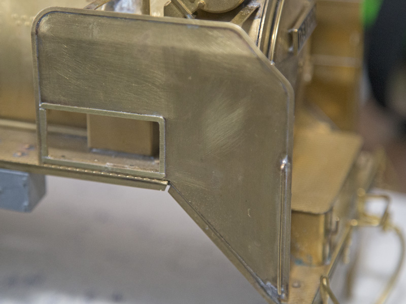

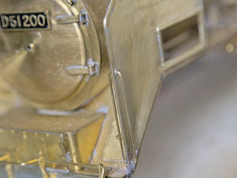

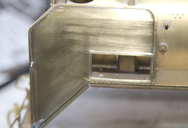

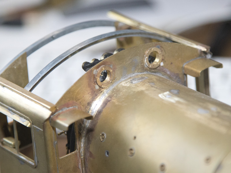

Good weather means other hobbies take precedent but it's time to do a little catching up. Since I have opted to airbrush my model it appears that will have to wait until the final stages since parts are still to added.
However my next stage was to attach the cab body. As usual this has been soldered in place. As yet I have left the floor still to be attached.
Mark under 'Video Links' mentioned the two round windows above the cab/firebox. I have installed these. Gauging the size from various pictures. Also under the heading of mods I noticed in most pictures of the class the smoke deflectors are fitted with inner and outer handrails. Also in a large number of images the deflectors are to be seen with rectangular access holes at the rear. I notice the image used at the top of instruction sheet page 124 shows this clearly (D51 - 200?). Hence I have also applied the same mods as shown below.
At this stage I have assembled both bogies and the tender base. However again the bogies will require painting later.
ps one handrail knob detached to be replaced.
cheers, Dennis

Thank you. I felt the smoke deflectors in particular needed to be modified.

Hi DaDokta,
Thank you. Soldering helps strength wise. As an example I soldered the rectangular frames on the deflectors first before cutting and filing the deflector away.
Dennis
