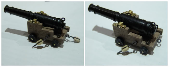

Hi All,

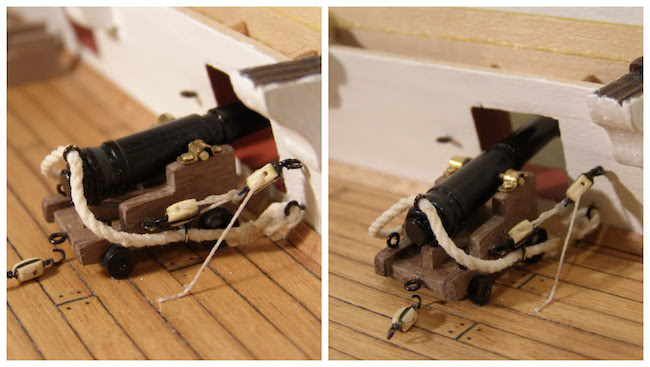

I just thought I would post pics of my first cannon.
Same here I am building this and Syren at the same time which is a job in itself..
Chris..
#146 Posted : 26 January 2011 00:51:59

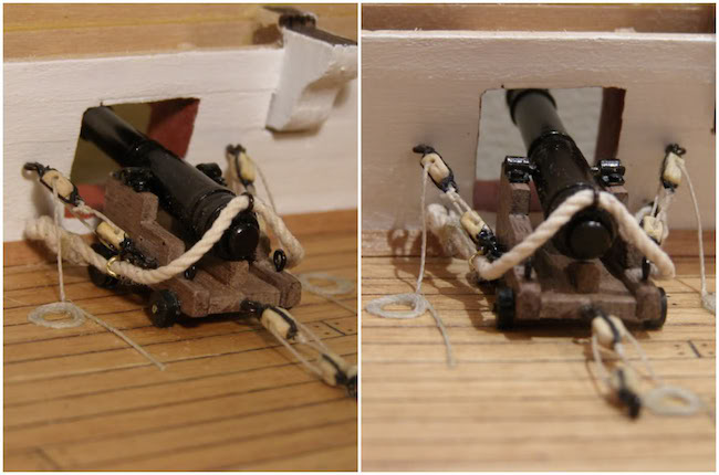

Here are a couple of shots of my half rigged Cannon onboard now. Just need to make some more blocks up for the rear and the other side then onto making some spirals of rope to sit over the cut of end.
Chris..
BigGrin
#147 Posted : 26 January 2011 12:28:40

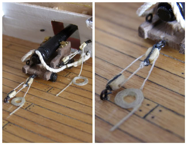

Here is the train tackle fitted and the coils. Definitely finishes them off.
Chris..

Last pics of the Cannon now fully Rigged up..
Chris..

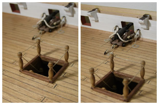

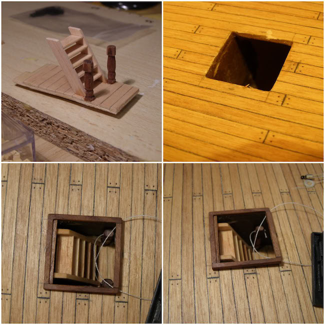

Hi All
I have done a little kit bashing today and installed a Stair well in the correct position, A/L have a solid hatch in a slight different position. The pain in the rear end bit was the fact that the frame and bulkheads are in the way under the deck so had to do some cutting at them, I didn't really think I was going to bash the kit up so much when I started otherwise I would have fitted a false deck.
Chris..
Mike Turpin
#151 Posted : 29 January 2011 10:34:09
Joined: 13/10/2011
Posts: 851
Points: 2,628
Location: Leeds, Yorkshire
Hi Chris
Excellent workmanship there. I wonder how many looking at those pictures will realise just how much skill goes into a piece of detail like that. I know from when I did similar work on my Bounty, how difficult it is to get the steps looking regular and squared up.
BTW, I was watching T.V. yesterday evening and the Endeavour Advert was on, it's a good job i had already decided not to take it on because SWMBO looked at it and said "Well I know somebody who isn't getting one of them!!!" Not quite sure who she meant, but I have my suspicions!!
Mike T
#152 Posted : 01 February 2011 18:48:08
Here I am again...
Thanks Mike..
A couple more pics with the hand rail and posts in place.
Chris..

What do you use for the thick white gun rope? I've looked at various srings, even white wool, but nothing I've found so far seems to meet the look you have got.

#156 Posted : 02 February 2011 16:56:45
Hi all
Thanks for the comments..BigGrin
The thread is 1.3mm Caldercraft rigging thread in natural, if its for the Victory I would suggest 1mm Thread.
1.3mm thread
Chris...

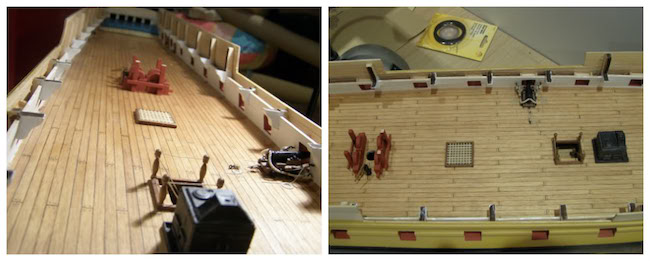

I have studied pics from various places and have measured the pumps on the FLY then converted to 1/48 and got the sizes I have made them. Some models show the pumps fit just under the roof beams but according to "The construction and fitting of the English man of war 1650-1850.Peter Goodwin" they are half height between deck and roof. Which make mine spot on..I Hope..
I also made and fitted my first grating.. problem was I tried using A/L's parts but the fell apart so ordered Amati gratings from Online-Hobbies.
Chris..
#159 Posted : 10 February 2011 20:10:54

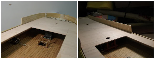

Hi All, Just thought I'd post a couple of pics of my update.
I have but the ribs off the inside of the bulwarks and made my own deck from 3mm Ply. Which is so much easier than the way A/L tell you to do the deck. Why they don't use ply is beyond me.
I haven't finished the cutouts on it yet though.
Chris....

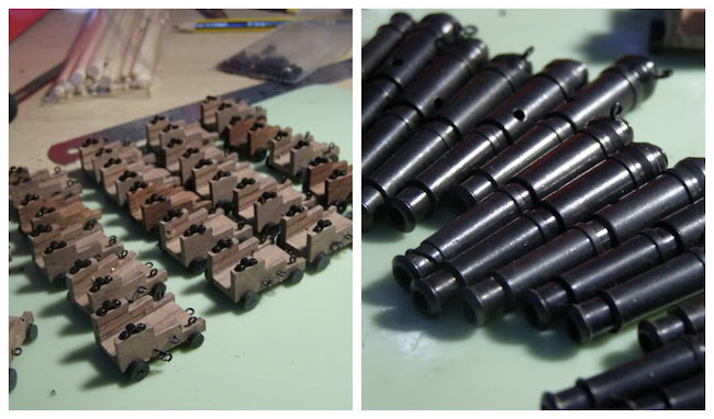

Hi Guys... I still here..

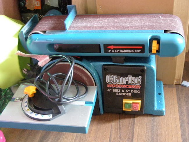

Here are the latest of my pics. I have been busy with work so Modelling was slow, I have got this far with the cannons. They are nearly ready for installation and then Rigging.
I also treated myself to a sanding machine.
Chris.
