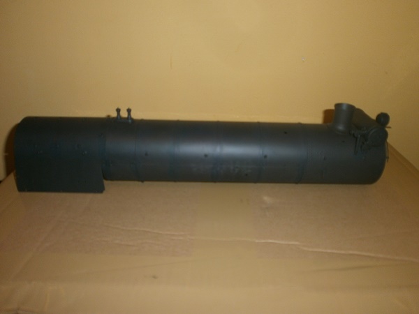

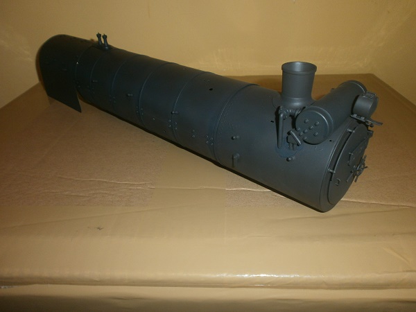

#142 Posted : 19 January 2014 17:39:47

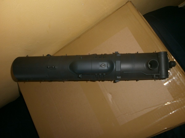

BigGrin Hi All
This month its the fire box/boiler area and the addition of the straps. Nothing of concern here and quite a fast build it also starts to give a good idea of its size as the drivers cab is still to be added.
More soon

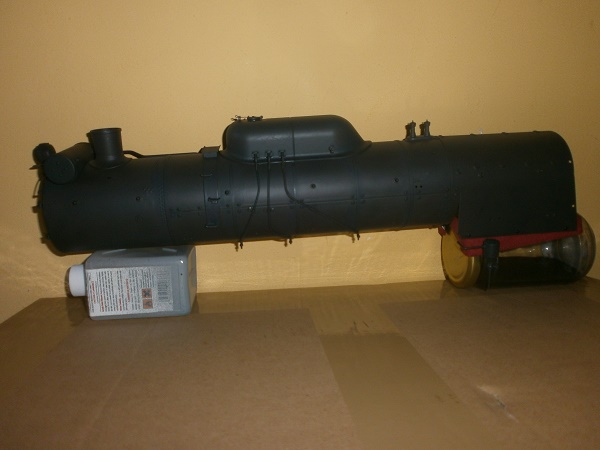

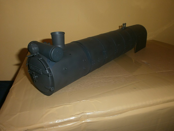

#143 Posted : 15 February 2014 17:27:39
BigGrin Hi All
More bits to add, the steps ,sand box [the shape of the sandbox gave the D 51 its nickname of the slug ]and pipes and finally the lower firebox sides.

#144 Posted : 15 February 2014 18:46:00
I have a bottle of the same Tamiya thinner (I'm guessing that's what it is?) and it's a pretty big bottle , so looking at the pictures I can see that's a VERY big Kit! Brilliant work as always Andy Cool

#145 Posted : 15 February 2014 21:04:47
BigGrin Hi Spencer
Your correct on the thinners bottle I use the empty's as props/holders when I use the airbrush but there useful for other things too. Thanks for looking in and your comments.

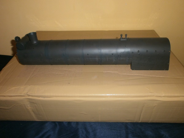

#146 Posted : 16 February 2014 13:36:08
That paint finish looks nigh on perfect Andy, a normal matt black just does not look scale like sometimes, but the Rail match weathered works a treat......You are setting the standard to aspire to with it..........Tony
#147 Posted : 16 February 2014 13:51:30
BigGrin Hi Tony
I agree about the Railmatch colour it gives that oily blue black colour that comes into its own on the larger area's of the loco, as for setting a standardBlushing there are im sure some better renditions out there but thank you for the compliment.

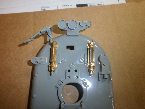

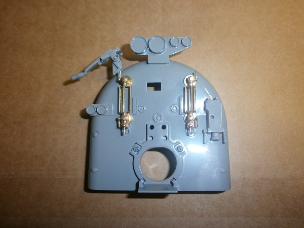

#154 Posted : 19 March 2014 20:00:41

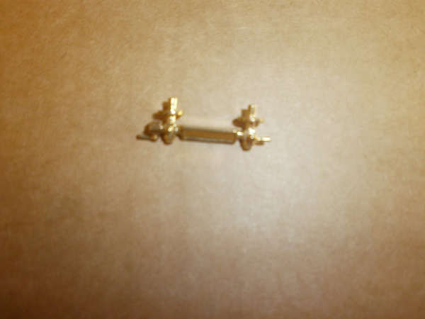

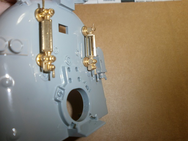

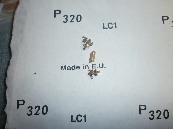

BigGrin Hi All
Today I received the new set of parts which included the backhead and the water level boiler sight's these as I have noticed from pictures are cast in the solid where they should be a frame with an inner tube with 3 panels of glass surrounding it just incase it blew to stop splinters.
My intention was to always remove the central solid part and replace with a frame ,inner tube and outer glass. So here are todays results the centre's have been removed and the frames have been made up ready for painting, the glass tube and outer glass panels will be added later.
More soon
#155 Posted : 19 March 2014 20:17:34
very nicely done andy.Cool
swordfish fairey
#156 Posted : 19 March 2014 21:27:58
That looks like a nice job you are making of them Andy, may have to "nick"Sneaky Sneaky your methods when I get to this section................Tony
