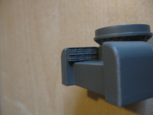

USTON we have a problem the vents on the forward secondary gun mounts do not fit they are to big Mr T has dune this bit was just wondering if he had a problem and if so a way to fix it The stern gun mount no problems a bit of filling in the gaps but that is all The 2 Maine guns are a copy of the first so no probs there will have photos of rest later see you soon
#153 Posted : 18 January 2011 10:08:15
Mine was also on the high side, so I filed the bottom edge of the vent to lower its height, which eats into the mesh, but once painted and in place is hardly noticeable levels out nicely at its the top, the height of my vent is now 6.5mm.

Thanks mrT will do that as you say will not be out of place
