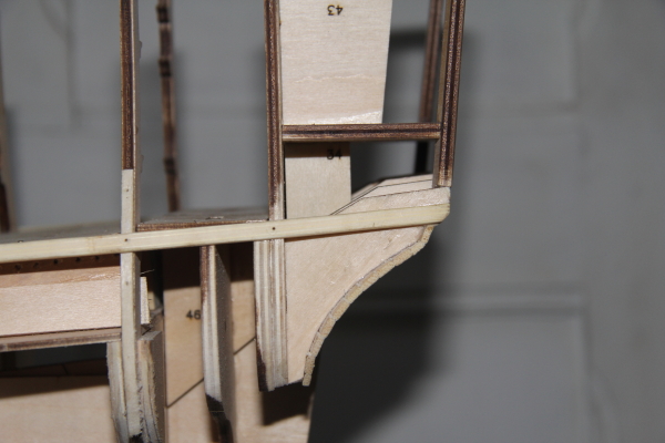

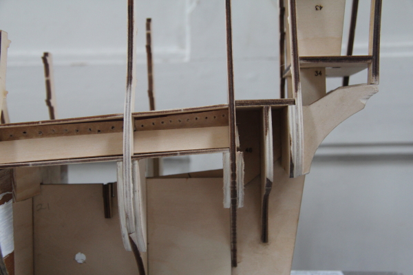

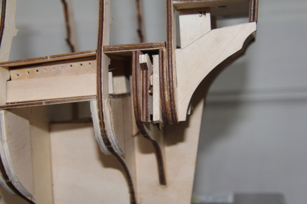

Fitted the stern assembly. Issue 16.
For some reason, I found that the half-frames 49 and deck extension 47 didn't fit properly.
When the deck piece was fitted on to the tabs on the ribs - a tight fit - then the ribs splayed out at the bottom by about 1mm.
No way of getting a clamp on those curved areas, so I tied pinning them. That was no use, as putting in pins at the thin bottom tips was splitting the ply and not holding.
The only thing to do was pull it apart, clean off the glue and rethink.
The ribs have to fit properly with a good glue fix, so I decided to fit them where they wanted to go, then modify the deck piece.
The slots in the deck were lengthened outwards, until the fit worked.
Dry-fitting the stern assembly showed me two issues:
1. The assembly moved around a bit on the keel, so I could not be sure it would glue in dead square.
2. There is no way of clamping the reinforcement pieces, to get a tight joint for the glue.
To fix both issues, I used packing, with spare bits of fret.
The average of the thickness required seemed to be about 10 1/2 mm, so I prepared 2 bits of 4mm fret, 2 of 2mm and some squares of card, for each side, then tried equal amounts of each material until the fit was tight.
Captain David attached the following image(s):

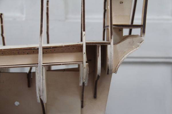

Profiling the stern and the rib 26 problem.
Thanks to others mentioning the problem, I was looking out for this.
When I started to sand the profile, it was pretty clear that rib 26 was not getting sanded down at all.
Trialing a bamboo plank across this area showed an obvious need for filling out the rib, by just over 1mm - certainly in the area of the first few planks.
Spare planking strips from the ship's launch gave me 1mm and 0.5mm stuff to use.
I glued on a bit of the 1mm, then tried the plank again. The problem looked solved, so I didn't add a 0.5mm piece here. On the opposite side of the rib, a 0.5mm piece did the trick.
This worked for my build but might be slightly different for other people, depending on rib alignment etc.

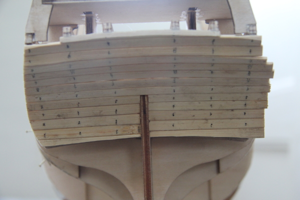

Stern Planking done.
Now the fun starts BigGrin
I started with the plank that butts against the keel. The instructions ask for something different - the first plank to be the one at the tips of the frames - but I couldn't be sure of it's exact positioning, due to the two curves of the frames. Not only does the plank have to bend in to the main curve of the frames but also there is a curve in the plank tips.
So, that plank in, I then added four more, then sanded the last one to match the curve of the frame tips, ready for the vertical planking.
My big mistake with the short planks around the keel.... not checking the width of the planks I was using Blushing
One of the planks was narrower than normal. I had already pinned in two lengths before noticing that one side was now higher than the other.
I left them in place, as all this will be covered up, but it is a lesson for the future, when I do the final layer which will be visible.
For the final pieces at the top and bottom, I whittled these down with a Stanley knife to the rough shape.
All of the pin-holes were pre-drilled with a 0.6mm bit. To get the positions right I had to hold each plank in to the curve and mark positions with a pencil, then drill the holes with the plank on a worktop, push pins in enough to hold them, then glue and fix.
Then sanding down to shape. The instructions ask for sanding to the profile of rib 27.
Laying a test plank along the sides shows that a lot more needs to be sanded off than that.
I used a sanding stick in line with the aft 3 ribs, so not in line with rib 27 but at an angle corresponding to the rib's profiled edge.
Final sanding will be done as each plank is laid, testing how it affects the shape.
I ended up sanding the top almost vertical for the first two side planks, so they will be in line with the gallery panels above them.

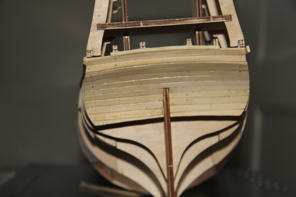

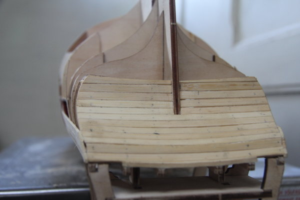

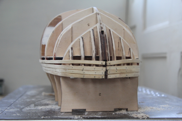

More profiling.
All done now except the stern below the transom.
I wish I had known about the need to cut away some of the aft reinforcing pieces - to create the "bearding line". I would have cut off the excess before gluing these pieces in place.
Three layers of planks in place. Already I notice a difference in the total depth covered, between port and starboard. This is due to the different widths of the planks.
The photo shows planks for layer number four, soaked and pinned in place overnight. I will swap these around when I fit them, as I want the wider plank on the port side to correct the difference in total depth.
