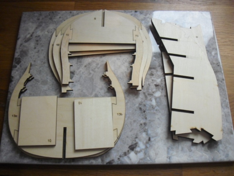

This is what we received this week:-
#142 Posted : 26 September 2012 22:04:50
ISSUE 4 BUILD

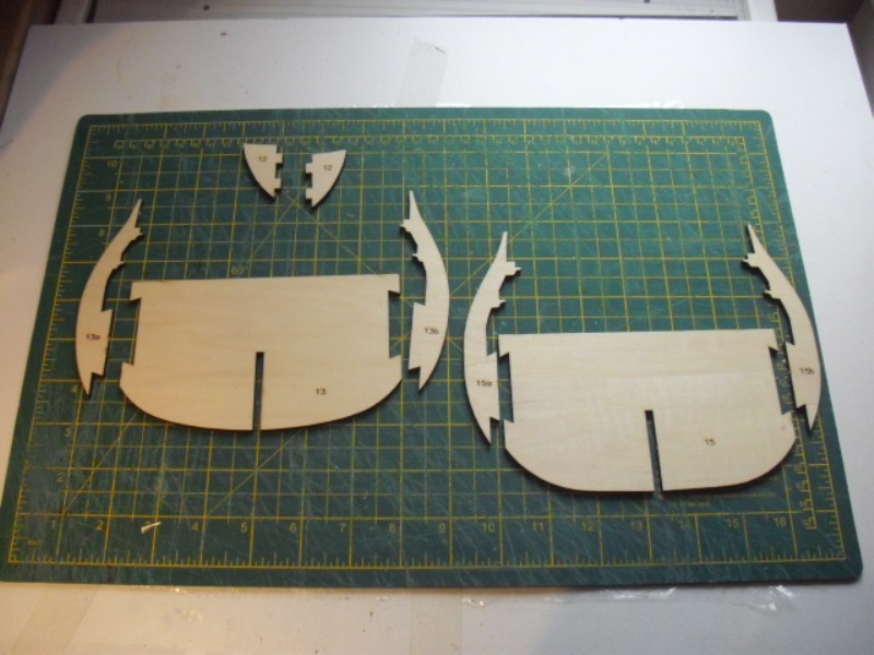

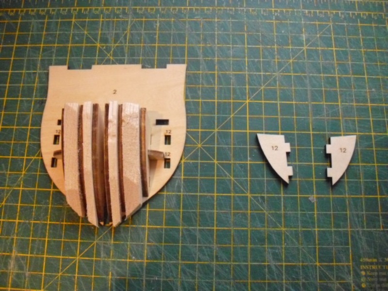

And the parts we received ( cut from the fret ):-

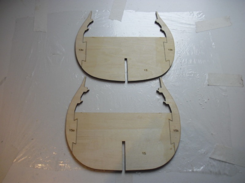

#143 Posted : 26 September 2012 22:08:41
ISSUE 4 BUILD

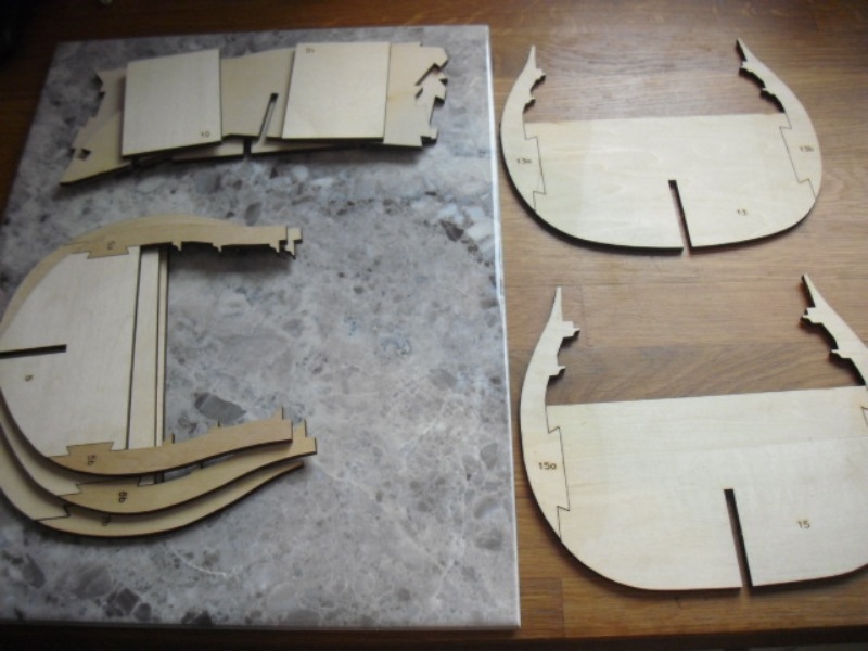

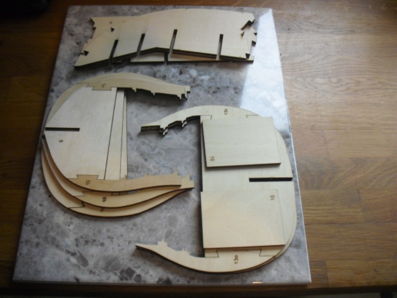

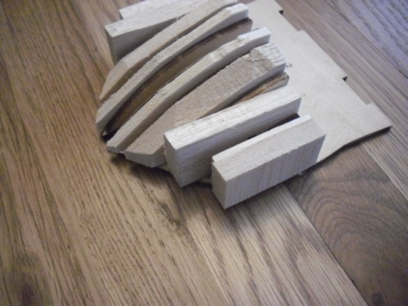

I cleaned off the ash and assembled the ribs 13 and 15, I used my board with the plastic fitted to glue all the parts with PVA, and when the glue was dry I placed the ribs in my tile sandwichBigGrin :-

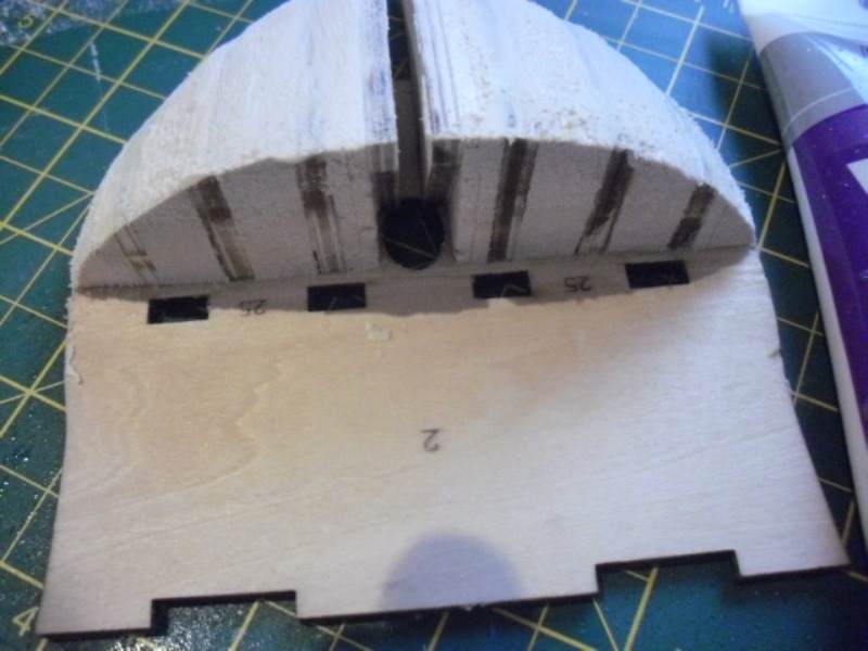

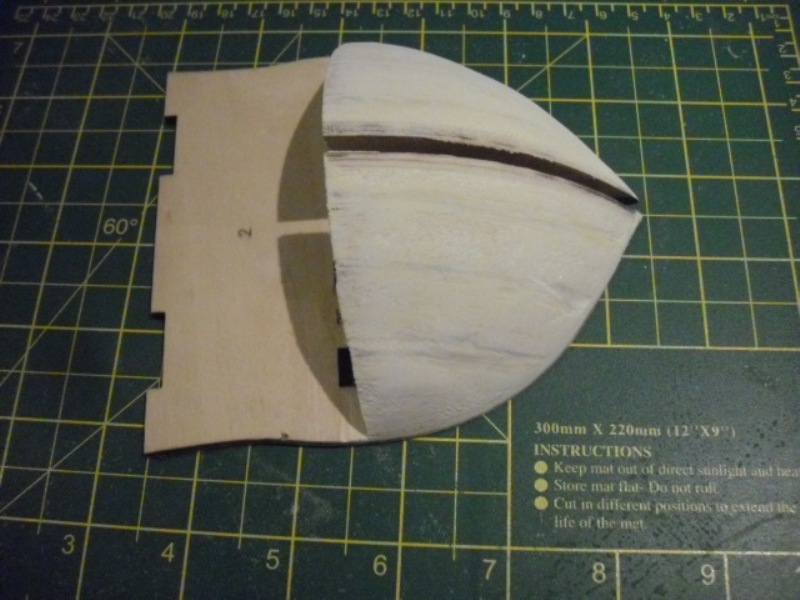

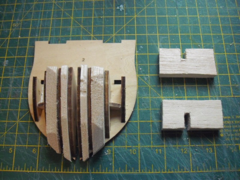

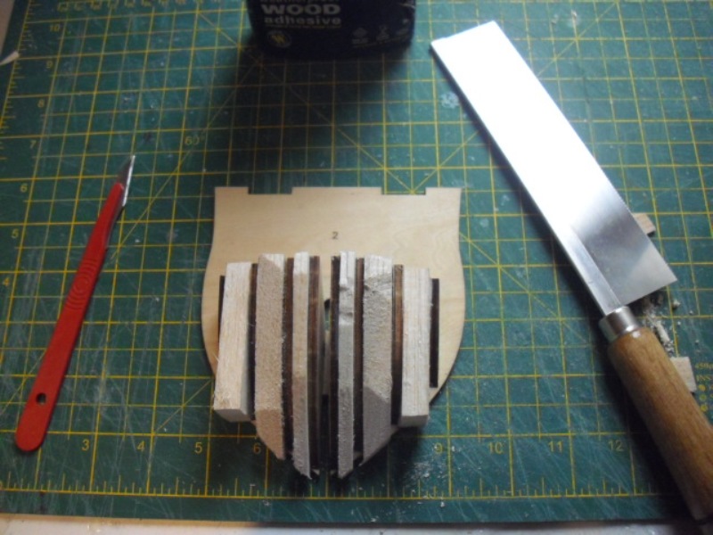

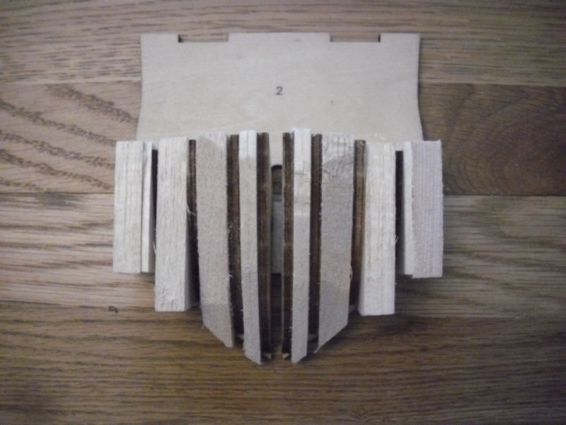

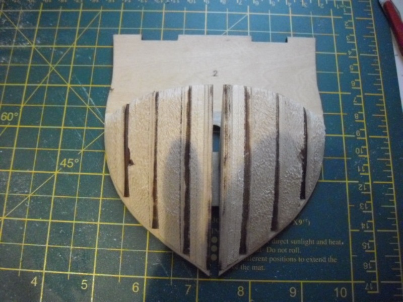

Next I fitted the 2 x parts to the Bow former, and fitted pieces of Balsa between parts 11 and 12 on both sides and also on the end of part 12 both sides:-

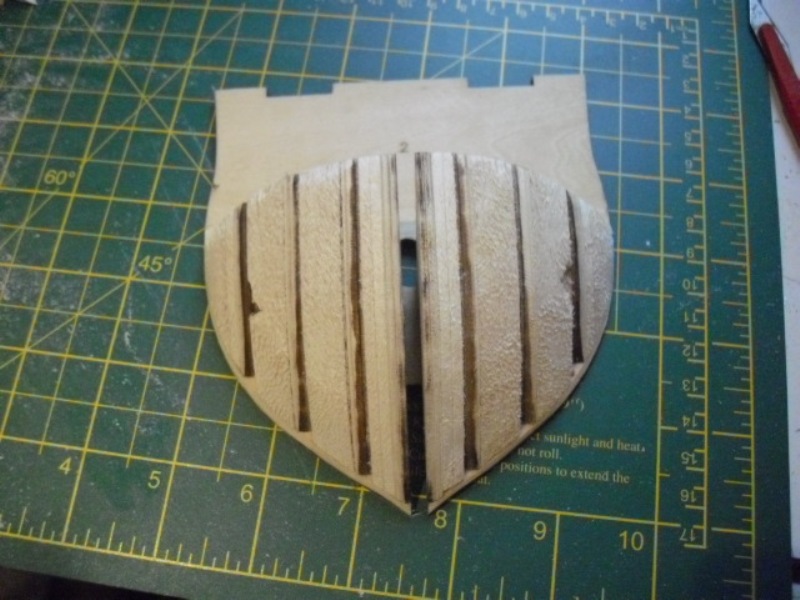

Now I began to shape the Balsa with a large file and sand paper block:-
#146 Posted : 26 September 2012 22:21:12
ISSUE 4 BUILD

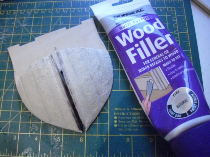

Near the end now, I use my preffered filler to fill in any undulations prior to Fairing the piece, which I do when it is dry:-

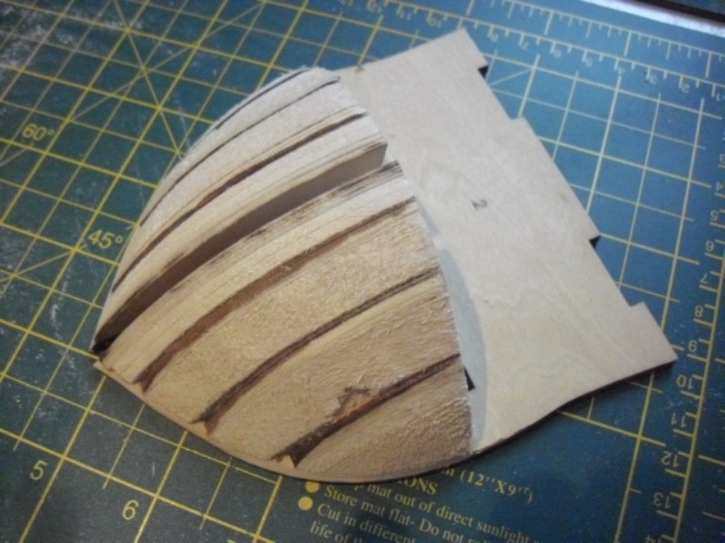

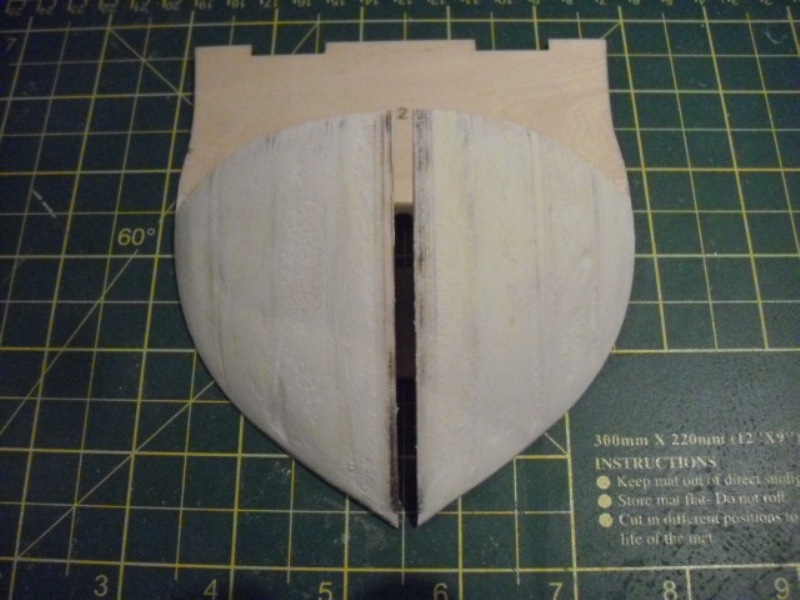

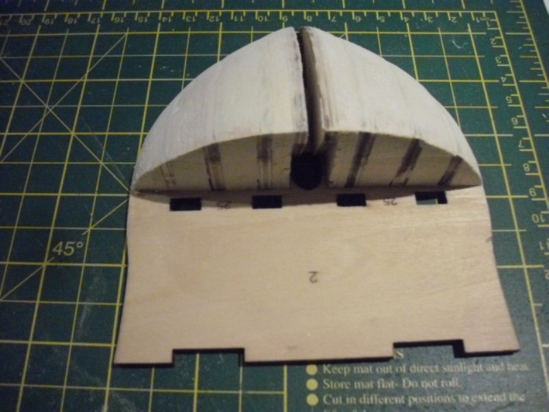

Well Team thats it for this session, thank you for looking in, as usual questions and comments are welcome.
I leave you as usual with the parts sanded and finished for now.
Kind Regards Mike
