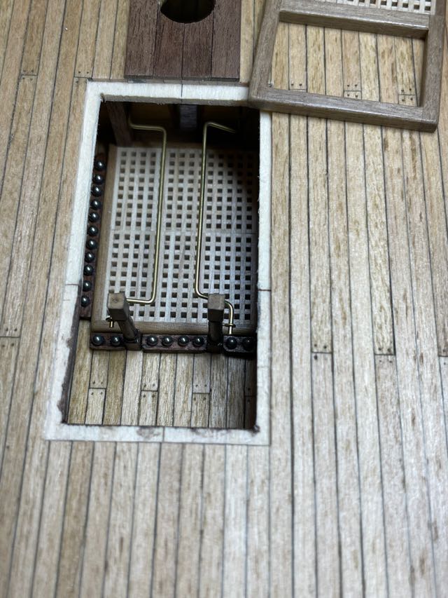

Odo attached the following image(s):
goddo
#142 Posted : 20 December 2023 12:41:31
Joined: 21/04/2011
Posts: 1,089
Points: 3,296
Location: Buckinghamshire
Hi Odo,
Some really nice details there especially with the pump.

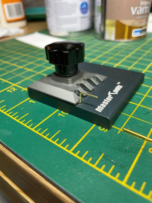

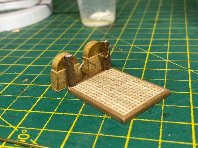

That's a nifty looking tool you used for bending the brass wire handles.
Would you mind sharing what it's called and where you got it from please?
Thanks. Chris

goddo wrote:
Hi Odo,
Thanks. Chris
Hi Chris,
the tool is a Photo Etched Part Bender. It comes in various sizes and there's plenty of manufactures out there.
Here's the link to the one I bought a few years back. Quite pricy, even for the small one of the collection...
https://www.emodels.co.u...3MbpAZdlrRoCuPkQAvD_BwE
Cheers,
Odo

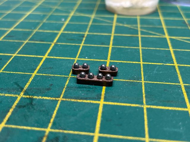

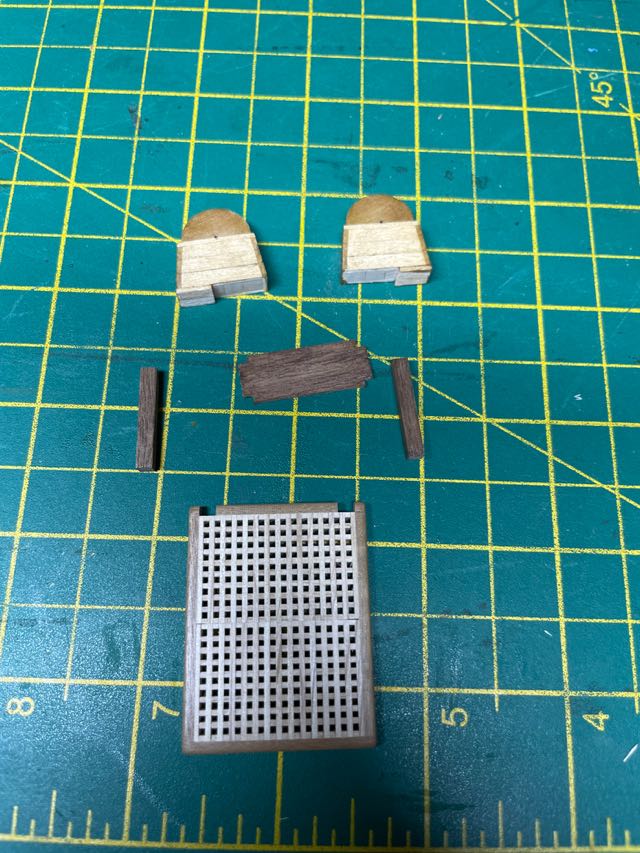

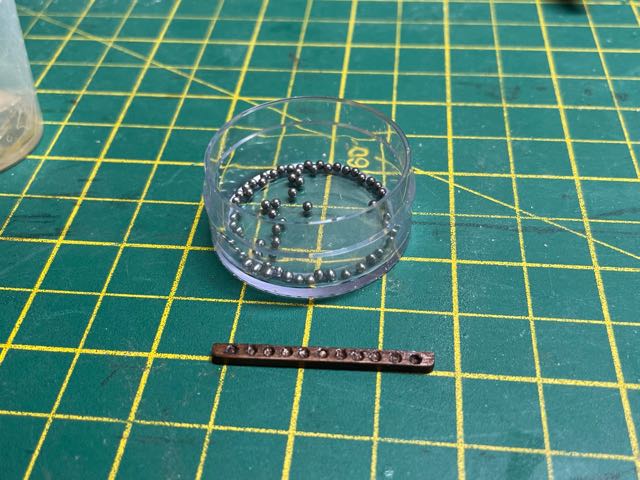

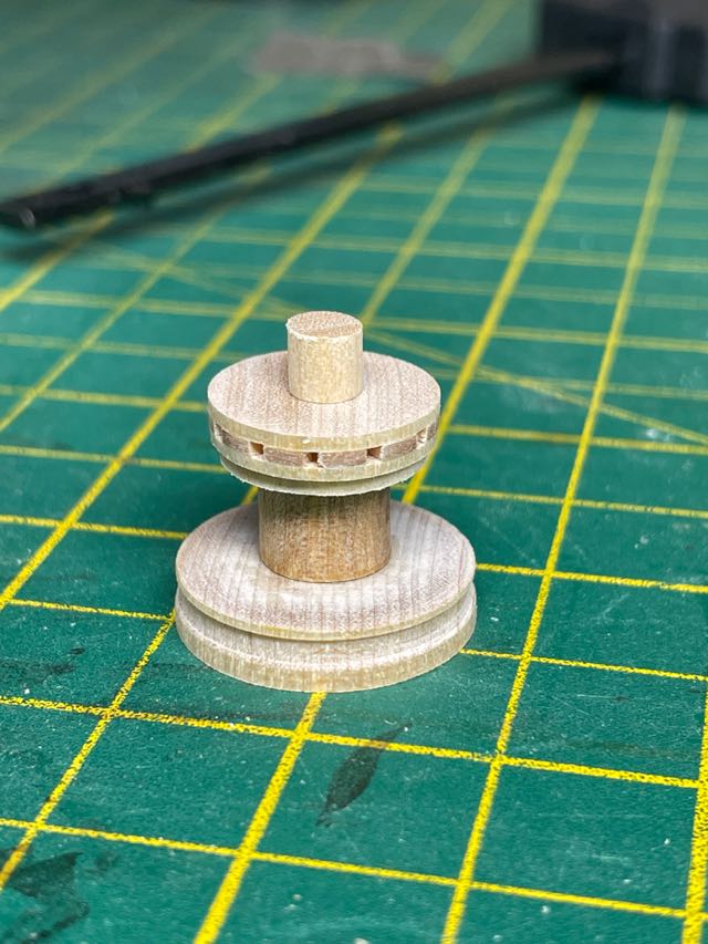

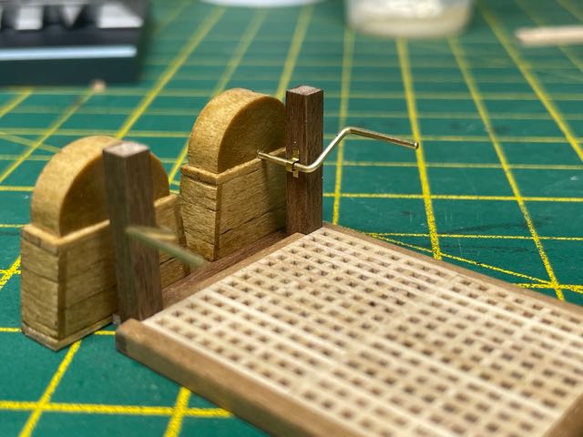

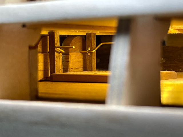

According to my reference book, each handle of the chain pumps could be operated by up to 30 men (with extensions). Hence, I figured that my handles came a bit short of that and after referencing other picture and videos showing the pumps, I extended mine too, and added some cannon balls around the grating.
Thanks. Chris
Hi Chris,
Cheers,
Odo
Thanks for the quick reply. My word that is expensive but I'll take a closer look at the variations on offer.
Keep up the good work and great diary updates. Enjoying it all.

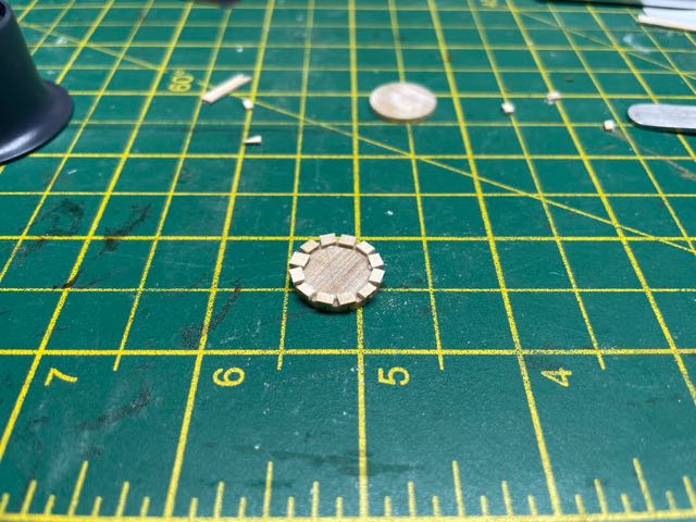

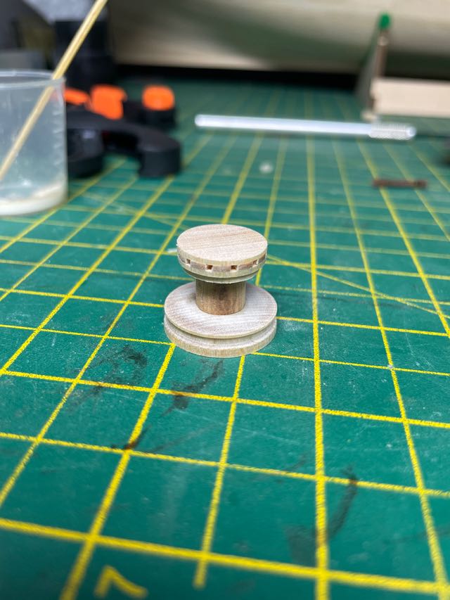

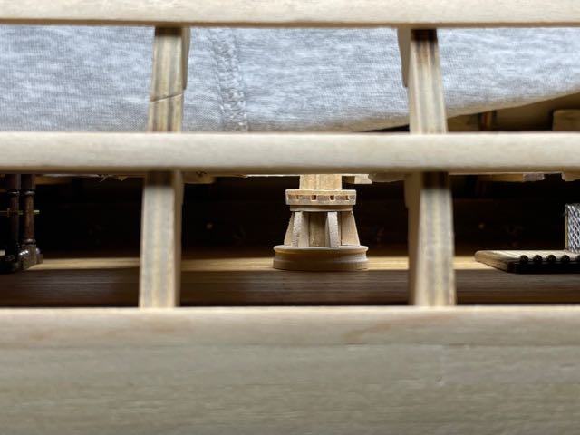

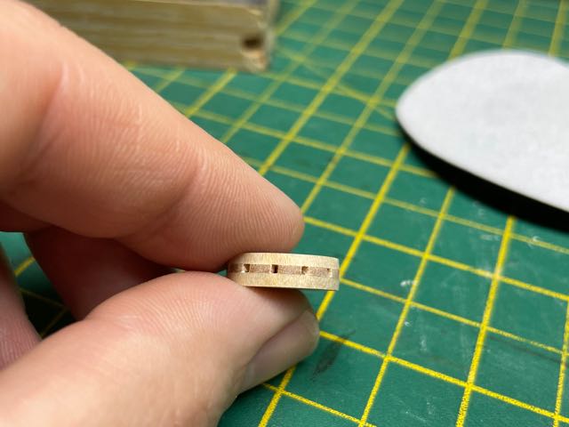

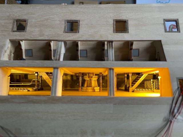

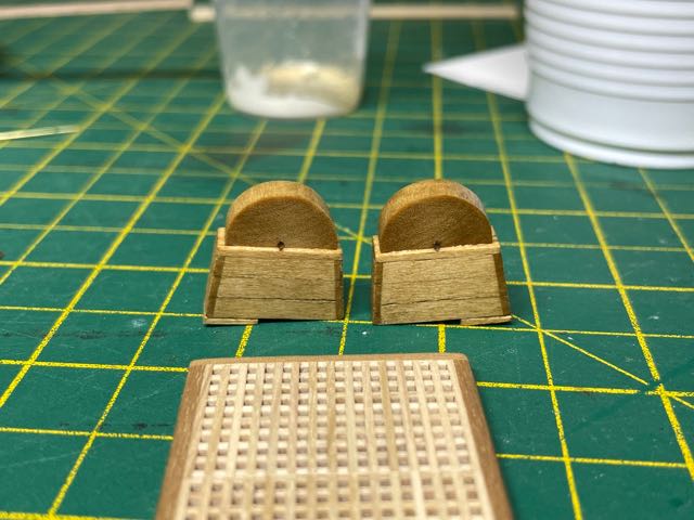

Another short update as I come close to the completion (not quite there yet) of the details for the visible part of the lower gun deck.
I rather do little updates than big ones to avoid having to upload too many pictures at ones and most likely miss some stages. This way I'm sure to have a more complete diary and get other builders inspired as much as I was inspired by other buildersBigGrin
This time its the lower part of the capstan. I'm planning to complete the details (missing stairs and posts by NYE, fingers crossed...

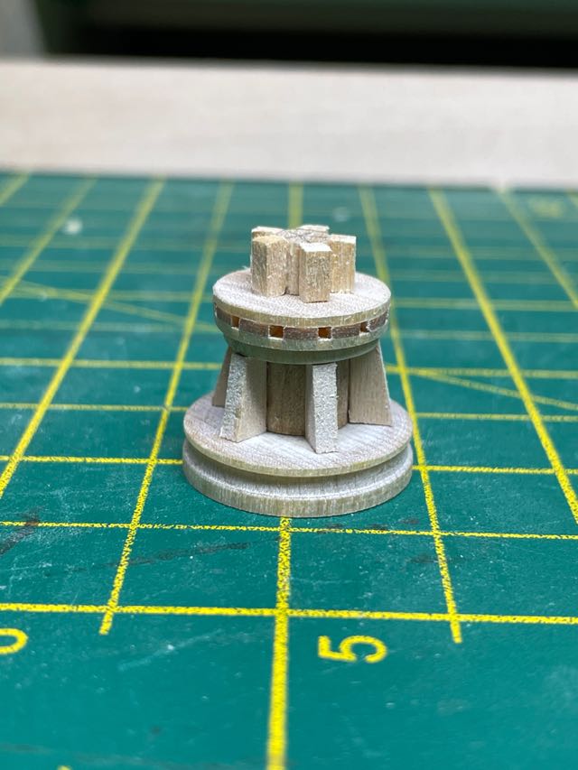

Odo
#149 Posted : 23 December 2023 01:42:41
Build-Diary Medal: Build-Diary Medal of HonourOutstanding Build: An award for an outstanding build
Joined: 13/10/2020
Posts: 171
Points: 522
Location: Hampshire, UK

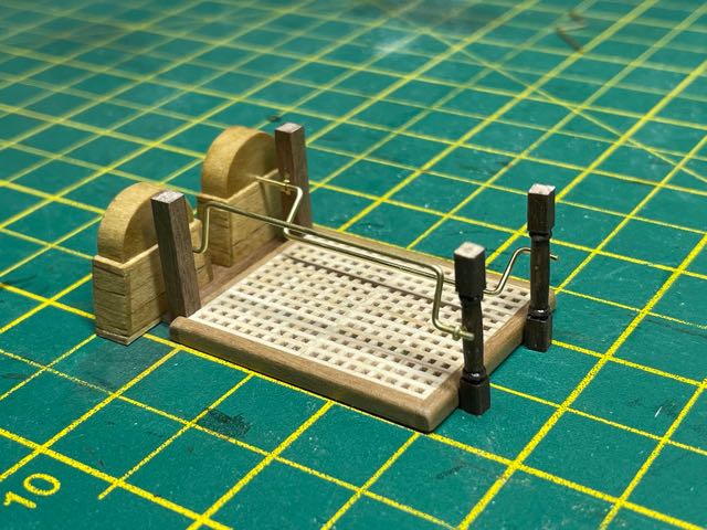

Odo
#150 Posted : 23 December 2023 01:43:48
Joined: 13/10/2020
Posts: 171
Points: 522

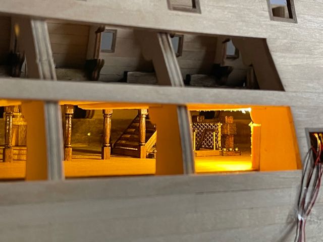

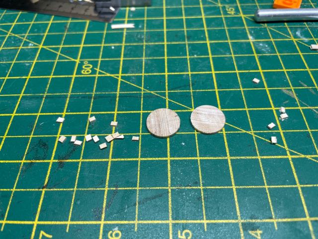

...and here with the capstan provisionally put in position

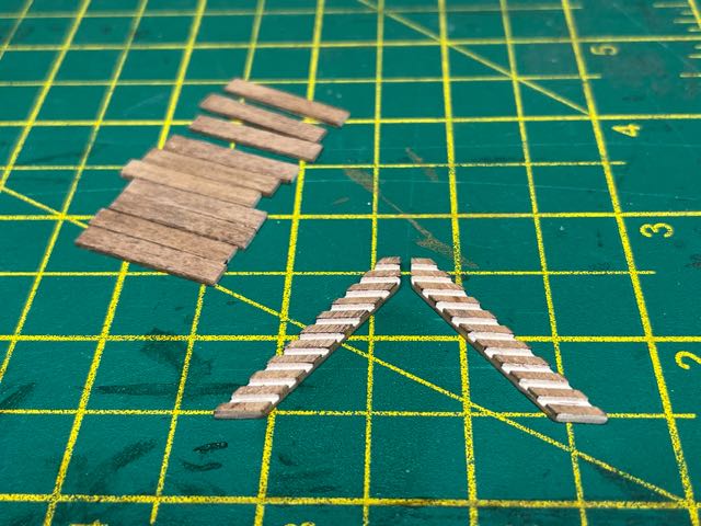

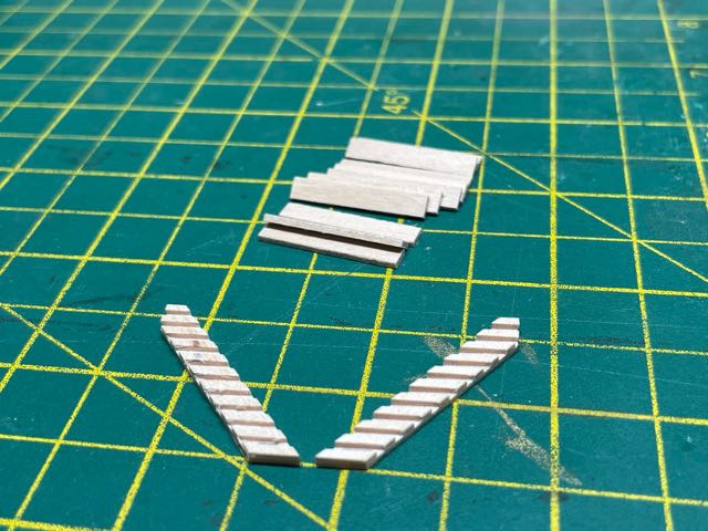

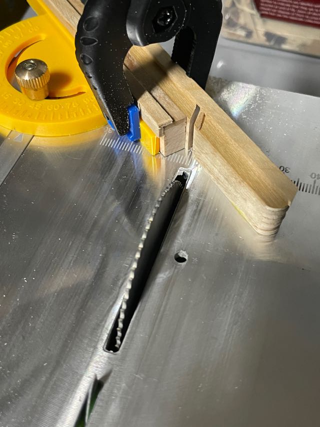

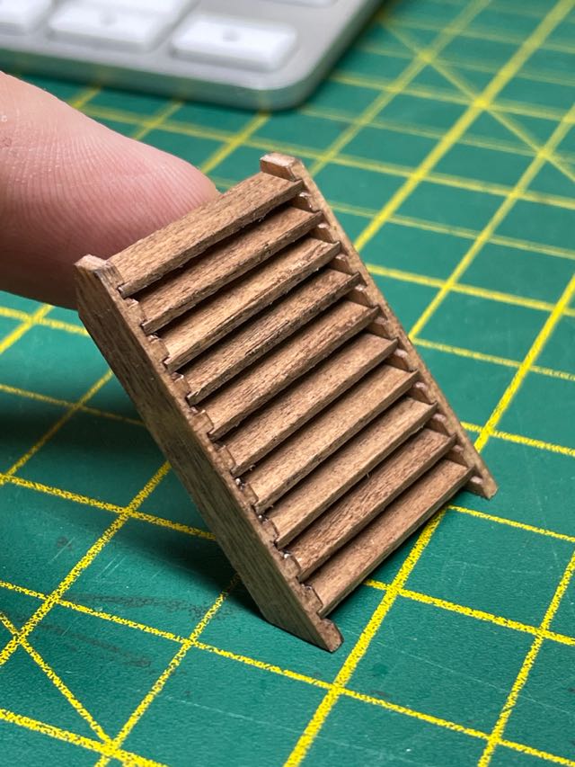

I thought to give it a try to make the ladders myself as others have too.
Firstly, as with so many other things I needed to figure out how to go about it. I have a mini table saw which I thought to be very helpful with the task but since its a very cheap one where nothing is adjustable, it turned out to be a much longer process as anticipated.
I had to make a jig to be able to cut slots in the planks for the steps to slide in. But despite the final cut planks look okay, the jig is not very stable and hard to handle. In addition, the sides of the ladder are mirror opposites and therefore required a second jig, which had to be an exact copy of the first one but mirrored.
And that's exactly where the problem was. The jigs are so unstable and their setup is so flimsy, that the cuts only partially lined up and out of 3 30cm planks for each side I can only get 4 or 5 ladders. So right now I'm not sure of whether to continue with that process. I need better jigs, that's for sure!
But for the current stage I only needed two ladders so it just worked out
Odo

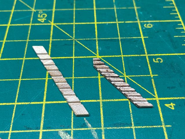

For comparison, the ladder side provided by the kit on the left and my version on the right
