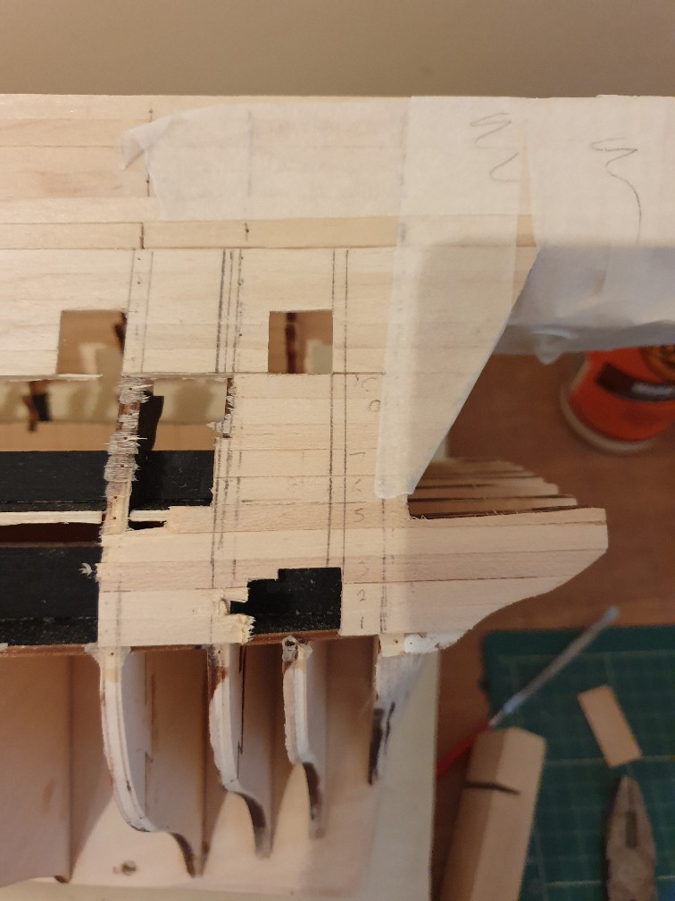

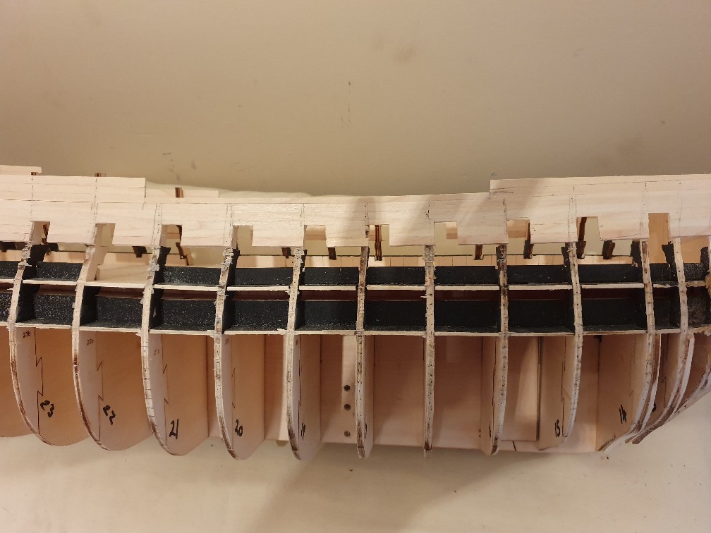

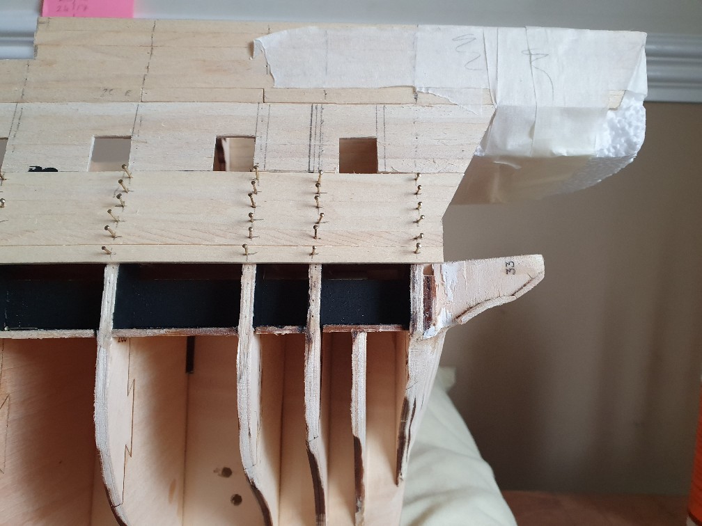

I have moved the repair build back onto my build topic where i really should have put it in the first place.....
As i said on the other topic the replanking of the bow just didnt line up with the planking on the sides on width..
Even though i put the same amount of lengths and butt joined them after a couple of planks placed the butted planks became smaller when next to each other...
So after a while and carefull thought i decided to remove the planks from bow to stern covering the lower cannon ports on both sides.
This will give me a straight edge to work back down the hull.
It does not matter if it adds more time to the build but to me it had to be done and it gave me peace of mind...
Once removed(pics below) i then found some damage from the dropping incident.
Because i could not remove and bulk frames i used the ones the Delboy sent me.
I cut them to size and glued and clamped the into position this will strength the the cracked bulkheads luckily i could not see any damage further up the ribs as they get thinner and shaped so thats a plus...
I have a few bits of planking to remove from stern/transend and then im onto carefully removing the dried glue....

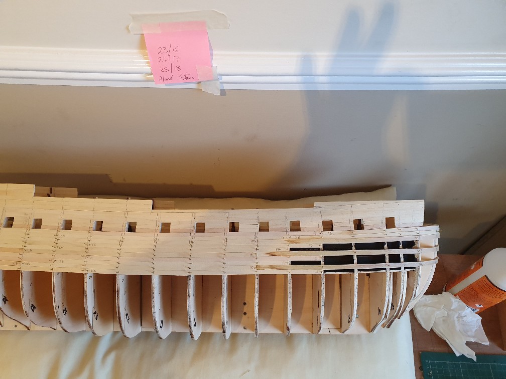

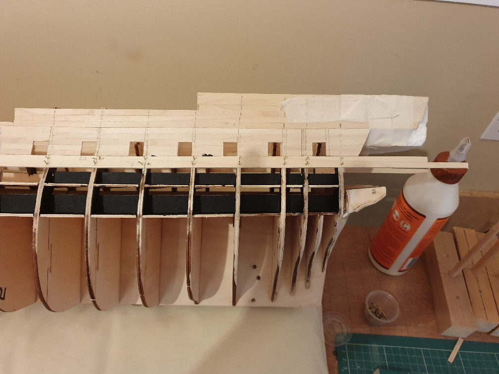

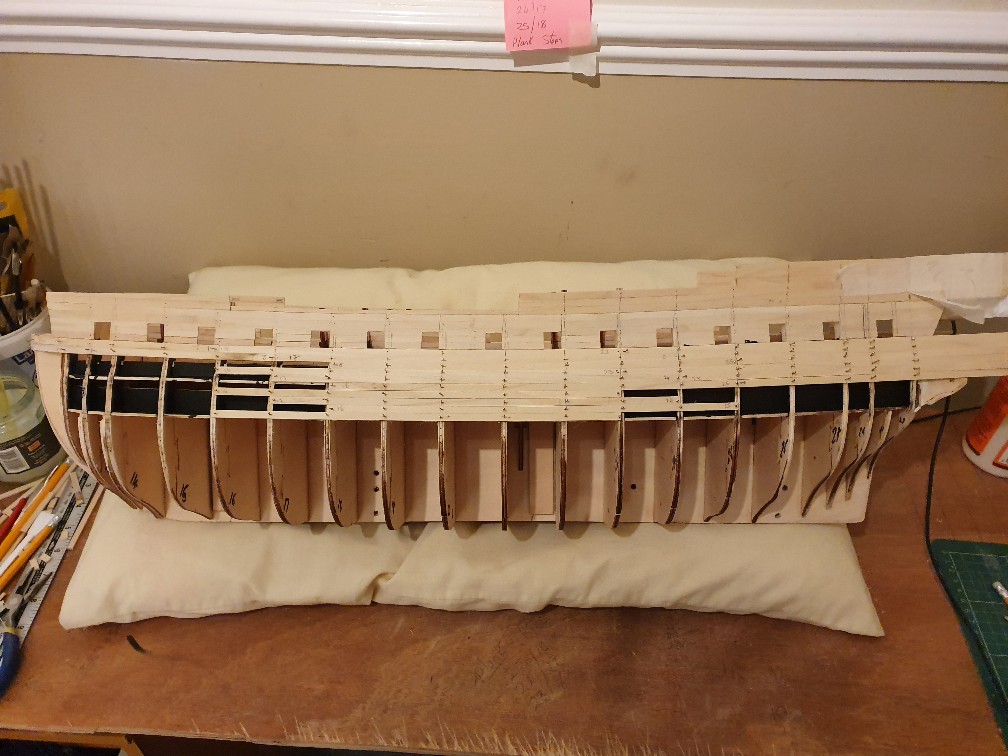

Started to evenly lay the planks yesterday on both sides.
I only pinned down two rows just to gauge how the lie on the ribs and around the bow.....
Ant62 attached the following image(s):

#149 Posted : 06 December 2019 20:54:12
Joined: 29/12/2018
Posts: 223
Points: 671
Location: Lancashire

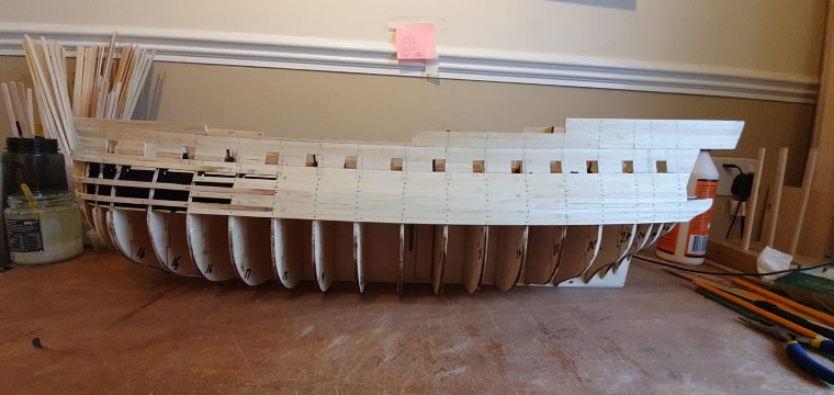

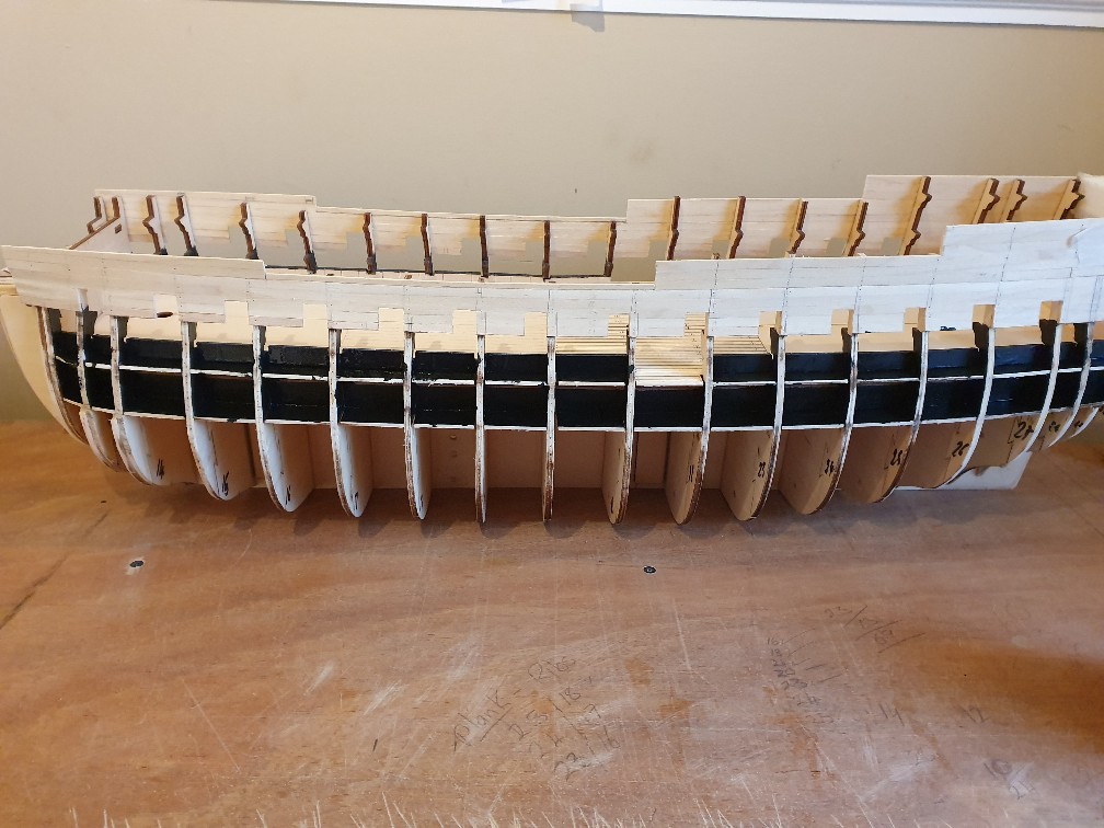

So the big refit(BigGrin) is moving along nicely.
I had plenty of free time the last few days..
One thing i have found out is after i pulled the planks off etc there where bits to do like faring etc.
The picture shows one side but ive evenly planked both sides....

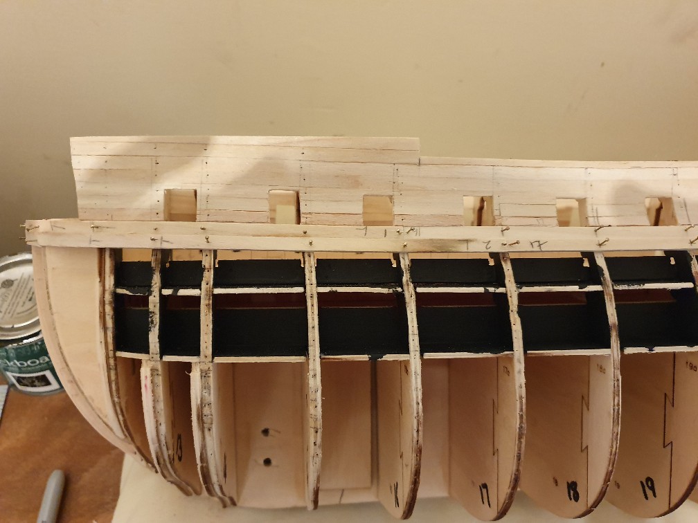

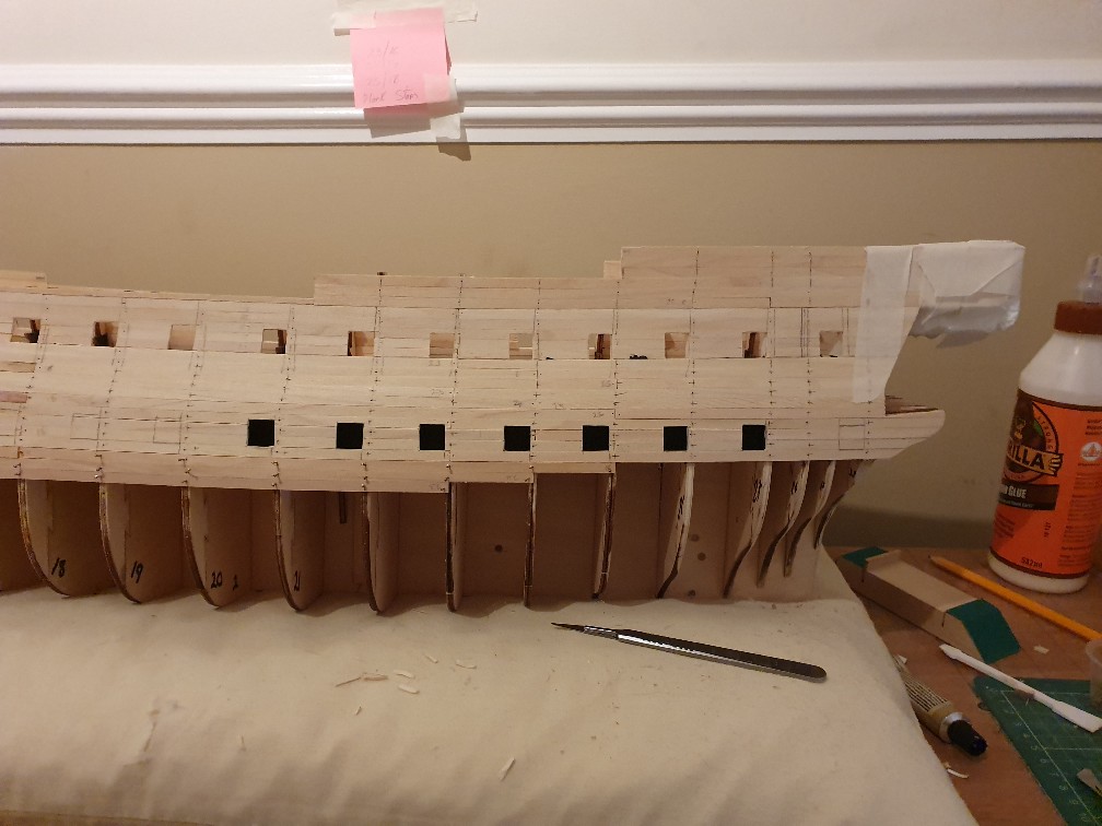

Hopefully by the end of the week im almost back to where i was until the pup got involved..
So basically i will onto cutting out the ports....
As you can see ive a few bow planks to bend and fit also the stern to finish then the ports to cut out..

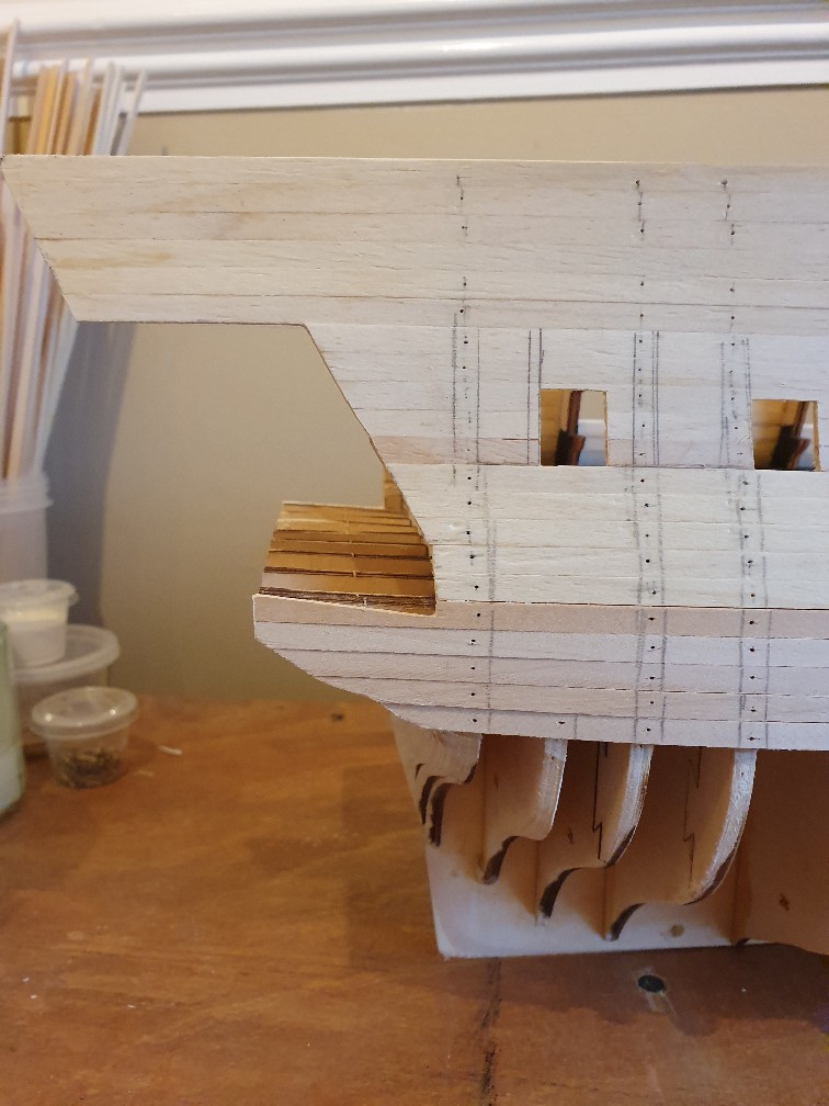

Building.
HMS Victory.....
Corel Albatross 1840......Completed
Hindenberg Zepplin museum piece..Completed
Artesian Latina Sopwith Camel.....Completed
Bismark.........

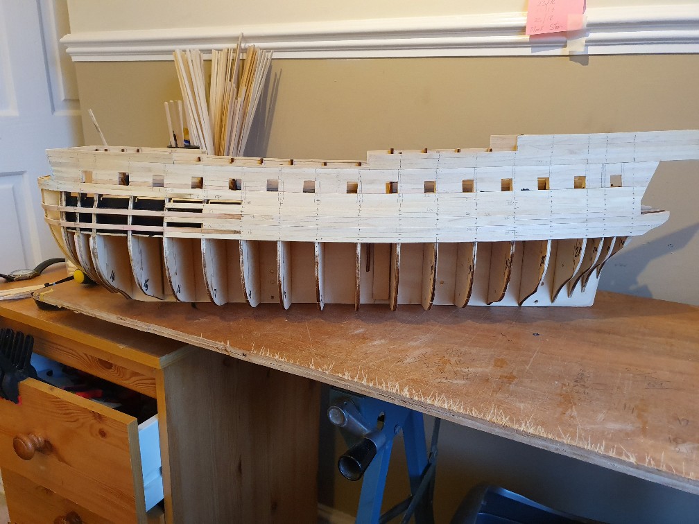

#155 Posted : 09 December 2019 16:25:12
Really good to see this one well on the road to recovery. BigGrin
WTG Cool Cool Cool
Ant62
#156 Posted : 11 December 2019 14:01:15
Joined: 29/12/2018
Posts: 223
Points: 671

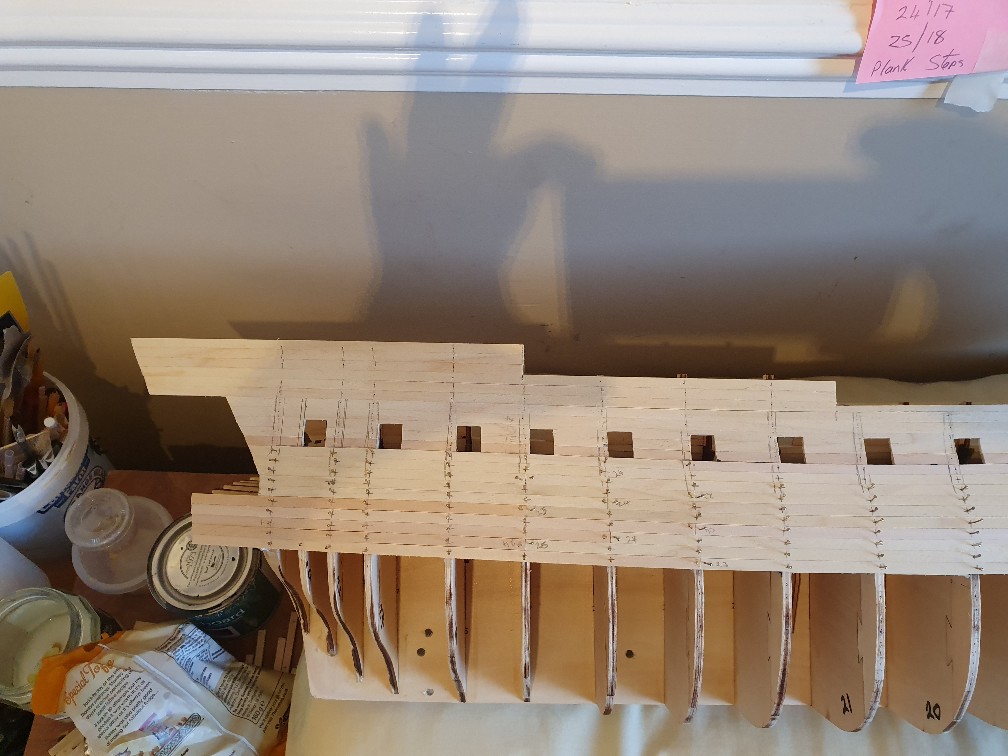

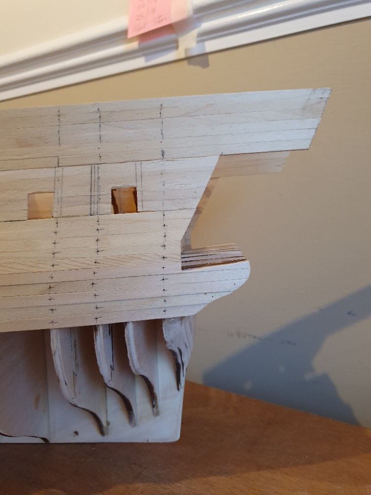

A little progress report...
The transom and the sides are replanked now.
Just the bow to plank.....
The three planks going around the bow with the gaps are just tacked into place as i made the same for each side.....
Its a case of soak several planks bend with the iron then attach one on each side leave to dry then attach 2 more the day after...
Glue them in the morning then a few hrs later bend 2 more and pin then leave to dry......

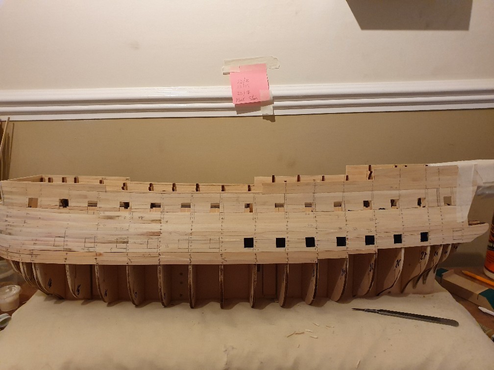

Well im now onto marking out the middle and lower gun ports later today....
Once i have marked out the gun ports thats me done for a few days just happy to be at the point of a repaired ship...

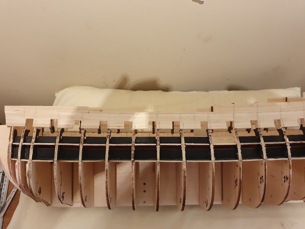

The two pictures show where im upto.....
Im giving it a rest for a bit now......
