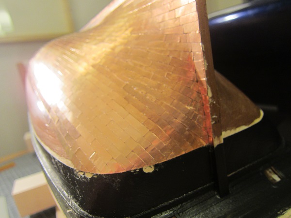

Added a few rows at the stern lately:
When removing glue, some of the black colour was wiped away. Will have to fix that, when the tiling is done.

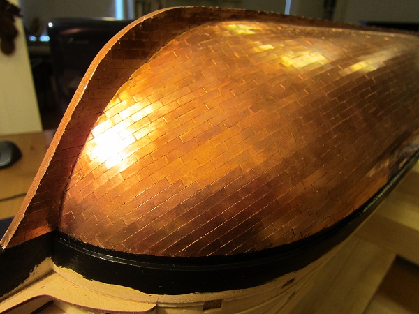

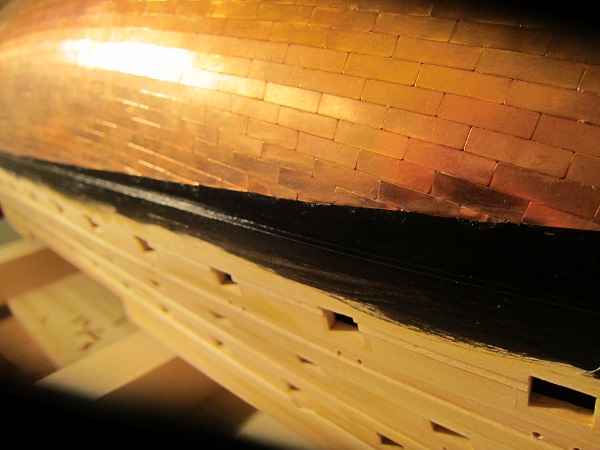

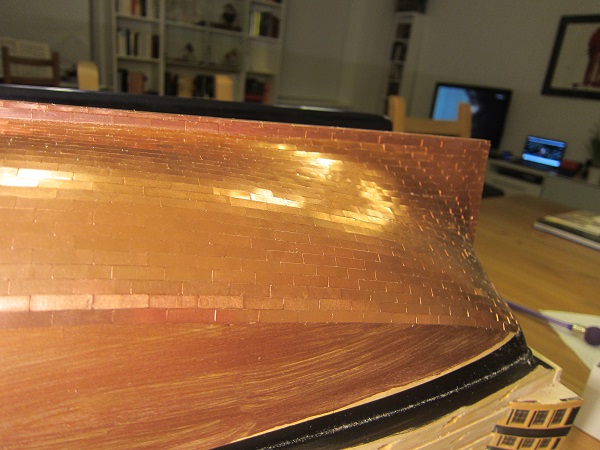

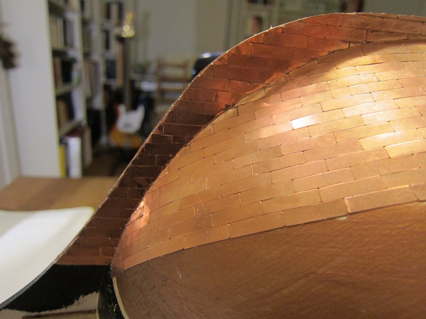

As promised i`ll post a few pictures of my progress.
Up to now i`ve tiled two thirds of the starboard side.
I´ve refreshed the black paint to make the waterline better visible.
As stated i found it very hard to achieve a straight line - it`s far from perfect. But after all i must say, i`m more satisfied with the result than i thought at first.
As mentioned in previous posts i use "UHU KRAFT" adheasive. At the waterline i first glue the whole tile in its place. Then i use a bendable ruler to mark the line on the tile.
Next i remove the tile, which is no problem with the adheasive i use, and cut it to the marked size (either with a sharp knife or with small scissors).
The tile is then glued in its place again.
Here are the pictures:
Now for the rest of the starboard hull!
