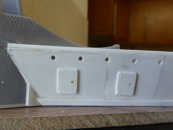

Starboard side.

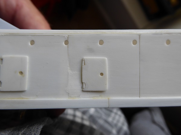

From another angle.

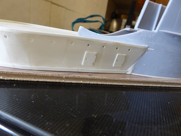

The next step was to add the hinges made from 0.8mm diameter half round strip.

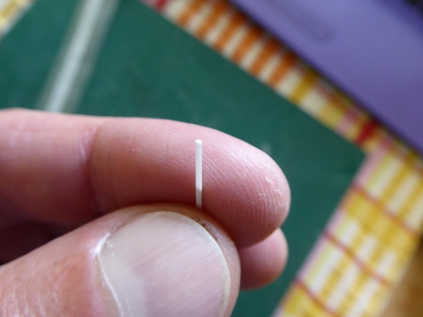

Close up of the half round strip.
#145 Posted : 13 September 2018 08:54:07
I then cut small lengths of the half round strip to form the hinges and glued in place.

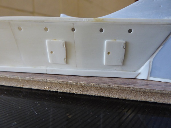

#146 Posted : 13 September 2018 08:55:10
Starboard side completed.

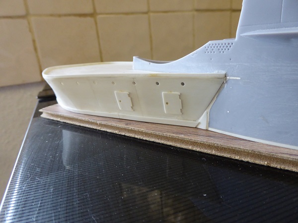

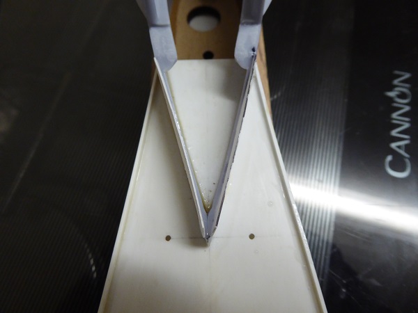

#147 Posted : 13 September 2018 08:55:48
Port side completed.
#148 Posted : 13 September 2018 08:57:32

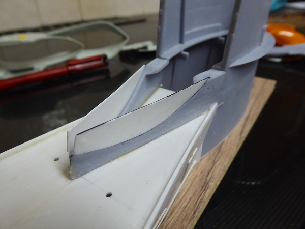

This weeks update continues with scratch building conning tower modifications of my 1/48 scale model of u-boat U230.
The next phase is to build the upper deck. To start with i had to square off the original angled profile by fitting 'filler pieces' made of 0.5mm thick plastic sheet.
The attached photo shows these 'filler pieces' being marked out.

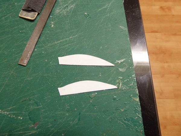

#158 Posted : 20 September 2018 19:42:30
The 'filler pieces' cut out and filed to shape.
#159 Posted : 20 September 2018 19:43:03
The 'filler pieces' fitted.
#160 Posted : 20 September 2018 19:43:59
From above.
