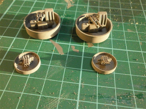

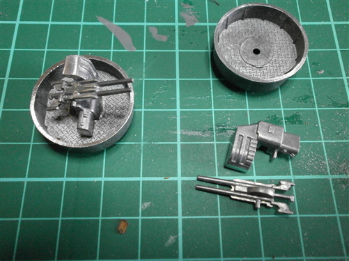

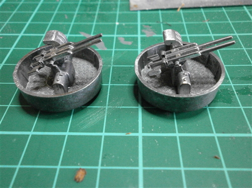

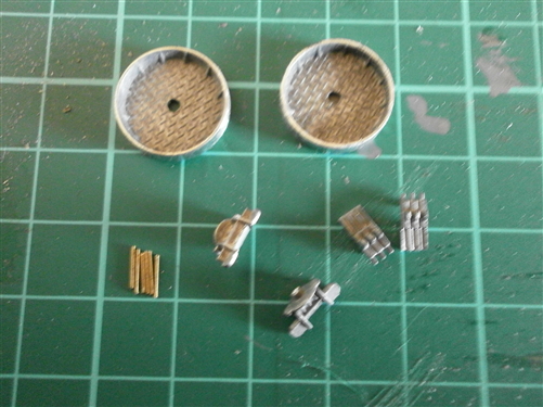

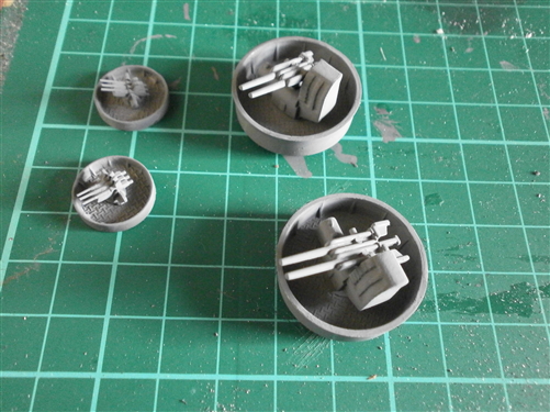

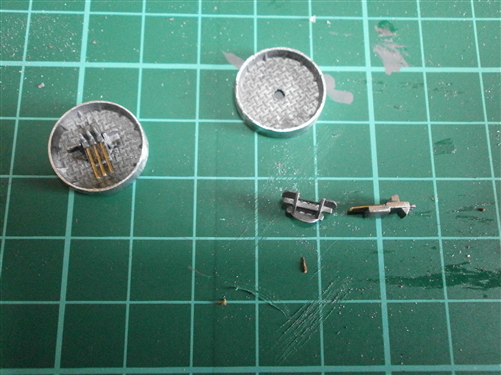

BigGrin Hi All
a few pics of the anti aircraft /machine guns made up as an example, i wont be building more untill its time to permamently fix them in place.As usual all comments are welcome
#145 Posted : 20 March 2012 18:11:49
Coming on well Andy, don't forget to tip the ends of the gun barrels black.

#148 Posted : 20 March 2012 18:50:47
BigGrin I had already painted them just forgot to post the pic Mr TLOL

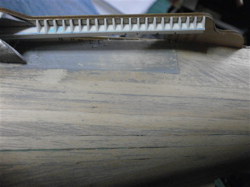

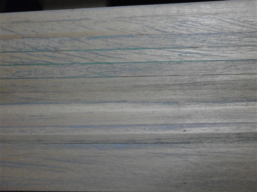

#149 Posted : 21 March 2012 21:59:36

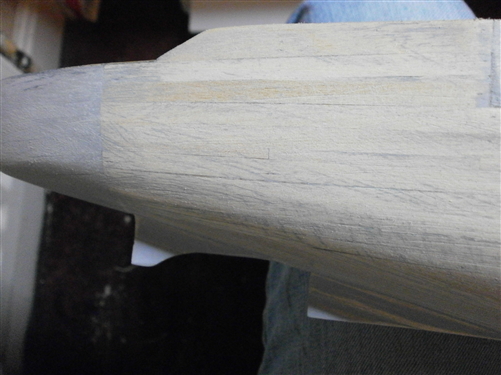

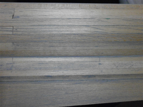

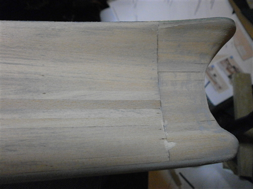

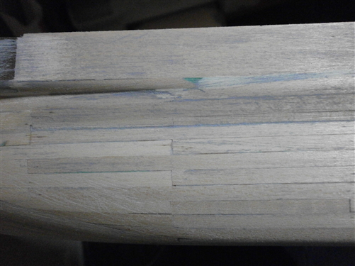

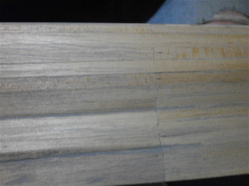

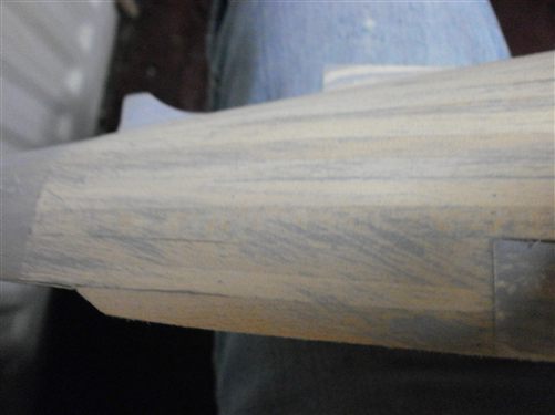

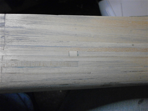

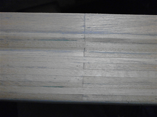

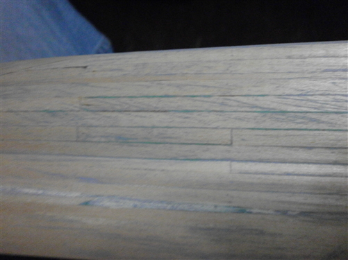

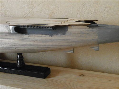

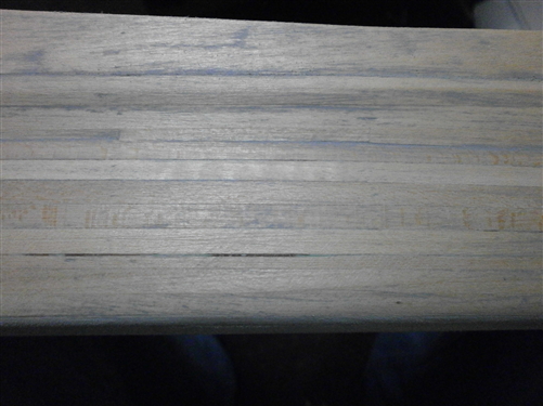

BigGrin Hi All

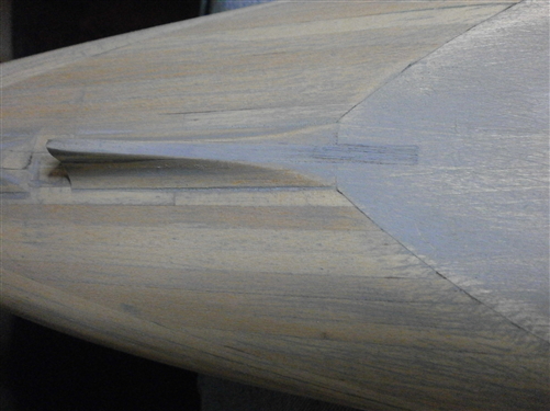

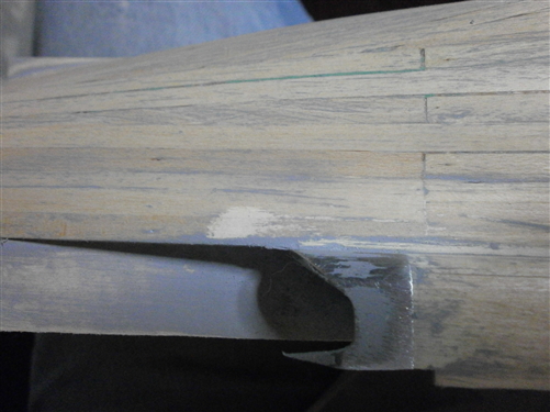

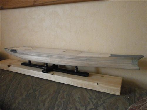

a few more pics of the hull,i proceaded to spray the whole hull with grey carspray undercoat then sanded it all off.This has highlighted any areas that still need some work/filler adding,esentially theses areas are around the bow and stern and look alot worse than they are in the pics belowBlink,there are no gaps in the planking now although it looks like there is in places unless someone spots somthing iv missedLOL .As ussual all comments are welcome

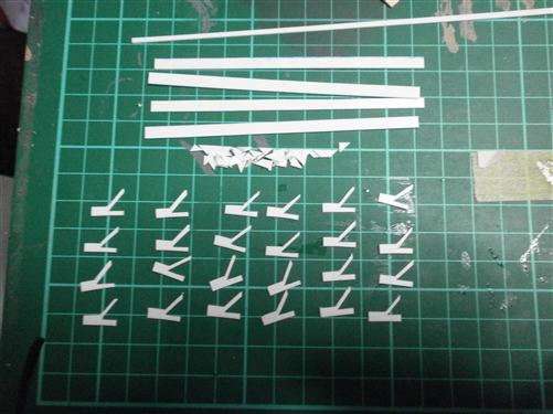

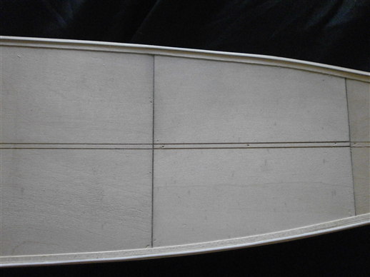

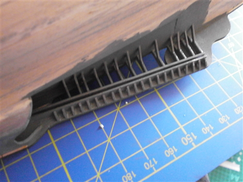

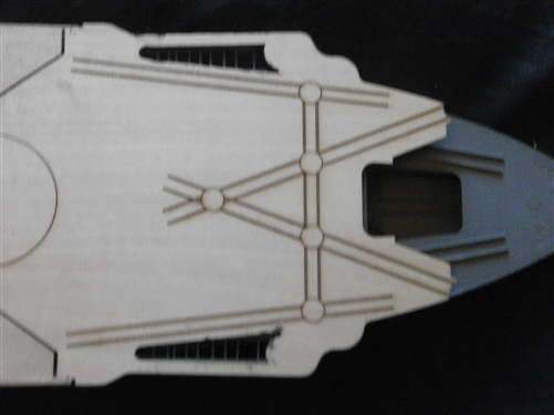

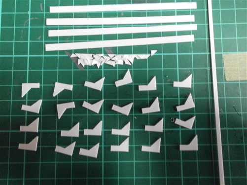

BigGrin Hi All

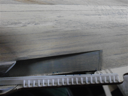

A little more progress on the Yamato,i decided not to use the ply/wood strip components supplied for the boat cranes the reason being that to me they were just too out of scale and instead made replacments out of plastic card.I then proceaded to add the rails and outer fillets before glueing the deck on the hull.The inner fillets will be added when the deck is dry[more pics to follow].As ussual all comments are welcome

#152 Posted : 31 March 2012 22:08:28
BigGrin Thanks Budgie, yes im quite pleased with the planking if you look closely you can see where i used a smidgen of filler in places[the green filler]but overall prety good as i havent done any planking in 10 or more years plus the one obvious mistakeBlink

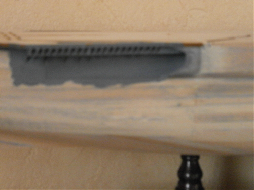

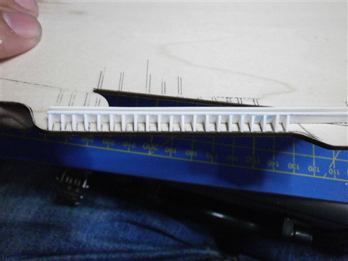

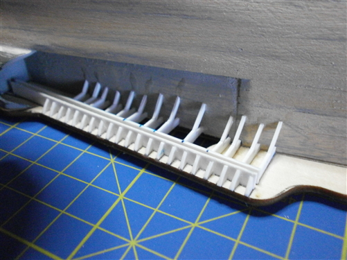

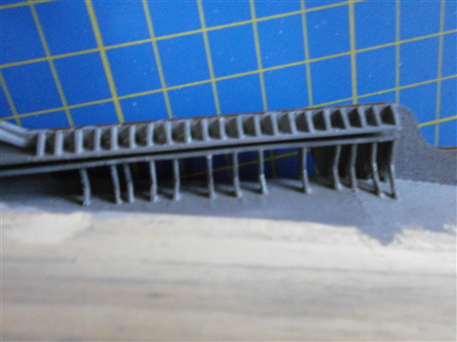

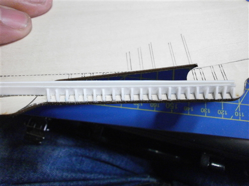

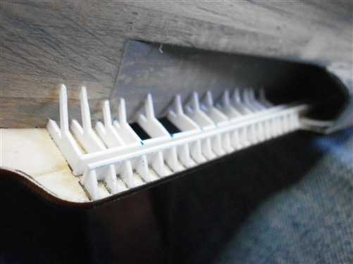

BigGrin Hi All
a couple of pics of the inner girders/crane assembly,overall im quite happy with the results not quite to scale as a small girder is omited at the centre part of the v i cut out.As ussual all comments are welcome
#154 Posted : 01 April 2012 14:32:26
BigGrin Just two more pics of the above undercoated,yes alot of extra work that i think has paid off admirably.As ussual all comments are welcome

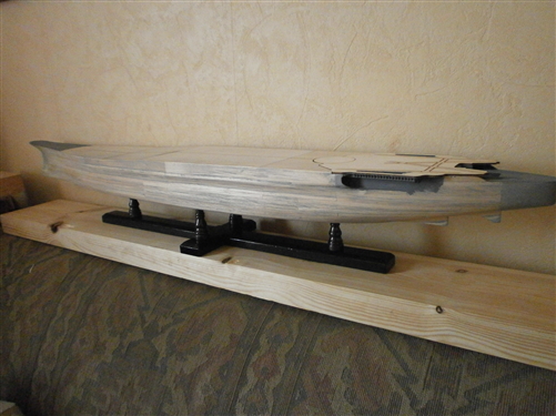

on your next update could you put up a wide shot pic, if possible, just to see everything in perspective, especially your mods in the recent update.
Come on you Jimmies

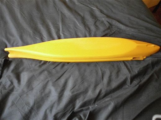

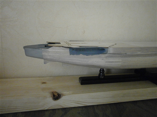

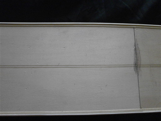

#156 Posted : 01 April 2012 18:57:27
BigGrinThanks for the comments Saintsman encouragment from people on here makes doing a diary worthwhile and no worries heres some pics you asked forCool i hope there what you wanted.I need to do a little filling between the crane deck and wood deck but this will be covered by the planking when its done

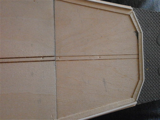

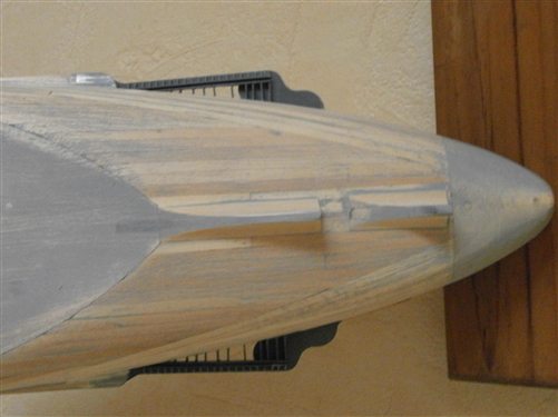

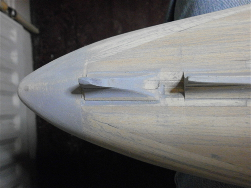

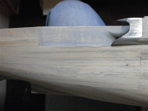

#157 Posted : 14 April 2012 17:17:19

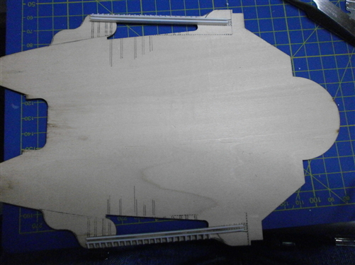

BigGrin Hi all
A little more progress on the Yamato,i have now compleated the deck edge enhancment i was planing for the wooden deck area of the hull.This consists of a sandwich of wood and plastic strip,a lower strip of 3 by half a mill strip with a 2 mill strip on top then a 1 mill plastic strip on that to form the sandwich.Provision has been made also for the adding of the anti aircraft guns to the centre section when i recieve them.
Also a small breakwater has been added to the bow section where the checker plate meets the wooden deck area,a simular type section has also been added to the stern where the wooden deck meets the aircraft/crane deck,finaly iv added the wooden decking edge strip before the actual decking is added.
As ussual all comments/questions are welcome

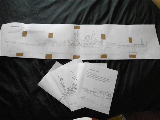

BigGrin Hi all
I have recieved the port and starbourd plans with this months issue showing the position of the port holes and deguasing cables.As im building the Yamato in its final voyage guise alot of the port holes were blanked off so il be using a mix of the suplied blanks and some open portholes iv obtained,also il be adding the third tier of portholes at the bow and stern near the waterline that are not shown on the suplied plans [ just got to work out where they areLOL ]

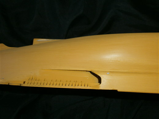

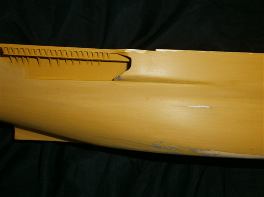

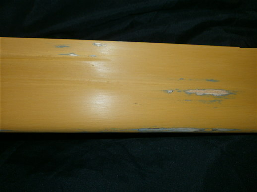

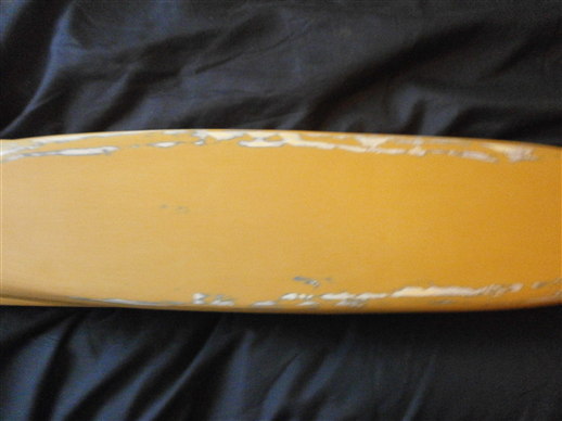

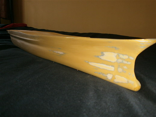

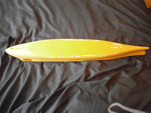

#159 Posted : 16 April 2012 21:45:10

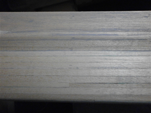

BigGrin Hi All

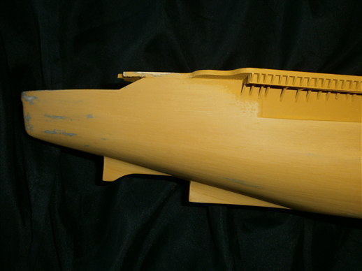

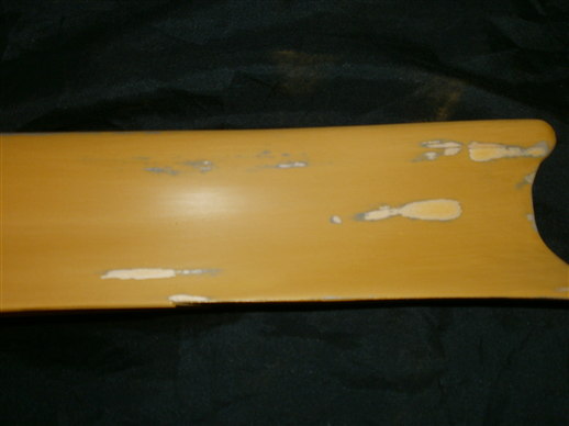

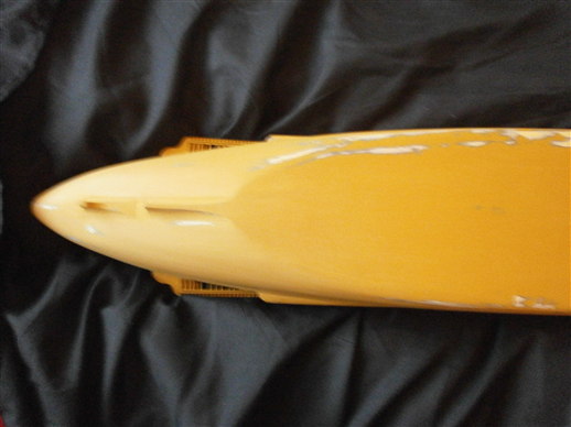

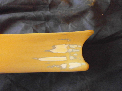

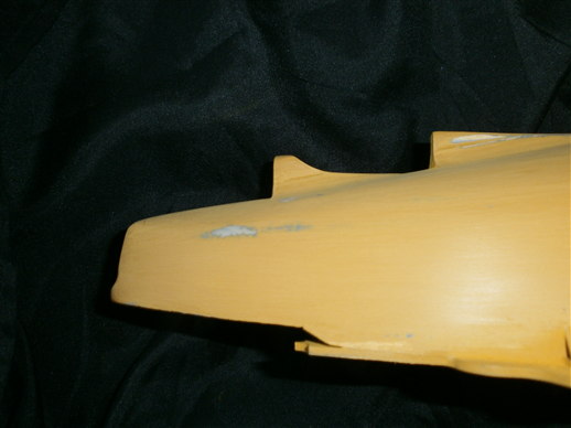

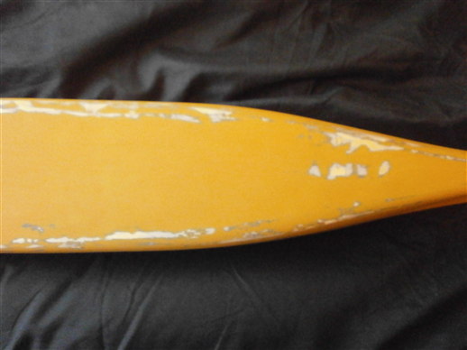

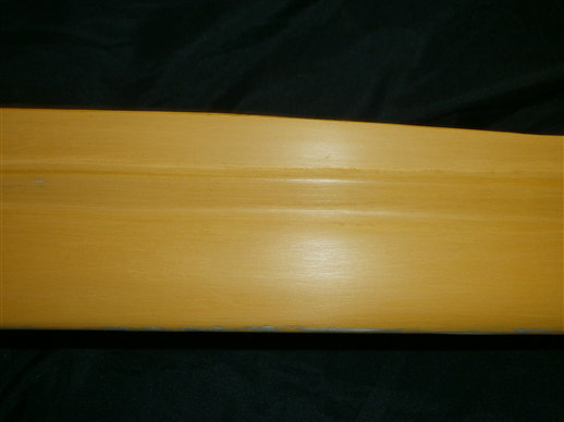

there will be quite a few pics with this post,as previously posted iv sprayed the hull with primer and sanded it all off to profile the hull then 2/3 coats of sanding sealer was applied before a light sanding.

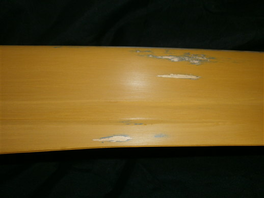

I then coated the hull in grey undercoat again and then on top used a yellow colour spray putty[as you sand back the putty the grey acts as an indicator your getting close to wood],the putty was built up with several thin coats every 15 minites or so untill i was satisfied i had a good even coverage.Now comes the hard work to get a good smooth finish, i used a 120 grit sand paper on the entire hull 1st, making sure any blemishes were removed [ in the pics you will see that the grey paint/wood in parts is showing].
After i was happy with the first sanding i then proceaded with the second sanding using a 320 grit super fine paper to give a finish smother than a babys bottomLOL and last of all a light coat of grey Kure grey.As ussual all comments questions are welcome
