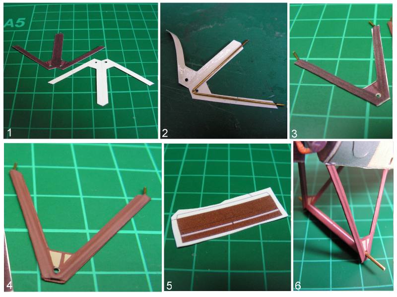

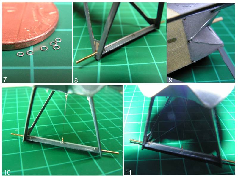

The construction of the undercarriage begins with the first two paper components; the vertical struts. These are formed in a single piece for each side as illustrated in Photo 1. After cutting the pieces out, the 1mm axle hole was then neatly punched out using my new set of Leather hole punches mentioned earlier in the build (so much easier than cutting or trying to drill out the holes!)Cool The next step was to use the wire diagram in the book to form two 0.7mm brass rods into the ‘V’ shape, which forms the support for each set of struts as well as the locating pins to fix them to the fuselage later. In actual fact the book specifies 0.8mm for these rods but I’ve only got either 0.7 or 1mm brass rod to hand and the 0.7 does just fine here. The rod is shown being glued into the first of the struts in Photo 2, note how the brass rod is curved below the axle hole, this becomes even more important in No.2’s up-graded struts later on! Photo 3 shows a completed strut section. The folded over left hand strut is quite easy to get lined up but the other side being essentially two separate pieces of paper is a lot more tricky. Even perfectly lined up however we still have that white edge to the sides of the strut caused by the thickness of the paper and so I’d already decided, rather than simply trying to colour over the edges I would just repaint the whole assembly as seen in Photo 4. The paint used was Vallejo Saddle Brown. This also gave me the opportunity to repaint the little triangular area where the two struts meet at the bottom. In reality this is a hollow area with two welded rods joining the ovoid struts so I repainted it in the colour of the wheel hub – a basic light tan. The two sets of struts are joined at the bottom by a flat (actually aerofoil shaped) cross beam shown in Photo 5. This is folded over and glued together enclosing a 1mm brass rod, which acts as the wheel axle and also ties all three pieces together. I’ve seen some examples of this piece in shaped wood but I’ve not been able to find out if this was how it was originally constructed or not – most other examples are of pre-formed metal casings (as are the vertical struts), the wooden one may be a modern replacement or even an entirely modern reproduction Pup! That grey bar down the middle is the axle itself. I repainted the cross bar before assembling the whole thing together and the result is shown in Photo 6. Despite being predominately paper, the brass wire inserts make this framework quite strong once it’s all fitted together. There is one thing in this assembly, which is essential to get right – those two ‘V’s made by the struts are not, as it turns out, symmetrical! There is a front and back to them and if you get them (or rather, just one of them) the wrong way round when the axle bar is put on it won’t lie straight at right angles to the fuselage. When the struts are first constructed one side of them is fairly flat and the other has a pronounced bulge covering the brass rod. Having glued on the first one with the bulge pointing inwards I naturally assumed the other set went on with the bulge pointing towards the first one. Anyway, it took me ages to figure out why the axle wouldn’t line up but once I’d turned the second strut around everything was fine again!Blushing As you can see in Photo 6, both wire bulges point the same way! This was the point where another major boo-boo came to light. I’d painted the struts a dark brown, they should have been a dark grey! This time it was Revell Aqua Colour to the rescue with Blaugrau or Greyish Blue 79. Having re-re-painted the struts and bar I then had to create some means of attachment for the bracing rigging wires. This was done with the 0.2mm electrical wire strands as shown in Photo 7. If I thought making the rings for Frederick’s ring-mail was bad enough, these are even smaller at 0.7mm diameter (Frederick’s were 1mm diameter!) Incredibly, this 0.2mm wire is too thick for No.2’s rigging points – they will be having 0.5mm brass micro tube turnbuckles which need 0.1mm wire to form the rings with, delivery of that is awaited! What I will be doing on most of the rest of No.1’s rigging is to create and fit ringbolts rather than simply just gluing the rings themselves, these rings are at about the limit of my magnified vision and its easier to make a tiny hole and insert the twisted tail of a ringbolt than it is to grip these little um, things! (A set of better, precision tweezers are also on the way!)BigGrin
The newly Blue-Greyed undercarriage is shown in Photo 8 along with the bottom set of three rigging rings (the right hand one is hidden in the shadows!) Also shown here is a new axle. I was able to paint neatly up to the printed axle the first time around, but with the undercarriage fixed in place that became much harder to achieve. In the end I painted the whole cross bar in the blue-grey and glued on a new axle made from stretched sprue which, just happened to be the right colour without having to paint it! As you’ll see later in No.2’s undercart, the actual undercarriage is a little more complicated than this set!
The upper three rigging rings are shown in Photo 9 whilst in Photo 10 the first central rigging wire is in position. This is the standard size Uschi Rigging Thread and to say it’s fiddly at first would be an understatement! At 0.005mm (five thousandth of a millimetre) the one thing you really need (apart from a magnifying system) is a good set of tweezers (which is why I’ve got a new set on order) if they won’t grip exactly at the tips they’re next to useless for this job! I tied a simple ‘granny knot’ on to the top ring, securing the joint with a tiny drop of super glue and then, after much cursing and threatening the skylight as its next point of exit, I managed to thread the bottom of the Uschi thread through the bottom ring. I tried to tie another knot down there but gave up in the end and simply pulled the thread through and using a spring tweezer gripped the thread back on itself applying another drop of super glue to bond the threads together. Once it was set I could then gently pull on the loose end of the thread, stretch it a little and snip off the excess down close to the join with the micro scissors. Once cut the joint is pretty much invisible. To finish it off I applied some thick and gloopy Humbrol Acrylic Brass with a small pointed brush to simulate the brass turnbuckles. Finally, and apologies for the picture quality, I didn’t notice the flash went off, damned thing supposed to be on manual, Photo 11 illustrates all three bracing wires in position. On this basic Pup I’m going to leave the rigging in its natural black colour but on No.2 I’ll be giving them the chrome ink pen treatment.

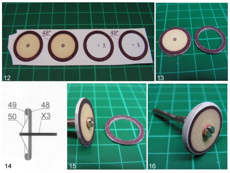

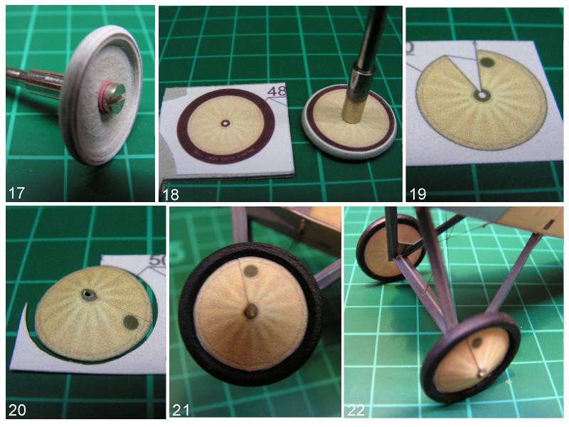

Beginning the construction of the Pup’s wheels, in Photo 12 we have two out of the three components that make up the wheel. Part 48 is the inward facing side of the wheel complete with the tyre and Part 49 is just the tyre section from the outward facing side. As you can see from the asterisk after the numbers, both of these pieces are first glued to the 1mm backing card. Cutting out disks in paper isn’t too bad, cutting them out of the card is a different matter! They can either be cut out using a lot of rotating shallow knife cuts following the exact shape of the outer line or, as in this case, they can be cut out by the straight cut method as seen before on this build, basically, creating something like a 50p coin and progressively doubling the number of straight facets until we end up with something like that seen in Photo 13. The main disk wasn’t too hard but getting that internal section on the outer tyre was a real task to finish – (for task read something else!)Blushing This level of finish was acceptable however as there was another job yet to do on this part, which is illustrated in Photo 14, this is a diagram from the book of instructions. As you can see there, the edges of the printed tyres have to be rounded off by sanding the paper and card sections down, the inner face just on the edge and the outer tyre both inner and outer edges. I came up with a method of accomplishing this hopefully easier than by hand, and certainly faster! In Photo 15, the card disk has been attached to the rotary tool Arbor (the shaft used to screw down a circular saw or sanding disk for a Dremel or similar). The tyre is still waiting to be slipped over the shaft and glued down in this shot although on the second wheel I realised my mistake and screwed the glued together wheel round the other way (I had to do one side on this one and then reverse it for the other, the other way around you can do both sides without changing!) Photo 16 shows the outer edge of the tyre rounded off together with the ‘50p’ facets having been smoothed out during the sanding whilst Photo 17 illustrates the other side (after turning it around) with the inner and outer edges rounded off. As you can see, this is why it’s better to start off this way around – all three ‘roundings’ can be done in one go. It is also pretty apparent that after the edges are rounded off, there’s not much of the printed tyre left! This is also evident in Photo 18 with the first tyre up against the still to be cut out second one. The last component to be fitted to the wheel is the paper cone, Part 50 shown in Photo 19. This forms the cone shaped outer face of the wheel and fortunately is just paper this time, no 1mm card required!BigGrin After cutting out, punching out the central hole with the 2mm? Leather punch and gluing the white tab inside, we have the finished article in Photo 20 and glued in place on the wheel in Photo 21. I painted the tyres with Citadel Chaos Black Acrylic (including the area under the cone) and let that dry completely before attaching the cone in place with the Roket Card Glue. Finally the complete undercarriage assembly for Pup No.1 is shown in Photo 22. You can also see the three bracing wires far clearer in this shot than the earlier one and hopefully also see the reason for re-painting the triangles in the base of the struts in a similar colour to the wheel disks!
In the next instalment it’s back to No.2 for her ‘new and improved’ undercarriage using brass, wood, more resin and a great deal of cursing!

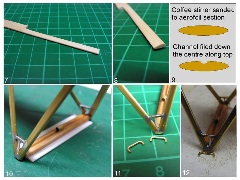

The first thing to realise about the Sopwith Pup undercarriage (and some other WW1 aircraft as well) is that their undercarriage can appear different depending on whether they are on the ground or in the air! Most plastic kits of WW1 planes actually have the undercarriage modelled as though the machine was airborne, that was probably due to the good old days when we received a nice little clear plastic stand for our 1/72 scale Airfix beauties!Cool There are some exceptions to that these days, the excellent if pricey Wingnut Wings range of 1/32 scale WW1 aircraft are highly detailed and include correctly modelled undercarriages (I used their pdf downloaded instruction sheets in the making of my pair here!)Blushing The two variations of the ‘undercart’ are shown in Diagram 1 – unlike most aircraft, the Sopwiths employed a split axle design, instead of a single axle joining the two wheels, each one has a half axle joined by a link in the middle. Back in the Great War there was no hydraulic suspension for the fixed undercarriages, instead, those that actually had any form of shock absorbing used a form of elastic cord very similar to today’s bungie cord or the common or garden luggage straps (the elastic things with a hook at each end!) Basically, the axle passed through the ‘V’ struts to the wheel and was bound to the bottom of the strut by the bungie cord. In flight with no upward pressure the cord secured the axle tight to the cross bar as shown in the top picture. On the ground however, the weight of the aircraft stretched the cord and the axle was pushed up slightly as shown in the lower picture. The bungie cord is shown in yellow here. Pup No.1’s basic design depicts the axles straight but for No.2 – more work again!BigGrin
The first task is to produce a set of micro brass tubing struts to mirror those in the kit. Photo 2 illustrates this under way with three of the tubes squashed into shape in my ‘cut-price’ strutter and the fourth one still to go. Photo 3 shows the first trial version of the strut (which was later discarded as I’d flattened the bottom too much but the experience was helpful!) Also shown here is the internal brass rod ‘V’ which is a carbon copy of the first ones made for No.1. In her case the brass rod supplied the actual strength of the strut assembly, in this case however they simply provide the shaping of the ‘V’ and also the locating pins to glue into the card fuselage later. In order to solder the two flattened tubes together they required some re-shaping at the bottom as shown in Photo 4. The sliced off joint was accomplished with a diamond dust cut off disk on the Rotary tool, the bottoms of the tubes were also levelled off at the same time. The angles not only allow the tubes to butt up together for the soldering but also allow that brass rod ‘V’ to pass up inside without protruding outside the tubes. Note also the two little drilled holes – these are to fit in the little cross bar seen in Photo 3 – there is also a tinier vertical bar as well but more on that one later! Using the kit strut assembly as a template, I drew around it to provide a guide for the brass replacements to ensure they ended up the same shape. The guide is illustrated in Photo 5 along with the first ‘proper’ soldered up strut and the second one still in pieces. The tops of the brass tubes also need trimming back to the length and angle of the original and the marking out is shown in Photo 6 (the struts shown here are still unsoldered).
I had hoped to make the central beam which joins the two side struts together out of flattened brass tubing but encountered a slight problem – the micro tubing with the extra thin tube walls only goes up to 2mm outside diameter and to obtain the necessary width I needed 3mm. I did buy a pack of 3mm tubing but the walls of this diameter material are far thicker than the micro range. Whilst I did manage to flatten it down (with a lot of grunting and effort) I was finding it impossible to get the actual aerofoil section and the central channel, which the axle fits into in flight. After a few botched attempts I decided to abandon the brass and return to good old wood. Photo 7 shows the wooden stock being cut down to the correct width with the leading edge sanded into a rounded profile. Talk about cheap modelling supplies – this is one of my many wooden coffee stirrers ‘obtained’ from the local Tesco Costa Coffee outlet – half a dozen each weekly visit, they soon mount up (and also make brilliant resin stirrers too!) Once the width was correct, the next task was to further sand the trailing edge into the aerofoil profile as shown in Photo 8. The final step was to file out that channel mentioned earlier as illustrated in Diagram 9. Unfortunately my old Corel program doesn’t do aerofoils so an elipse will have to stand in! The central channel was excavated with a variety of diamond dust rat tail files until it was deep enough as shown in Photo 10. A small piece of micro brass tube was super glued in the centre to act as the axle link (it’s bigger than it should be but should look OK once the axle shafts are in). See also those tiny little vertical bars at the base of the struts. Again, I’d hoped to make them in brass like the overhead bar but I found after soldering the struts and that bar together it was impossible to solder anything else in that area without the first three pieces coming apart again. In the end I was forced to make this little upright out of stretched sprue and super glue it in place. The slightly larger triangular space in front of the bar, shown clearer in Photo 11 is where the axle will pass through and the height of that triangle is the maximum amount of ‘suspension’. In Photo 11 we also have the two little brass rod brackets, which will be glued onto the bottom of the struts as seen in Photo 12. These will form the frame around which the bungie cord is wound later. That cord has just arrived from Ebay now – white elastic sewing thread!Blink
In the next instalment, the strut assembly is painted and powdered! And the first of the turnbuckled rigging is put on (cursing not included!)BigGrin

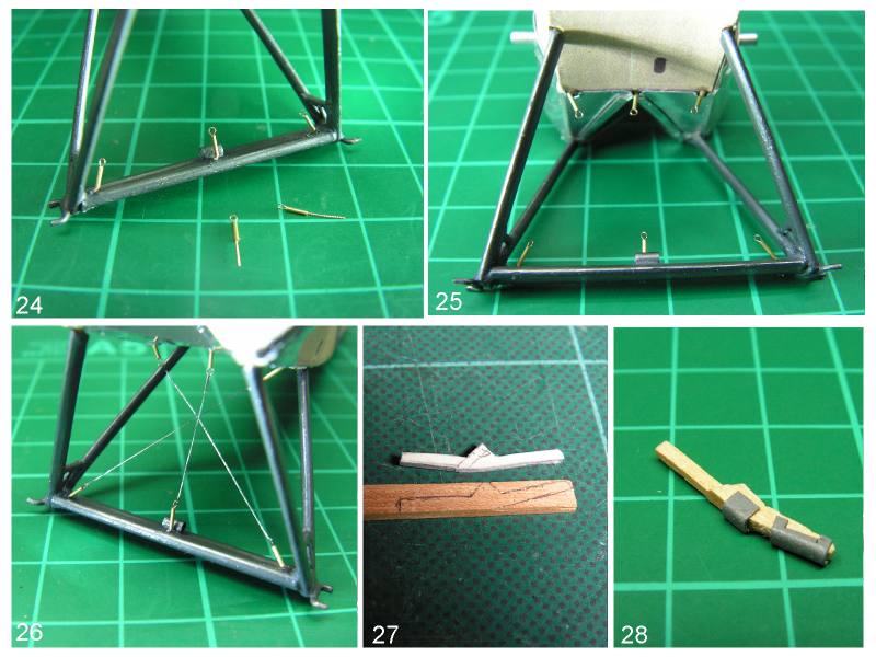

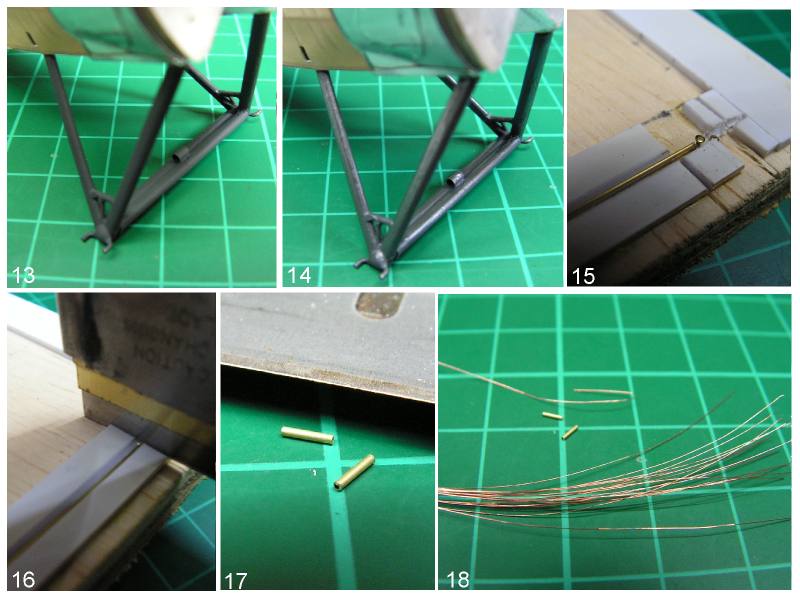

The brass and wood new undercarriage was first given a couple of coats of matt dark grey enamel. I’ve no idea what the name of the colour was, but it is Revell Enamel Matt 78 as seen in Photo 13. This dark grey was simply the undercoat however for the Uschi colouring powder or to give it it’s full title: Metal Polishing Powder Steel Type. This was applied to the matt grey using a cotton bud and polished or burnished up to give the lovely metallic effect as shown in Photo 14. What I completely forgot to show here was the photo of the fuselage all kitted out with green Frog Tape to mask off the paper fuselage around the rear strut. I had taken a photo however and that’s coming shortly! Now I had intended to carefully remove the undercarriage from the fuselage, and give it a spray of matt black primer before adding the steel powder. Unfortunately the ruddy thing began to fall apart as it was coming out so I had to super glue it back into place, gluing it to the fuselage in the process which is why I then had to mask it off.Blink Before gluing the cross bar in place I had carefully drilled small holes in the top surface to take the tiny brass turnbuckles, again, unfortunately, since I had to give the wooden bar two coats of thick enamel paint I never saw those holes again! Instead, I was forced to drill corresponding holes up through the bottom of the bar; fortunately they are so small they’re almost invisible to the naked eye.

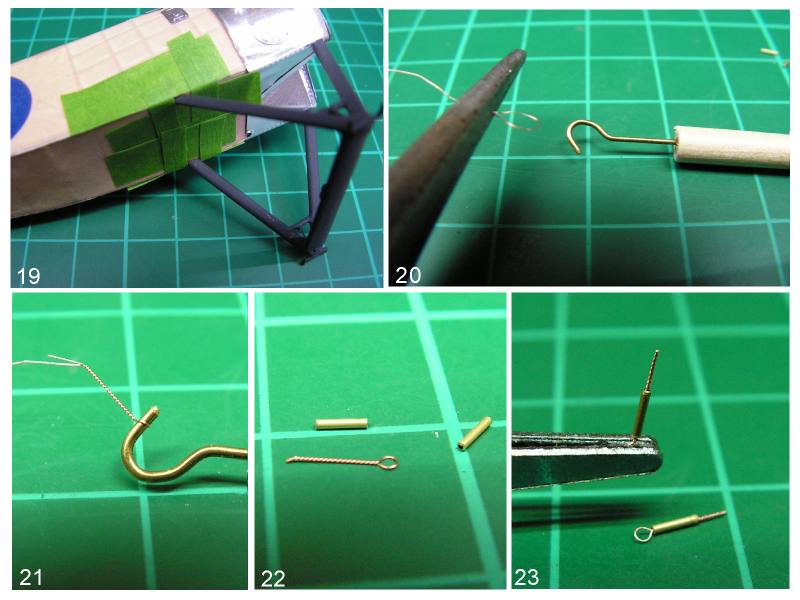

So before the brass turnbuckles could be added, I had to make them up first! Photo 15 illustrates the simple scoring jig made up to cut the micro brass tubing to length. This is simply a scrap piece of plywood with scraps of plasticard super glued in place and filed down into a V shaped channel. A brass pin acts as a stop for the brass tube which is laid in the V groove whilst a sharp blade (safety razor is best) is run along the sideways groove. The brass tube rotates in the groove creating a score mark around the circumference. The tube is then removed and the scored line acts as a guide for the blade to re-score the tube on a flat surface until the tube splits apart. A 0.3mm drill bit is then used to open up any deformation of the tube ends. Photo 16 shows the initial scoring under way and Photo 17 shows the first two tubes cut to size up against the razor’s edge. In Photo 18 we have an illustration of the almost microscopic size of this 0.1mm copper wire alongside the two pieces of tube. In the background is a length of the 0.2mm wire that was used to fabricate Frederick’s ring-mail last year! Before continuing with the turnbuckles, here’s that missing photo of the Frog Tape masking off the struts before applying the steel powder (Photo 19). The tape was ‘second hand’ in that it had already been used for something else and had been left sticking to the edge of my worktop. As such it was slightly less tacky than unused tape, just what you need on delicate paper!
When I made Victory’s Ring Bolts, I gripped a loop of the thicker wire in my pin vice, threaded it over the brass rod former and rotated the vice to create the ring. The new method used on this build is far less cumbersome I’m glad to say and was pinched from examples seen on Youtube! This time I’ve made another new tool consisting of a length of the brass rod which gives the ring diameter bent into a hook and glued into a cut off tip of a cheapie paint brush to form a handle. Instead of having to manually grip the wire loop in the vice each time, the ends of the loop are now just gripped in the jaws of a pair of long nosed pliers as shown in Photo 20. The little hook tool is then placed into the loop and twisted creating the tightly wound tail to the ring as shown in Photo 21. The ring and its tail are shown against the brass tube in Photo 22 and in Photo 23 one turnbuckle is finished and the other is held in sprung tweezers awaiting a drop of thin super glue to be applied to the end of the tube where capillary action will draw the glue into the tubing fixing everything together.
With the first six turnbuckles made up it was time to fit them in place. The first set were for the cross beam as shown in Photo 24. As mentioned earlier, the holes previously drilled into the top surface of the wood had been obliterated by the thick coats of enamel paint and so I had to drill another set up from the bottom, as they are only 0.35mm in diameter they can’t be seen (unless you pick the model up and peer very closely!) These were glued in with a tiny drop of the Roket Card Glue, the two 0.1mm copper wires twisted together giving a fair degree of flexibility when fixed in, this allows the turnbuckle to be angled to follow the run of the ‘wire’ once fitted on. The second trio were then glued into the same tiny holes drilled through the cardboard fuselage bottom, each one nestled in its little ‘alcove’ punched into the aluminium cowling bottom as seen in Photo 25. The final task for this part of the undercarriage was to install the Uschi Rigging Thread. I started at the top centre turnbuckle, tying a simple knot with the thread and securing it with a drop of super glue. I then threaded the free end of the thread through the corresponding bottom turnbuckle and pulling it back with just a slight amount of elastic tension held the end of the thread as close to the first run as possible (touching together down at the turnbuckle) and another drop of super glue secured them together. After a minute or two the excess ends of the threads were stretched out away from the run of the ‘wire’ and snipped off close in with the micro scissors. Because it was under tension when cut, the snipped off part springs back in tight and is practicably invisible. Repeating this for the two cross wires I then carefully applied the chrome ink to the black threads, on the end of a cocktail stick down by the turnbuckles and simply with the pen nib along the rest. The result, giving a lovely effect of a steel wire is seen in Photo 26. All that remains now is to add the split axles and the pair of wheels, but as the wheels are another scratch built resin upgrade that’s a separate instalment coming soon! In the meantime, for the final two photos, here’s the item I completely forgot to include earlier – a wooden tailskid! The one thing that No.1 has taught me is that the integral card tailskid is extremely vulnerable to damage during construction! The skid is fitted in during the earliest stages of the fuselage carcase building and after that, everything else that is put on from the fuselage skin cladding to the undercarriage etc, puts it at risk of collapsing when pushing down to glue something in place and forgetting that the skid is sticking out. Because of that I decided to cut the skid out from its bulkhead on No.2, to be slid back in when all the pushing and pulling was done. Once it was cut out I then decided to go the whole hog and replace it with a wooden version, which could still be put in at a later stage. Photo 27 shows the original skid on its 1mm card backing after removal from the bulkhead. As you can see here, its removal simply leaves an empty slot in the bulkhead, which lines up with the cut out in the tail. Below the card original is a piece of well seasoned old wood on which the outline of the skid has been pencilled in. This was cut to size and sanded down, especially on the peg end, which has to just slide into the fuselage. Then the little black add on paper pieces which formed the iron re-enforcements on No.1 were used to cut replacement parts from the DecraLed sheet lead and glued into place as shown in the final Photo 28.
