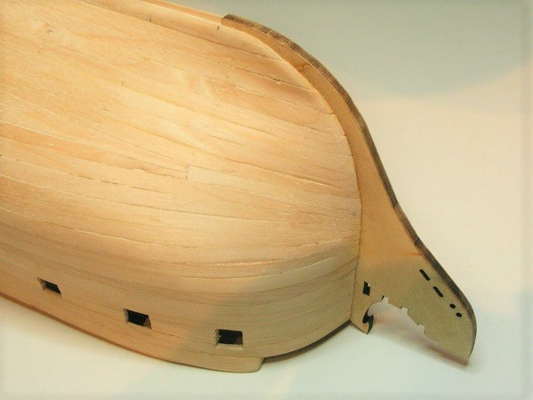

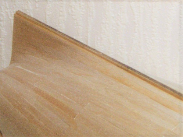

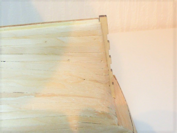

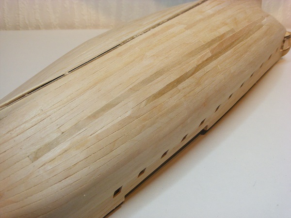

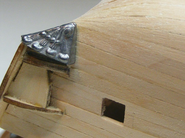

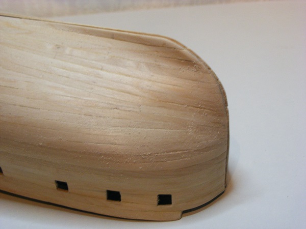

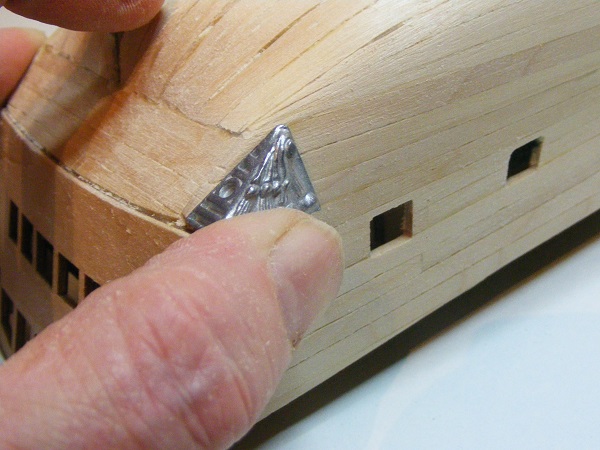

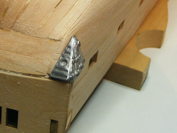

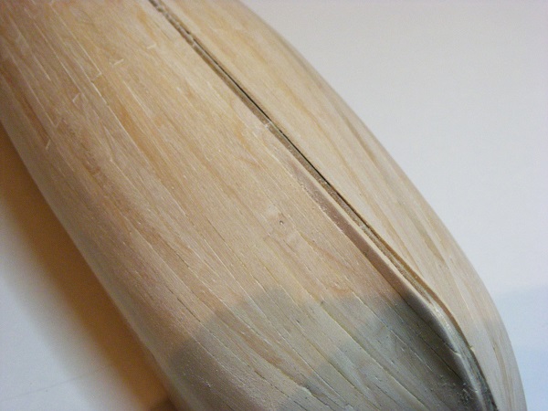

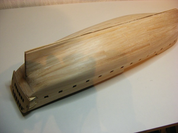

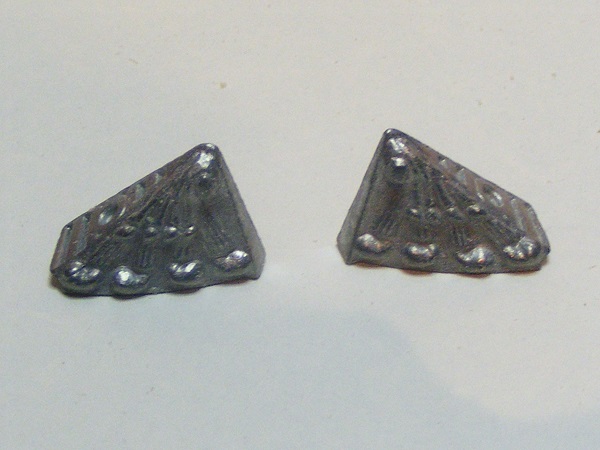

Now that the Victory Launch is complete and I've settled into my new workshop its time to get back to building again. Thought I'd make some progress with this one. Have now completed the planking ensuring I've left the necessary 4mm gap for the fitting of the keel and have also given the hull its first rough sanding. No filler has been used yet but will need to be used a little later on. All I'm looking for here is to get the rough edges removed and getting the shape right. A word of caution when you get to this part, take care when you are sanding the stern area. There are two cast metal parts to fit so you need to be test fitting these as you go along so as to ensure you have a good fit later in the build. These stern parts are not fitted until stage 64 and by that time it will be too late to make any major adjustments.
Next to be done is the fitting of the keel, stem and stern post, hopefully that will be done tomorrow evening.....Cool Cool

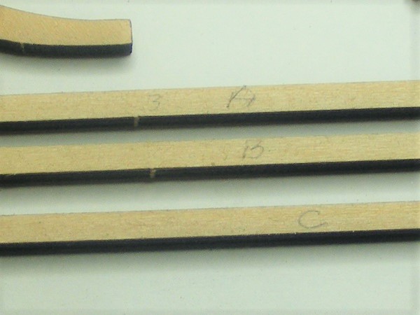

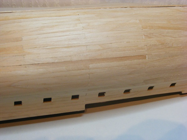

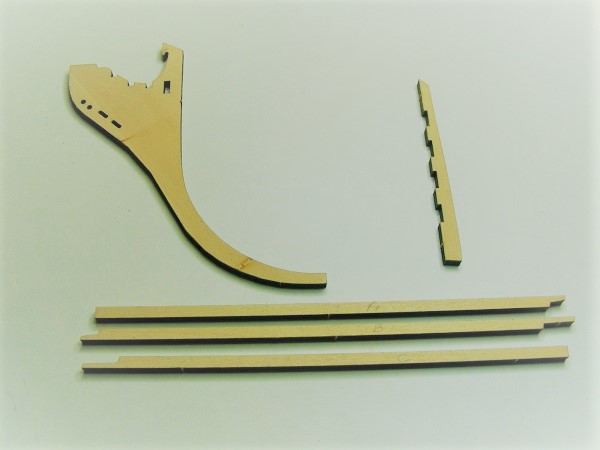

Tonight I completed stage 12, the fitting of the Stem, Keel and Sternpost.. Started by removing the items from their frets and cleaned all edges of imperfections and burnt ash. Also, on removing the three keel strips I marked them A, B and C so as to ensure they don't get mixed up.
First item was to carry out a test fit and during this process I found some minor adjustments were needed to the 4mm slot along the hull, did this using a fine nail file as I found the fit was just a little to tight for my liking. Once happy I then glued the Stem in place and left it to dry before carrying on. Then went on to glue the three keel strips in place. The fit was good enough that I found it was not necessary to hold the strips in place with either pins or masking tape. Last item was then to glue the Sternpost and everything is now let to dry thoroughly whereupon I will then trim the Sternpost level with the keel.
Next on the agenda is to get the filler out and to prepare the hull proper for painting. This will be started tomorrow so until then, happy building all....Cool Cool
