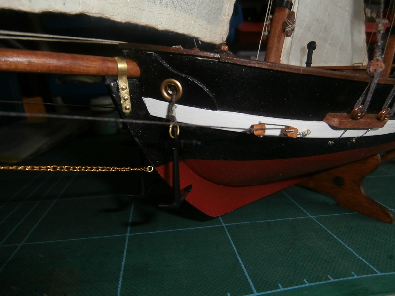

Thanks again for the comments, now for the final leg.

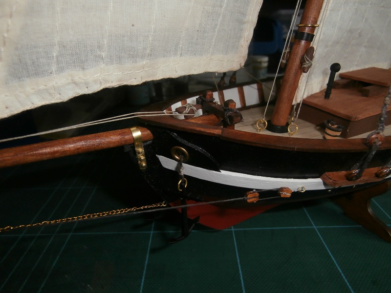

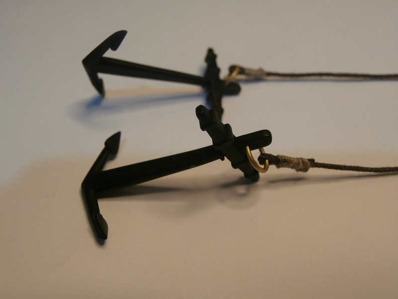

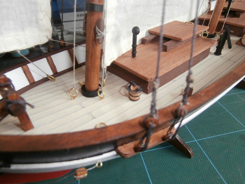

Thick lines were lashed to the anchors, Pic 1 and then passed through the hawsepipes and tied off at the fore pin rail, Pics 2 & 3.

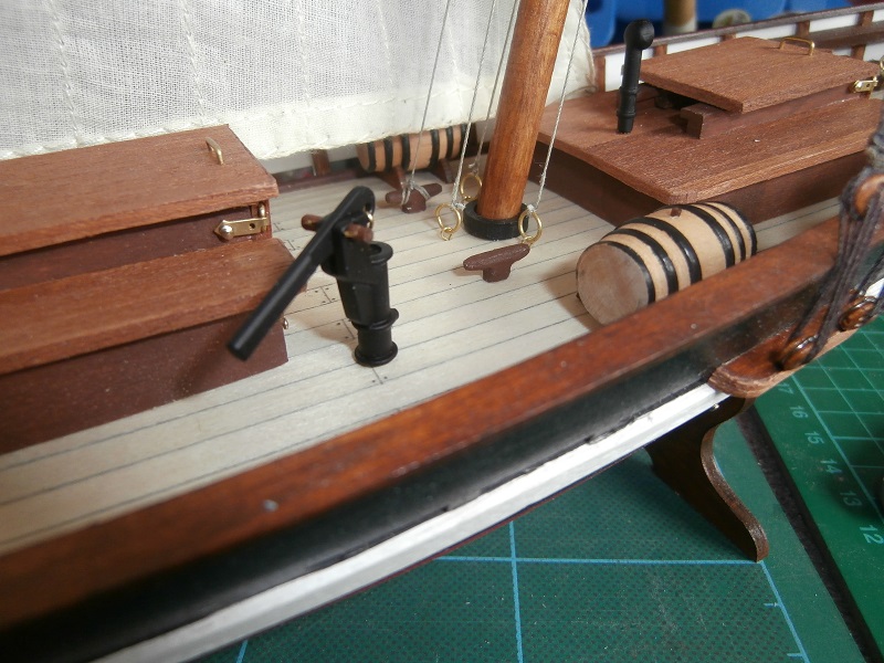

The pump, buckets and barrels – all made earlier – were then fixed to the deck, Pics 4 & 5.

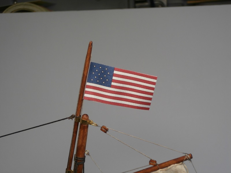

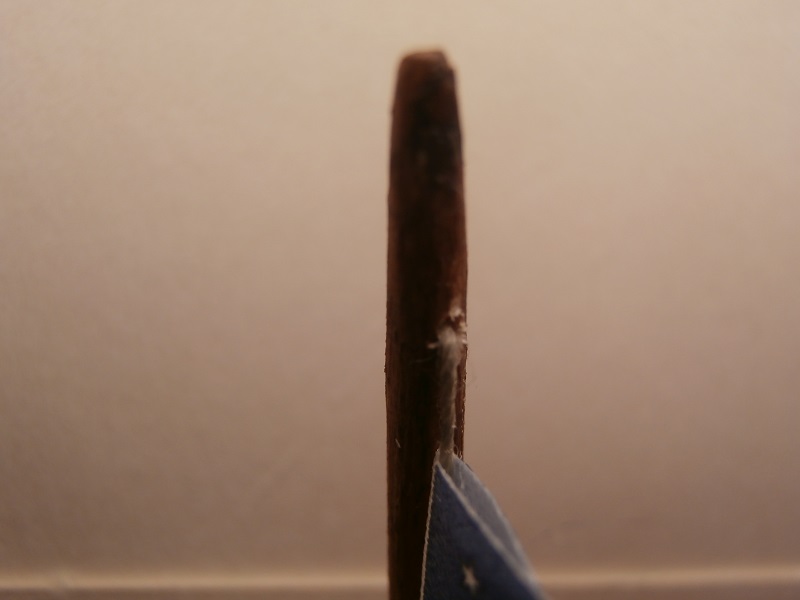

The final bit of rigging was to raise the flag. This was fitted to a line which runs from the deck, up through a hole in the top of the upper main mast, Pic 6 and then back down to the deck. Pic 7 shows the flag in place.

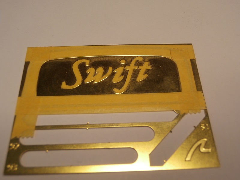

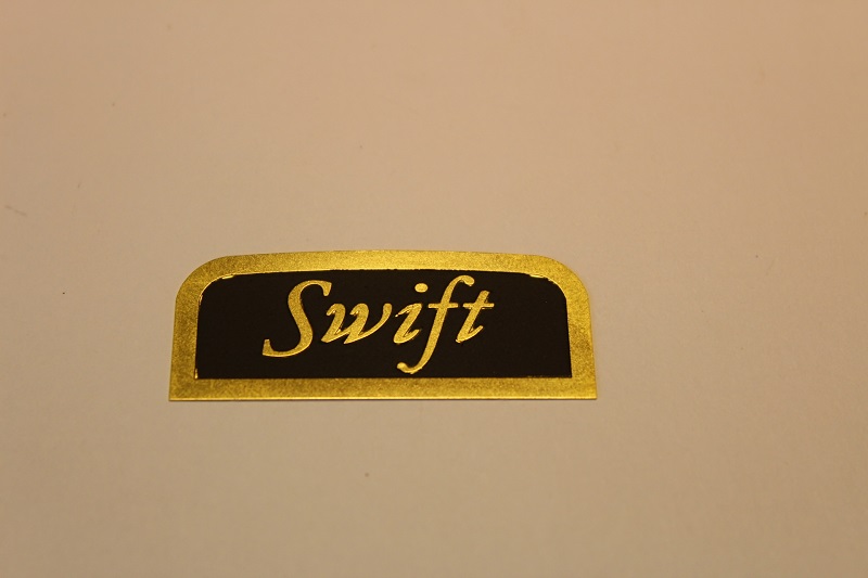

The name plate was then painted. The instructions said to paint the whole plate black then rub it on fine abrasive paper to remove the paint from the raised name and border. I chose to mask off the name and border before spraying, Pics 8 & 9.

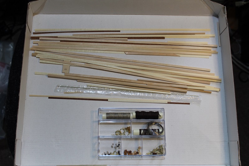

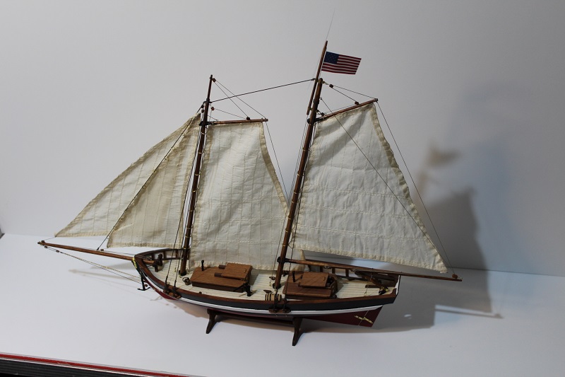

Well, that’s it for the build. I have thoroughly enjoyed the build, the only slight challenges being gluing down the deck as it is curved in two directions and fitting the bulwark pieces (for the same reason) but these were easily overcome with a little forethought. There was plenty of material included in the kit to complete the Swift, Pic 10 shows what I had left at the end of the build.

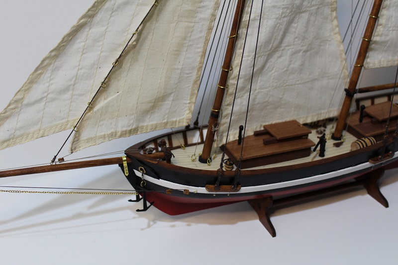

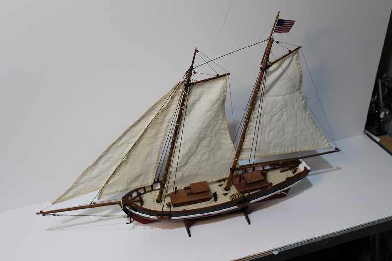

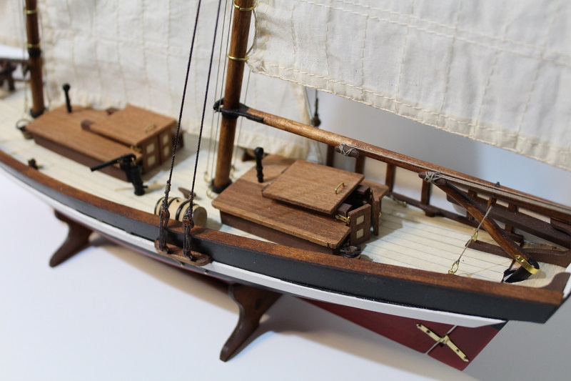

Pics 11-14 show the completed model. I have ordered clear acrylic to build a display case for the Swift and will post pics here once the materials arrive.

Graeme your doing a superb jobDrool Drool love it Love the detail and the quality of the build is first class BigGrin regards PhilCool

Wonderful build Graeme!!
One question: If i understand this right some of the lines that handle the sails are attached to some rings on the deck. How could they move the sails this way?
I hope you don`t mind my asking! I`m planning to buld this model as well - so this is of great interest to me!

Cheers guys. Walter, I'm not a expert on period ship rigging but I've read that some lines e.g. haylyards, were tied using a bowline knot which gets tighter under tension but is easily released to adjust the line so would work in this instance.

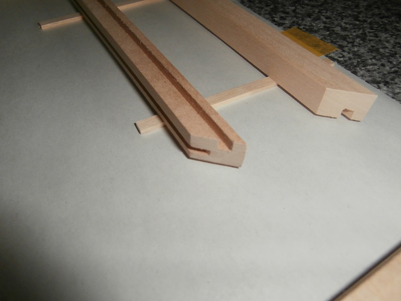

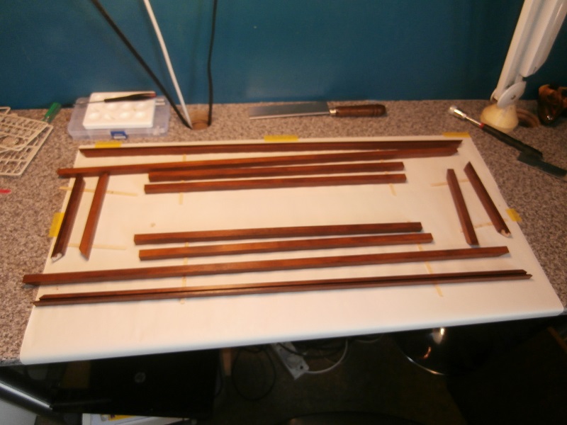

Now for the final update of this build, the display case. I ordered the clear 3mm acrylic cut to size online and used display case section from CMB for the frame. The display case section is 12mm square timber strip with either a single 3mm groove cut into it or two grooves cut into adjacent sides, Pic 1.

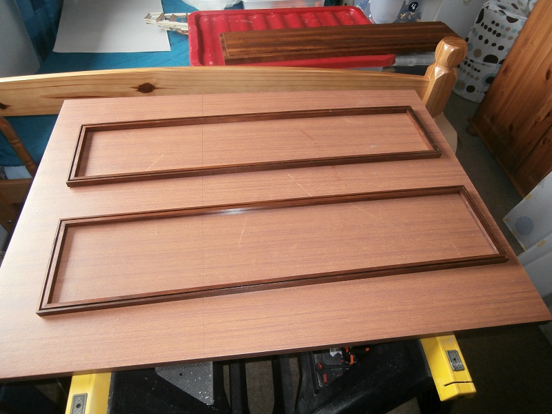

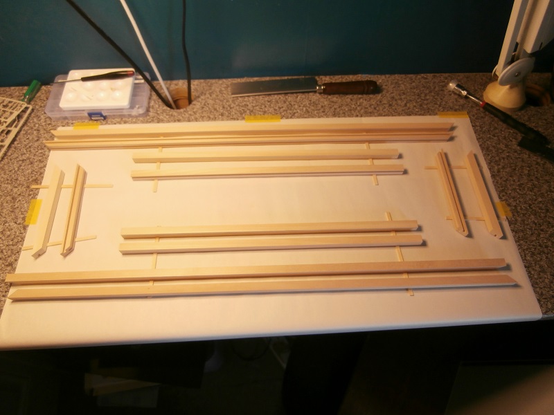

The display case section was cut to size using a mitre block and good quality razor saw, Pic 2. The single groove section is used for the bottom of the case and the two groove section for the rest. The frame pieces were then stained a walnut colour prior to assembly, Pic 3.

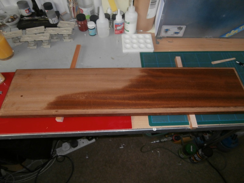

The display case base was made from a piece of hardwood I had lying around, cut to size and a 12mm rebate was cut around the upper face for the case to sit in. The base was then given 3 coats of Danish oil. Pic 4 shows the first coat being applied – I used a piece of lint free cloth to apply the oil.

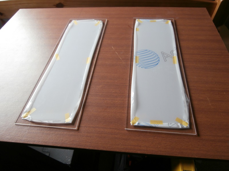

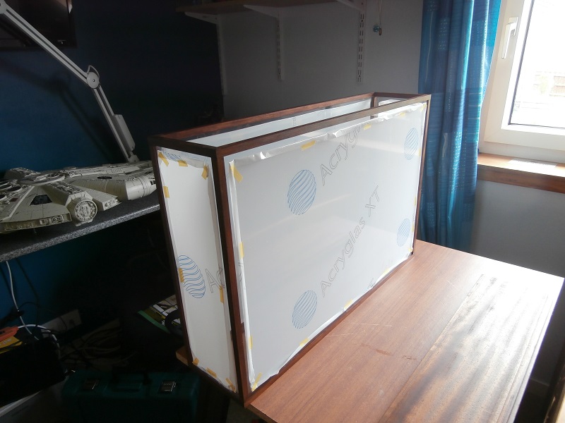

The protective covering on the acrylic was then peeled back from the edges on both sides and taped down. I did this so the acrylic could be fitted into the frame without removing the film completely to reduce finger marks, dust etc. getting on the acrylic during assembly, Pic 5.
Pic 6 shows the bottom frame assembled (upper frame in the pic) and the top of the case assembled with the acrylic fitted and film removed.

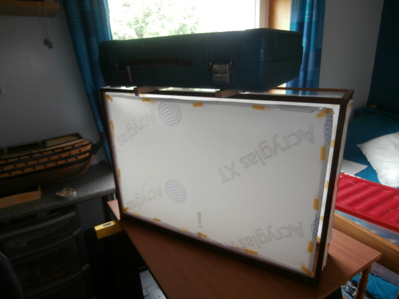

The bottom frame was then placed on the base and the side pieces of acrylic slotted in place with the upright frame pieces being slid into place as the frame was assembled, Pic 7 – this was done without any glue at this stage to ensure everything fit into place correctly. Once I knew all was well, each upright was slid upwards in turn, glue applied to the bottom corner and the upright piece slid down again join the frame pieces. The top section of the frame was then glued in place and the case left to dry, Pic 8. As can be seen in the pic the top of the frame was weighted down whilst the glue dried.
Once dry the case was turned over, Pic 9 in readiness for removing the film from the inner faces of the acrylic.

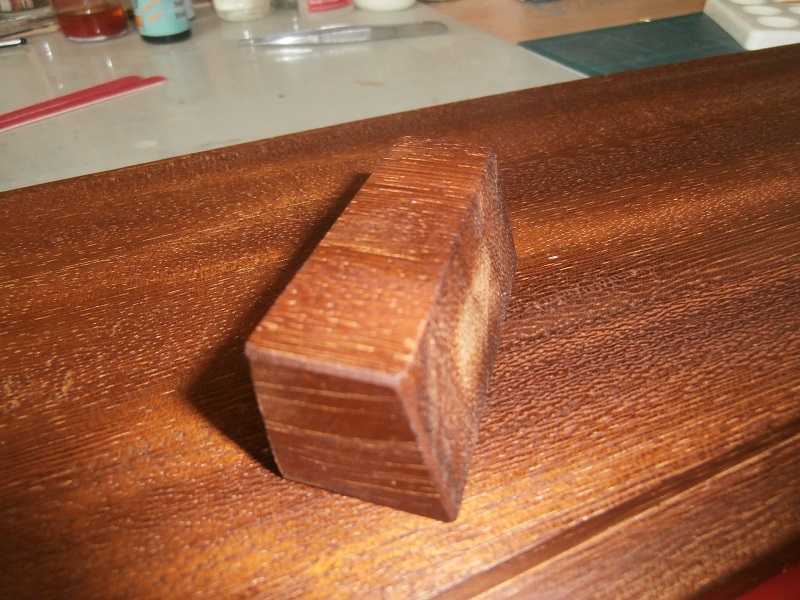

An offcut of the hard wood had one face angled and was Danish oiled, Pic 10, to hold the name plate.

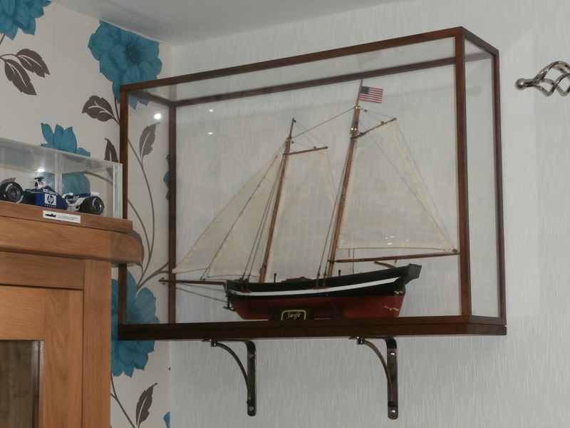

The Swift’s stand was then glued in position on the base, the name plate fitted and the Swift put into place. All the protective film was carefully removed from the acrylic and the case place over the ship and fitted into the rebate on the base.
Pic 11 shows the finished Swift in her case mounted on the wall in our lining room, with kind permission of my wife.

Excellent work on the display case Graeme! It will really enhance your quality model.
