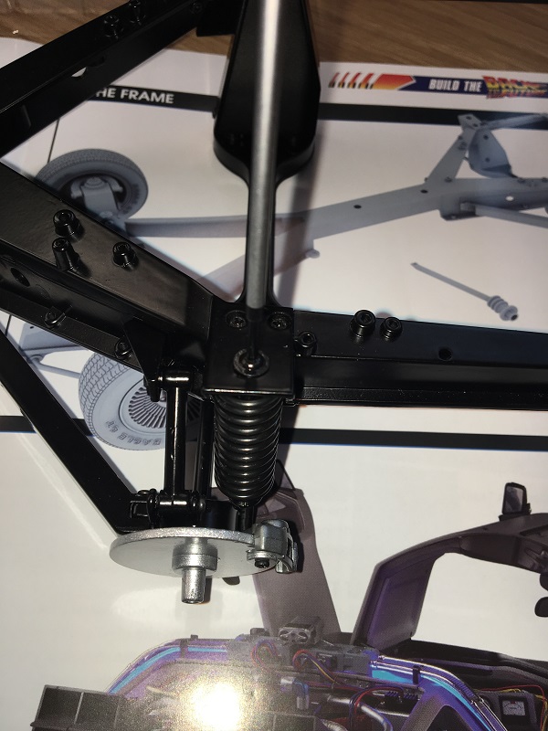

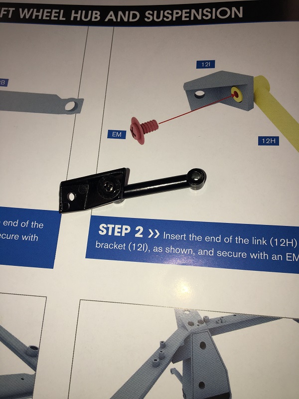

Fit the rear hub carrier into the end of the radius arm. Align the holes of both parts and secure with 2 CM screws. Insert the end of the link into the hole in the bracket and add a EM screw. Secure the bracket to the side of the frame with a BM screw. Place the hole at the end of the arm over the post at the side of the frame. Add a EM screw into the post hole. Place the end of the link between the 2 uprights of the rear hub carrier and pass an HM screw through the holes.

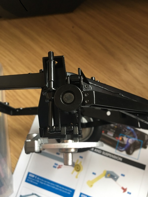

spike
#144 Posted : 28 March 2017 15:20:09
Joined: 04/07/2016
Posts: 297
Points: 897

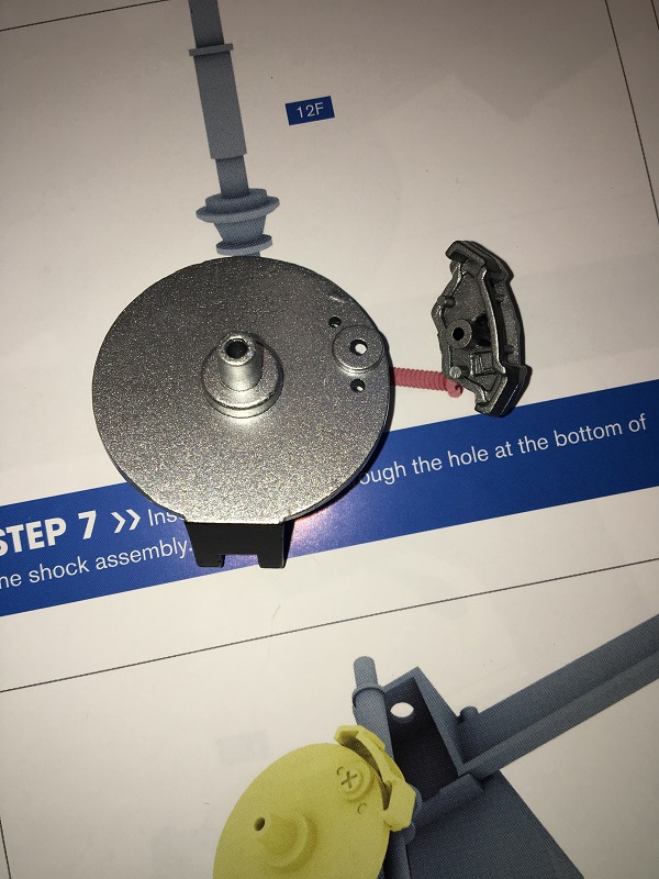

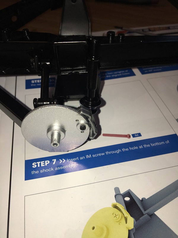

Place the 2 pins of the caliper into the holes in the brake disk, then add an AP screw. Insert an IM screw through the hole at the bottom of the shock assembly. Place the brake disk into the rear hub carrier and raise the lower link up into the bottom of the brake disk. Pass the IM screw through the hub carrier, brake disk and link. Add the spring onto the shock assembly. Insert the top of the shock assembly into the hole and add an EM screw.

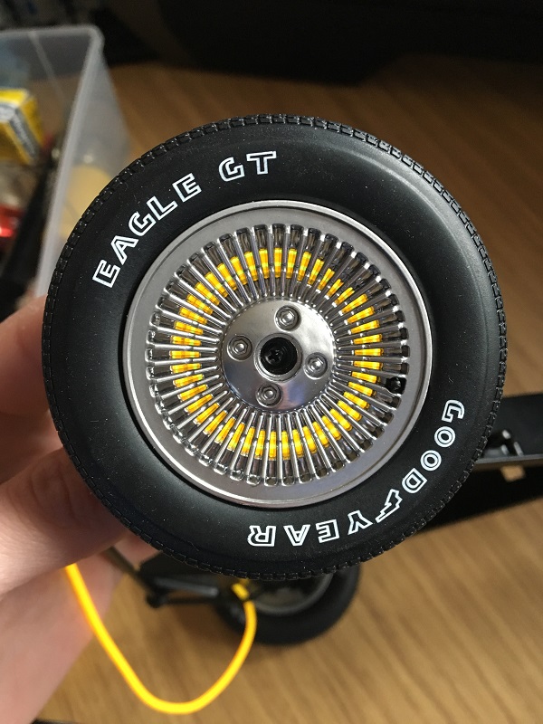

#145 Posted : 28 March 2017 15:24:45
Joined: 04/07/2016
Posts: 297
Points: 897
I got some LED rope lights with 2 flash settings, i have tried them in a wheel and it looks alot better but the light is not that bright.

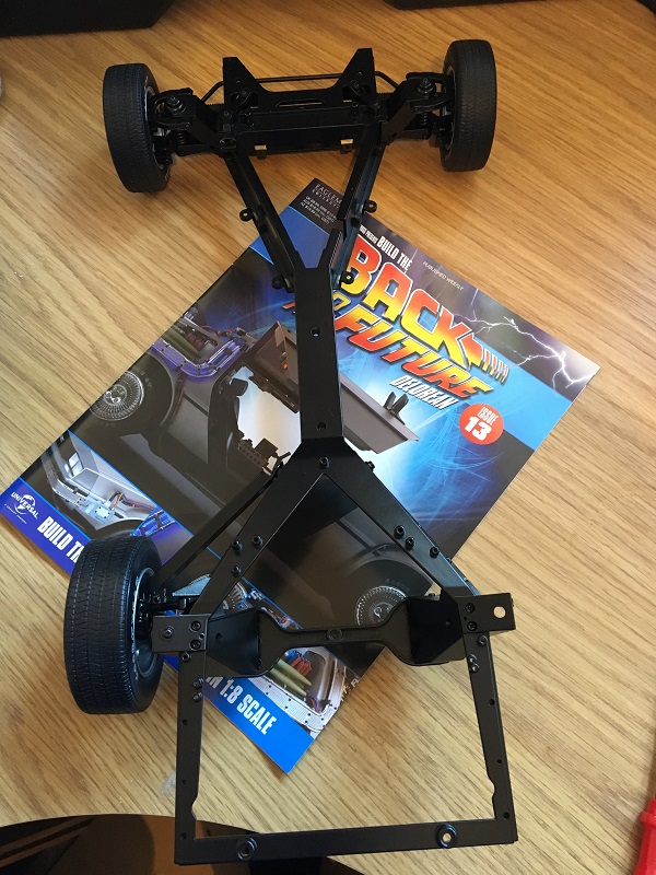

The wheel is put together in the same way as the other 2 wheels and then added to the frame with a GM screw.

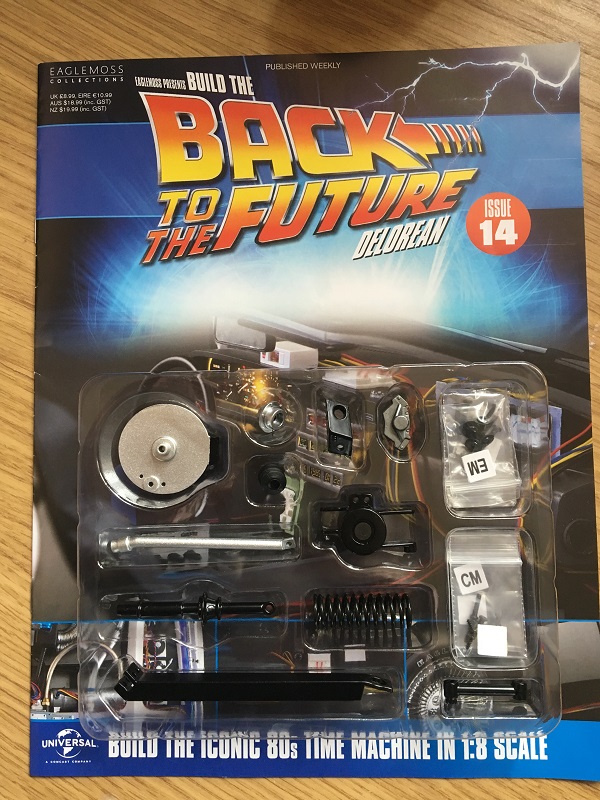

Issue 14
Parts -
Rear Right Hub Carrier
Rear Right Radius Arm
Flange
Front Right Tracking Rod
Boot
Rear Shock Assembly
Spring
Link
Bracket
Rear Brake Disk
Rear Brake Caliper
2x BM Screws
2x CM Screws
1x HM Screw
3x EM Screws
2x AP Screws
1x IM Screw

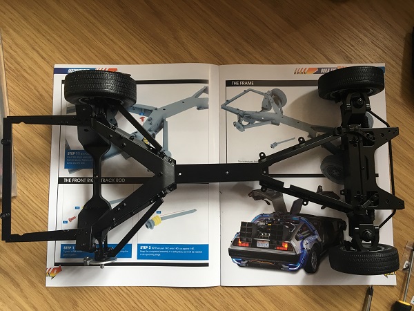

spike
#150 Posted : 19 April 2017 14:49:00
Joined: 04/07/2016
Posts: 297
Points: 897
Do the same as issue 12 and add the assembly to the fame.

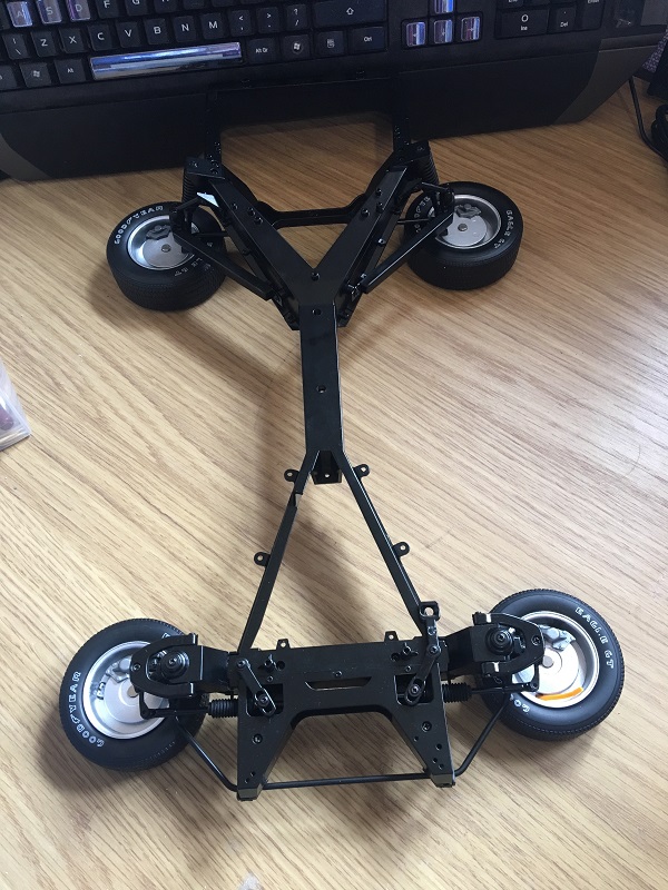

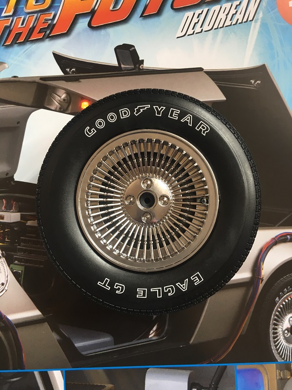

Same as the other 3 wheels are put together. A pic with the wheels up and a pic with the wheels down.

#154 Posted : 19 April 2017 15:04:03
Joined: 04/07/2016
Posts: 297
Points: 897
birdaj2 wrote:
That looks like a nice full pack of parts to be working with.
Just looked back over your earlier updates and really do like that yellow light cable you are fitting to the wheels.
Its turning into a very solid looking model.
Hope it all continues to go well.
Hi birdaj2 thanks for looking in, the yellow light tube is a lot better then the LEDs but they don't let off a lot of light like the LEDs do. I will be sticking to the LED strip lights in the wheels. I will also put some pics up when i get all 4 wheels fitted with lights. So far the build is good and had no problems getting issues. I am still waiting for EM to send me issue 3 out Cursing.
