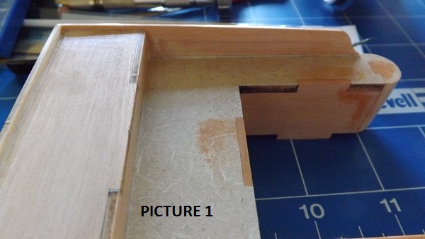

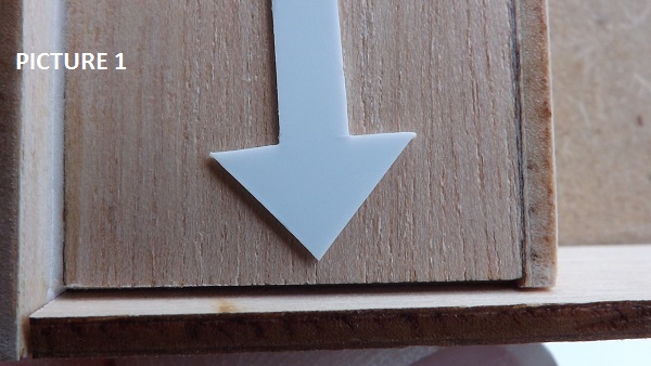

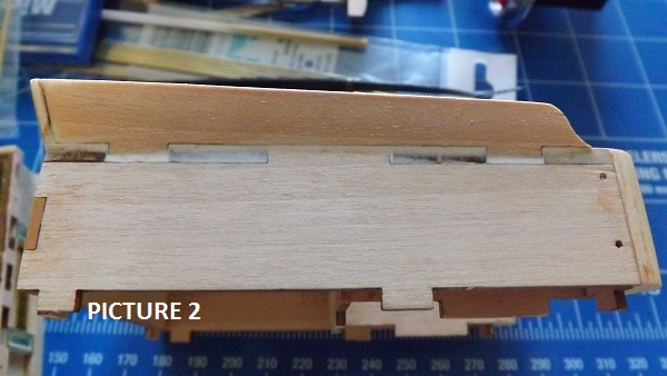

We have 2 side rails to now fix to the top sides of the tender. These are expected to be glued in 3 dimensions but having been cut in 2 dimensions means the fit is far from perfect and if you want to get the best from this area of the build (it will be very visible in the finished model) a lot of fitting adjustments are required.
In this picture we can see a significant gap which in theory could be filled later but if these parts are glued in place like this the outer sides do not line up correctly with the rear of the tender.

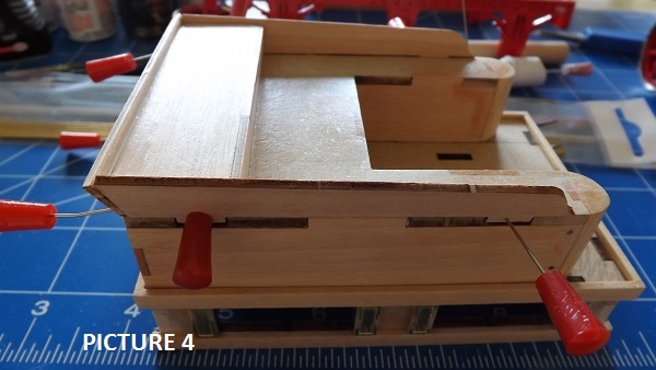

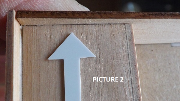

PICTURE 2
Some very careful filing along the already glued in parts (on which the arrow sits in this picture) allows the side rail to fit into place with next to no visible gap which is an improvement over the earlier dry fit.

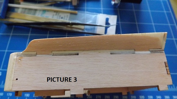

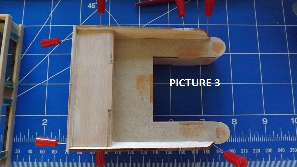

PICTURE 3
This shows the 2 side rails glued and pinned into place on the tender. You can also see in this picture some of the earlier filling that was required in order to remove the gaps between the part tabs as much as possible.

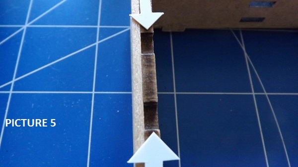

Once happy with the location of the side rails I pinned them into place to ensure they dried exactly how I had set them in place.

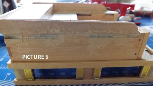

PICTURE 5
Once dry I removed the pins and then used a liberal amount of filler in order to try and blend in the tab areas and the edge to edge joint.
“RECOMMENDATION”
While plastering on lots of filler may seem like a good idea its best to try and use as little as possible or (if you can get a good fit) none at all.
The Ronseal filler I have switched too dries like “concrete” and while it can be rubbed back it takes an absolute age. It creates a load of fine dust and you want to ensure you do not start breathing that in for the sake of your health and wellbeing.

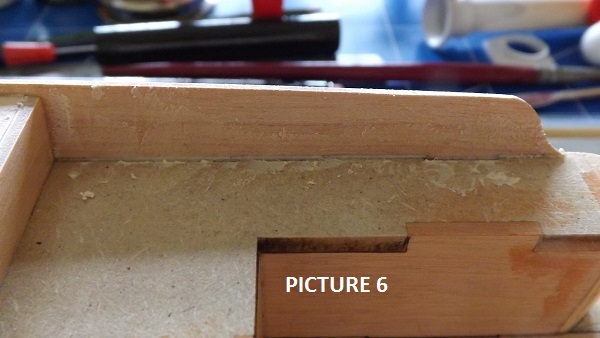

PICTURE 6
A very small amount of filler was required along this join simple because you are gluing the side pieces on at an angle so this form a small gap along this edge.

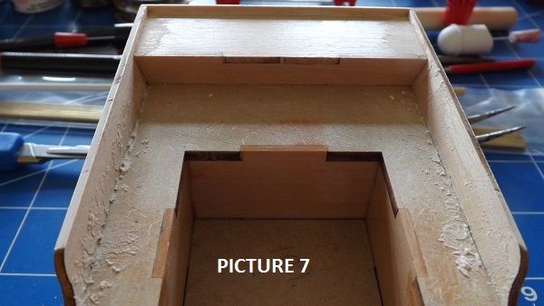

PICTURE 7
This is the view looking into the tender. While it took an age to get to this point I am really pleased that the time to get the side rails adjusted before fitting into place has paid off and it all looks quite neat and tidy.
Once the filler is dry it will be back to the sandpaper and once that is complete the whole thing will be given a couple of coats of Sand n Seal prior to painting.

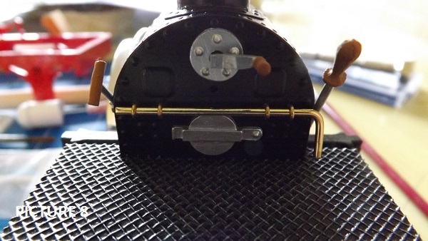

PICTURES 8 & 9

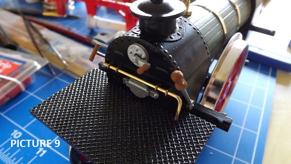

The final part of this week’s instalment has seen some of the control levers painted up and installed.

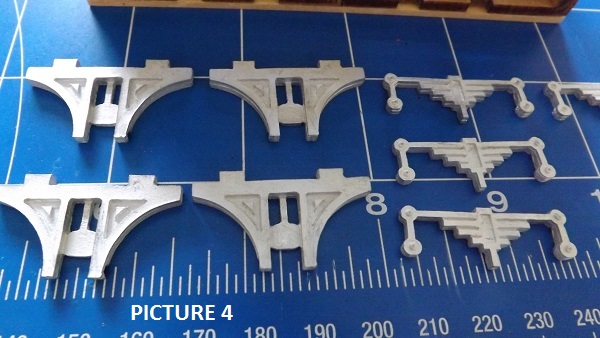

We now have another 8 pre-cast pieces to add to the tender assemble.
These parts are actually rather well cast with very little clean up required. Again an inconsistency in the kit in that some parts are “perfect” and others need quite a bit of attention to tidy up.

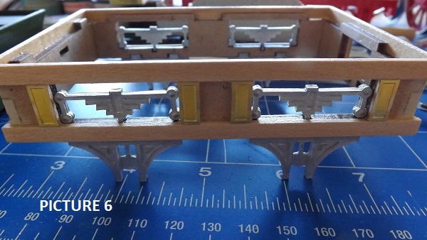

PICTURE 5
4 of the precast parts will be glued into the area highlighted with the arrows in this picture. The parts are quite heavy and have to be self-supporting so consideration needs to be given to the type of glue used here.
Super Glue (CA) on its own I do not think suitable. Epoxy (I use Devcon 5 minute) is very good but prior to drying can become very fluid and difficult to control.
So my option is to use Timebond in the slots and Super Glue (CA) on the other touching areas. There is no direct weight applied to these areas on the finished tender so I think this combination of 2 adhesives should prove ok.

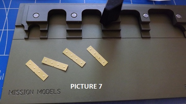

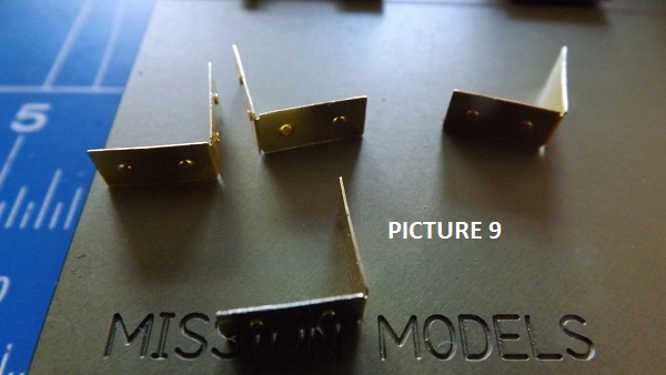

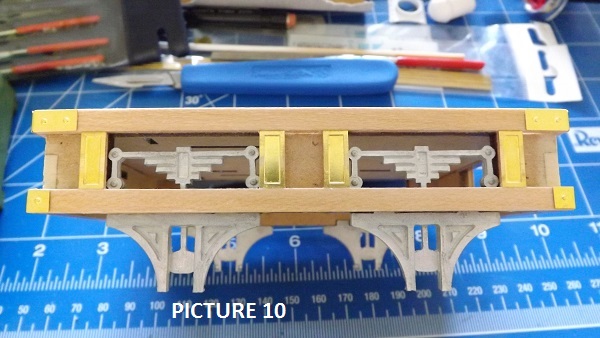

The next stage is the addition of 8 etch brass parts that represent the corner bracing. In this picture we can see the 4 parts that require some shaping before being applied.
PICTURE 8
Most modellers that use photo etch will at some point invest in a folding tool. I have had mine for some time now and it’s a model that was produced by Mission Models. It does for my needs very well.
PICTURE 9
And once all of the parts are shaped this is what they look like.
PICTURE 10
These corner pieces are then affixed to the lower tender corners. IN this case I have used Super Glue (CA) as I am gluing onto sealed wood that having been rubbed back is a nice shiny non porous finish ideal for CA

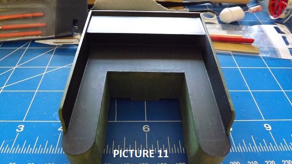

PICTURE 11
Here we can see what the upper part of the tender looks like now that it has received its very first coat of final colour.
The Humbrol Rail Match green is a nightmare to use as its almost transparent and needs around 5 coats at least to get the depth of colour required

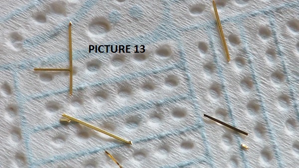

PICTURE 13
“PROCEED WITH CARE”
Something I think well worth a mention is that if you are working with Brass etch or cast parts that require clean-up make sure you work “Clean and Tidy”.
As you can see in this picture some of the tabs that hold the etch parts into their fret are very fine and extremely sharp.
If you have pets or youngsters at home (or even if you walk around barefoot) the last thing you want is for one of these fine brass parts sticking into you or the paw of a pet. Or worse ending up in something edible and being digested by mistake.
They can cause some really serious issues so I always work on a paper kitchen towel and when done this is all folded up, taped up and binned.
