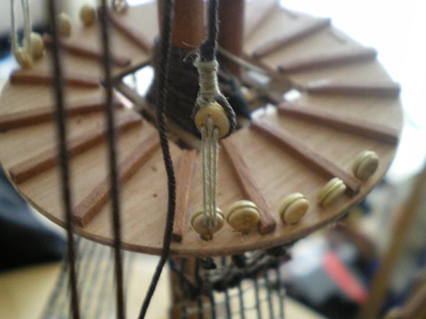

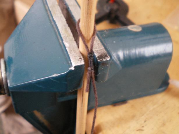

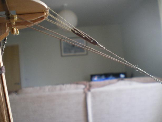

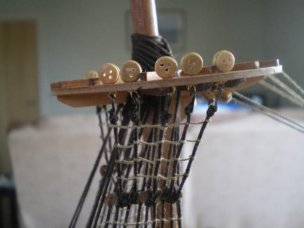

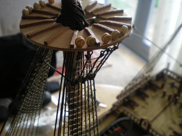

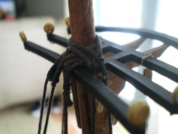

All the ratlines have been finished on the lower mainmast and mizzenmast so have now moved on to the upper foremast Cool
The loops for the shrouds are made first and then served once completed they are looped over the mast and fitted to the dead eyes with a jig to keep them at the same height the dead eyes are then served and fitted Cool
Next job doing the rest of the ratlines Cool
Catch you next time
Martyn

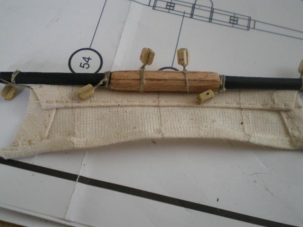

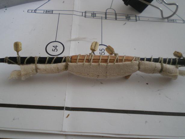

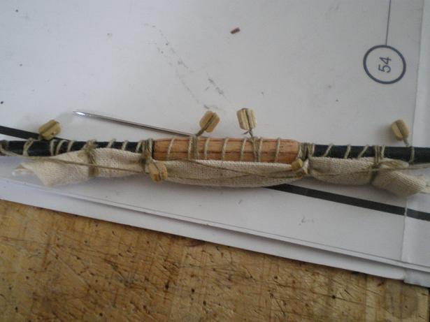

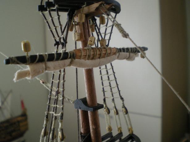

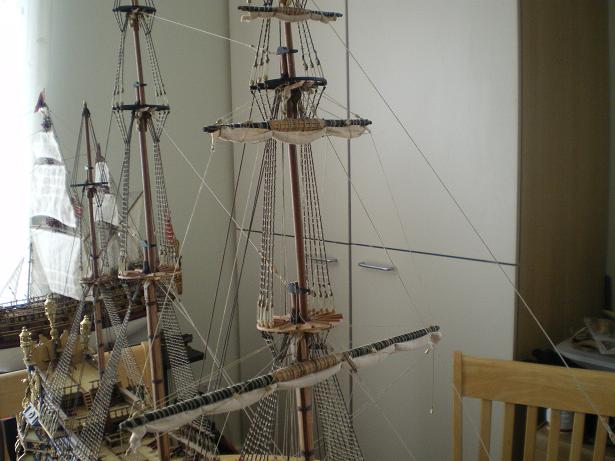

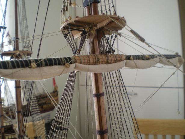

The ratlines have all been completed yippee BigGrin so have started on the yards. One word of warning is the 1-1 plan is wrong as the lower fore yard is to long as it's 15mm over size so go with the measurements in the description at the side of the plan Cool

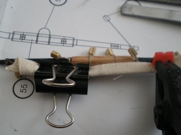

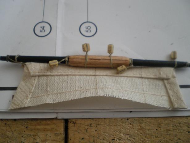

Someone asked on the forum about furled sails and I said I was going to have a go on the SR so here's how I got on Cool
First step is to make the yards as per instructions
Step 2 sow the sail to the yard
Next cut the sail down to one third its size to get rid of the bulk as the material is quite thick .
I hemmed the bottom of the sail with some contact adhesive to stop it fraying
Then the fun begins, fold the sail up until it hits the yard hold in place with some clamps and tie the sail up with some thread pulling it tight. Once completed tease the sail out until you are satisfied with the look then fit it to the mast
One thing I will say is that the smaller the yard the more you have to cut down the sail as you end up with to much bulk .
There is probably more ways of doing this but it seems to work
Thanks for following
Martyn

I do like the way you have done the sails furled. Its a shame some kits out there don't show how to have them done this way. I do prefer the furled sailed as it leaves everything open for the detail to be seen.

I have been itching to have a go at furled sails . Chris as you say they don't cover the details on the deck so it was in for a penny in for a pound and if they didn't work out I would have rigged it with out sails Cool . Talking about rigging I have rigged the yards slightly differently to the rigging guide as some of the belay points didn't make sense so went with Patterson book Cool
