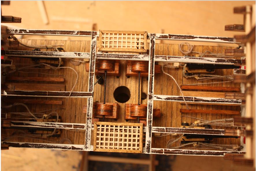

Issue 141

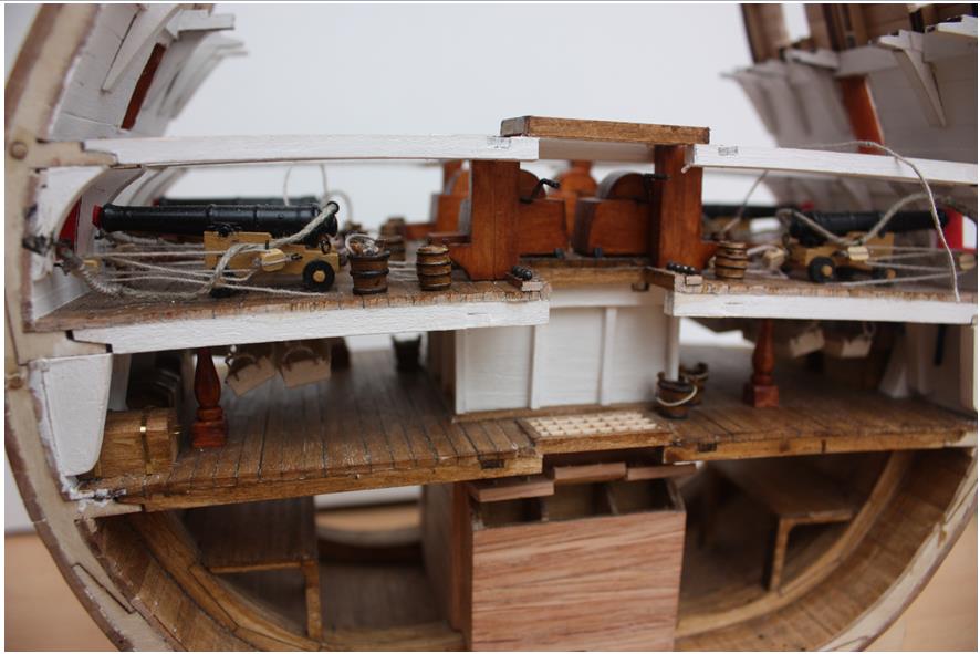

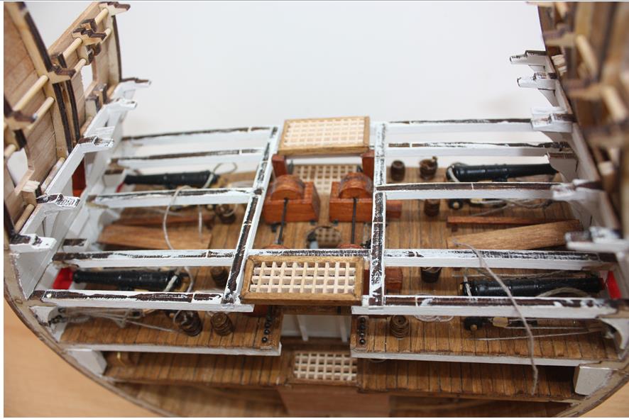

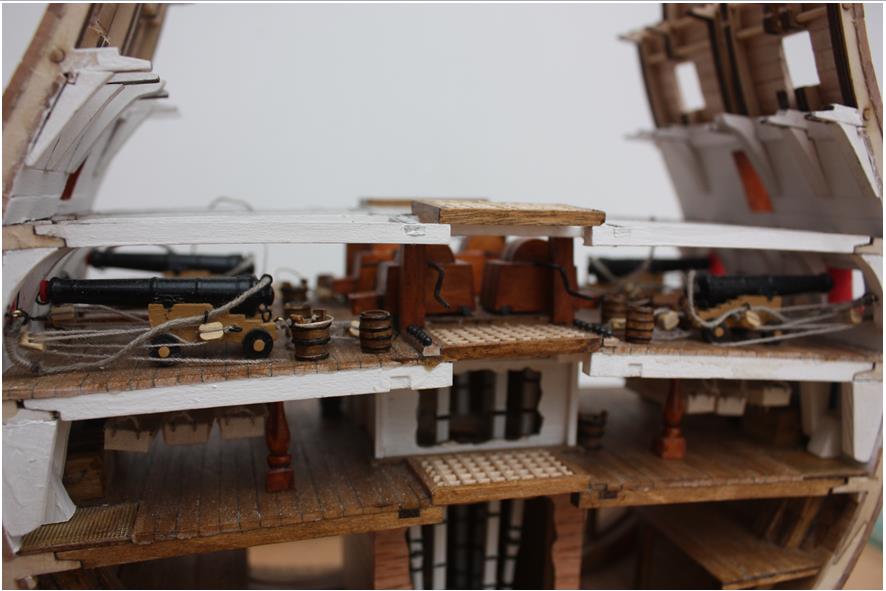

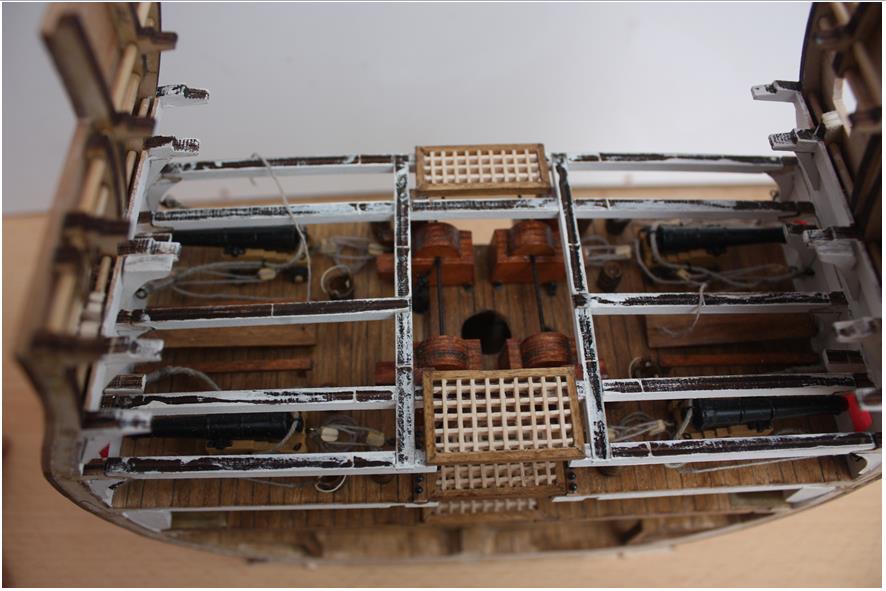

Deck support beams
Paint first, I use white emulsion paint it give a good cover with one coat.
I did notice that on my model the beams seemed to be a bit short and it seems as thought the ribs had opened out slightly so in order to pull the frame back I used some clamps to pull the ribs back into place, glued and pinned the beams and left overnight to dry. problem solved. Added the two fore and aft beams, note the instructions re orientation as it is easy to get them the wrong way round
Fitting support columns and roller fairleads
The only issue I had here was with my pump handles which I had made slightly to large.Angry As it happens I had tried to be too clever and made the handles in one piece and left them able to turn in situ. It was therefore easy to cut them out and remake as per instructions BigGrin
Shot Garlands
I replaced the provided steel balls with black balls I purchased from CM to give a more realistic look (We all know canon balls should be black)
Fitting the gratings
Same procedure as before although I mitred my joint as apposed to butt joints.

Issue 143

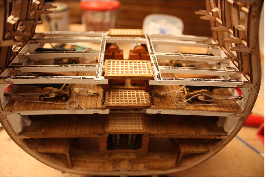

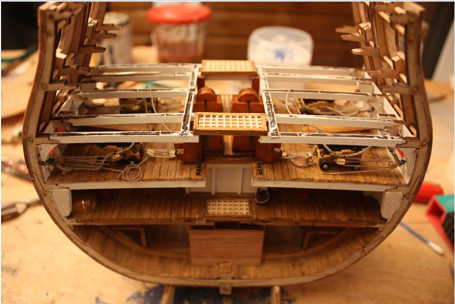

Planking the Bulwarks - Is as before withe lower decks except that this deck has the entry ports. Once the planking is complete it is just a matter of trimming back to the frames to allow for the entry port linings. Once fitted the linings need to be sanded until they are flush with the bulwark and outer hull.
To Finish the bulwark you need to cut a piece of 1X6 mm to fit around the frames. A sharp blade is required as the final piece is fragile until glued in place.
Once the final bulwark plank is in place it is time to fit some more knees. These will need to be notched to fit over the final bulwark plank and may well vary from model to model. Ensure you glue them under the right deck supports.
Adding Buckets and barrels - The buckets and barrels I stained with dark oak and them painted the iron rings black. Did not have much sucess with painting the straps on the small barrels so resorted to using the the side of my black felt tip marker which I use on the edges of the deck planking. The ridges on the barrels are raised and using the pen gave me the effect I was looking for.
You will see from the attached photos that I have replaced the steel cannon balls provide with black ones I purchased from CM.
I have still to make the hammocks, I do not like the suggested design so am giving this a bit of thought and will show my results later
