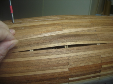

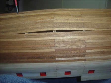

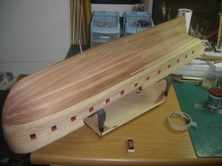

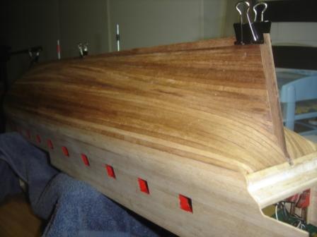

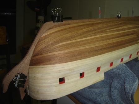

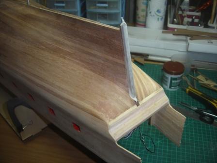

Thank you gent's...your support made me find more time (got the other nagging things sorted in double time), finally got the hull planking finished (not sanded yet though). The last two planks port & starboard were a tricky little blighters, the good news was that both of them were much the same size and shape, must have got something right....

There's no time like the present.....

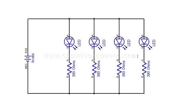

Do you have any recommendations on where to look to learn how to do the LED lighting? I've just bought a complete Titanic model from a fellow forum member and i really fancy trying to light her.

Rob...Led lighting is very simple as long as you stick to the basic rules, there are 3 elements...
V = Supply voltage
I = Current
R = Resistance
You cannot connect an LED directly to a battery the current has to be limited to around 20ma (0.02A) otherwise you will smoke it and then back to the shop, here's a pic of the wiring and elements required....
As we know the current required (20ma) next we need to know the voltage you're going to use, I'll presume 9V DC (got to be DC i.e. from a battery) lastly what resistor? The voltage drop across the LED will be about 2V so we will need a resistor to drop 9V(supply voltage) - 2V(LED Voltage) = 7V
OHM's Law....R = V/I = 7/.02(20ma) = 350ohms (closest std resistor 390ohms)
The last thing to consider is the resister Wattage...
W = V x I.........= 7 x .02 = .14W 1/4W resisters are o/k. I used 1/2W resistors.
Here's a LED Pic...

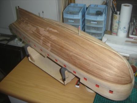

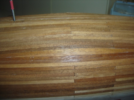

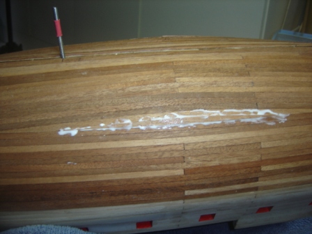

Spent about 3 days sanding the hull still a little way to go yet....I glued the stern post into place to blend the planking in easier, just cover it with a bit of masking tape and it stops it from being sanded as well...just keep replacing the tape if it gets damaged.
Just a few places to touch up, used some sapele wood filler, cant see it after final sanding..about 20% left to sand on the port side then on to fitting the stem and keel pieces...should have that finished by this weekend then the copper plating after marking the waterline...I think I might give the hull below the waterline a couple of coats of acrylic metallic copper paint which will camouflage any small gaps there may be in the copper plating...
Barry
I wouldn't bother going to all that trouble. If you get any gaps you can just throw some paint in the gap and wipe it off with solvent. That's way easier and faster. Also, if you're careful you shouldn't get any gaps. The foil works better than you think. I would however put a couple coats of sealer below the waterline to ensure that the adhesive on the copper foil sticks properly. Don't forget to sand lightly after and then wipe with a damp rag. It will stick like gangbusters.

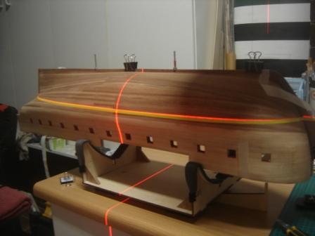

Thank's gentlemen...yes amazing how the swan appears from the ugly duckling with a little sanding (or should I say a lot). Managed to get the sanding finished today and the Stem and Keel pieces fitted, just requires a little more sanding towards the stern to blend the keel in a little more.
John when you say you used sealer before coppering, was that Sanding Sealer?
Marked the waterline this evening, looking at a couple of pics of the real deal the waterline is at 13 feet from the bottom of the keel, converting that into real units relates to about 82mm on the model...looks about right. Lucky me I have a laser level which made things quite simple, once the model was leveled a mark on the Keel post both sides some 5mm plastic tape and presto...waterline, another hurdle overcome..
