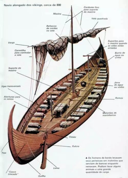

In effect I'm working to build the seats for the oarsmen, they are 50% ready, I only need to find a way to realistically simulate the kind of cushions or covers over the boxes, as shown in the following picture . .
That's a cool drawing and thanks for sharing, should look fantastic!

In practice this is the famous "sailor's box" where the owner kept his personal belongings with a blanket added over its cover to soften the sit. When the ship run with sail the whole was stored under the deck planking.

Here below the reference image for my idea. .

Another small step forward: I finished the building of the oarsmen's seats and sailor's boxes and, after giving a coat of clear matt paint to the deck, I proceeded to glue them in the same way of the drawing I reproduced some messages ago. Then, considering that hardly the viking warriors were equipped with common uniforms, I thought to paint with different colors the various blankets over the boxes.
