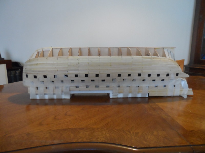

The ship itself on much closer inspection needs to be completely dismantled and started from scratch, i dont know how they did it but they managed to put most of it together without using hardly any glue, this is how it arrived to me.
Wow! That planking is bad.
It's kinda sad in a way because some poor soul has bought this with good intentions, but it obviously was way beyond their skills.
It is isn't it, they obviously didn't follow the instructions in any way and didn't have the support help and inspiration of this forum.

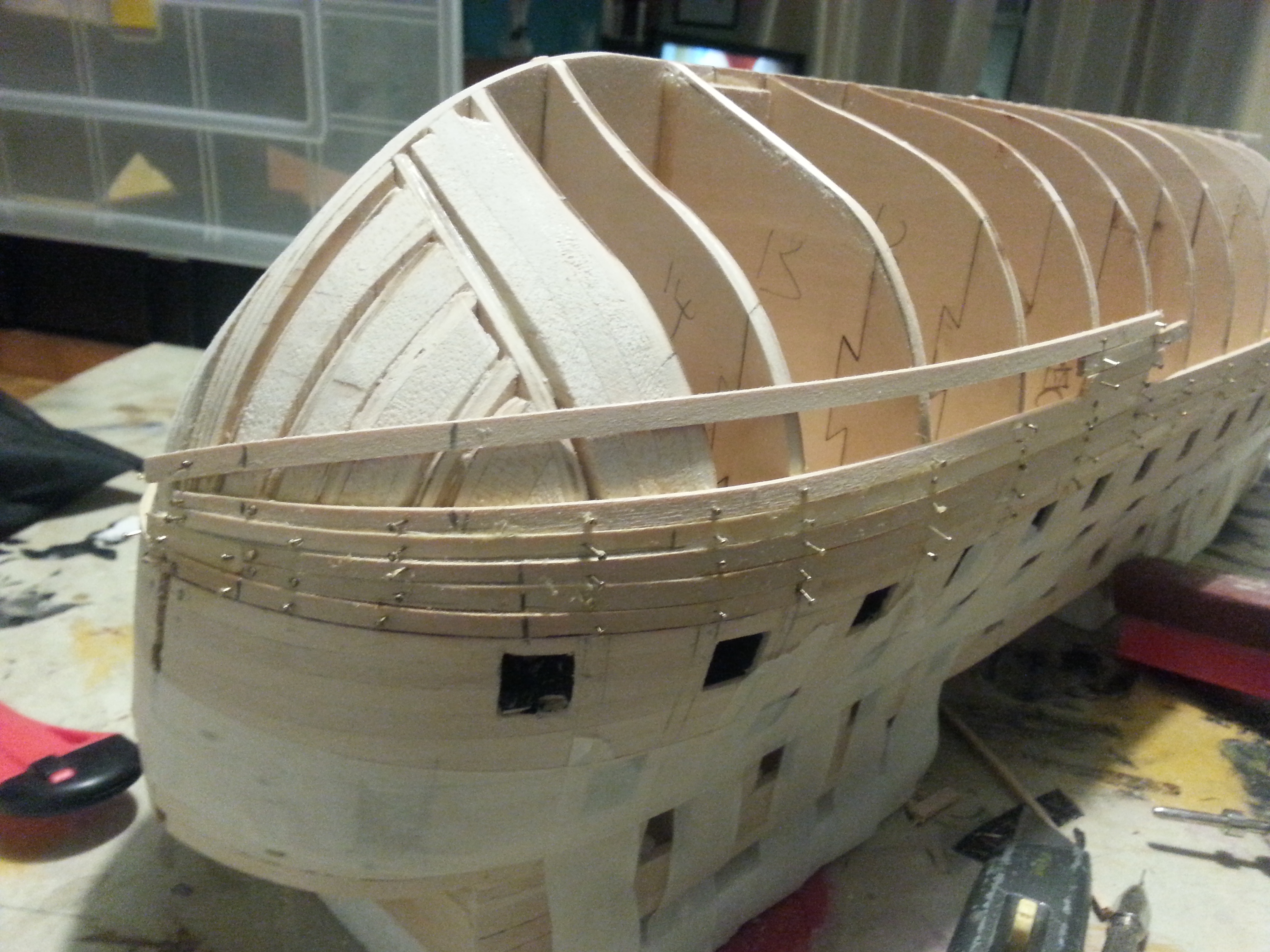

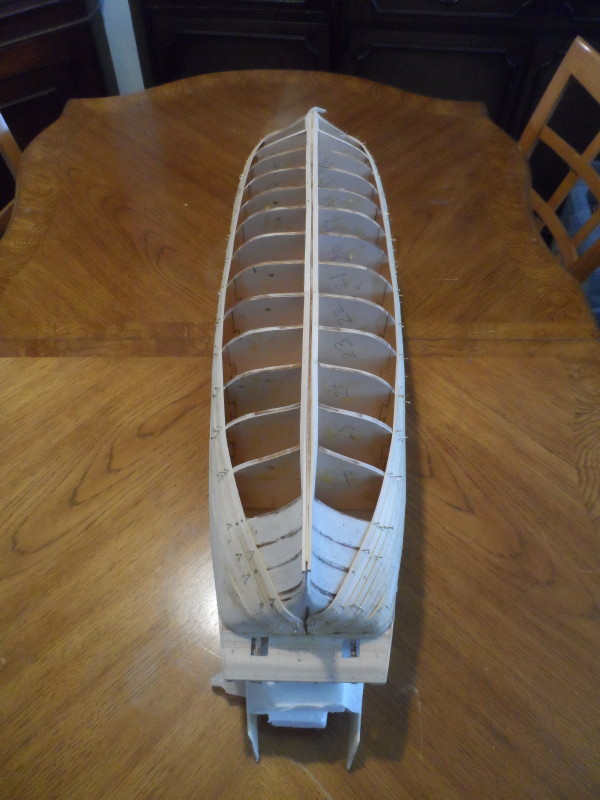

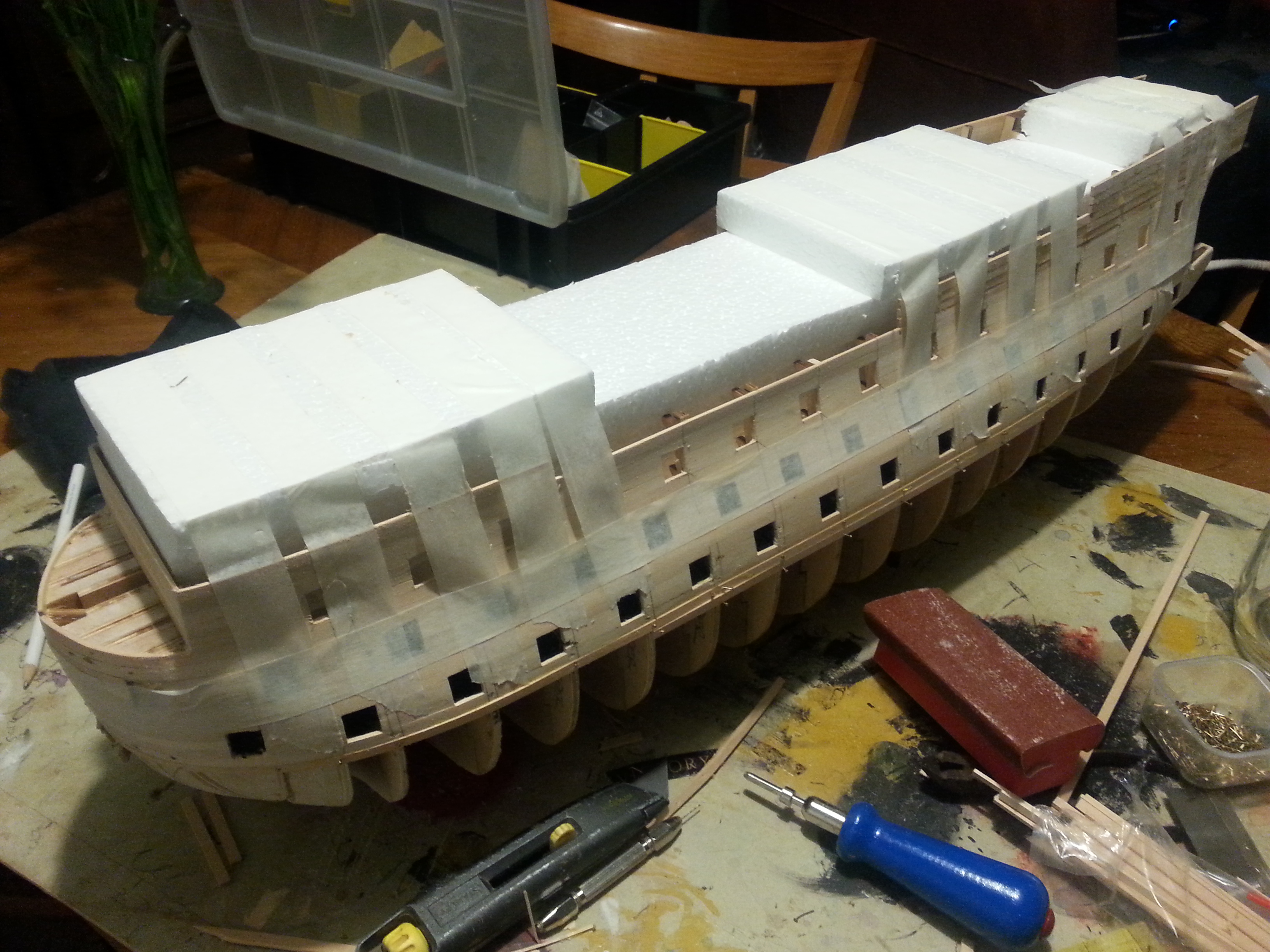

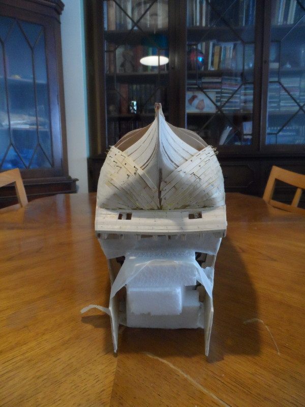

Hi guys and gals, been around nine months since i did anything and posted something on here, i hope i find you all in good health, i hadn't gone away completely i kept popping back and looking at your builds and there's some cracking stuff going on, as for myself i just haven't done any of my hobbies lately, no guitar, no fishing, no modelling, too much work and no play does not make Paul a happy bunny, but time for a change, packed out the inside with polysyrene so that i could turn it upside down without breaking anything and started planking the lower hull, and trying to get the hang of this dropper plank thingy.

Good idea using the balsa filler on the bows and the hull above the water line looks pretty great. The rest should sand up nicely.

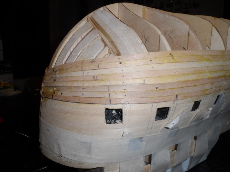

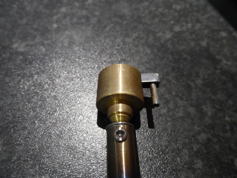

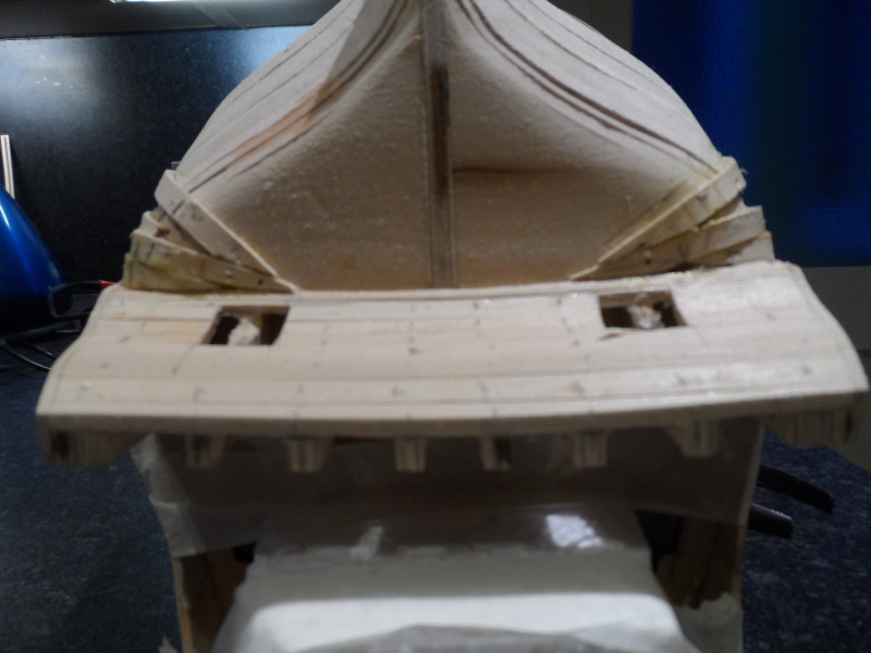

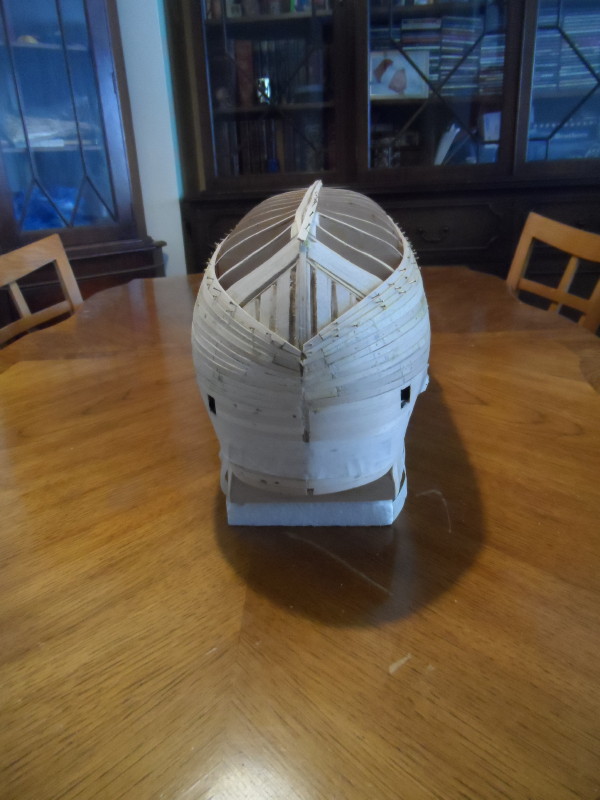

Well the bow seems to going ok i'm getting to grips with droppers, the stern on the other hand seems to have gone a bit awry, (note to self, pay more attention in class) rather than coming up and round i seem to be coming across more, i know where i went wrong i didn't twist the first plank enough, got some tapering to do as i work up the rows to rectify it, so the positive is "lesson learned", the other positive is last year Bernd very graciously sent me one of his plank bending tools, which you attach into the end of your soldering iron and makes it easier to get a tighter bend on the planks, this was very helpful in the stern planking, thank you Bernd.
Gibbo attached the following image(s):
#156 Posted : 21 May 2016 11:40:42
Hi Gibbo, she's coming along nicely. The start of the stern section is very tricky to get right and it's not easy to twist and bend the planks around that area. Solution for me was to give the planks a good soak first, bend with a soldering iron.... Look forward to your next update..

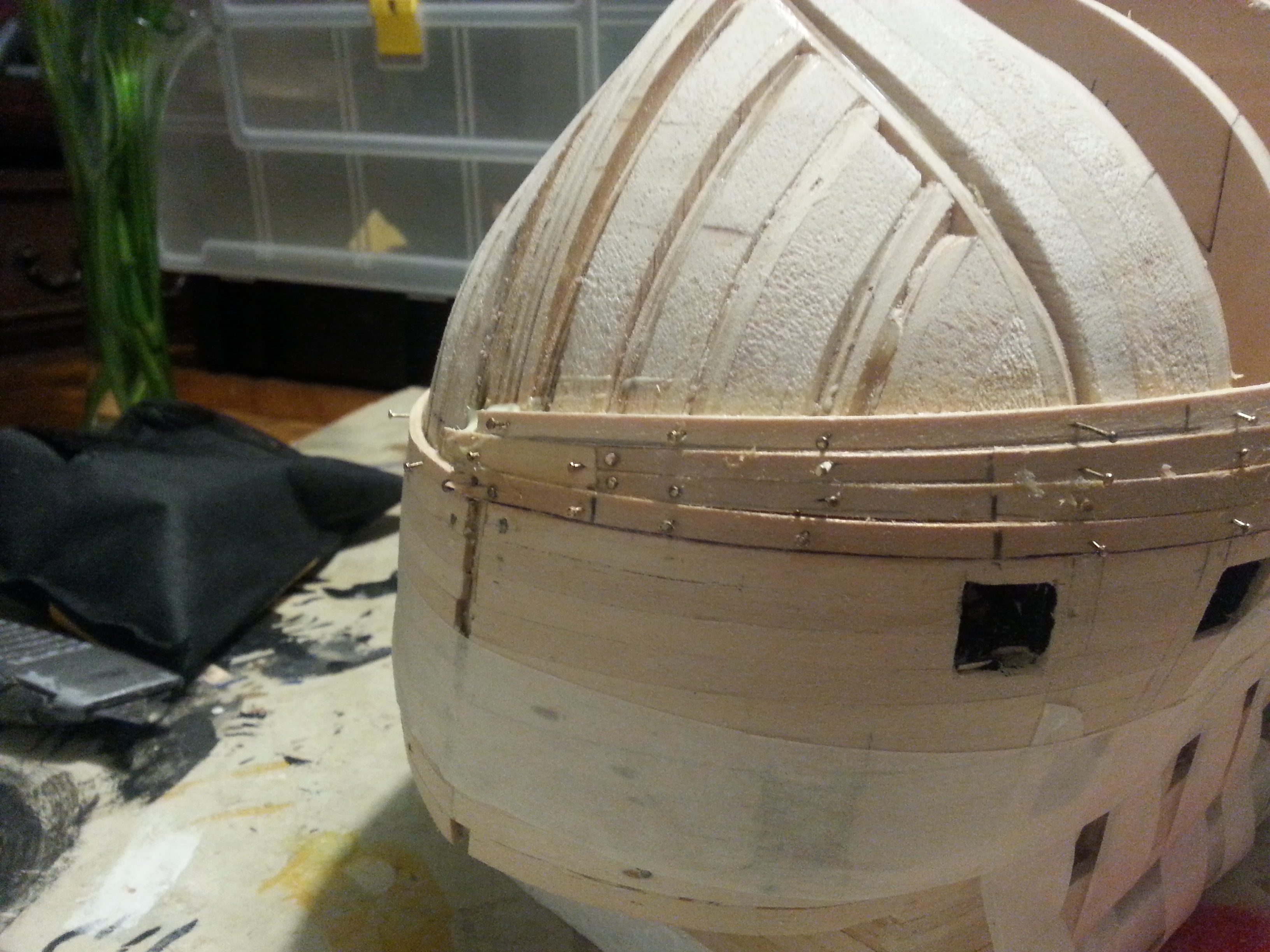

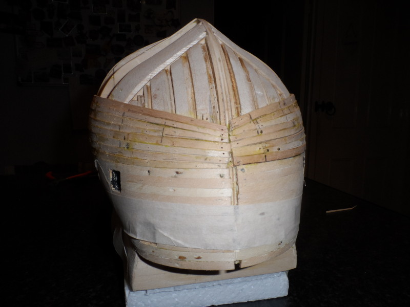

well after the shaky start of the stern section i think i am somewhere around where i need to be, my droppers at the bow seem to be very short ones compared to other builds i have seen, so for the people who have gone before me can you have a look and let me know what you think, Thanks
Paul

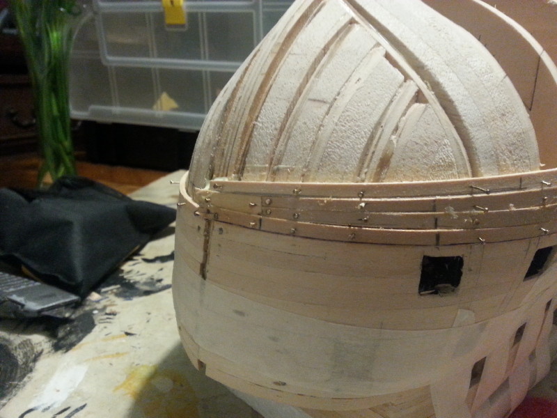

#158 Posted : 24 May 2016 17:32:11
Joined: 26/05/2014
Posts: 912
Points: 2,773
Location: East Sussex UK
Paul
#159 Posted : 24 May 2016 20:20:45
Hi Paul.
looks fine to me. should sand down nicely. Keep the pictures coming.
Ian.
#160 Posted : 24 May 2016 21:00:19
Looking good Gibbo the bow and stern are the most fiddly bits to fit , keep the faith and it will all come out ok
