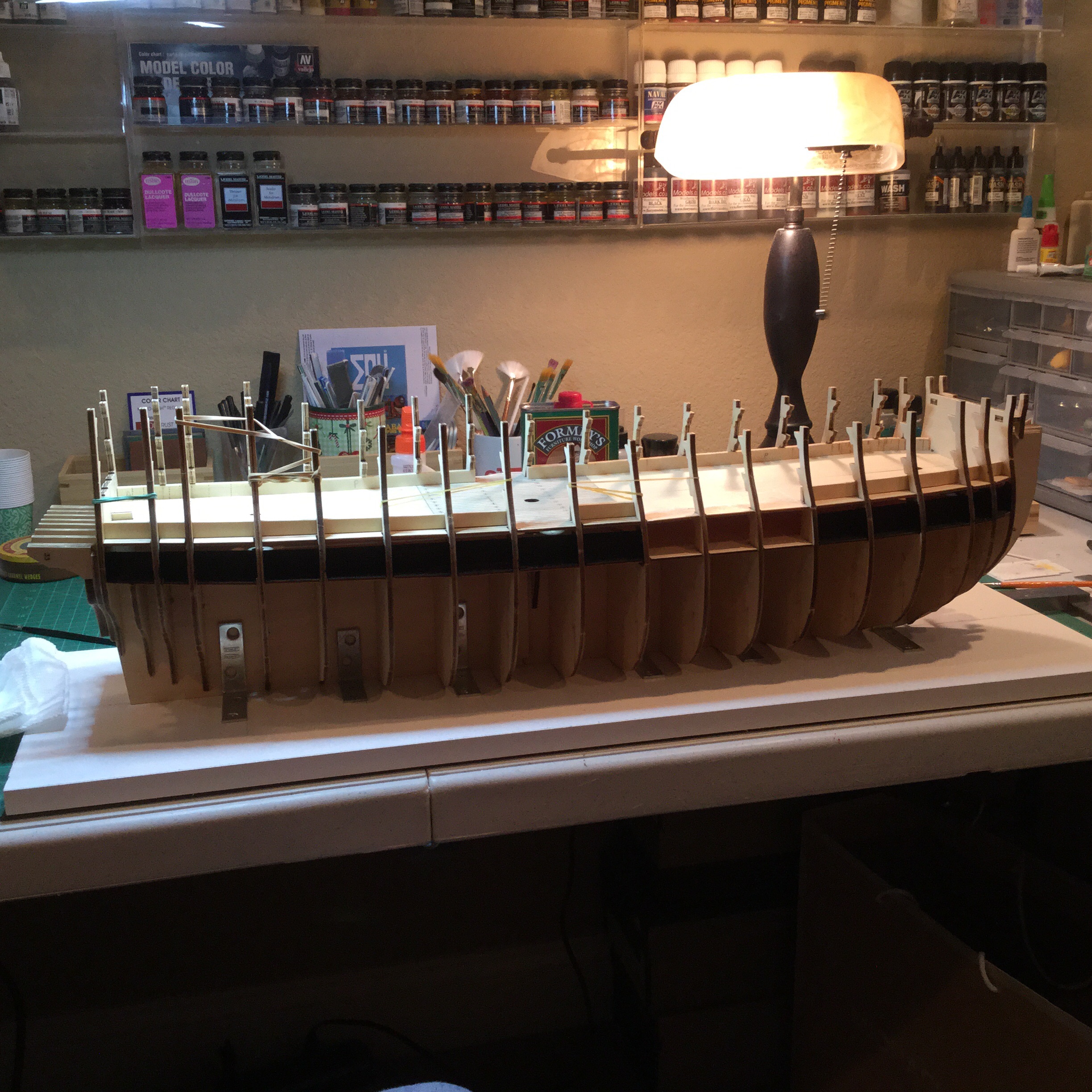

#146 Posted : 09 June 2015 00:22:49
Joined: 25/04/2015
Posts: 154
Points: 462
Location: Northern California, USA
Ian,
Thank you.

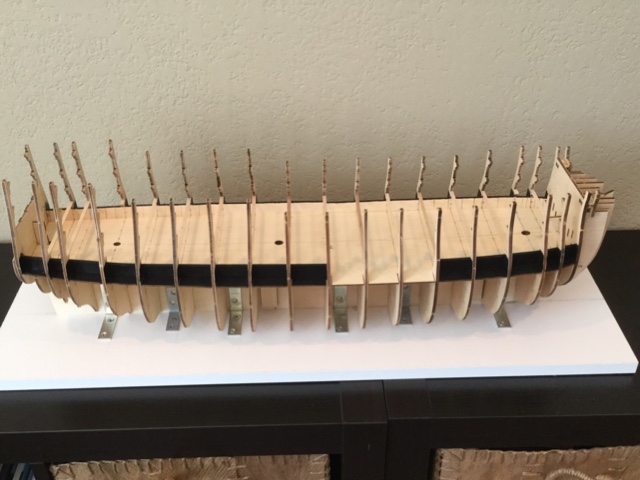

I installed the main gun deck beams (the ones on the sides that the false cannons mount to) and the cross beams for the second gun deck. All went together fairly well. As you can see from the state of the model I opted to go with the cut out.
I also applied two coats of black to the areas that will be inside the cannon ports.
Here she is at this stage.
My only concern is that a number of the arms from the frames are still a bit warped above the deck line. I'm hoping these will straighten out with installation of the next few decks. Any advice mates?
I also soaked and weighted the next deck sections as they were a bit cupped.

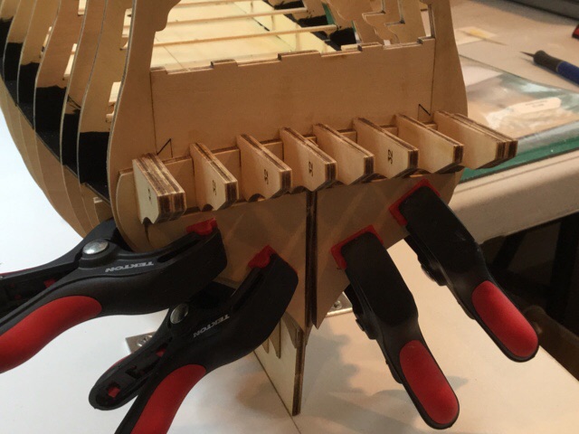

While waiting for the decks to flatten out I completed the stern assembly.
DSoldano attached the following image(s):

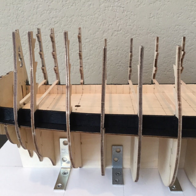

And the bow

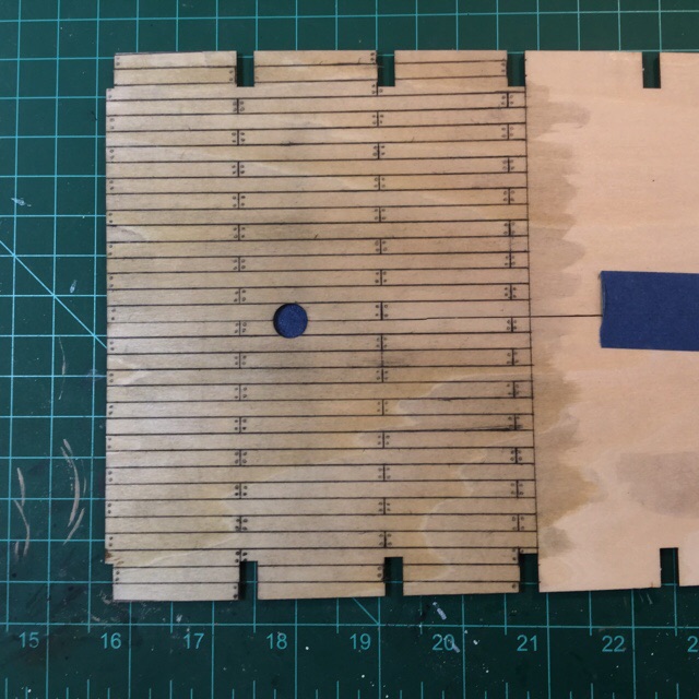

The second gun decks finally dried out much flatter after soaking and weighting. Then I test fit and adjusted the decks as needed. shaped and bent the support beams and drew the deck boards and tree nails onto the rear portions of the second gun deck. I used Steve's method of weathering the deck with a 50/50 mix of Weather-it and water. It looks great. Thanks for sharing Steve.
Next I glued the decks to the thwarts and used the deck beams and coffee mugs filled with water to weight the decks. The I'll seal the drawn on planks with some Tung Oil.
I still want to adjust/straighten some of the frame arms. I plan to glue the deck beams to the deck without gluing them to the frames. Once that's dry I'll adjust any of the frame arms that need straightening and clamp and glue them to the beams to get them in position for fairing and planking.
Here's the weathered deck.it has a plywoodylook here but It dried much more even.
I'll post more pictures tomorrow.

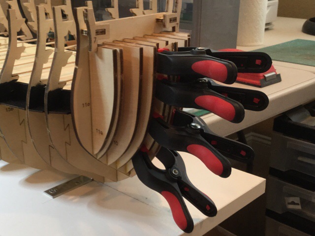

#157 Posted : 16 June 2015 05:45:24
Joined: 25/04/2015
Posts: 154
Points: 462
Thanks Gents,

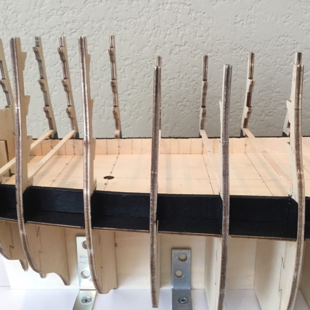

I started straightening all of the arms of the frames. I used rubber bands (as shown in the photo) to pull the offending arms into line and then glued them to the deck support beams. I actually took the batch of rubber bands that you see in the photo off this evening and it worked great. I have a few more to straighten on the starboard side and then a very few to get on the port side.
Then I'll paint the required areas black, apply some Tung Oil to the simulated planking to seal it, and then it's on to fairing.
Laugh Laugh Laugh

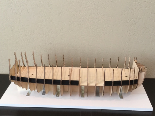

Looks like DeAg billed for month 3 so I should see issues 21-30 in a week or so.
The hull assembly is complete and all the parts that need to be painted black are done.
Fairing starts tomorrow morning, wish me luck.
