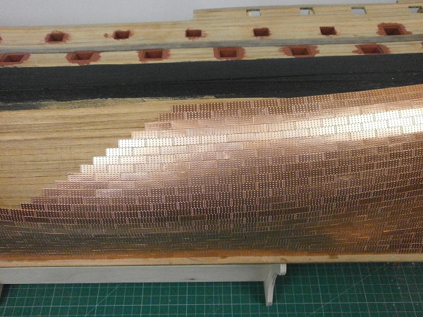

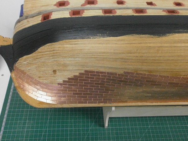

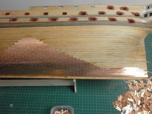

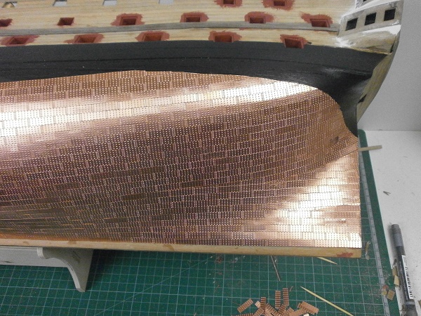

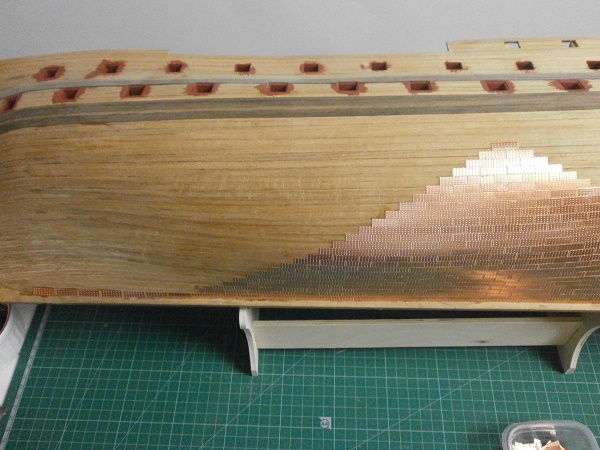

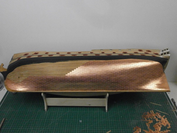

BigGrin Hi All
The tiling proceeds at a steady pace in fact im quite enjoying the process of seeing it build up on the hull, a few pics on progress.

That tiling does look very nice indeed Cool

BigGrin Thanks everyone for looking in and your commentsCool

Hi Andy great progress on the tiles.I found this job on me victory very relaxing in fact.I used the same tiles they do look good.just found ya do have to check for double tiles as eh do like to stick together on the rivets.going great and look forward to more.cheers mick.BigGrin BigGrin

Thanks for looking in and your comments and I agree about the tiling ,had a few doubles but managed to spot them all bar one so far and yes very theraputic.

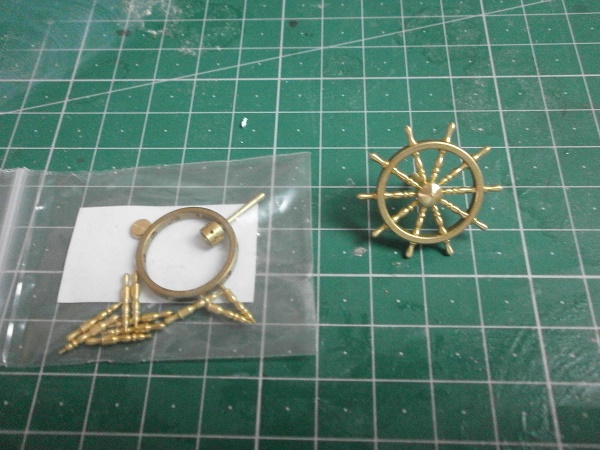

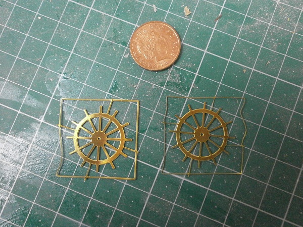

BigGrin Hi All
The turned brass wheel's arrived today there in kit form but very nicley made. The axle on one will have to be removed to make the matching pair but there a marked improvement on the kit ones I think.
#155 Posted : 18 June 2015 22:33:09
The difference between the two is like night and day, without a doubt a vast improvement Cool

Great work on the build Andy. The rurned brass wheels are a massive upgrade from the original ones.

BigGrin Hi All
Copper sheathing continues, when I started the sheathing I suspected that the plates were applied in certain ways such as when they were first used until later. The sheathing was firstly applied to the bottom of the stern post and keel and then worked forwards untill the hull was covered. The earlyest form of sheathing was the smiley face type where the shape of the hull caused the tiles to slope upwards at the bow and stern the plates were then capped with a straight run of plates, a wooden baton running along the top with the plates trimmed to the baton or simply a rolled up piece of canvas nailed in place.
As time passed the copper plates were replaced by 'Muntz' metal an alloy of 60% copper and 40% zinc sometimes called Yellow metal. The tiling also was laid in straight lines a perfect example of the use of Muntz metal and straight tiling patterns is the newly refurbished Cutty Sark at Grenwich.
More soon,
Regards.
