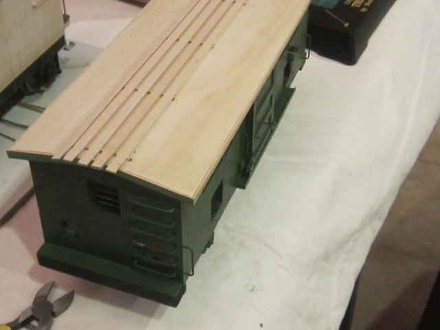

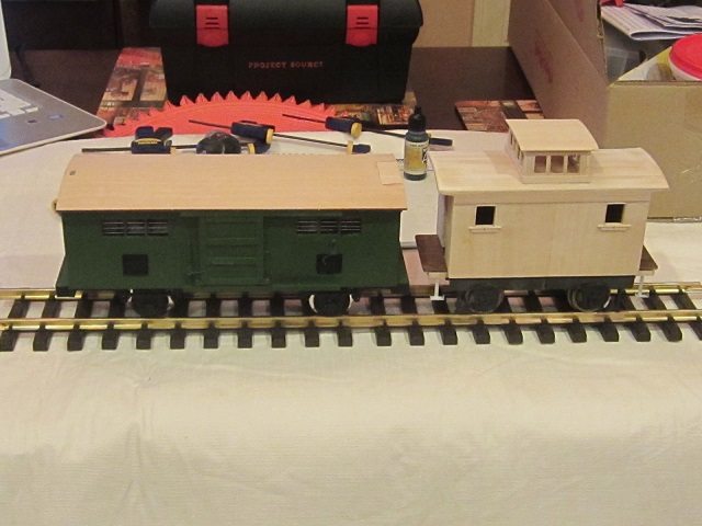

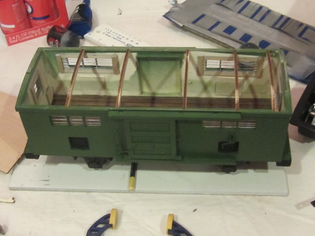

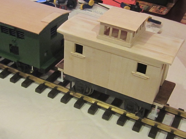

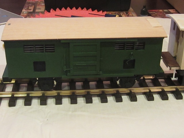

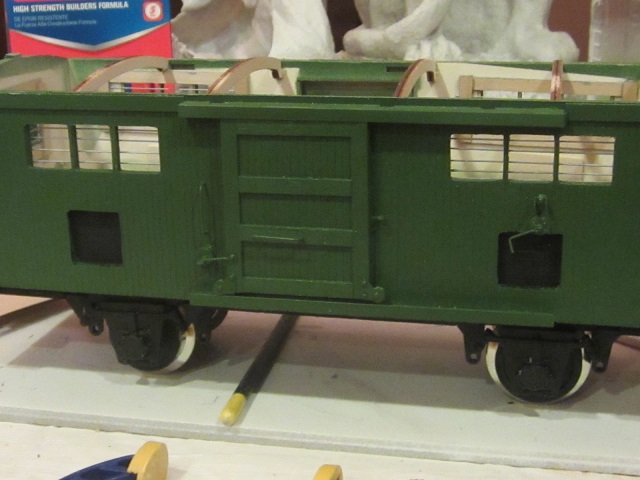

The next step for the boxcar was to install bars on the windows and grills for the vents on the front and back of the train.Next I installed the roof supports for the boxcar.I soaked the plywood roof and then taped it to a CO2 tank to get a curve on it.Once it had dried I installed it on the boxcar.I then put the boxcar and caboose on the track to see if they were the same height.

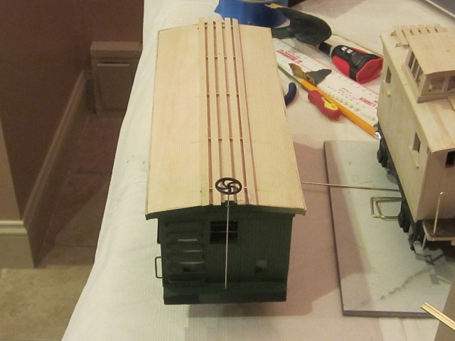

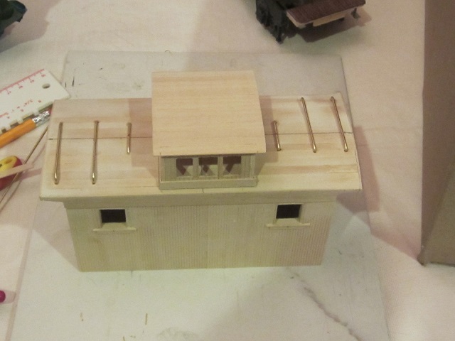

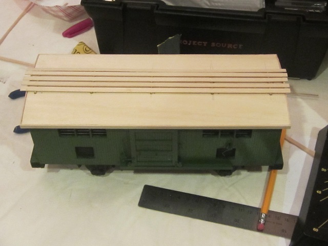

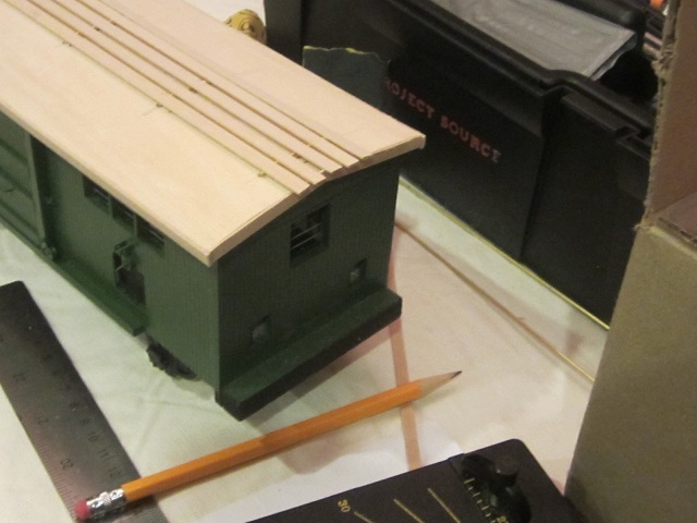

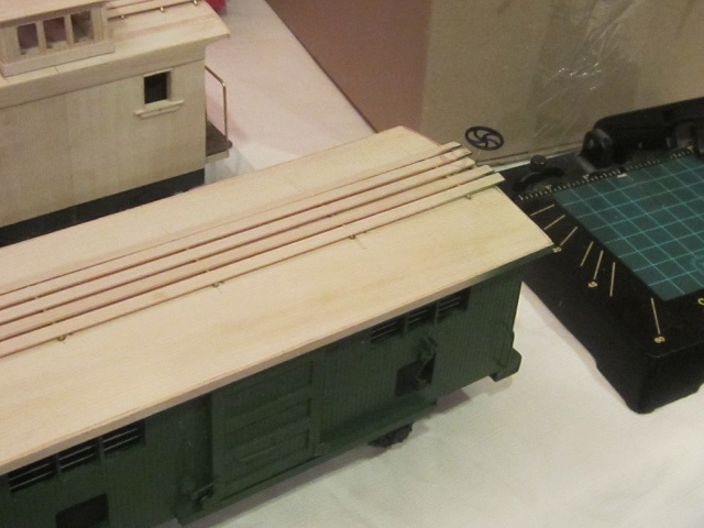

Thanks everyone.More work on the boxcar.I finished the roof and attached the walkway and the ladders to access the roof.I also attached the brake wheel to the rear of the car.The next step is to paint the roof and then apply to stencils.
#152 Posted : 07 September 2015 07:12:56

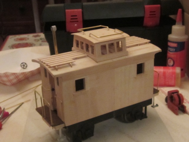

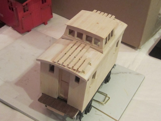

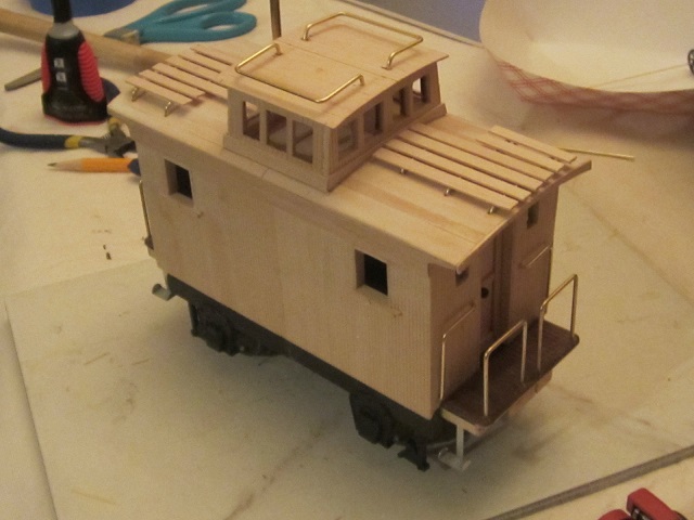

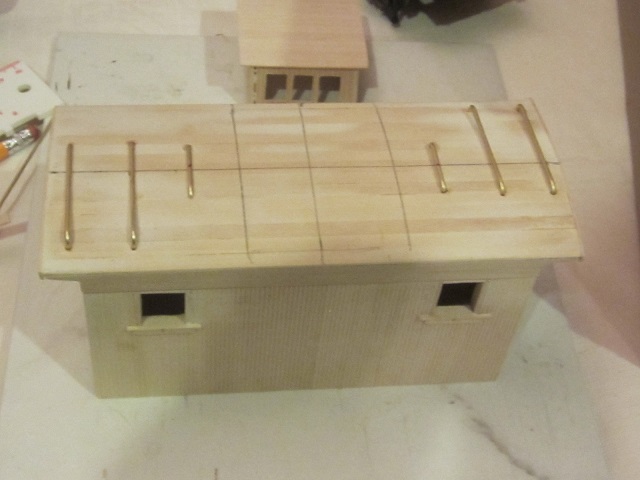

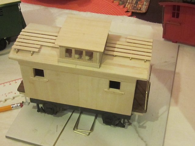

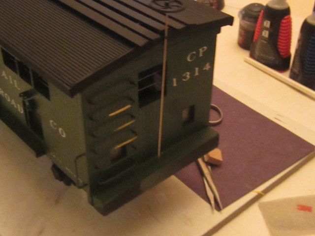

More work on the caboose.I attached the walkway to the roof and started the rails on the front and back of the caboose.

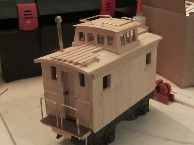

I have added more detail to the caboose.It is ready for painting now.I just have to add the access ladders and stencils.

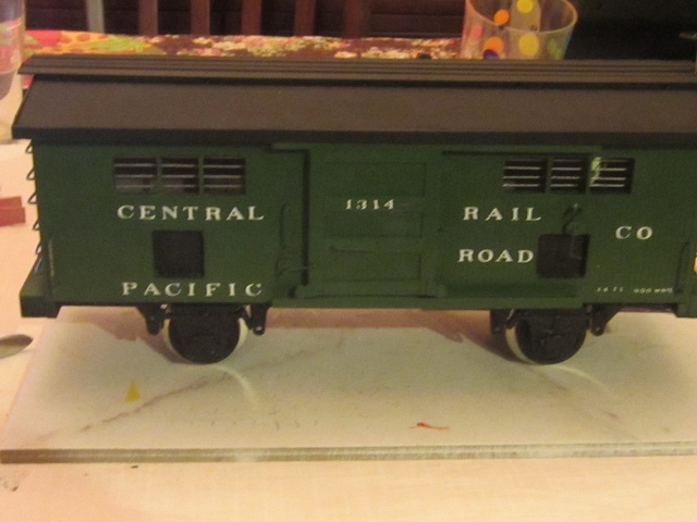

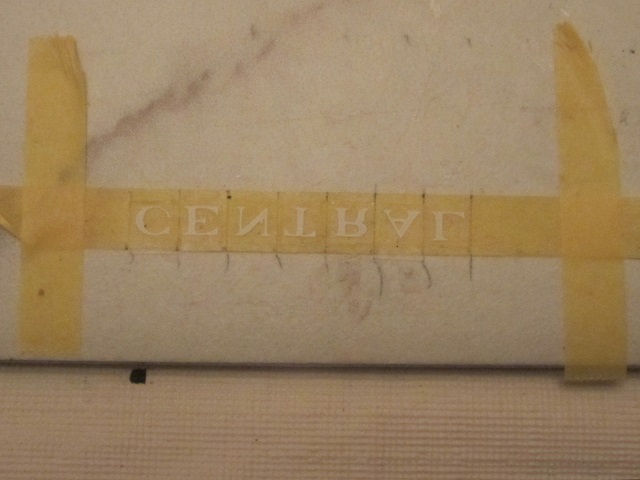

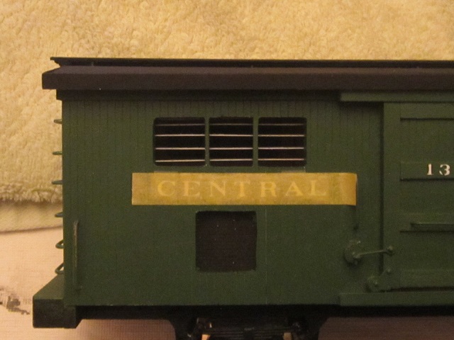

More work on the boxcar.I bought some dry transfer letters to add some detail. I thought they would be easy to apply, but they were terrible.They did not transfer well so after some frustration I came up with a way to get them to work.I placed the letters onto some Tamiya tape and then I could attach them to the boxcar with the tape and keep peeling the tape back and forth checking that they hade transferred.it was pretty tedious work, but it worked pretty well.

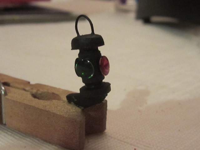

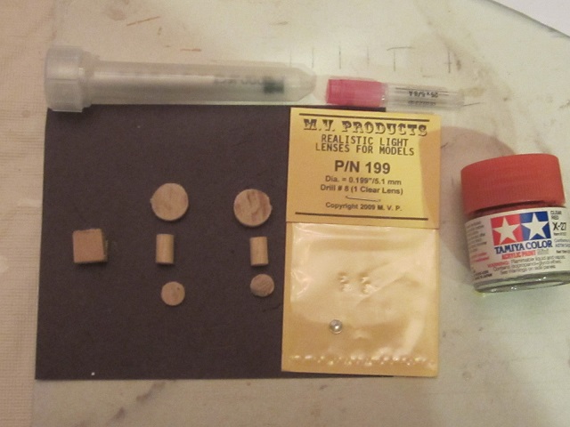

The caboose in being painted so I figured it was a good chance to make some signal lamps.I made them with a couple of different diameters of wood dowel, some MV lenses and Tamiya clear red and green paint.
