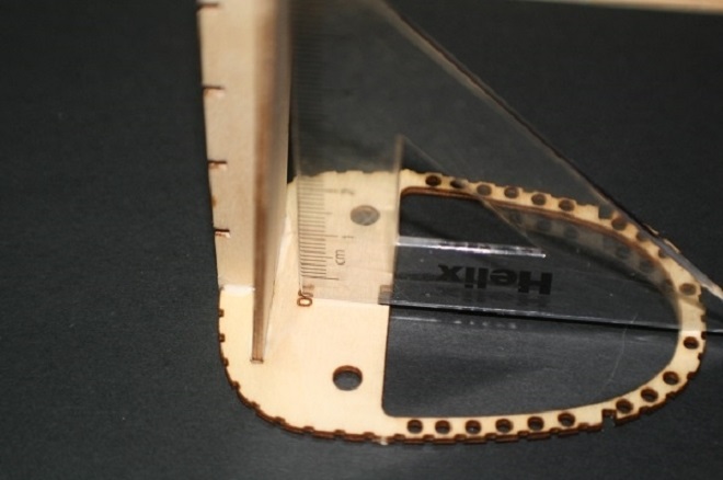

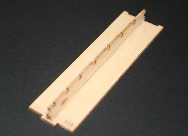

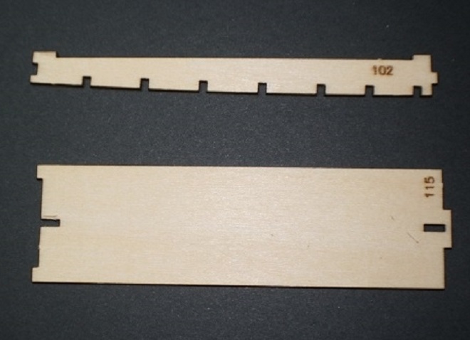

Parts 102 and 115 make up the floor base.Pic 1
Make sure the floor and the spar underneath are set at 90 degrees or you are going to give yourself a serious headache.Crying
(Also make sure you get the orientation of the two parts is correct).
This is where you should be.Pic 2

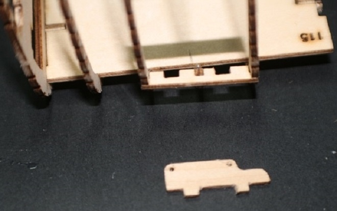

So, now you remove the first rib from the fret and clean up as required.
When fitted to the relevant end of the floor section, you will be at this stage.Pic 3

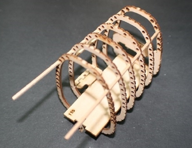

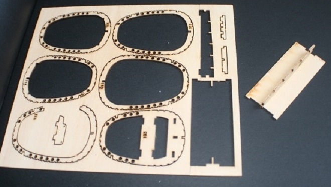

This is where things make (in my mind) a major difference worth taking note of.
Things will not be square and their not meant to be.Pic 4
Make sure you let this set rock hard before progressing, or things will not end up aligned where they should be at the end.

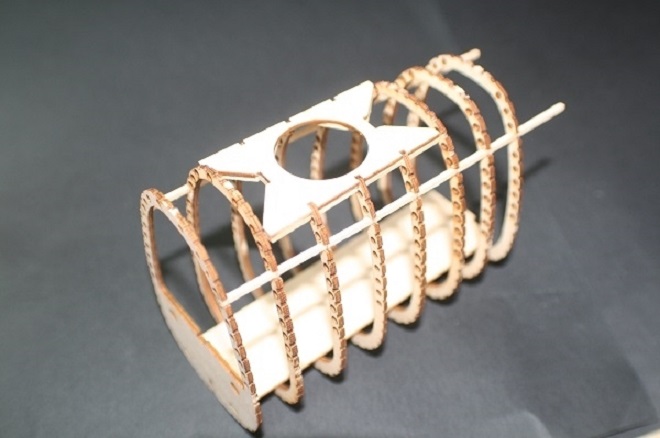

Remove the next rib from the fret, clean up, Blah Blah you get the idea, repetitive. Flapper

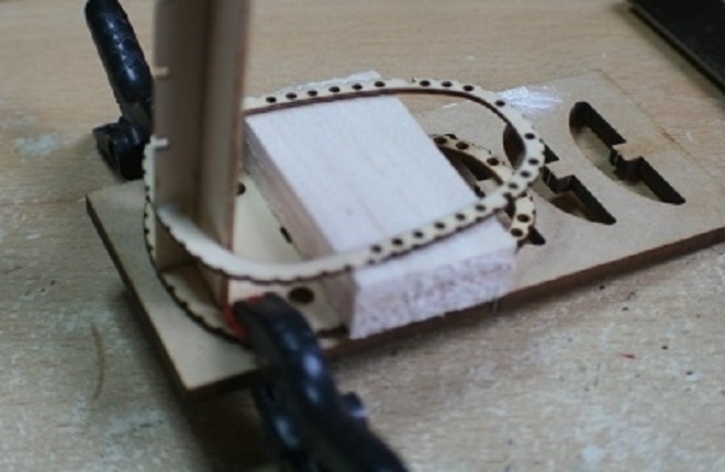

This rib has to be set in the next slot in the floor and end up parallel to the first rib.
This is how I dealt with this part of the build:

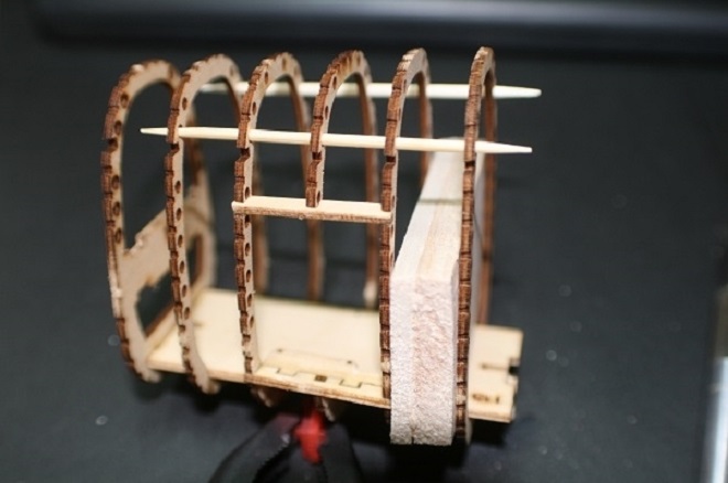

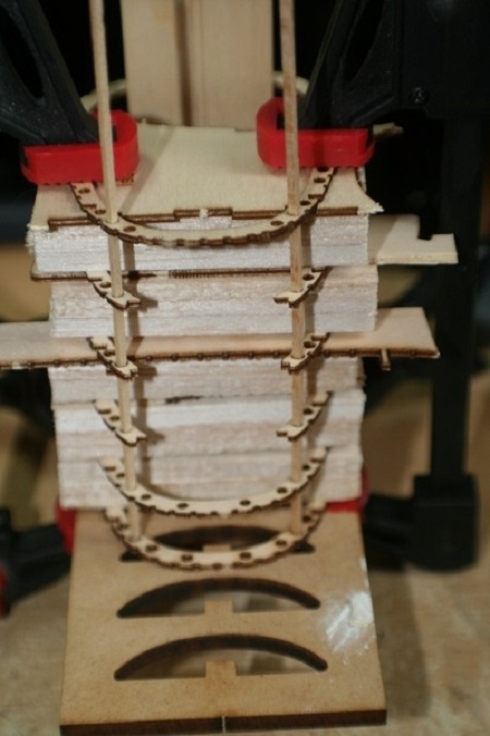

Scrap balsa, ply, basically any thing you have in your scrap bin that can be used as a measured spacer.
Lay it on the first rib and fit second rib, let it set as long as it all lines up. (More on that later).Pic 5

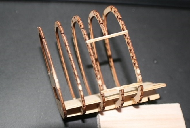

Ok, keep building up the ribs with ACCURATE spacers in between.
This is how I stacked up the ribs for this section.Pic 6
I kept the ribs aligned by using the square wood stringers supplied and fed them through the holes in the ribs. At a later stage (as will be shown) cocktail sticks work just as well.

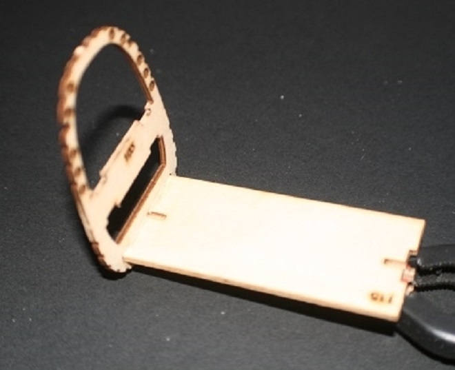

Issue 24 works on the same lines and you form the base section.Pic 7
The first rib is set in the same way as before.Pic 8
With square stringers fitted and the base of this next section made this is what they would look like if fitted together.(Not stuck yet).Pic 9

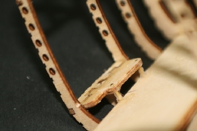

You will also see that this is where the cocktail sticks came in handy as aligning aids.Pic 12

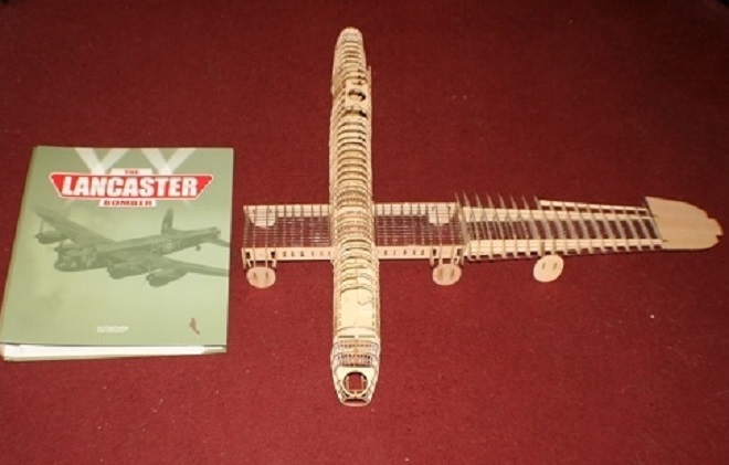

It will also include an up to date picture of all the parts rested together. Will be a long while before they are stuck together as a mountain of detail to be added while you can access the interior.
Am unable now to do the overall picture on the computer table. It has to be on the floor. you will see why later.

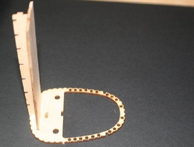

First thing to do is make a box section from the relevant parts of the fret of issue 27.
Now, some advise from my experience of this part of the build.
DO NOT glue the box to the fuselage Yet.
My box section was quite a tight fit, but went on without having to use any real force. What I failed to see, was that the glue was covering the fact that the box was not fully inserted into the end frame of the fuselage section, (only by a very, very small amount)but this error of my own making meant that everything to be added on toward the tail end was out of line.

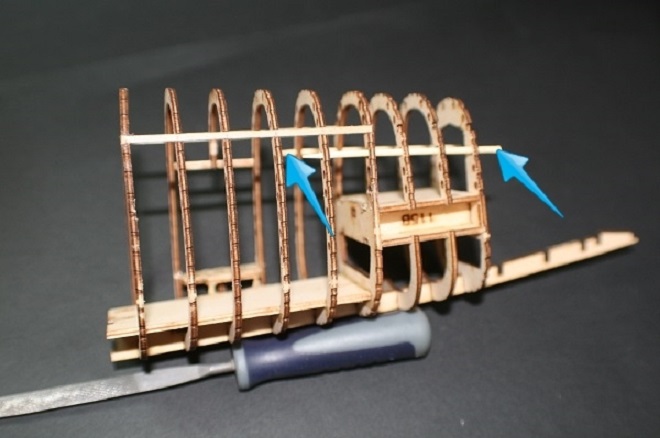

When cleaned up, I went through a process of building up the tail section using clamps. This proved that the box was too tight a fit, so filed out the locating lugs and slots very carefully until things lined up as they should.
The following picture shows the box fitted to the fuselage section made in issue 24. It is glued at this point.Pic 1

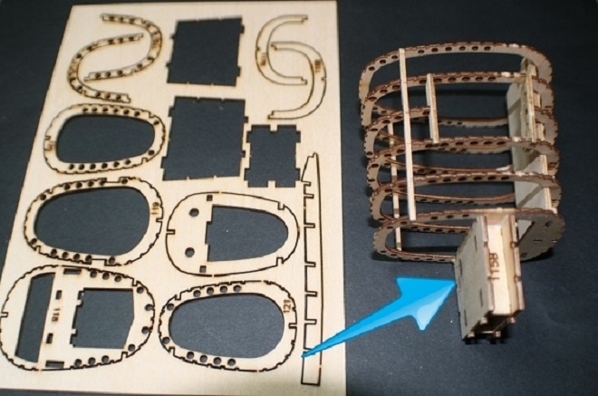

The next picture shows the parts to be fitted in this section.
The parts at this point are rested together, but supported by the insertion of two cocktail sticks through the holes in the airframes.
Cocktail sticks arrowed.Pic 2

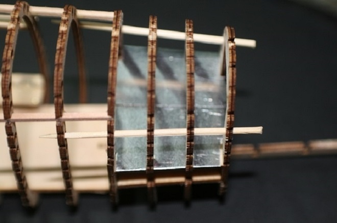

First thing to do is make sure the plates fit properly.
They have to fit in between the ribs and the centre line of the plates must meet flat and level. It may mean that you have to make some slight adjustments to the slots in the plates that fit around the airframe ribs.
You also have to make sure that both ends of the two plates end up straight with respect to each other.
Here is a picture of my plates fitted in place.Pic 3

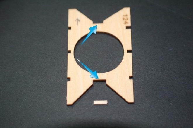

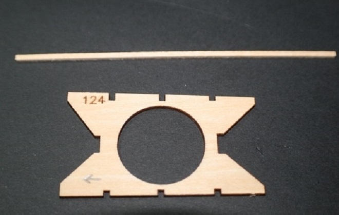

I have since moved on to build the base for the middle gun turret. This is fitted into the airframe made in issue 23.

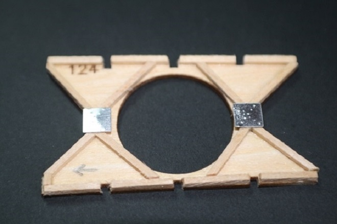

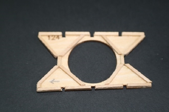

So, to issue 28 picture 18:
Take the base plate part 124 and the wood strips supplied.(Only one strip shown).Mark an arrow as you can see on part 124. This is for orientation purposes, as this plate is not square and is designed to fit one way only.Pic 4
Following the measuring instructions cut and fit the two short framing pieces.Pic 5
Carry on framing the outer edge of part 124 and you get this.Pic 6
Two very small metal plates are now rivet marked and fitted.

That`s about all done for today.
One last thing is a picture of progress so far.
Sections are only laid in place, so look a bit wobbly and it no longer fits on my computer table. Hence it`s on the floor with cats banished from the room.
The Lancaster folder by the side is A4 in size, put there as I don`t think you would see a penny in this shot.Pic 9
That`s all for now folk`s as updates now match progress. Blink
Happy Building
