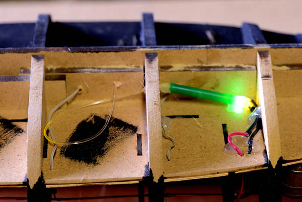

Hi All,

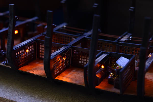

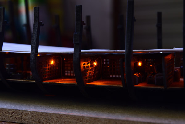

To add more light, I made 3 more lanterns.

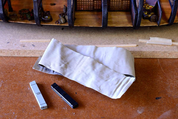

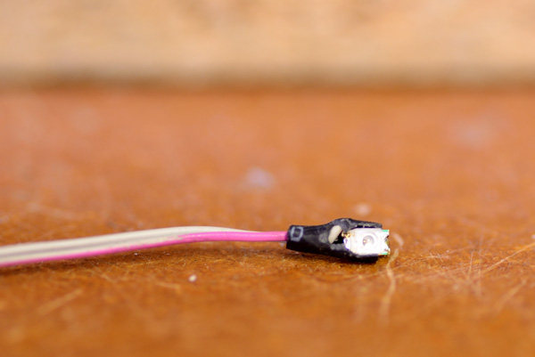

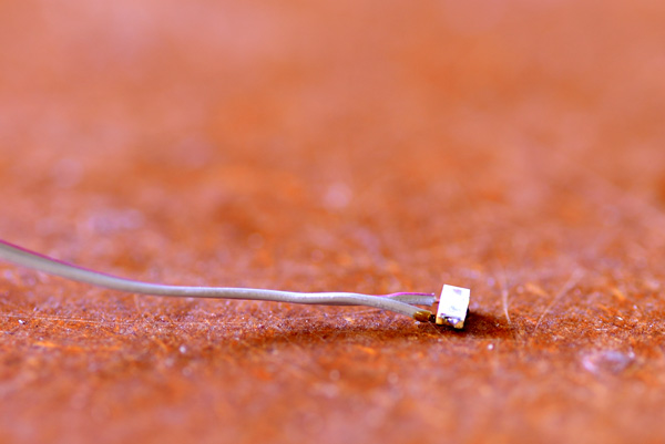

I tried a different approach on the wiring this time. I used scrap ribbon cable recovered from an old PC hard drive. This worked much better than the armature wire.
In addition, I fitted a tiny piece of heat shrink around the LED to prevent it shorting on the lanterns body. As with the other lanterns, I applied a blob of clear silicone sealer to the back of the LED and pushed it into the lantern. It’s important to leave this to dry for a couple of hours.
This method worked much better, the entire assemblies seemed much tougher and there was no ‘flickering’ once all was soldered!!!

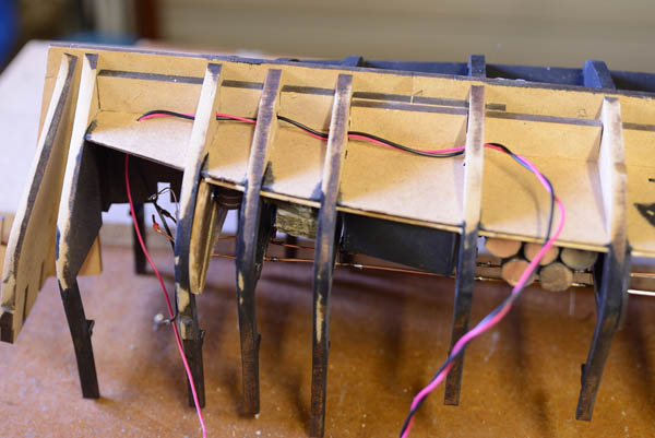

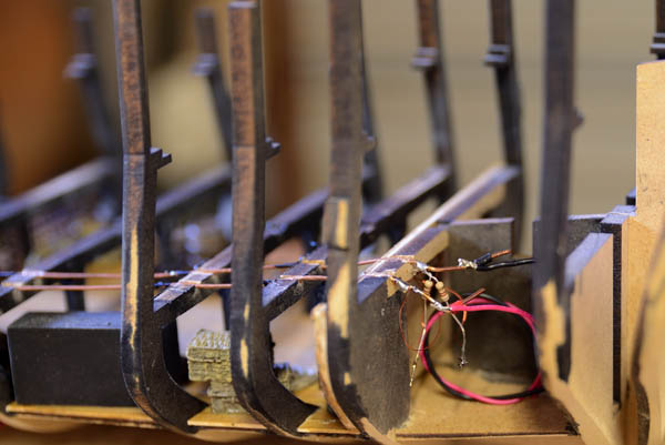

Whilst the soldering iron was out, I used the opportunity to neaten up the wiring, fit the input wires and the wires that will connect the second decks ‘Buzz Bars’.

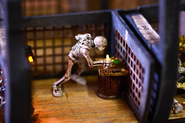

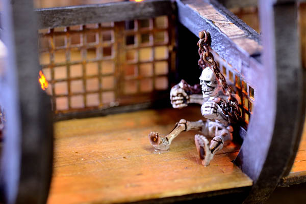

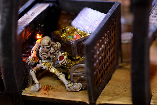

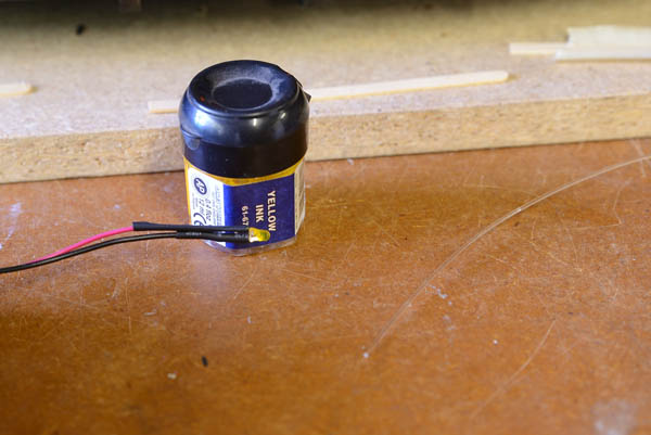

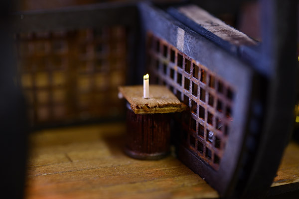

Now for a bit of fun. I have always wanted to have some skeletons in the cells and I finally was able to get my hands on some suitable candidates.

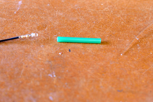

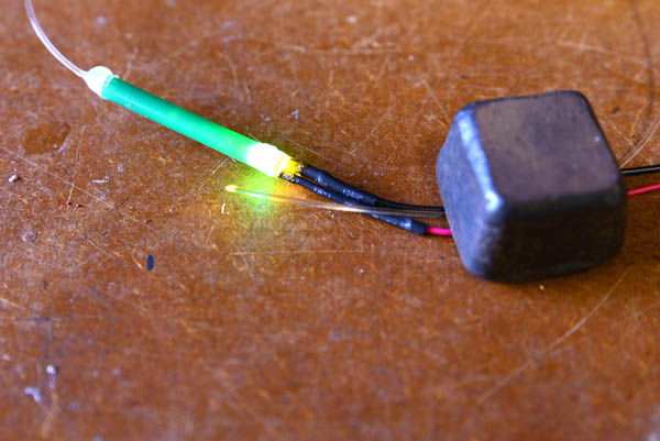

To make the candle, I used a piece of 0.75mm fibre optic. I made a projector using some of off-cut styrene tube with a 3mm LED and the 0.75 Fibre Opric hot-glued into each end.
I cut the optic at an angle to look like a flame and used some old GW Yellow Ink to change the colour of the LED.
I made a table of sorts then drilled a 1mm hole through for the Fibre Optic.
The projector and wires are tacked to the underside of the deck with hot glue.
A note on gluing Fibre Optics. Do some tests first as most solvent based glues damage the Fibre Optic and it can snap. Use epoxy or hot glue to glue them.
