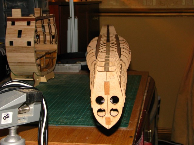

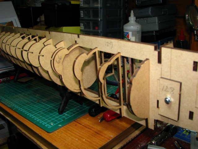

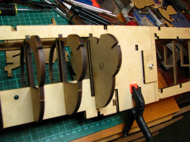

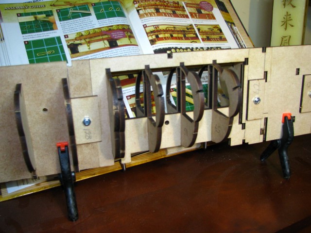

BUILD UPDATE #17
Hi again and welcome to this weeks U-96 build update which is continuing the fitting of more transverse frames up to the rear bulkhead of the engine room cutaway. Also included more nuts and bolts.
The nut and bolt sets were fitted to the remaining holes in the main framework. At this stage I had to purchase a few extra M5 nuts and bolts because the forward torpedo room conversion framework has 2 or 3 extra fixing points.
The laser cut parts consist of 5 transverse frames and a small curved section.
All the frames were test fitted first to check if any adjustment was necessary but apart from a light touch from a small file everything was OK.
Frame 65 was the first to be glued into place and this formed the forward bulkhead of the engine room cutaway. This was followed by frame 66 which was glued into place butting up against #65. Then #67 and #68, and last but not least #69. But before fitting #69, a small curved piece needed to be glued to it, lining it up with the small cutouts in the lower part of the frame. Frame #69 then became the rear bulkhead for the engine room cutaway.
That completes this weeks issue.
Thanks for the comments and thanks for looking in.
See you next week
Happy building
David

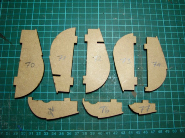

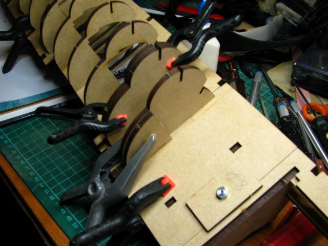

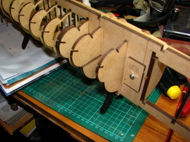

BUILD UPDATE #18
Welcome to this week's build update of the U-96.
Being at a loose end, I decided to do a bit more work on her, hence this update being a few days earlier than it would have normally been.
Before I started, I took the advice of Kev, (aka ModelMania), and bought myself a tube of Loctite. I undid all the nuts one by one and applied a dab of Loctite to the threads and tightened them all up again. There shouldn't be any problem with them working loose now. Thanks Kev.
Right then, issue #18 contained one laser cut sheet with 8 transverse frames (parts 70,71,72,73,74, 75,76 and 77) to continue the building of the left-hand side of the hull. After a light sanding to remove any rough edges, the parts were test fitted and then glued into place in their respective slots. No problems here with everything going into place nicely. I am quite pleased with how well all the parts so far have fitted together with a good tight fit.
Thats it for this update, thanks for the comments and for looking in
Happy building
David

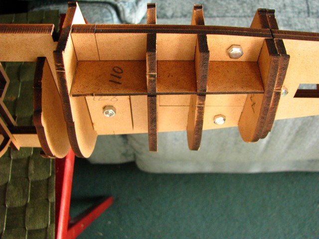

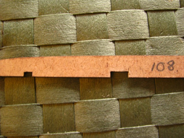

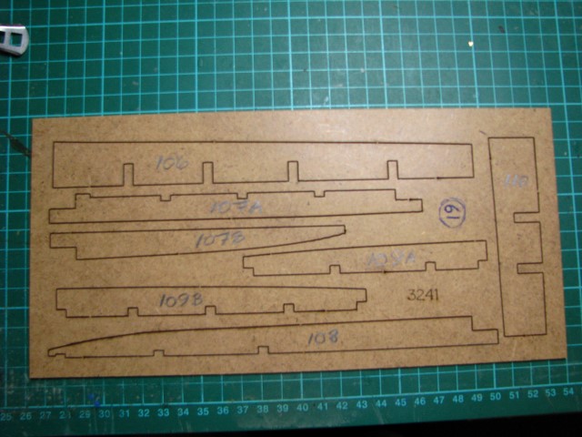

BUILD UPDATE #19
Hi everybody, here's this week's update on the U-96 build.
Issue 19 came with a laser cut sheet containing the longitudinal beams - parts #106,#107A,#107B,#108,#109A,#109B and #110.
After removing the parts from the sheet, they were given a light sanding to remove any rough edges, and after test fitting, started gluing them into place.
Part #106 was fitted to the bow section between frames #43 and #49 - part #110 at the stern between frames #70 and #73.
Parts #107A,#107B and #108 were fitted to the upper mid-section frames in the corresponding slots.

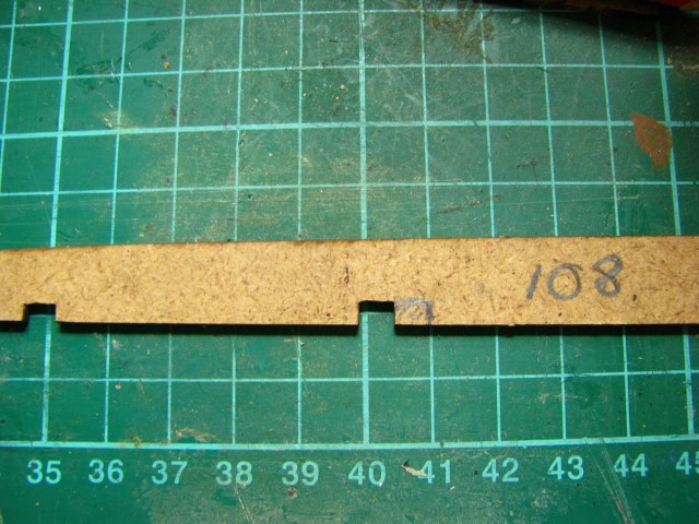

At this point there was a small problem in that there is a double thickness frame at #65 and #66 and the corresponding slot in part #108 was only wide enough to accommodate a single frame, so the slot in part #108 had to made larger to make it fit correctly over those 2 frames. Not a serious problem and easily rectified (spoke too soon in my previous post about everything fitting together well). Finally, parts #109A and #109B were added to the middle slots in the mid-section frames.
So that's it for this week, the framework of the hull is now complete and ready to accept the cladding.

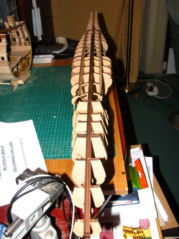

Another small problem has arisen from taking the pics this week. It was only when reviewing the shots that I noticed that the hull has a slight warp at the stern end. Perhaps I could throw it open to you guys to give me a few ideas on how this might be corrected, or do you think it may straighten out as the cladding is put on? What do you think?
Thanks for looking in and for the comments.
Happy building
David

Hi David
Is it the pic because you seem to have a bow at both ends, the only thing i can suggest is to make a dry dock and straighten the keel with clamps. once your happy everything is straight it must be kept in the dock until you have done as much planking as possible without removing it from the dock. This should straighten everything out, hope this helps.

BUILD UPDATE #19A
I managed to get the 'banana' shape of my hull sorted quite easily, although I want to take Andy's advice and make up some sort of jig to keep it clamped in until most of the cladding has been accomplished. Lots of things are going through my mind on that score, we'll see what evolves.
As I said, it was an easy fix due to the pliable nature of MDF on long, thin strips. So it was just a matter of applying gentle manual pressure in the opposite direction to the areas in question. Whether this 'hands on' technique is right or not may be questionable (the possibility of breakage being high on the list) - but then, whatever works!!!
Happy building
