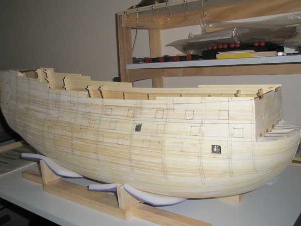

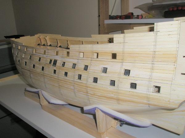

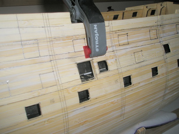

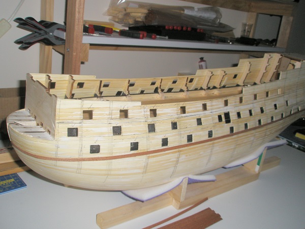

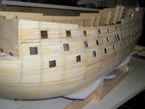

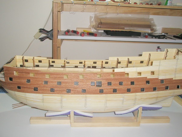

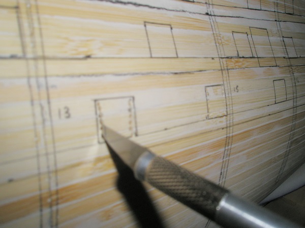

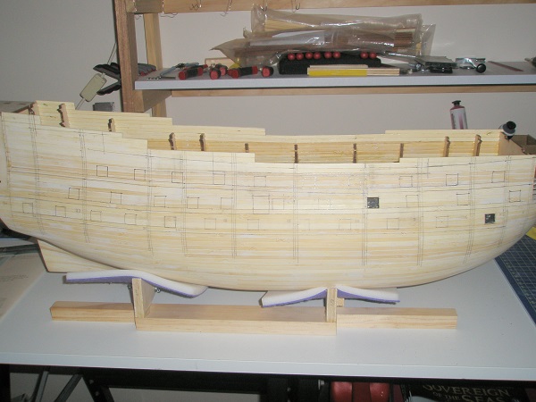

Hi Everyone
Here is December 2014 Progress, it's early as I shan't be doing any more building until January as I have other things to do.

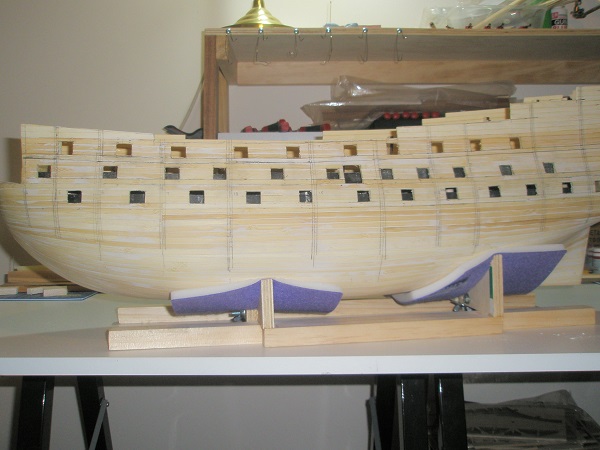

I'm still working through issue 35, marked out the hull as shown. Made a blue initially with the access hatch in measuring the 20mm height from the gunport line, which made the hatch 5mm too high...Blushing Blushing Picked up the error when marking out the top gunport line...BigGrin

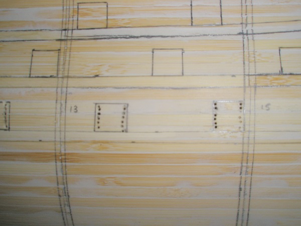

Had to do a bit of experimenting for the best method of cutting out the gunports.
Issue 35 step 26 shows a little hole drilled in the centre of the gunport square...Huh Not sure why. Step 27 shows the gunport completely cutout and being trimmed...like magic!!!Huh Huh It alludes that the square was cutout using the craft knife...Huh Huh Huh I SAY NO WAY, Mr DeAgostini, it is nigh on impossible to cut bamboo cross grain with just a craft knife!!!Huh (and with slightly rheumatic hands)...Mellow So I devised a method of drilling a row of little holes just inside the vertical lines and then it was just a matter of joining the dots with the craft knife...Cool Initially used a pin drill but that was time consuming, so in deference to my penurious nature went and splashed out on an El Cheapo mini rotary tool kit for $20 - it's absolute rubbish for doing anything but drilling little holes...BigGrin But I can bin it at the end of this little caper...BigGrin BigGrin
Just got to tidy up the port holes as some of them are slightly undersize, then repaint some of the black paint inside...Cool
Progress pics below.
Kind regards to All
with best wishes for Christmas and happy building in 2015...BigGrin BigGrin

#146 Posted : 16 December 2014 18:14:57
Lovely work John, she's certainly coming along nicely....Cool Cool .. Cutting the bamboo with a craft knife isn't impossible but will admit it is very difficult to cut cross grain, tend to end up going through lots of blades in the process...Cool Cool .. We all find our own ways of cutting out gun ports and for me I used my trusty dremel with a routing bit attached... got to ensure you keep the dremel under control through as it does have a tendancy to try and skip away from you.... method worked for me and from there simply sanded the edges smooth and to the correct size.....Cool Cool .. As for the hole in the middle, some builders use this to help find the centre point for the gun barrel by drilling through to the dummy gun support behind....Cool Cool ... Look forward to your return in January....

Thanks for the compliment and yes I found that drilling lines of holes made for easier progress of the knife cross-grain. The knife kept jamming otherwise.

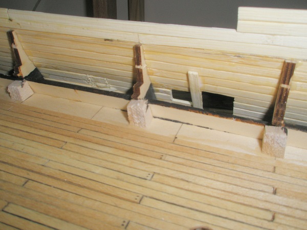

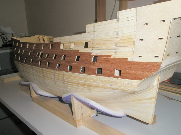

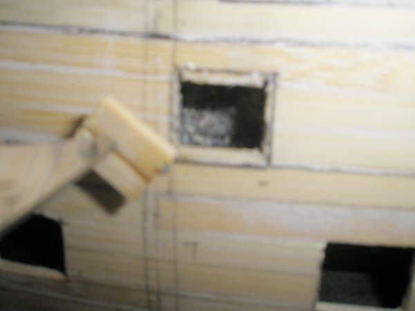

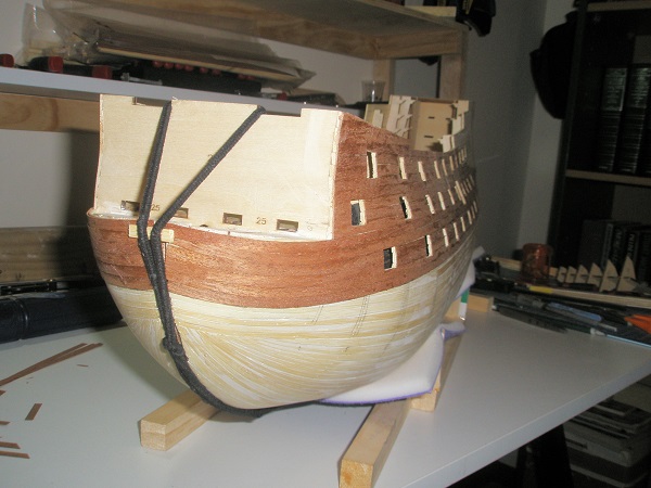

Hi All

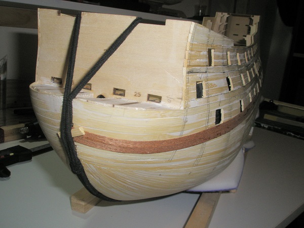

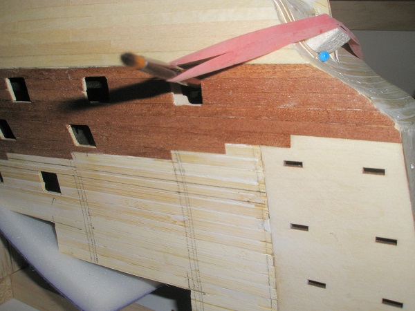

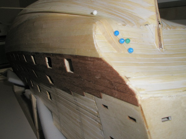

Following is my progress for January 2015.
Have received up to issue 46 but still working laboriously through issue 37 - oh yes and I finally received the missing issue 21 a couple of weeks ago...so now I have 4 unused packs of bamboo planks...Blink
All gun ports now cut out and trimmed to specified size in accordance with issue 35...although I do have a question regarding the stern-most gun port on the lower gun deck. What is this gun port for?...as the dummy cannon support piece was cut away as per issue 14 step 1...Confused Confused
First 2 pics are showing vertical reinforcement I was obliged to make on that little narrow bit between the access hatch and the gun port...Blink A little too much pressure on the craft knife and it caved in...Blushing. I had to reinforce in a few other areas as well when the bonding between some planks cracked apart...Blushing

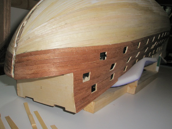

The following pics show brown planking complete both sides per issue 36. Note my high tech construction aid - an elastic band to hold down the front end of planks while the glue cures...Cool Cool
Working on the white planks now (issue 37) and completed the first 14 rows on one side. Had a spot of bother in bonding the ends that bend up under the transom and that's where I found out what that stern-most gun port is for...to provide an anchorage point for my trusty elastic band...Laugh Laugh Laugh
Happy building to All
JohnP

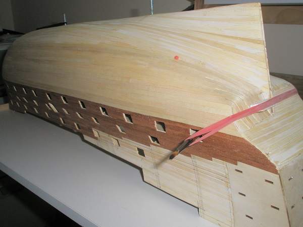

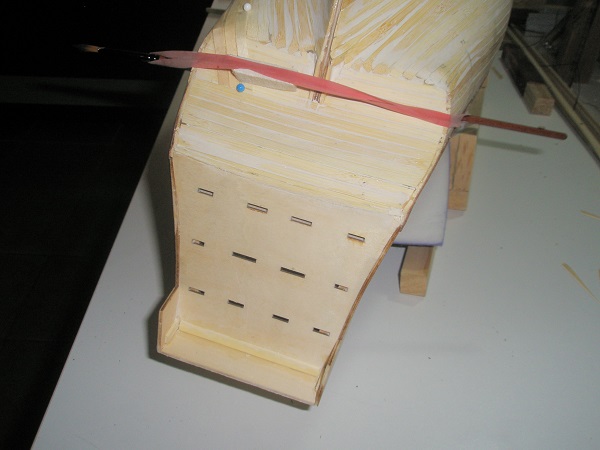

#151 Posted : 24 January 2015 14:05:59
#152 Posted : 24 January 2015 14:34:08
Definitely coming along very nicely John, looking great....Cool Cool .. Don't be to concerned about the last gunport on the lower row, just make sure it is in the correct position and the right size. This gunport will end up being a closed port as can be seen on the last pic of this page on my diary....Cool Cool
http://forum.model-space...ts&t=5013&p=156
Keep up the good work, you're doing a great job....Cool Cool
#153 Posted : 24 January 2015 14:49:16
Hi Alan, BigGrin
Coming on a treat, WTG.
Some ingenious clamping methods in use as well. Cool
Keep up the good work.
