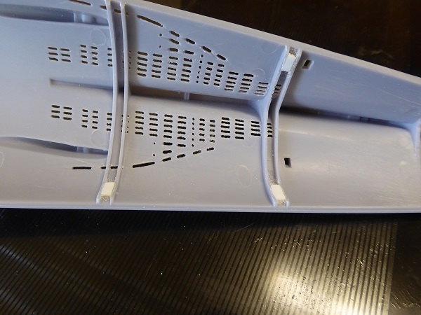

Packing pieces made of square acetal strip were cut and filed to shape and added to the replacement part.

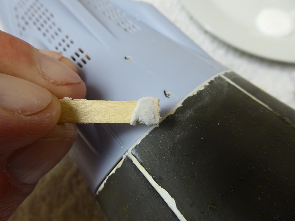

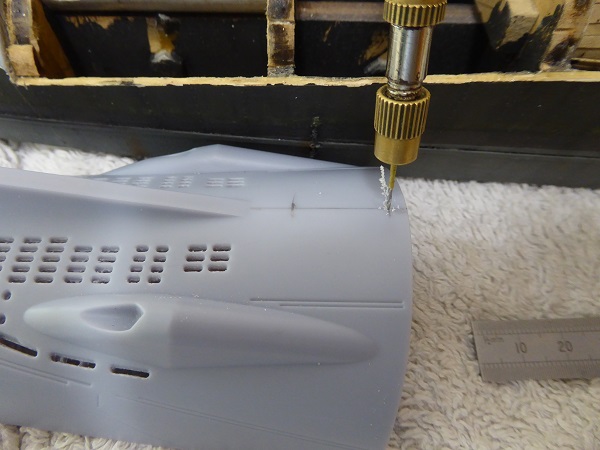

I then drilled 0.8mm diameter holes through the replacement part so they aligned with the packing pieces.
The reason for this is so I can pin the replacement part with brass rod once it has been glued in place. Gluing alone doesn't provide enough strength and I have used this technique extensively on this build.
The replacement part has to support both prop shafts, propellers, two rudders and two aft diving planes, plus all of their support brackets. Pinning with brass rod means this part will provide a very strong platform to fit all of these extras.
See attached photo of a 0.8mm diameter hole being drilled through the replacement part.

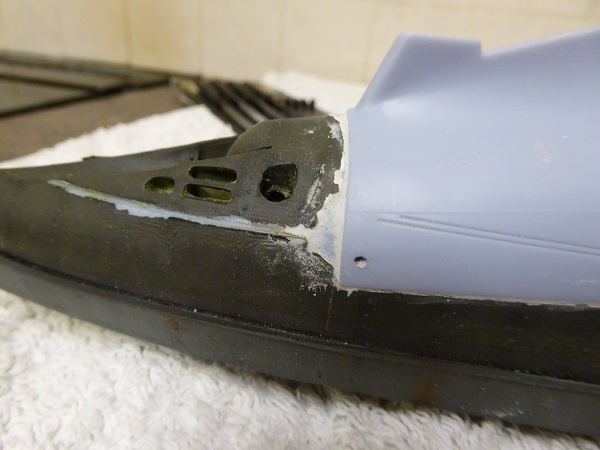

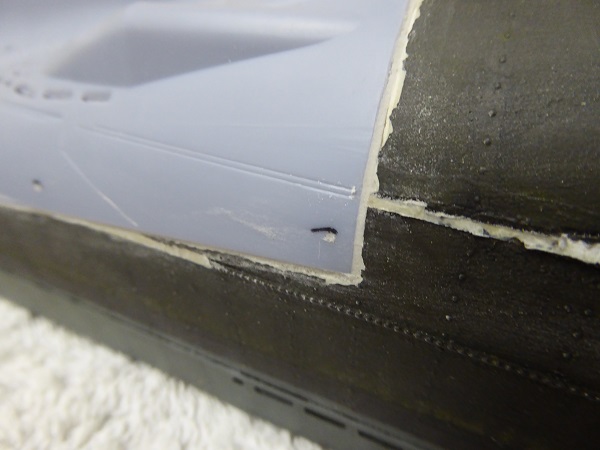

Once all the pilot holes were drilled, I deburred them and glued the replacement part to the hull with PVA glue. See attached photo. I will let this dry thoroughly over the weekend before moving onto fitting the brass pins, which i'll detail in my next post.

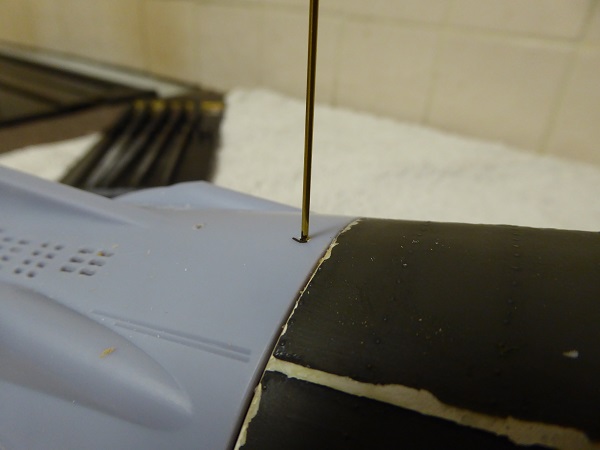

Further progress was made on the hull repairs. After the replacement part was glued into place, the next step was to reinforce it by inserting brass rod, cut to length, to act as strengthening pins.
I had already drilled the pilot holes as mentioned in my last post, so it was a case of opening them out to the correct diameter of 1.0mm for the brass rod.
The attached photo shows the brass rod inserted into one of the locating holes until it 'bottomed out'. I then marked the rod, withdrew it and cut just below the mark so the rod would be just under the surface of the hull when fixed. I continued in this manner until all holes had been drilled out and brass pins fitted.
#1572 Posted : 15 May 2020 07:43:09

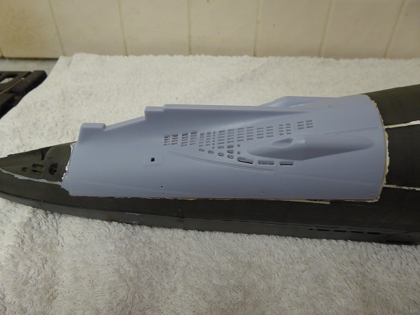

I then proceeded to fill the gaps with Exterior Polyfilla. I let this dry overnight and applied a further mix in places where it had shrunk a little.
#1573 Posted : 15 May 2020 07:47:09
I have found that I prefer using Polyfilla on this model for various reasons; its easy to wipe away excess when applying, its easily sanded when dry, it can be watered down, which is handy on smaller areas and it takes paint reasonably well.

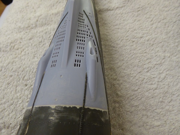

#1574 Posted : 15 May 2020 07:48:53
Filler work.
#1575 Posted : 15 May 2020 07:50:18
More filler work.

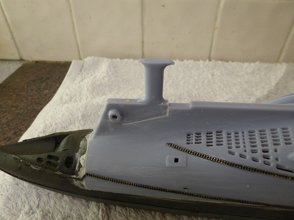

#1576 Posted : 15 May 2020 07:52:31

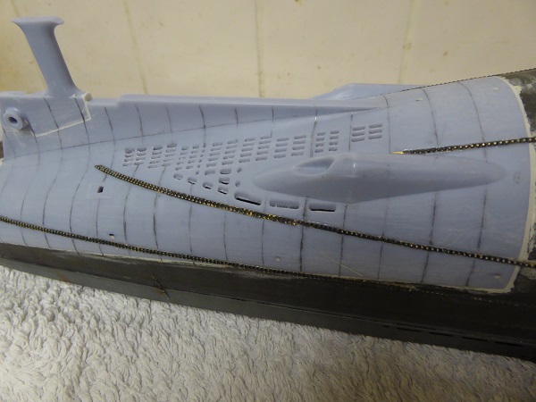

The next job was to attach all of the etched brass rivet strips that I had to remove to conduct the repairs. This is where labelling them made for easy identification and positioning.
#1577 Posted : 15 May 2020 07:53:40
From another angle.

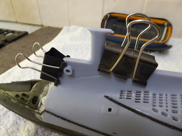

#1578 Posted : 15 May 2020 07:56:51

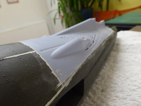

I then fitted the rudder mount after cleaning up the edges and removing any flashing or burrs. It was held in place with a couple of bulldog clips.
#1579 Posted : 15 May 2020 07:58:07
Rudder mount glued, drilled, pinned and all gaps filled and sanded.

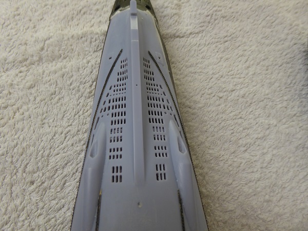

#1580 Posted : 15 May 2020 07:59:56
The last job for this week was to mark out in pencil, all the guidelines for applying the embossed rivet and weld line decals.
