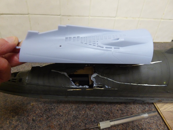

Well I've been busy working, interspersed with sporadic model making sessions. Progress has been slow but steady as I concentrate on the repairs.
See the attached photo showing the replacement part that I will have to fit.

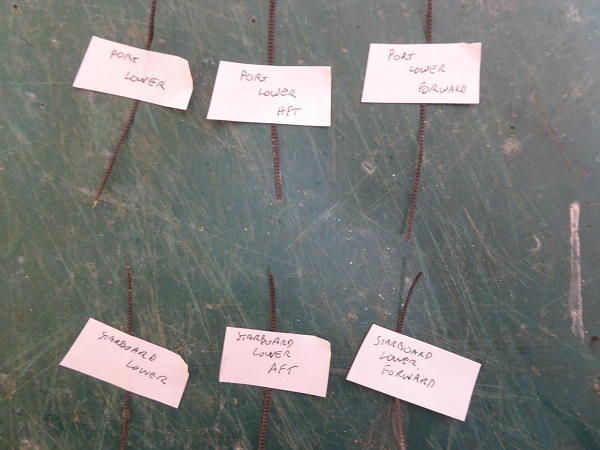

The rivet strips on the affected parts were carefully removed and labelled.

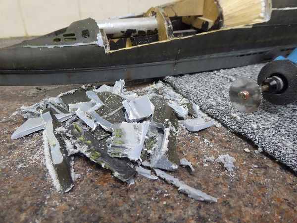

The next step was to tentatively remove the melted parts without causing further damage. So I proceeded to remove small sections at a time causing a great deal of mess!Flapper LOL

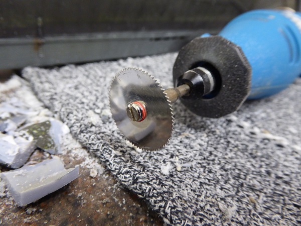

The slitting saw attached to the Dremel made light work of the thicker plastic parts!

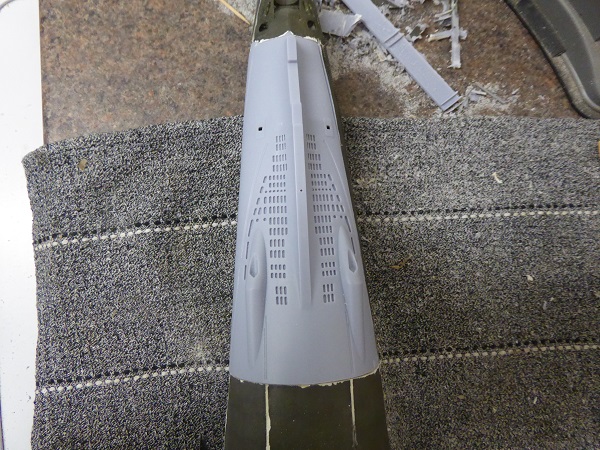

#1548 Posted : 24 April 2020 12:01:21

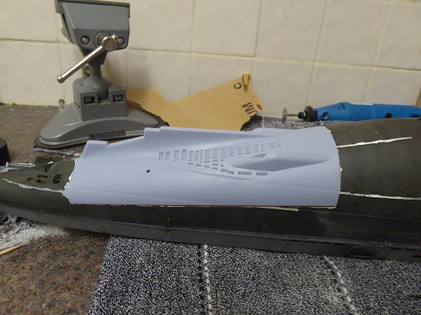

Replacement part now sitting in it's correct location. Not fixed or glued at this stage. A lot more work involved such as filling, pinning, fettling and filing.

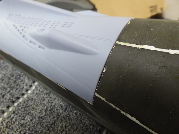

#1549 Posted : 24 April 2020 12:02:12
Plenty of gaps to keep me busy with filler and sanding!LOL

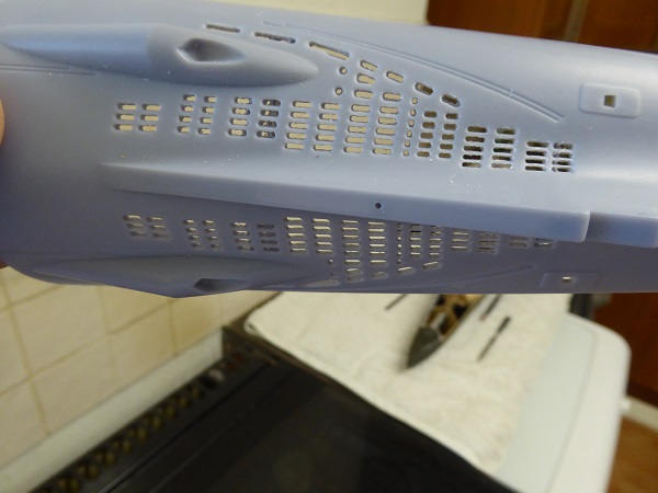

More progress has been made on the hull repairs. I spent a bit more time ensuring that the replacement part would fit correctly. Far easier to write these words than accomplish!LOL The idea being that it fits with all edges aligned and no force required to achieve that.
The next step after this was to drill out all of the free flood holes with a 0.8mm drill bit and dress them with a needle file. This took about 6 hours in total. See attached photo.

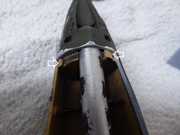

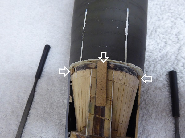

The next step was to fit packing pieces, which I will use to fix the part too. There are several of these packing pieces and I would fit one, then file it to size by constantly checking that the replacement part aligned as it did before. If it sat too high, I would know that packing piece was sitting too proud. It was far easier to fit one at a time, which narrowed down which packing piece to work on.
See attached photo showing three packing pieces fitted, indicated by arrows. They were all made from MDF cut offs, fixed with PVA glue and left to dry overnight before filing them. By fitting one at time, it took several evenings to complete this stage.

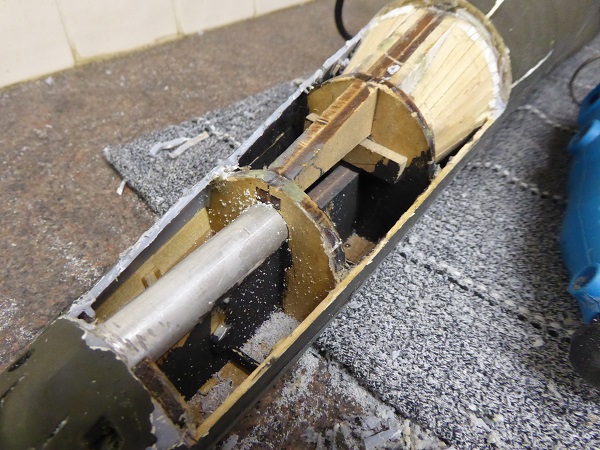

#1560 Posted : 09 May 2020 10:58:38
More MDF packing pieces, indicated by arrows.
