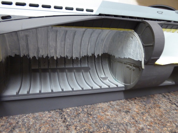

This photo shows the same compartment finished after 4 coats of matt white. Any bleed through under the masking tape was touched in.

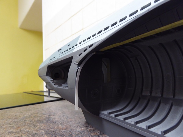

The next task was to mark out a guide line for the upper, matt white above deck level and the window grey below deck level. The idea being that I could freely paint the white by going just over the line and only have to mask up once when I start the window grey.
The attached photo shows the guide line being marked out in the Engine Room. I then continued to mark out the Aft Torpedo Compartment/Motor Room, as this follows the same split colours.

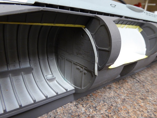

#1543 Posted : 30 November 2017 21:53:10
Engine Room masked up, looking forward.
#1544 Posted : 30 November 2017 21:55:52
Engine Room masked up, looking aft.

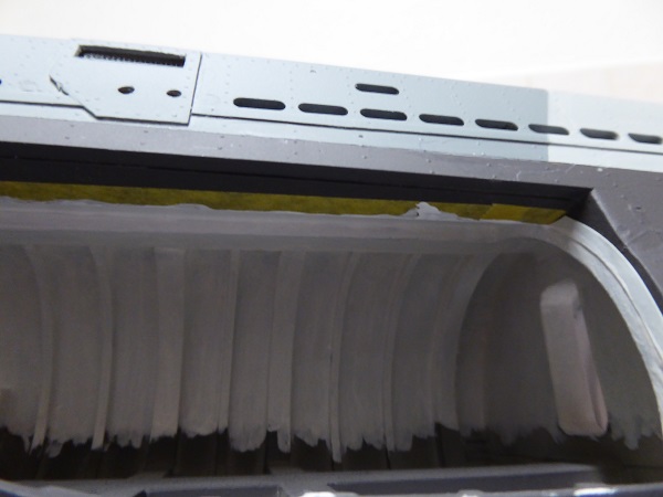

#1547 Posted : 30 November 2017 22:03:47
After the 4th coat i'm happy there's a nice even coverage and leave the white at that. Granted, it still looks a little scruffy, but i still have to touch in where the white has over ran onto the dark grey, then mark out, mask up and apply the window grey to the lower half. Only then will it look proper.

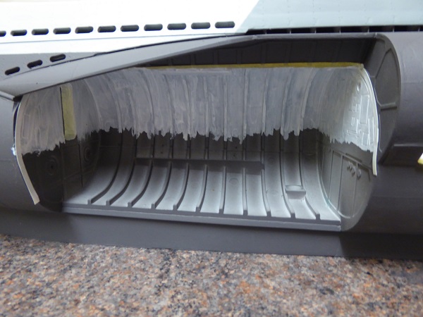

#1548 Posted : 30 November 2017 22:05:43
The Aft Torpedo Compartment/Motor Room after three coats of white. The compartment itself is in shadow, so looks darker than it is. More work to do on this section.

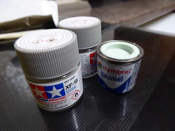

The window grey for the lower half of the compartments is classified as RAL 7040. A close match for this is Tamiya XF19 [Sky Grey]. I bought two pots of this to be on the safe side and a pot of 'Duck Egg Blue' for some of the machinery in the U-boat, a colour we used in submarines for the same purpose. Different systems have different colours making it easy to identify, especially with so many valves and hand wheels.
