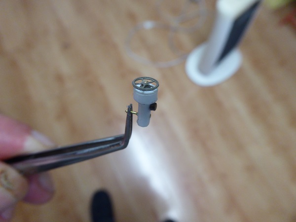

Just a short update after the disaster that unfolded earlier this week.
I made a hull valve that is located in the deck-head of the aft torpedo compartment. It was during the making of it, when I flipped the U-boat over to check it for fit, that i discovered the damage.
The photo attached shows the hull valve ready for painting. The small, brass pin is 0.5mm rod and is used to securely locate the hull valve to the deck-head.
The main body was made from 2.5mm diameter and 5mm diameter styrene rod, with a brass pin running through both to secure. The valve handwheel is an etched brass item. I added an M1 bolt head to the valve body for detail.

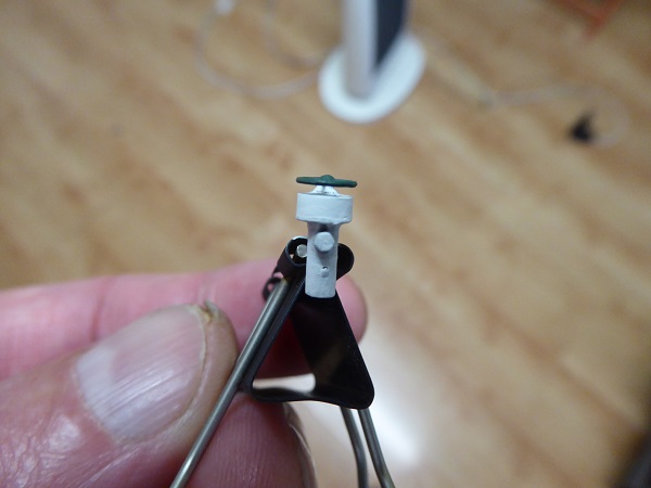

#1533 Posted : 09 April 2020 10:16:39
Painted.

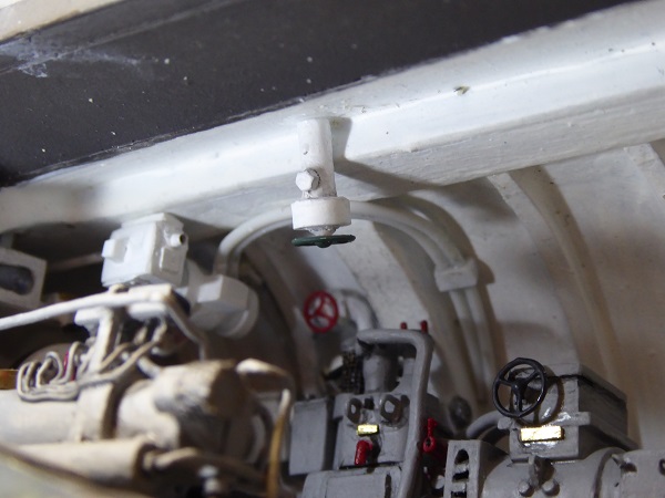

#1534 Posted : 09 April 2020 10:21:23
Fitted.
