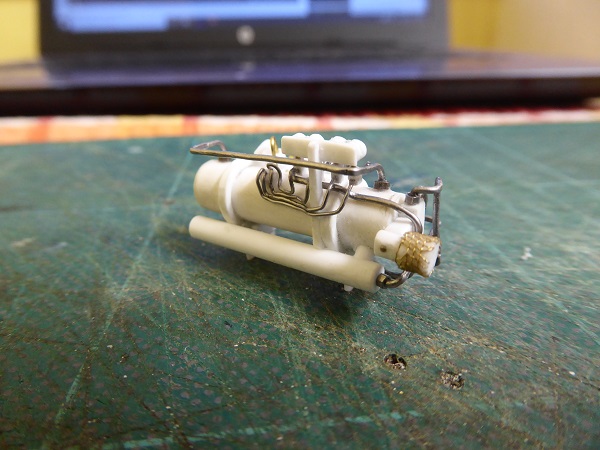

Fitted to the left hand side of the compressor.

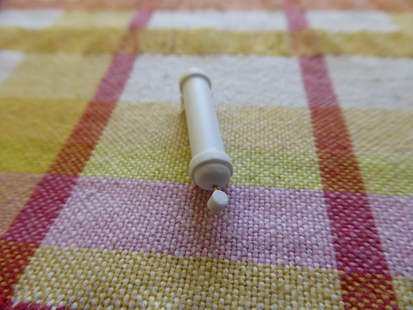

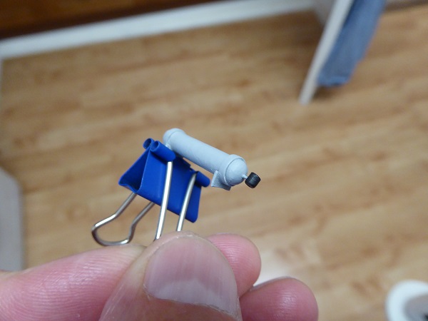

A little more progress made this week by scratch building a compressed air cylinder. This cylinder is part of a myriad of various sized compressed air cylinders, which i'm currently building and will post updates on these next week.
I started off by cutting to length a 3.5mm diameter styrene rod. With careful filing I shaped the domed ends and I have to say i'm very pleased with the way they have turned out.
The next step was to make and fit straps, front and back using styrene strip.
Following on from this I made the air gauge, fitted to one end and finished off by making the support brackets, again, from styrene sheet.
The attached photo shows the completed compressed air cylinder prior to painting.

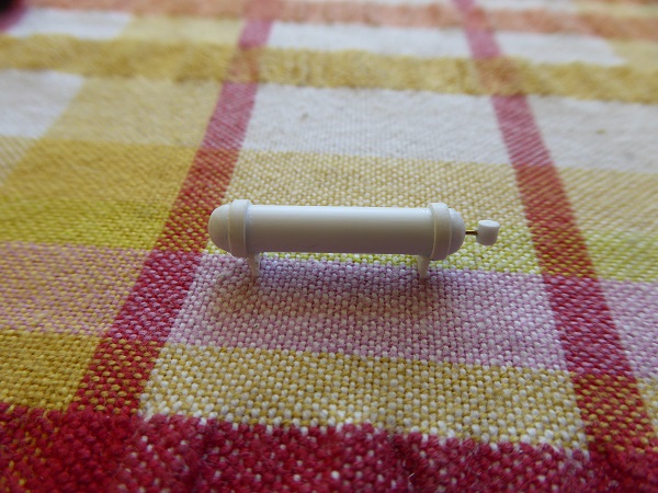

From another angle.

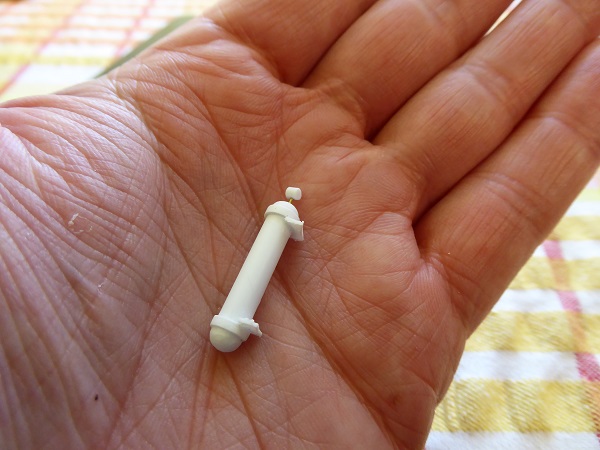

#1491 Posted : 27 March 2020 09:38:51
Photographed in my hand to a give a sense of scale.

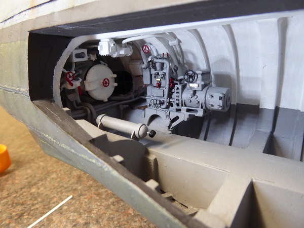

#1492 Posted : 27 March 2020 09:39:16
Painted.

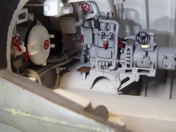

#1493 Posted : 27 March 2020 09:40:20
Fitted.

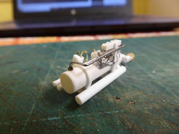

Last week and this week I have been busy scratch building the myriad of compressed air tanks and gauges for firing a torpedo from the aft torpedo compartment.
Materials used are styrene sheet and rod, brass gauze, various diameters of solder and 0.5mm brass rod as locating pins.
The attached photo shows a front view of the air tanks awaiting painting.

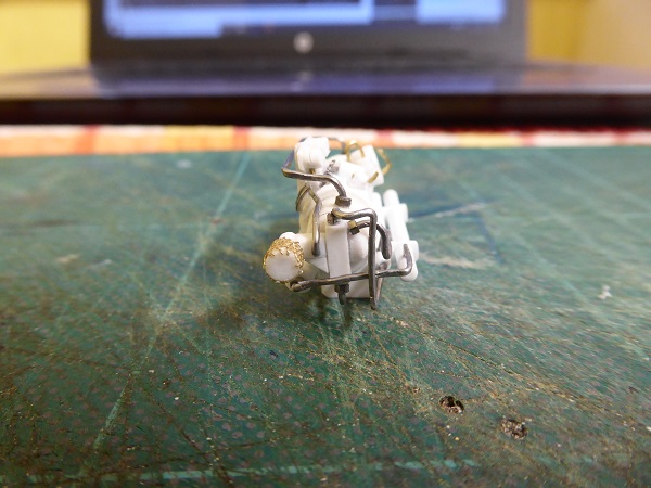

#1498 Posted : 03 April 2020 14:25:43
3/4 front right view.
#1499 Posted : 03 April 2020 14:27:31

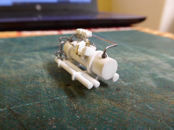

3/4 rear right view.
#1500 Posted : 03 April 2020 14:28:34
3/4 rear left view.
