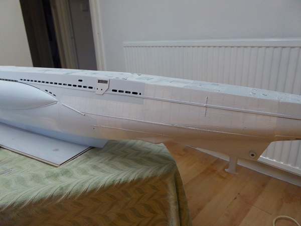

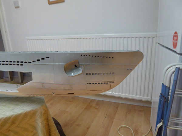

I chose to prime the boat in Vallejo white rather than grey primer as i felt the latter would prove difficult to define once I started putting colour on.
The attached photo shows the bow in primer. Spraying took a long time in all of the different stages due to the large surface area.
#1402 Posted : 26 October 2017 21:27:04

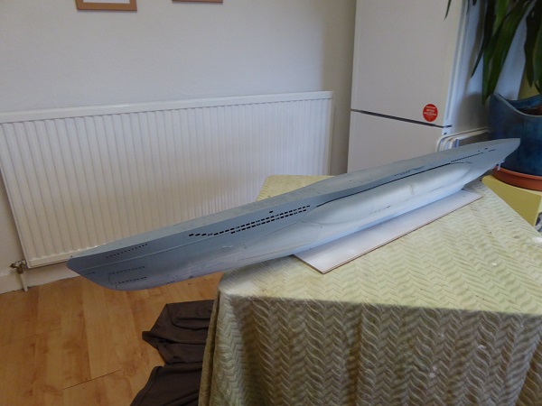

Looking further aft. What you see is the result of several thin coats, building up an even finish. The different materials that make up the boat; plastic, brass, filler in places and glue, all had a different effect on the paint when keying it in.

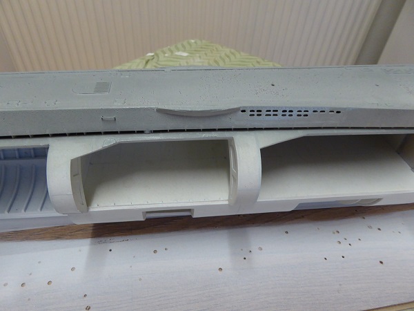

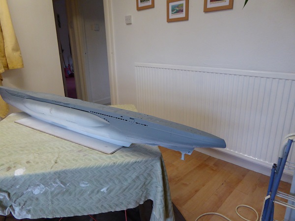

Stern in primer.
#1404 Posted : 26 October 2017 21:28:14

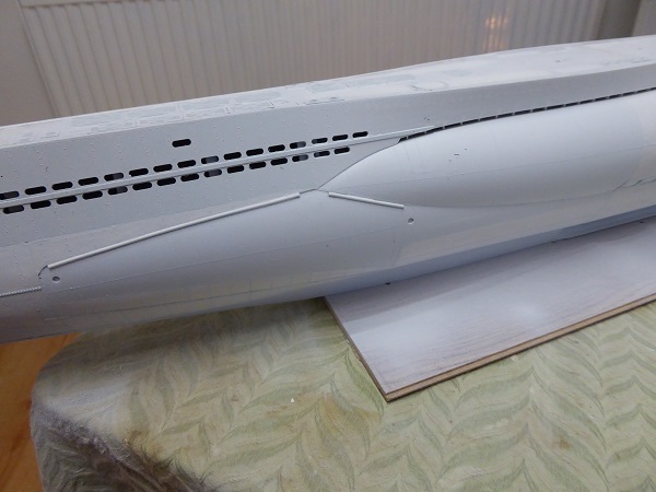

From above.

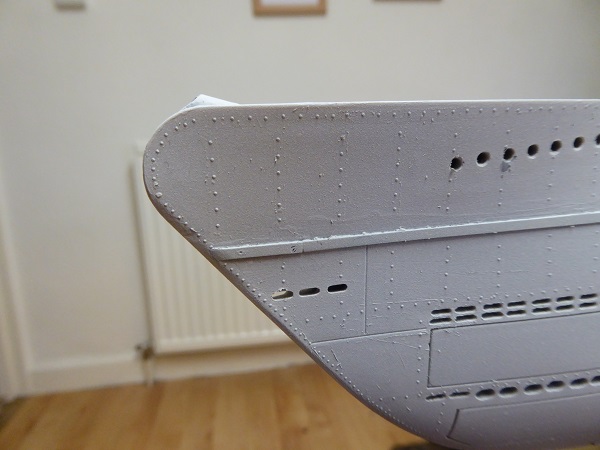

Close up of the bow in primer.

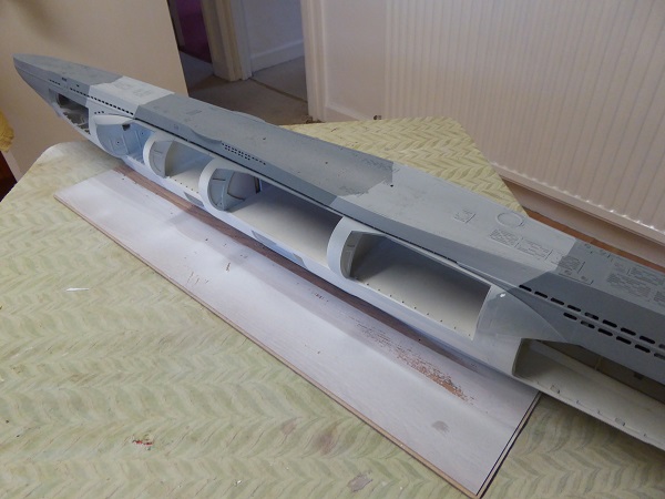

#1407 Posted : 26 October 2017 21:49:27
Continuing aft with the medium grey.
#1408 Posted : 26 October 2017 21:50:22
Moving further aft.
#1409 Posted : 26 October 2017 21:51:56
Medium grey completed, looking at the port side.
#1410 Posted : 26 October 2017 21:52:23

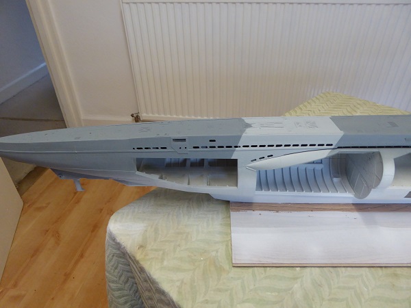

Looking at the starboard side. I then sprayed over the medium grey with matt varnish to seal the paint and prevent 'lift' when masking.

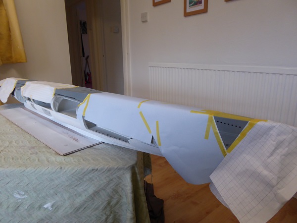

#1411 Posted : 26 October 2017 21:57:54
One of the reasons i like the look of U230 in the later stages of it's short life is that it sported light grey, camouflage stripes.
I used Hellgrau 50 [light grey] for the camouflage after studying a photograph of the real boat in La Spezia in 1943 and reading Dougie Martindale's article on U-boat paints.
This photo shows the areas to be painted, masked off.
#1412 Posted : 26 October 2017 22:01:19
Masking off from above.

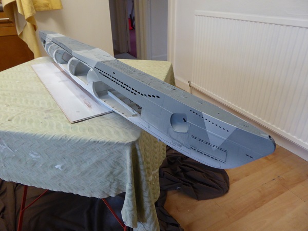

Masking tape removed to reveal the rear of the camouflage stripes in light grey. I didn't mask off the top deck to make sure I applied an even coat to the edge of the casing.
#1416 Posted : 26 October 2017 22:13:36
This photo shows the mid-camouflage stripe.
#1417 Posted : 26 October 2017 22:15:21
Camouflage pattern on the starboard bow. I based the shapes and sizes of these camouflage stripes on a photo of U230 in La Spezia in 1943.
#1418 Posted : 26 October 2017 22:18:36
Once I had removed all of the masking tape I sprayed matt varnish over these areas to seal the paint.

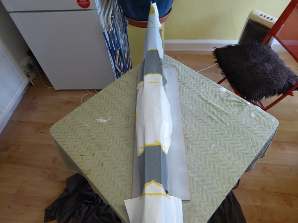

#1419 Posted : 26 October 2017 22:19:17
Masking up the stern, following the guide line.
#1420 Posted : 26 October 2017 22:19:57
Masking up the amidships section.
