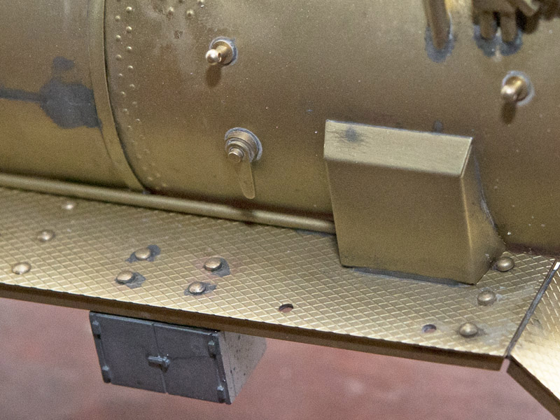

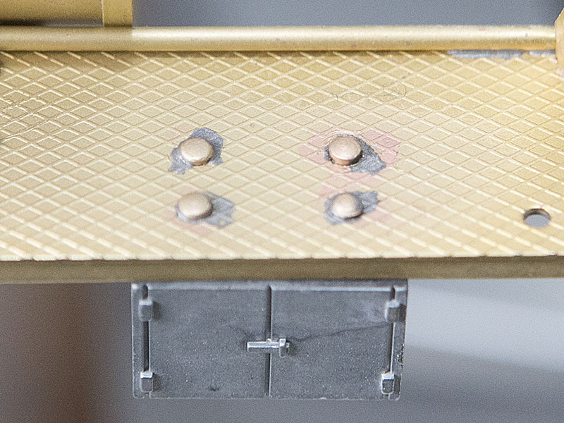

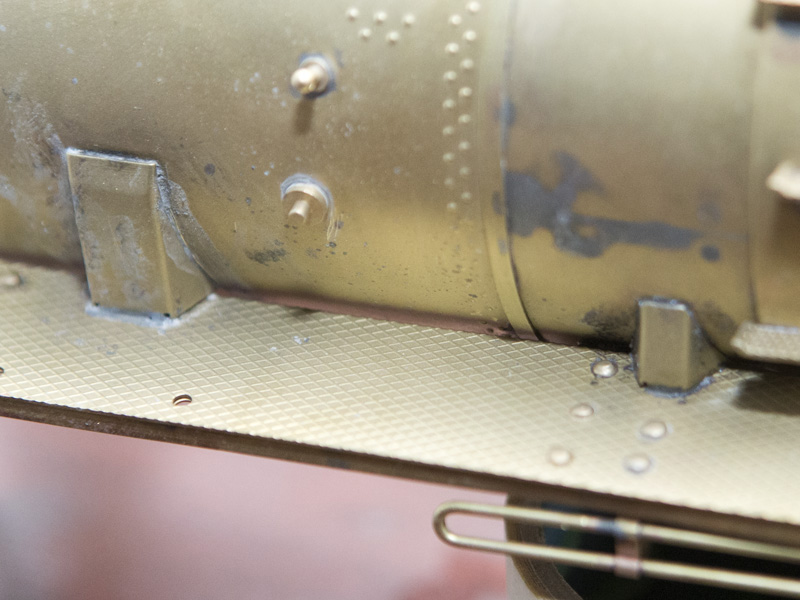

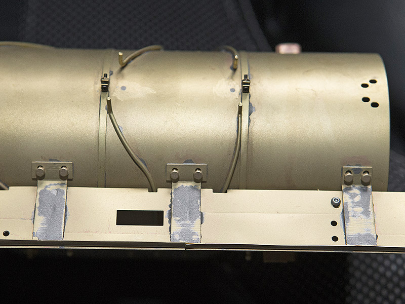

Parts 11 - running boards
I mentioned previously that I intended using rivet headed brass screws in the 2mm screw holes on the running board. Andy (Court Orchard) had mentioned they were difficult to screw in and he was certainly correct. I found the threads on the screws quite tight. Therefore I ran a 2mm split die down all the rivet headed brass screws. Also I run a tap through the already threaded brackets. I found the screws then easier to screw in. Since I was going to solder the other end of the stews any problems with a loose fit didn't matter.
Whilst I was very pleased with the rivet headed screws I did find the heads rather large. Measured they were 3.9mm in diameter compared to the kits cross heads at 2.8mm. I therefore resized the heads, reshaping as required. I simply held the screws in a battery drill and used a file to resize/reshape the heads.
The process of rethreading, reshaping etc needed to be done in a certain order to allow the stews still to be screwed in place otherwise for instance the drill chuck would damage the brass threads.
Finally I soldered over the other end of the screws once they were filed flat. Where the running board brackets screw to the boiler I have used hexagon headed screws but may change these. I would prefer the rivet headed but access is difficult for final tightening.
Dennis

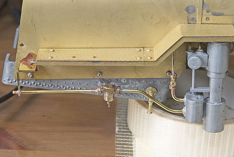

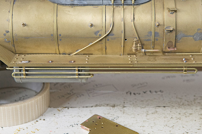

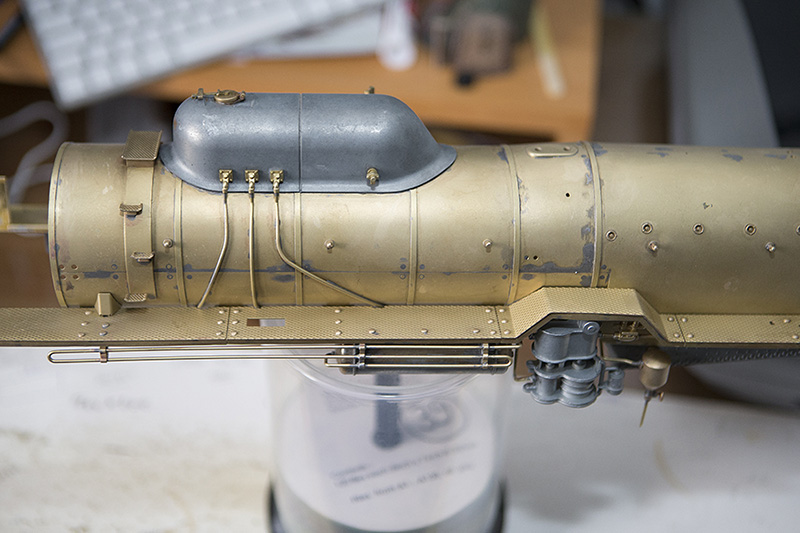

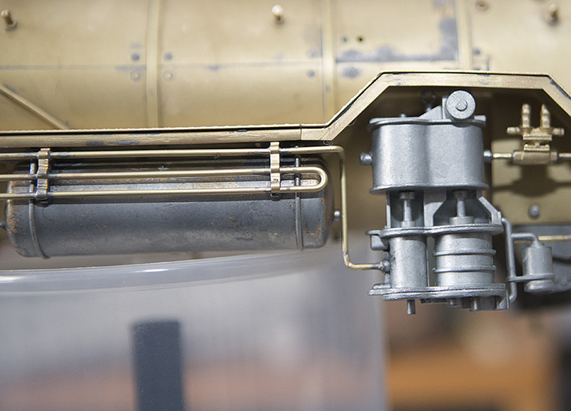

Parts 12

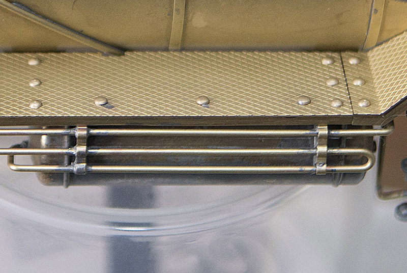

I was somewhat slower assembling parts set 12. Now that the weather is improving other hobbies take precedence.
Parts 12 was essentially the left side running boards that could be soldered in a similar way to parts 11. I have continued to use the 2mm rivet headed brass screws also discussed in part 11.
The Zamac parts were first of all simply rinsed in paint thinners which quickly removed the 'brass' finish off the compressor body however it had little effect on the left reservoir finish which had to be lightly bead blasted to remove the surface 'paint'. I cleaned the Zamac parts of the surface finish to allow soldering. Also soldered in place was the Zamac oil pump box (see soldering, model making know how). Although the various parts were soldered in place I have also used the 2mm brass rivet head screws on the various parts. These then all blend in together with the running board screws/rivets.
Although I did intend to leave the boiler front section for now (smoke deflector brackets) really it now needs to be attached since it screws to the main boiler body and the loco front end attaches to the front of the running boards, so watch this space.
In preparation I have attached (soldered) the front boiler band in place ready to accept the front end.
Dennis

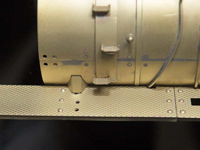

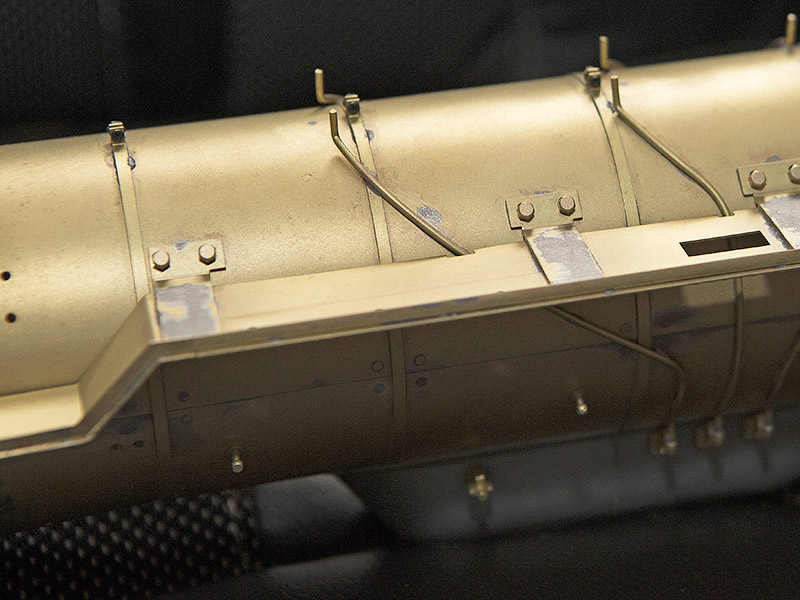

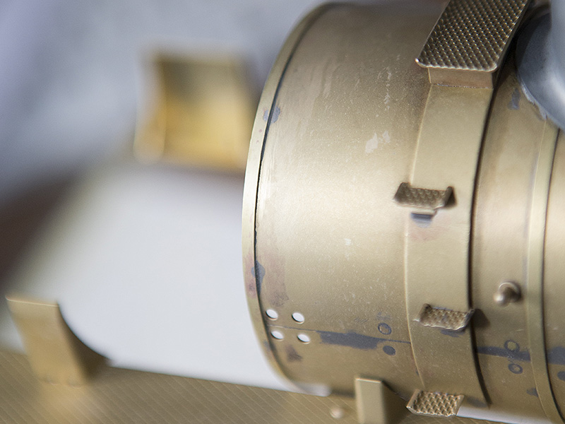

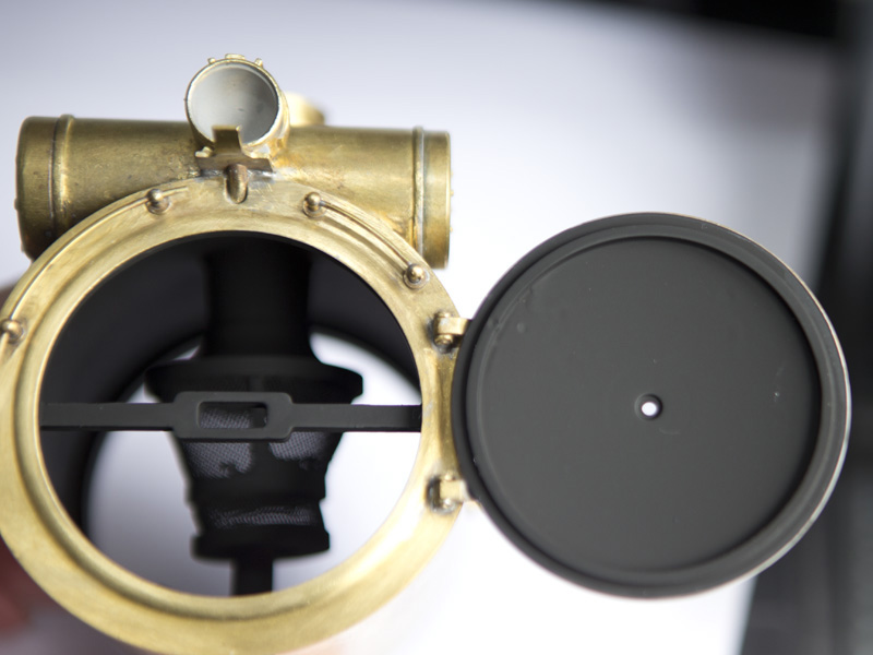

Joining smokebox to main boiler.

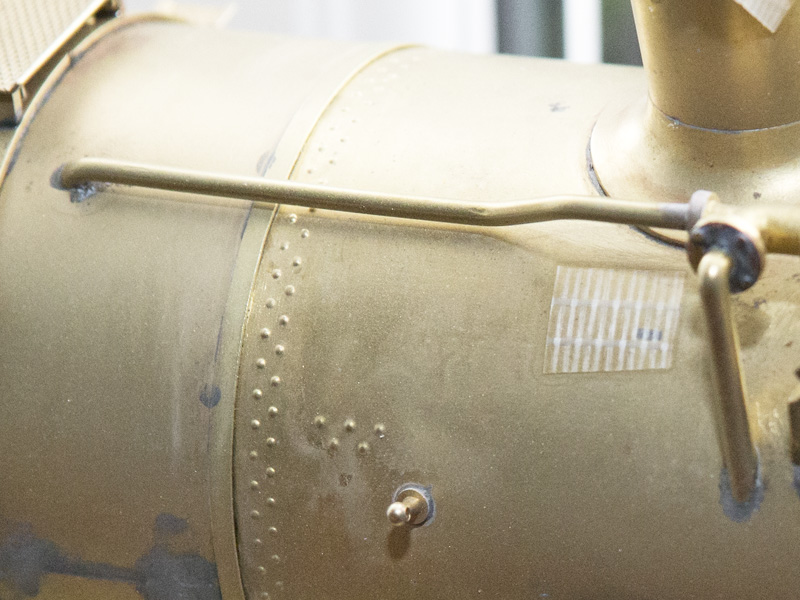

I had tried to leave this part until later. I was waiting for the smoke deflector brackets which would be the final parts to solder into the sides of the smokebox. However having completed the running boards I really needed to mount the front end in place.
Therefore I first sprayed the superheater element plate matt black. I masked off the lip to allow it to mounted to the boiler hinge joint with epoxy (plastic doesn't solder very well!). I sprayed inside the smokebox, over the spark arrestor and inside the chimney also matt black. Finally I also sprayed the inside of the smokebox door. Masking off as necessary. Once the paint had hardened the superheater element was glued in place.
Whilst the instructions use self tapping screws to hold the superheater element I would again be soldering up the holes on the boiler sides.
I soldered the final boiler band in place on the smokebox end of the main boiler. I arranged for 50% of the band to overlap. This helped when fixing the smokebox to the boiler.
I attached the front section once the smokebox was fixed in place. I used rivet head screws, 3 either side. I also soldered the joints underneath.
Although the pipe covers left and right, screw in place, I have soldered around these which adds stiffness to the assembly. Finally I fixed, again by soldering the steam pipe in place.
The matt black I used should be fine with the heat from the soldering.
Dennis

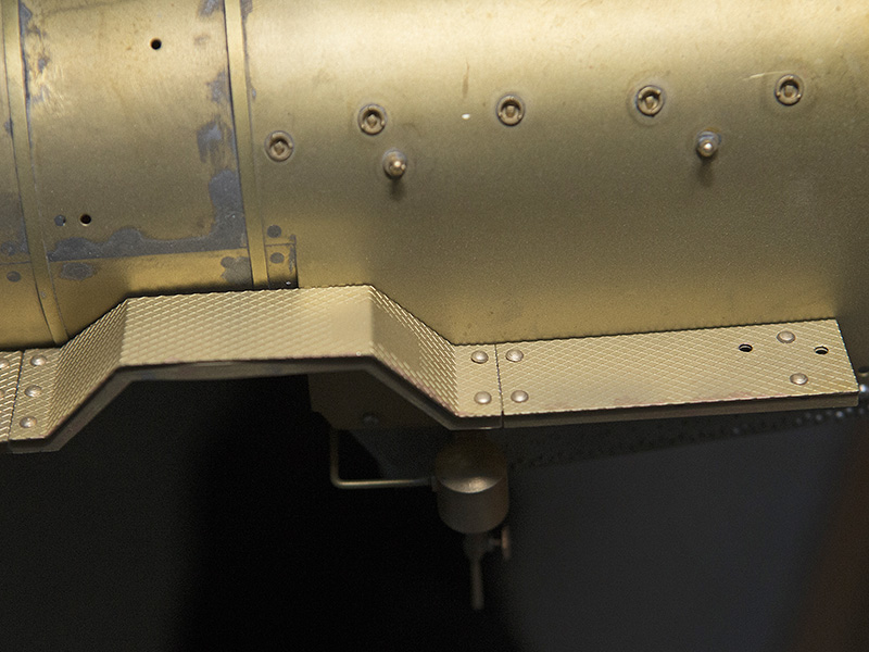

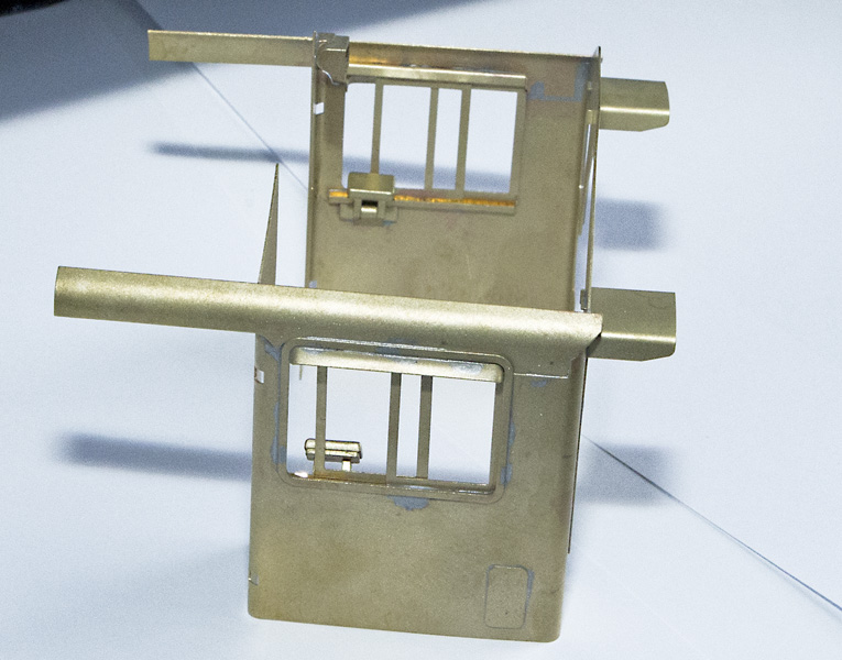

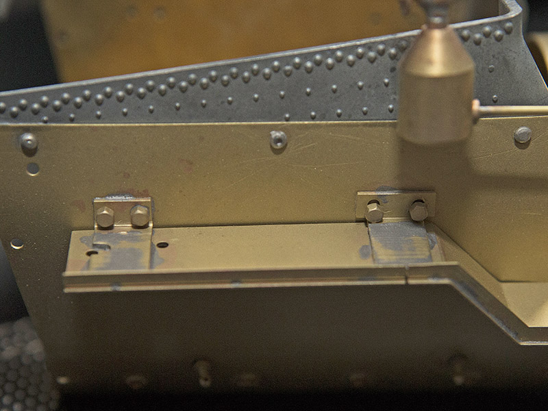

D51 parts 13

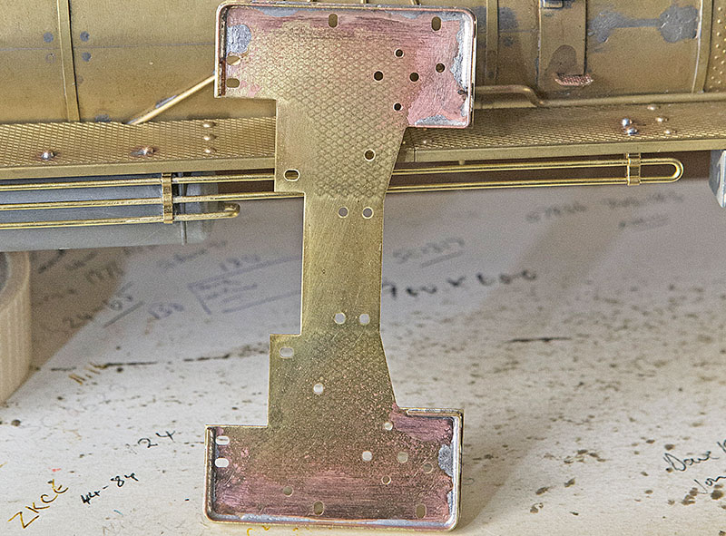

Firstly I removed the 'brass' paint from the water pump and right air reservoir. This would aid painting later. Also I used needle files to remove the casting marks especially from the water pump casting, the air reservoir only had slight marks on the two rounded ends.
I particularly liked the way the fire hydrant and the filter simply slipped on over the pipes. In practice the cutaway sides cannot be seen. As usual the water pump support was soldered in place and two rivet head screws installed and also soldered. The water pipe support, water pipe, fire hydrant and filter were all soldered in place.
Fitting the right reservoir and associated pipework was similar to the left side but somehow I made a better job this time round. Again the air reservoir and bracket were screwed to the right side running board using brass rivet headed screws. These again being fixed using tiny amounts of solder.

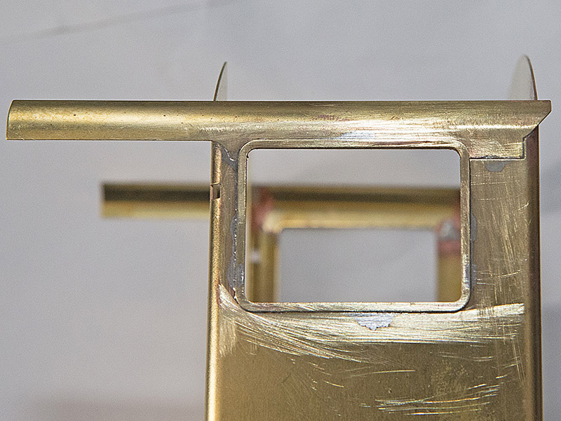

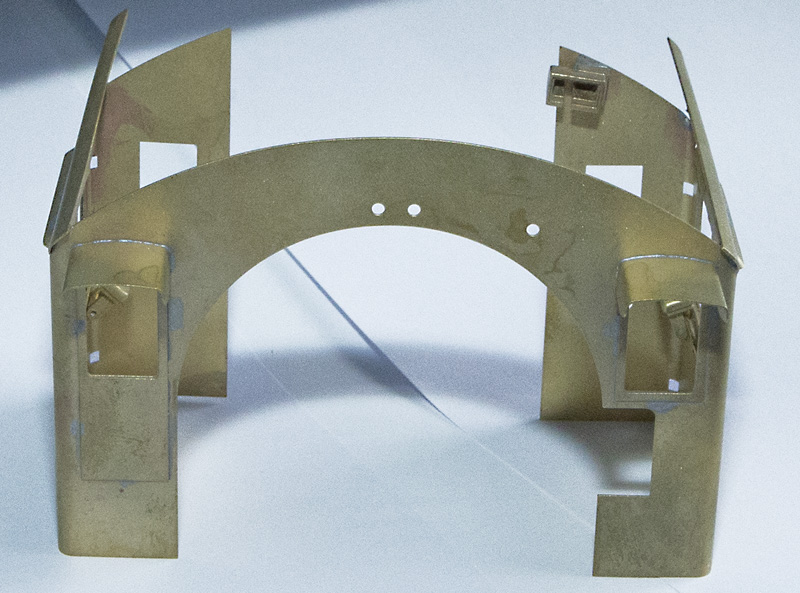

The cab I used in the 'Model Making Know How' entry under soldering. I will include two of those pictures again here. The delicate window frames and cab tops being held with toolmaker clamps whilst being soldered. The cab floor edging sections were held also in place with the clamps whilst being soldered. I have left off the 'stays' at present until I see how the rest of the floor is attached. Finally the firebox and grate was straightforward. I am intending to paint the inside (except the base of course) a mix of red/yellow etc that should reflect well and appear as a fire through the hatch.
The various soldered items and resultant flux marks will of course be removed before painting.
Dennis

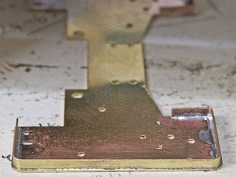

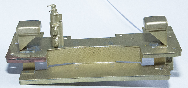

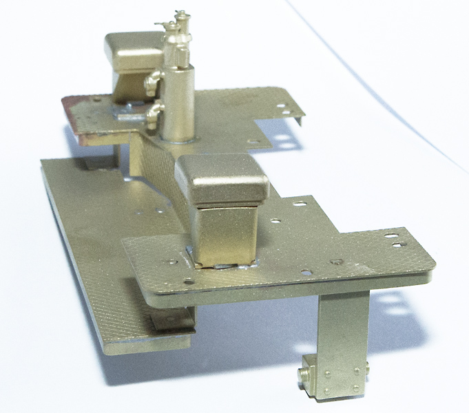

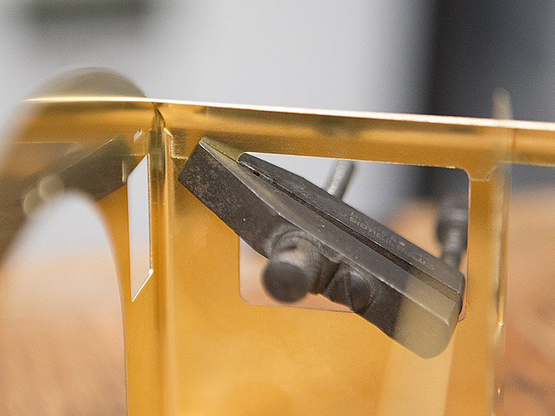

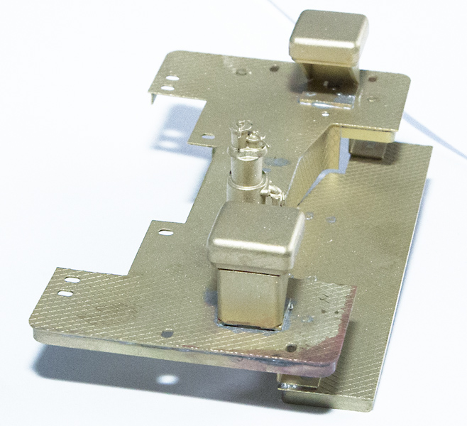

D51 parts 53/54/55/56
Again a little late sorting the pictures out but here goes.
Sometimes going via the solder route means the process is so much harder especially since everything is drilled for the 2mm screws.
This was particularly true with the cab floor. I have used pieces of brass 2mm screws to fill the screw holes (if that make sense?). Each time tiny amounts of solder are applied to fix the screw in place and then the protruding surface carefully or otherwise sanded down. I am hopeful that tiny amounts of stopper between spraying the various coats will cover up most imperfections. All the stays in parts 53 were soldered in place together with the floor edging as I did with the upper floor. Before the two levels were soldered together.
All the various other components were held in place with stainless button head screws whilst they were soldered, the screws then removed. In some instances the kit screws have been replaced as a bonus.

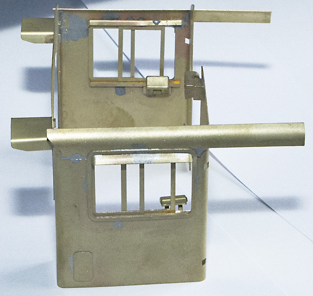

Next was the cab which is at present very flimsy. The idea of drilling the two upper ports is currently on hold otherwise flimsy could be strong compared to the result.
The windows frames were held in place with engineers clamps, soldered and the sliding window then fitted (yes they do slide!). The use of the clamps you will find under Modelling Making Know How - Soldering.
Fitting the eves did prove interesting (read messy). One end was roughly soldered, the eves positioned and the other end then soldered. Finally the soldering at the first end was improved and the whole finished off.
At present I am undecided still regarding the angle stays to hold cab/floor etc. So these remain in the box. Possibly soldering may be sufficient. Finally the small parts on the boiler were soldered in place or left as appropriate.
Dennis
