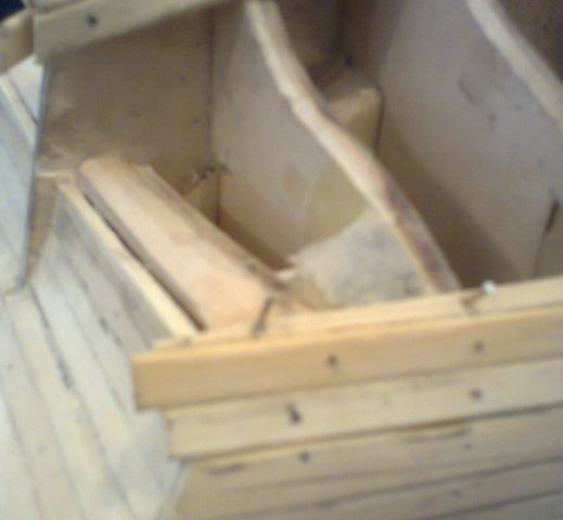

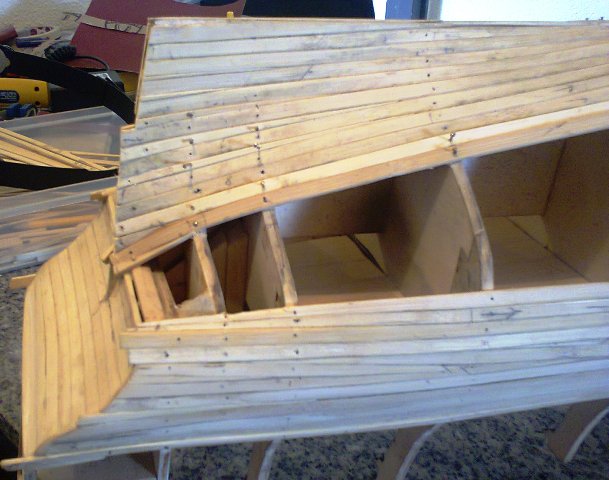

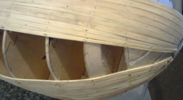

I was working on the stern at the bottom of the castle when I saw the inside contours of the structure ribs. When planked, this smooth profile disappear due to the flatness of the planks. It bothered me from the beginning of the planking that the half-round shapes does not have a smooth curve.
I want to simulate this effect as close as possible while the structure rib is still visible.

Marcel attached the following image(s):

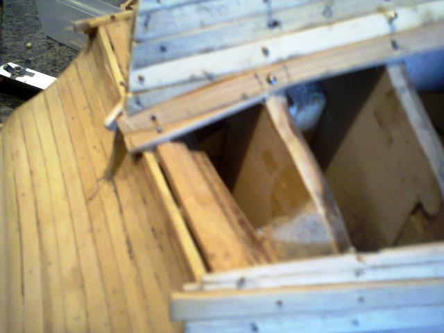

GlareWhen I received the laser cut parts for the castle, I discovered the strakes does not align. I had to remove some of the planks to rectify the misalignment of the strakes at the bottom of the castle.
Its only small adjustments to be made, before I am back on track. The black strings (marking the bands) is a great help for a quick fix.(I am glad this is a 'double-plank' build to hide my flaws). Blushing

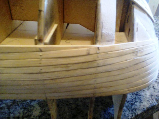

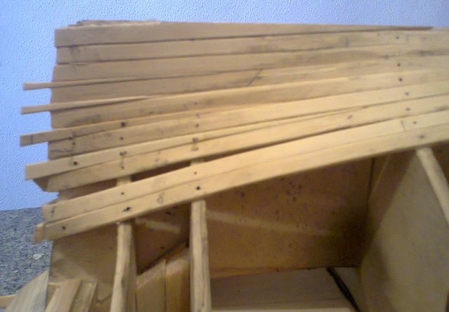

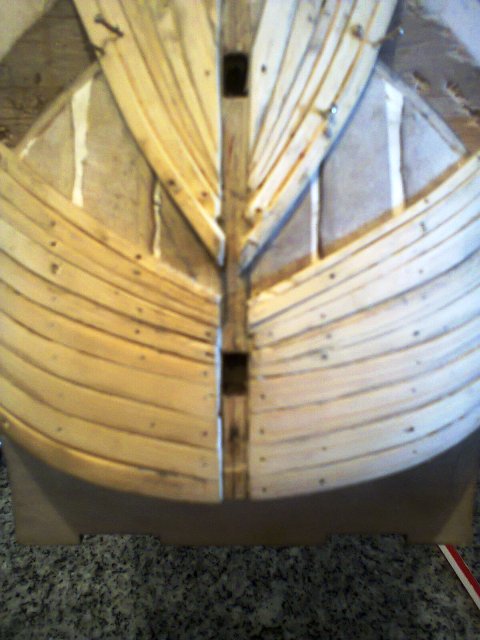

I had reach another roadblock in the first layer of planking. Issue 20 have 10 strakes from bow to stern. I have only used 9 strakes to reach the same goal. My only explanation is the 5.5mm wide bamboo of my supplies instead of the 5mm width: 10 x 0.5mm = 5mm. To follow the instructions I need to compromise a few steps. I have to use lots of grey matter and maths to come true again with the instruction.
Any help here would be appreciated.

Hi Marcel, for the first layer the number of strakes used compared to the written instructions for me wouldn't be too important nor any great concern. My overriding concern and where my attention would be would be in ensuring I keep the profile spot on and finishing off with a nice smooth finish ready for the second layer.... After all the first layer isn't going to be seen...... Cool Cool
Hope this helps..

I planned not to paint the hull white, but to use dark veneer. Although imperfections will be hidden, I need to fix my booboo I made at the stern in row 1 from the 1st two decks. I placed it one row too high which had to be broken off and rectified to fit the laser cut parts of the castle.
I had a good night rest while brainstorming and came up with a solution for my dilemma. All is need is a bit of my engineering skills.Blink
.HuhIf 9 rows is enough to do the job of 10 rows, which both measure close to 50mm, I only have to move on to the steps of the 11th row in the instructions
I can also use one or two sharp long tapered plank at the stern to equal the number of planks on all ribs and level the rows later as shown in the instructions.

Thank you all members of this forum. I manage to solve my planking problem at the stern and is glad to tell you that I am back on track with the instructions in the magazines.
I tested row 11 as instructed and it falls in place. When I put a new uncut plank over the hull to mark out the taper, the taper correspond with the original. I still have the same amount of planks on the ribs per band needed. I can now move on completing the first layer. This is a dreadful task I wish to get finished soon.
"Rather try and fail than had failed to try".

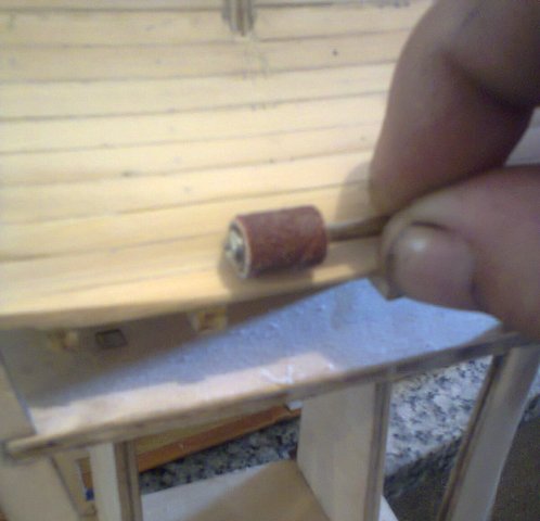

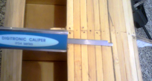

For the infill at the stern, I used 6mm apple wood for more support.
I used the small sanding-barrel mandrill from the rotary drill kit to sand it down by hand the contour where the castle meets the lower planks.
The rest is the basic instructions followed.

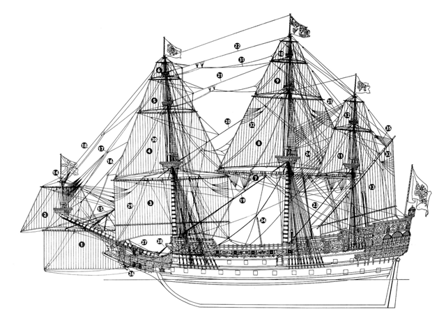

The HMS Sovereign of the Seas had a total length of 71 meters, a beam of 14.7 meters and a draught of 7.2 meters. The keel was timber piece of 39 meters length and 80 cm thickness. The golden decorations alone were equivalent to the cost of an average warship armed with forty guns.
The kitchen was traditionally placed in the forecastle, while the quarterdeck and poop housed the chambers of the commander and officers. The orlop deck and the hold, (below the gun decks) served as the storage for the goods of the ship. On the orlop deck below the commander’s and officers’ chambers, runs the rudder’s tiller which was attached to a lever to control the steering.
The gun decks, bulwarks and uncovered upper gun deck were painted in bright red to dissimulate the blood patches during combat.
The bronze cannons were typical of that time. To gain better stability, one of the covered gun decks was later removed.
Most of the precious ornaments were also removed as well and also her name was modified; firstly Sovereign in 1650, lately Royal Sovereign in 1685.
1 - Spritsail :: 2 - Spritsail topsail :: 3 - Foresail :: 4 - Fore topsail :: 5 - Fore topgallant sail :: 6 - Fore royal sail :: 7 - Mainsail :: 8 - Main topsail :: 9 - Main topgallant sail :: 10 - Main royal sail :: 11 - Mizzen topsail :: 12 - Mizzen topgallant sail :: 13 - Mizzen sail :: 14 - Topmast of spritsail topsail :: 15 - Fore stay :: 16 - Fore topmast stay :: 17 - Fore topgallant stay :: 18 - Fore royal stay :: 19 - Main stay :: 20 - Main topmast stay :: 21 - Main topgallant stay :: 22 - Main royal stay :: 23 - Mizzen stay :: 24 - Mizzen topmast stay :: 25 - Mizzen topgallant stay :: 26 - Forepeak fairleads :: 27 - Bowsprit lashings :: 28 - Fore stay collar :: 29 - Clew garnet :: 30 - Buntline :: 31 - Bowlines :: 32 - Bridles :: 33 - Halyard :: 34 - Cargo rig :: 35 - Topping lift

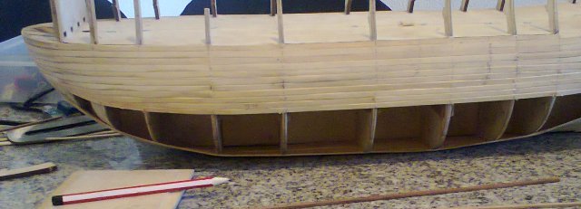

I had to shuffle some steps of planking to avoid the clinker effect. I used less rows due to the fact of the somewhat wider bamboo planks in my batch.

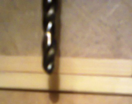

Issue 25

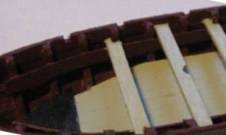

Making the hole in one of the thwarts is done easier with a 3mm drill bit.
Clamp or glue the ends of two pieces of planks together and drill a hole on the centreline.
Separate the two planks and you'll have a precise 3mm wide by 1.5 deep recess in the thwart.

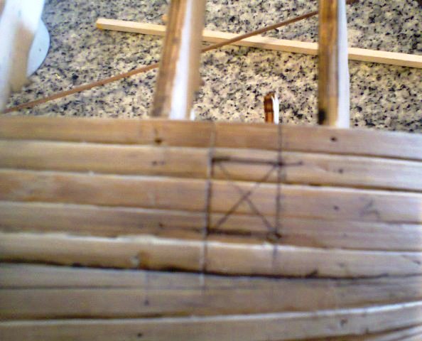

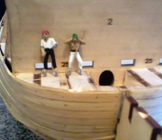

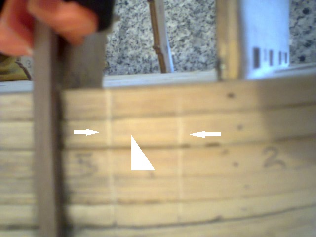

Marking the gunports

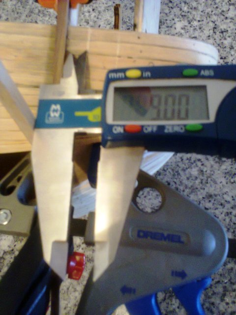

I triple checked the measurement of the ports to make sure it correspond with those of the instructions. I deliberately did not close the hull before I start to work on the first deck's ports. With the ribs and deck still visible, I can use it as a marker to avoid mistakes.
I measured the lower deck from the inside wall of the hull and marked it on the outside of the strake. This pencil line indicates the exact location of the bottom of the plate, in my case 25mm from the top deck.
Subtract the 2mm thickness of the deck plates and you have the 23mm transverse line from the instructions, which correspond with the top of your deck plate that you build in Issue 11.
I used a 4mm strip and clamped it onto the rib as a guide for my port. With the calliper I marked the port distances from the rib. I made a 12mm x 13mm square to use as a jig to fill in the port's border lines.
