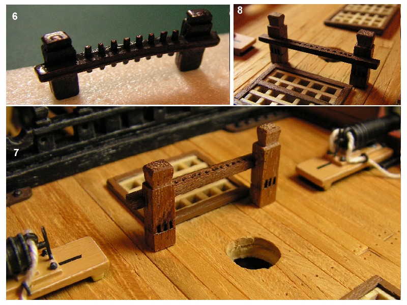

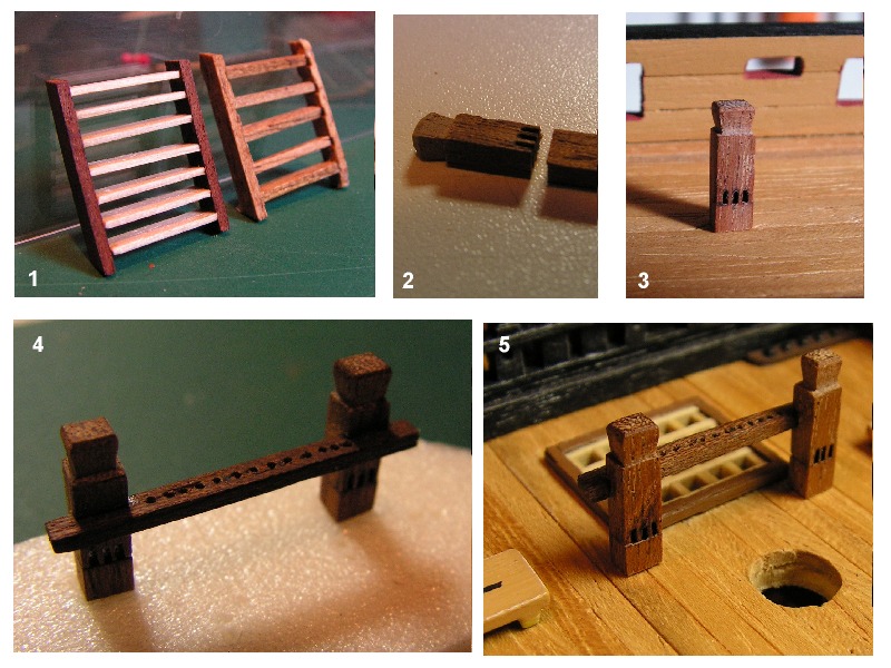

As I mentioned before, after building better steps for the poop and waist, I didn't like to leave the first lower waist steps which were built as per the kit instructions. Pic 1 shows the Mk1 and Mk2 versions, hopefully you can tell the difference - "No Harty! it's the other way around!!LOL ) The new versions are both safely glued down in position now and it improves the whole waist area.
The rest of the pics illustrate the replacement of the kit metal moulded Belaying Racks with new wooden ones. The original DelPrado is shown in photo 6. To be charitable, the dimensions of these things was actually spot on with the reference drawings at least it would have been if all four of them (two for the foremast, one for the main, (wrongly moulded to stick on the deck NOT down through the two hatches) and the mizzen mast thingy) had not been horribly warped during the moulding process into bow shapes.
The construction of the replacements is basically the same as for the catheads but on a much smaller scale. Thankfully they weren't any smaller, I did discover that three slots cut into 4x3mm wood strip is as small as I can get with the extra thin cut off disc (at the third attempt). After the slots were cut the strip was cut off to size and the decorative head filed into it. After that the remainder of the strip was superglued onto the slotted end and once dry the post cut to length. I learned my lesson on the first one, trying to file the head into such a tiny bit of wood gave me cramp in my fingers! On the second I slotted then glued the slotted bit onto the remainder, which gave me a much longer and easier to hold length of wood in which to file the head into! Blushing
Once the posts were both completed I then filed a horizontal channel into the front face into which the belaying pin rack would fit. The rack was made from yet more Grimsby spare plank cut down in width by about 1/3rd and drilled out with the pin holes. Before glueing the rack to the posts I drilled up into their bases to accept a length of 7mm brass rod which will later strengthen their locating points onto the forecastle deck.
Pics 4-5 and 7-8 show the finished belaying rack in position, it has now also been painted in Admiralty Black and drybrushed. I won't be finally fixing it down until the carronades have been tackled up, there isn't much finger room down there!
I now have to make the aft rack which fortunately only has two slots in each one! and then the mainmast rack too!Flapper

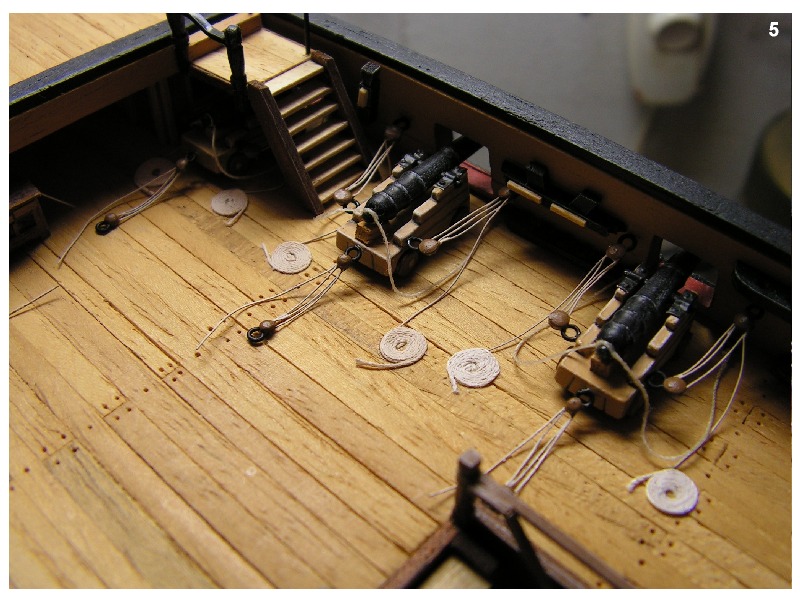

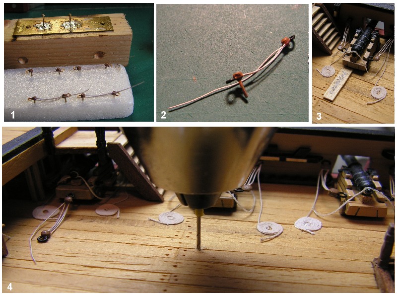

OK then, this is just a quickie about the final piece of the 12lb cannon tackle, the running in gear to pull the gun backwards either for re-loading (although usually the recoil would do that) or for securing and lashing down.
The first pic below shows the beginning of the production line for the wire and brass pin tackle. Unlike the main tackle which I produced one at a time I decided to try and do a few at a time for these. The system works quite well apart from the painting of the wire with the White/Walnut mixed paint. Once again I found that the Admiralty paints whilst brilliant used on their own, tend to dry too quickly when mixed together. Unfortunately there is no Citidel colour which is 'just right' so I'll just have to paint them in pairs instead of fours. (The obvious solution would be to get another two pots of white and walnut and mix them together in a third, clean pot to create a dedicated 'rope colour' pot of paint! But I'm not that rich!!BigGrin )
The second pic shows the completed tackle. This is made from the same .2mm wire as before but soldered to my thinnest brass pins, about half the diameter of the earlier ones as you can see in the final picture. The other difference is that I only completely remove the pin shaft from the end which attaches to the cannon, the other pin is cut down but still with half it's shaft remaining (for reasons which will become clear!)
Pic three shows one of the quarter deck cannon with a small piece of scrap wood pencil-marked "cannon", this wood is the exact same length as the tackle is from the pin shaft to the end of the soldered ring on the other end. Once that distance has been marked on the deck a tiny hole is drilled through the deck at that point as seen in the fourth pic. Although the drill bit is shown in a large chuck it is actually being hand drilled, my small pin vice drill won't grip the smallest drill bits anymore so I'm using a universal chuck and twiddling the shaft by hand, (pound shop special God Bless 'em!)
After drilling out the tiny hole, the pin shaft mentioned earlier is inserted into the deck and only the ring jammed against the rear of the cannon needs to be secured with a drop of PVA.
The final large picture shows the completed tackle on three of the quarter deckers, this was taken just after the rings were glued to the cannon, once they have dried I will gently alter the curves of the trailing wire ropes so that they lie flat against the deck. All I need now are the damned crew to man them!Crying
Incidentally, both the forecastle belaying racks are finished now but I forgot to take a photo to include here - hopefully next time! Five cannon finished, only another thirteen to go.

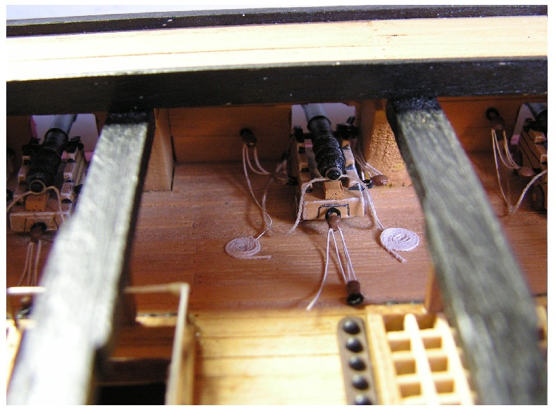

Here's just a quick update, the quarterdeck guns and the port side waist cannon are now all done with just another five on the starboard to go, (should really be six but on both sides the aft most waist gun was passed in through the gunport, just glueing it in position was hard enough, there's no chance at all of getting any tackle in there!)BigGrin
Had one little accident fitting in the last two sets of rear tackle on the quarterdeck, marked and drilled the holes for the brass pin to drop into and had to use the 'kinked ended' tweezers to hold the pin to position it. Once gripped tightly my thumb and forefinger blocked my line of vision below the tweezers and as I went in closer to drop the pin down the hole said digits collided with that spindly fence work around the main steps and popped it completely off the deck!Crying Cursing
Fortunately the bottom bannister rails remained glued on the lower deck so it didn't fly off completely and was soon re-PVA'd back in position so not as bad as it could have been.
That's the trouble when bare decks start to get covered in sticky out details, you not only have to glue extra bits in, you have to carefully plan your big clumsy hand's route in and out to avoid all the delicate obstacles!Blink
Anyway, all's well and here's some of the port waist (they look so cute all bedded down with their ropes, just waiting for their crew to arrive - one day!)

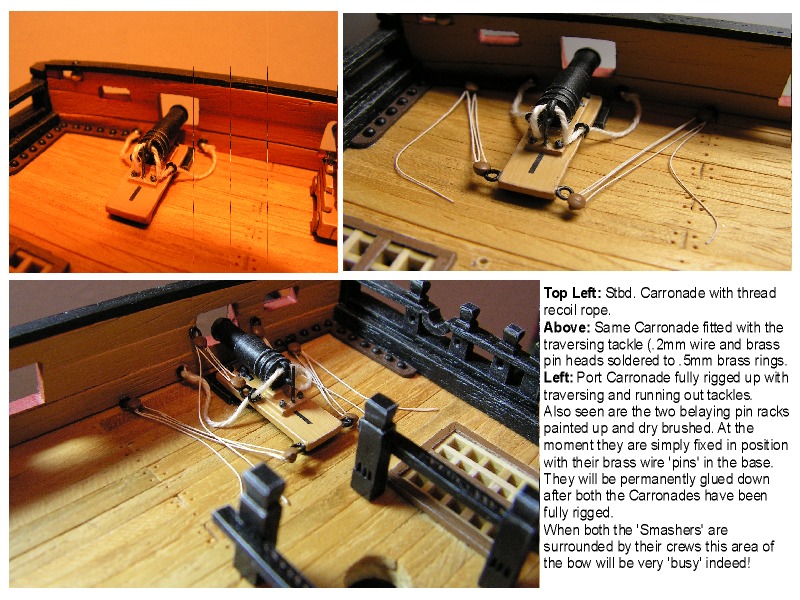

Here's a quick update on the Carronades in the bow area, one is completed and the other just needs the running out tackle so hopefully the next couple of days should see the last of the detailed guns completed!BigGrin
Coming up soon should be the entry steps up the sides of the hull Crying
