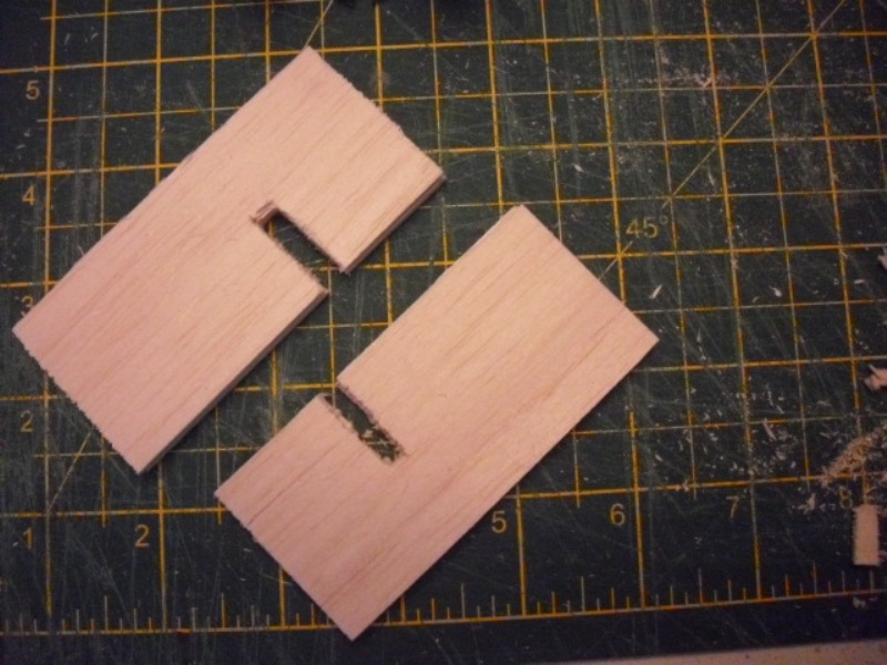

BALSA INFILLS (BOW PART No 2)
Hi Team, its time for me to start using balsa wood, to strengthen the Bow formers.
Its something I prefer to do (you do not need to)with all my ship builds.

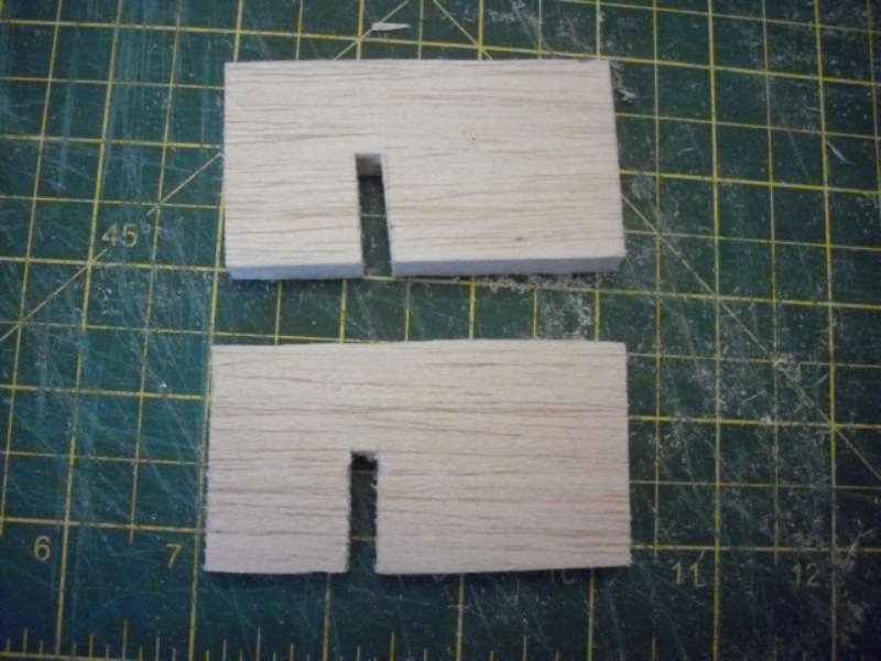

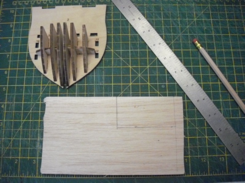

STEP 1 cut the first pieces of Balsa (these are 10mm thick):-
#123 Posted : 21 September 2012 15:14:21
BALSA INFILLS

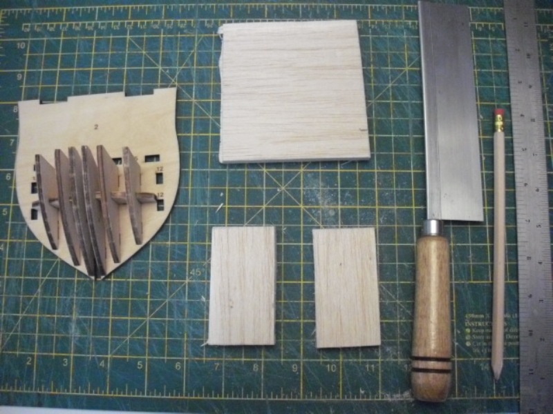

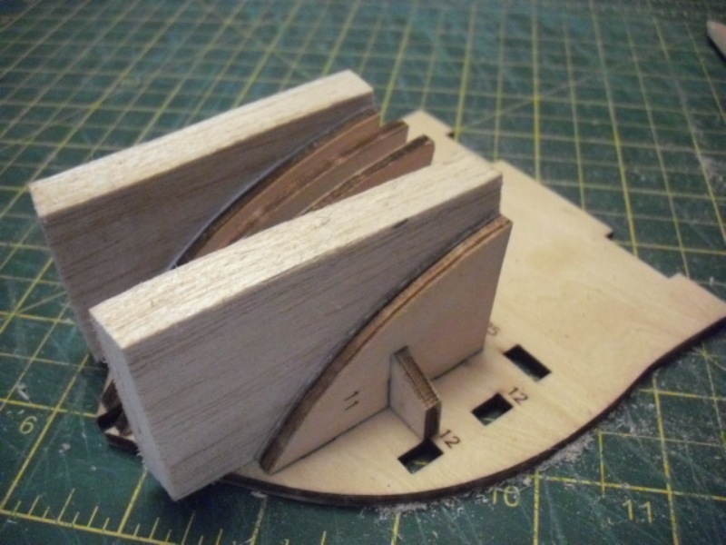

STEP 2
I now measure and cut two more infills (these are 6 mm thick) I used two pieces of 3 mm thick from some offcuts I had:-
#124 Posted : 21 September 2012 15:23:19
BALSA INFILLS

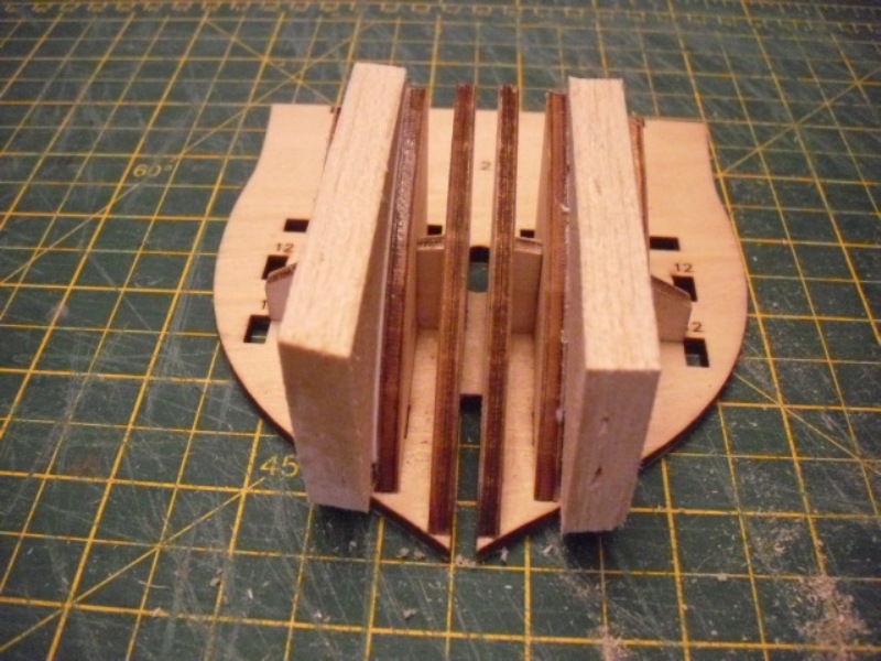

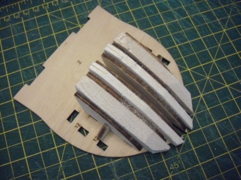

STEP 3
Please make sure if you decide to do this, you do not fill the centre slot because judgeing by the hole at the middle of part 2 the bow sprit will be fitted here, plus there is a slot at the bottem where we are going to fit another part.
I will add two more infills of 10 mm thick when I have fitted bow formers 12 in another issue.
Well thats all for now,BigGrin Questions and comments welcome, I will leave you with a photo of the balsa roughly shaped at this point.:-
Regards Mike
