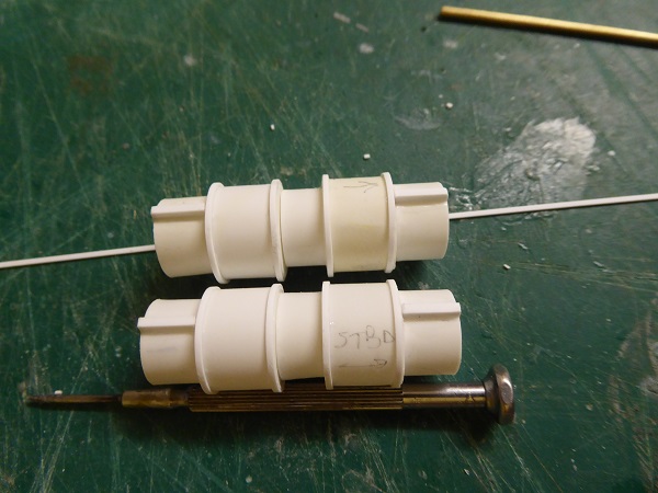

The attached photo shows the edging strips completed on both the main motors.

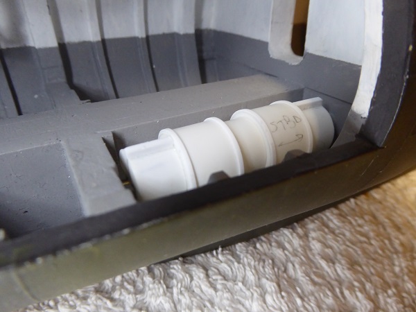

The attached photo shows the starboard main motor in-situ to give you an idea of how it's located.
I intend to add as much detail to these before i fit them in place.

Very nice work Phil.
Like how you have made the motor cylinders from card discs and a wrap - that is a neat idea.

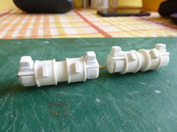

This week i've continued to add detail to the main motors.
See attached photo showing the addition of inspection plates and junction boxes.

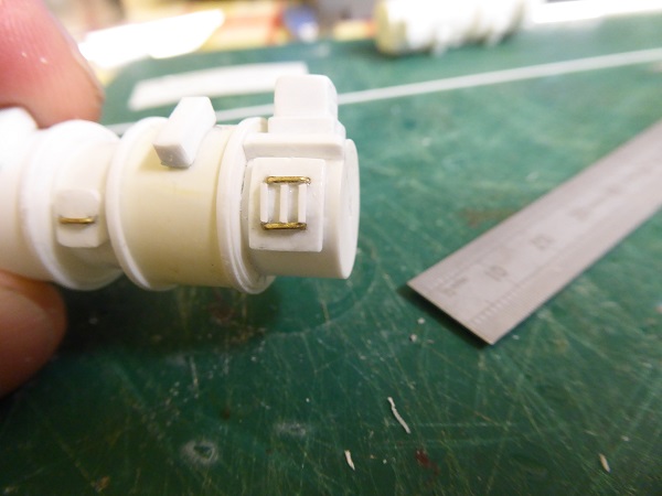

10 x lifting handles were made from 0.5mm diameter brass rod, bent to shape and attached to the inspection plates.

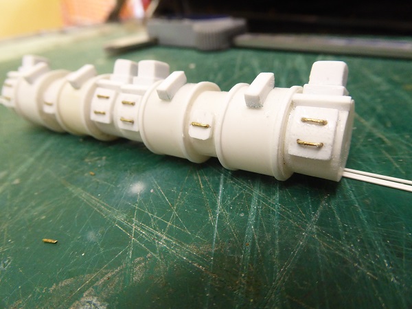

More detail added to the inspection plates using 0.5mm styrene strip.

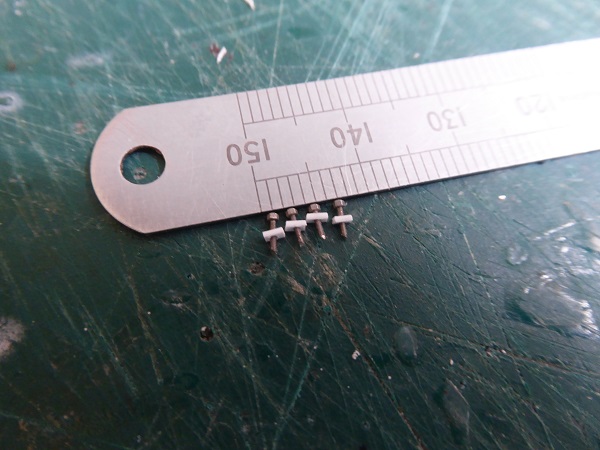

#135 Posted : 11 September 2020 07:23:56
The next job was to make the inspection plate latches. I used 0.6mm diameter x 6mm long steel bolts, cut down in length slightly and plastic strip, drilled out and also cut to length.

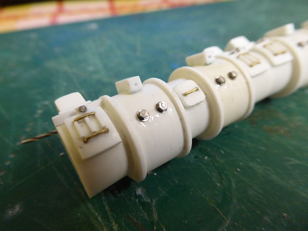

#136 Posted : 11 September 2020 07:29:06

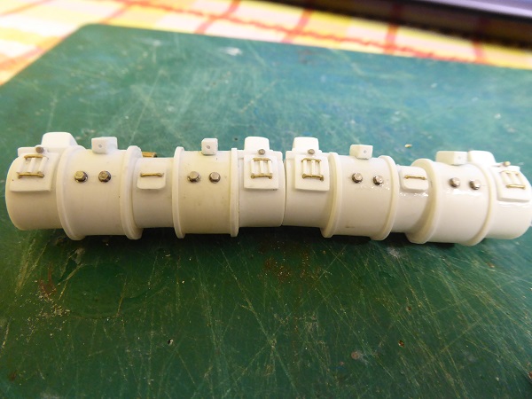

This photo shows the latches fitted and further detailing to the main motor bodies using 1.0mm diameter steel bolts and washers.
#137 Posted : 11 September 2020 07:29:47
From another angle.
