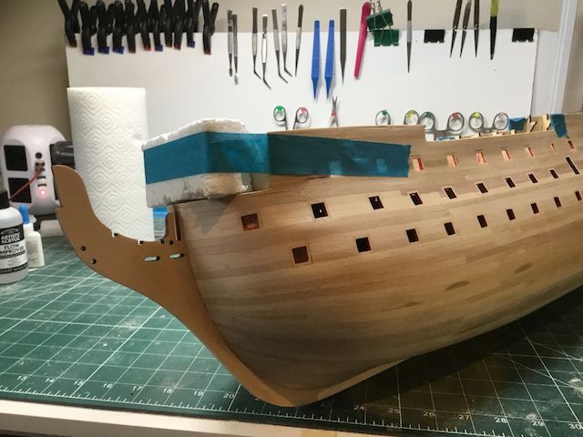

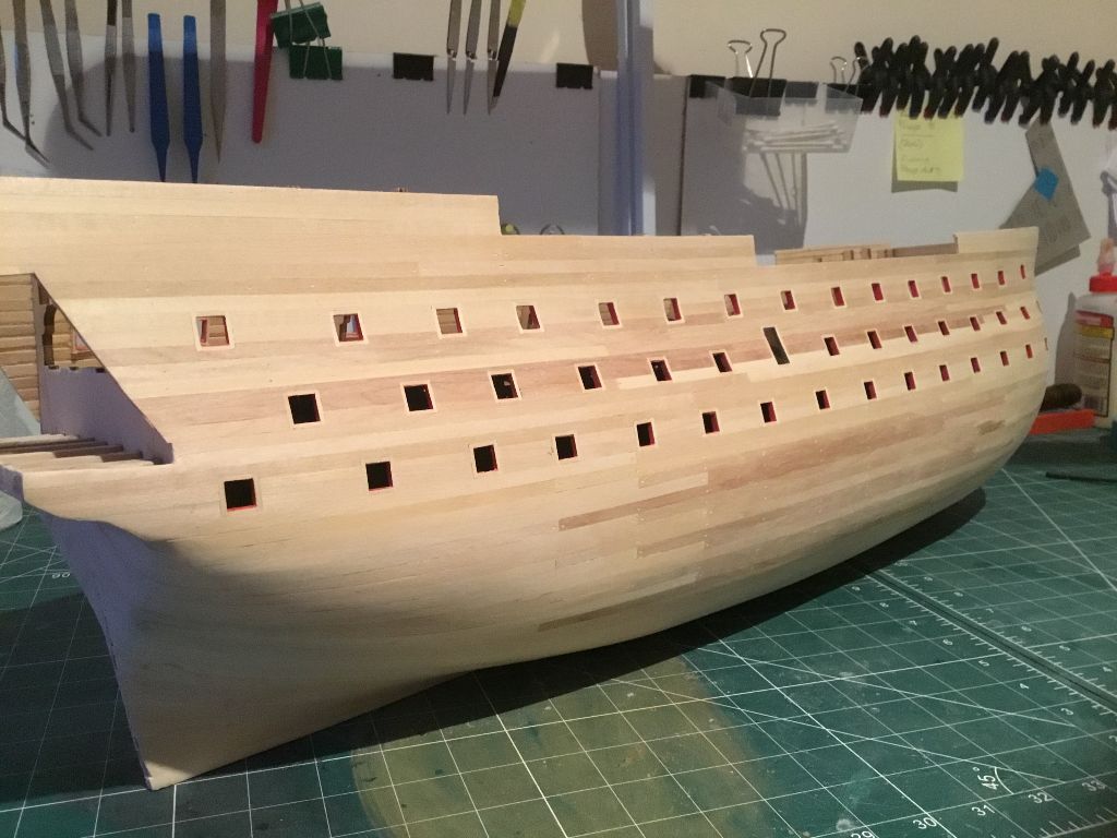

Hull planking now complete and its had a light sanding up to the gun port level.
Added some filler and will rub this down before moving up the hull.

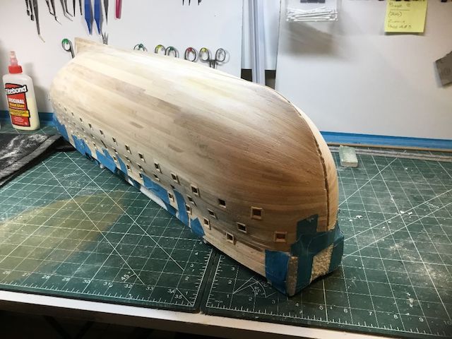

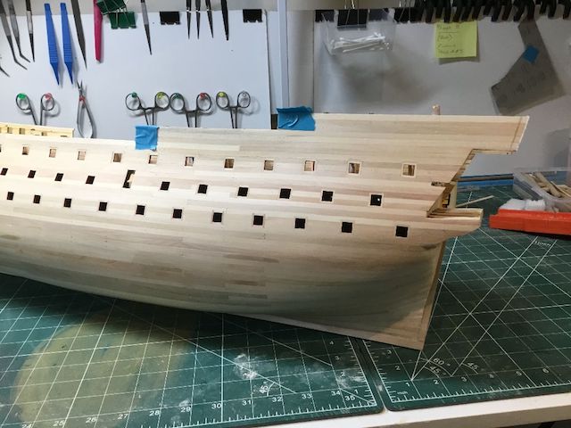

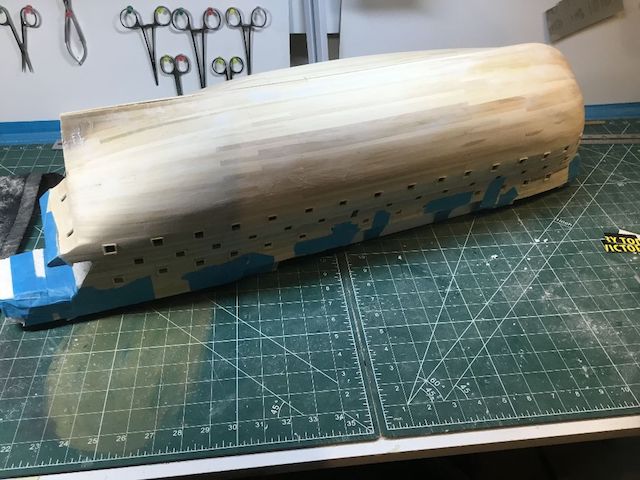

Some of you will remember Zwong and his fantastic build back in 2013/14 and how he painted the gun ports
at the stage before sanding. I thought this would be a good idea so I followed suit. Any slight runs or bleeds of paint then got sanded off now and just some very minor touching-in is required.
Next step is some joint filling and then another medium sanding before finishing off.
goddo attached the following image(s):

z8000783 wrote:
Great work Chris, she really looks nice.
Thanks John. The only concern I have at the moment is the dark mark in the planking adjacent to the foremost top row of gun ports. I may remove that plank for a "clean" one.
z8000783
#127 Posted : 03 February 2020 19:14:01
Groups: Unapproved
Joined: 24/05/2010
Posts: 1,761
Points: 5,351
Location: London & Greece
If you are painting the model, then don't worry about it. Even though it will be ochre, it should cover OK.

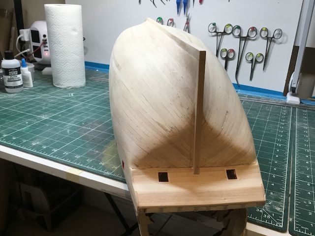

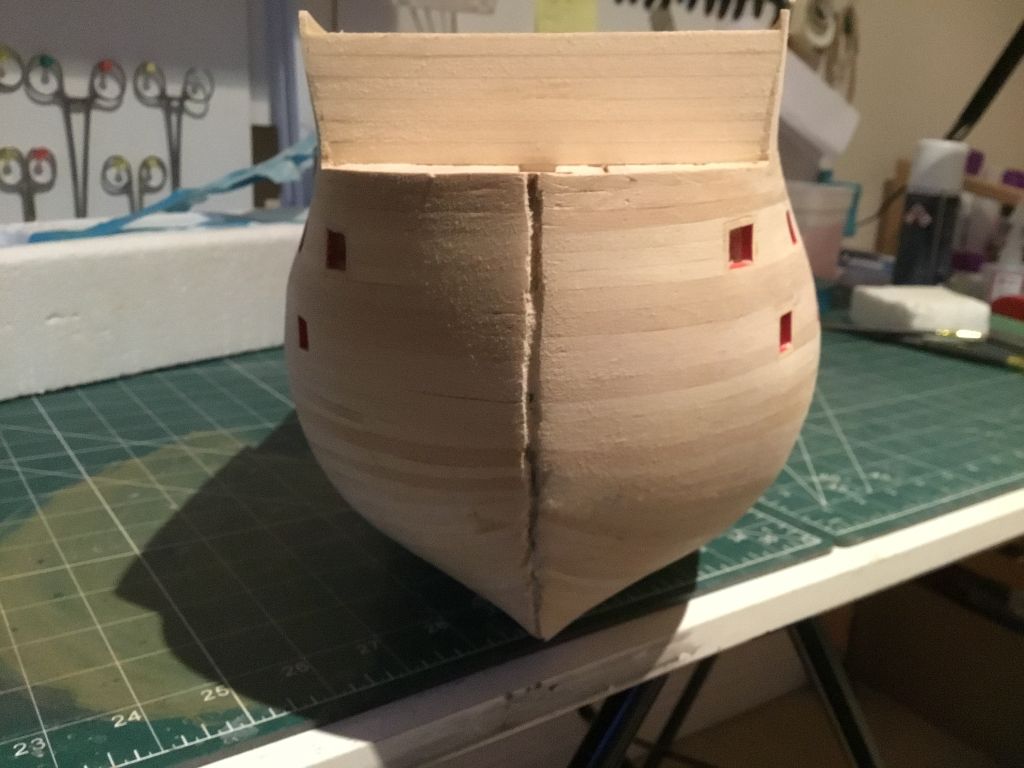

#129 Posted : 10 February 2020 16:41:55
Joined: 21/04/2011
Posts: 1,089
Points: 3,296
Location: Buckinghamshire

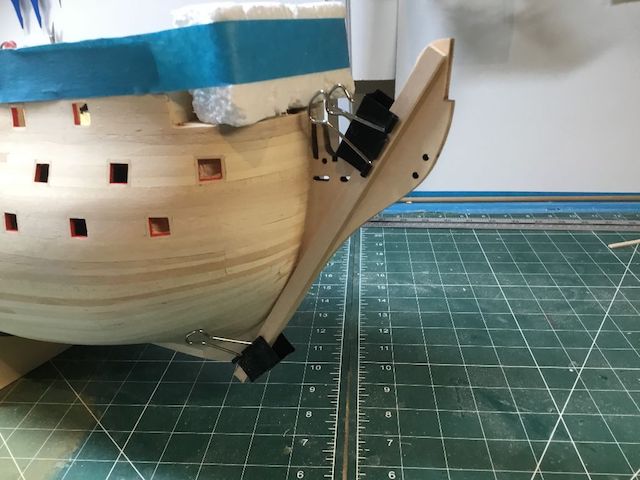

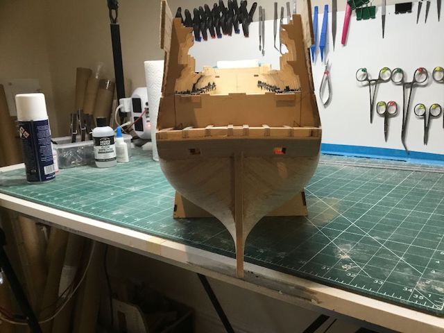

Main keel, stem and stern post now fitted.
All sanded and just final going over required.
From past experience, the stem can be very vulnerable to knocks, so I mad a "splint" out of off-cuts and clamped it on. Hopefully it will give a bit more protection.

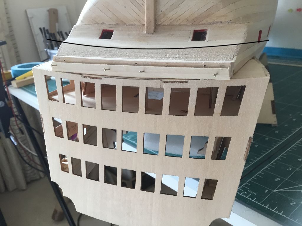

#140 Posted : 17 February 2020 12:46:21
Joined: 21/04/2011
Posts: 1,089
Points: 3,296
I wonder if anyone can advise me please?
I have added the additional five planks to the rear of the gallery support and I am
wondering if I sand them to follow the underside of the support (as per the black line) or do I leave them horizontal?
Hope this makes sense.
